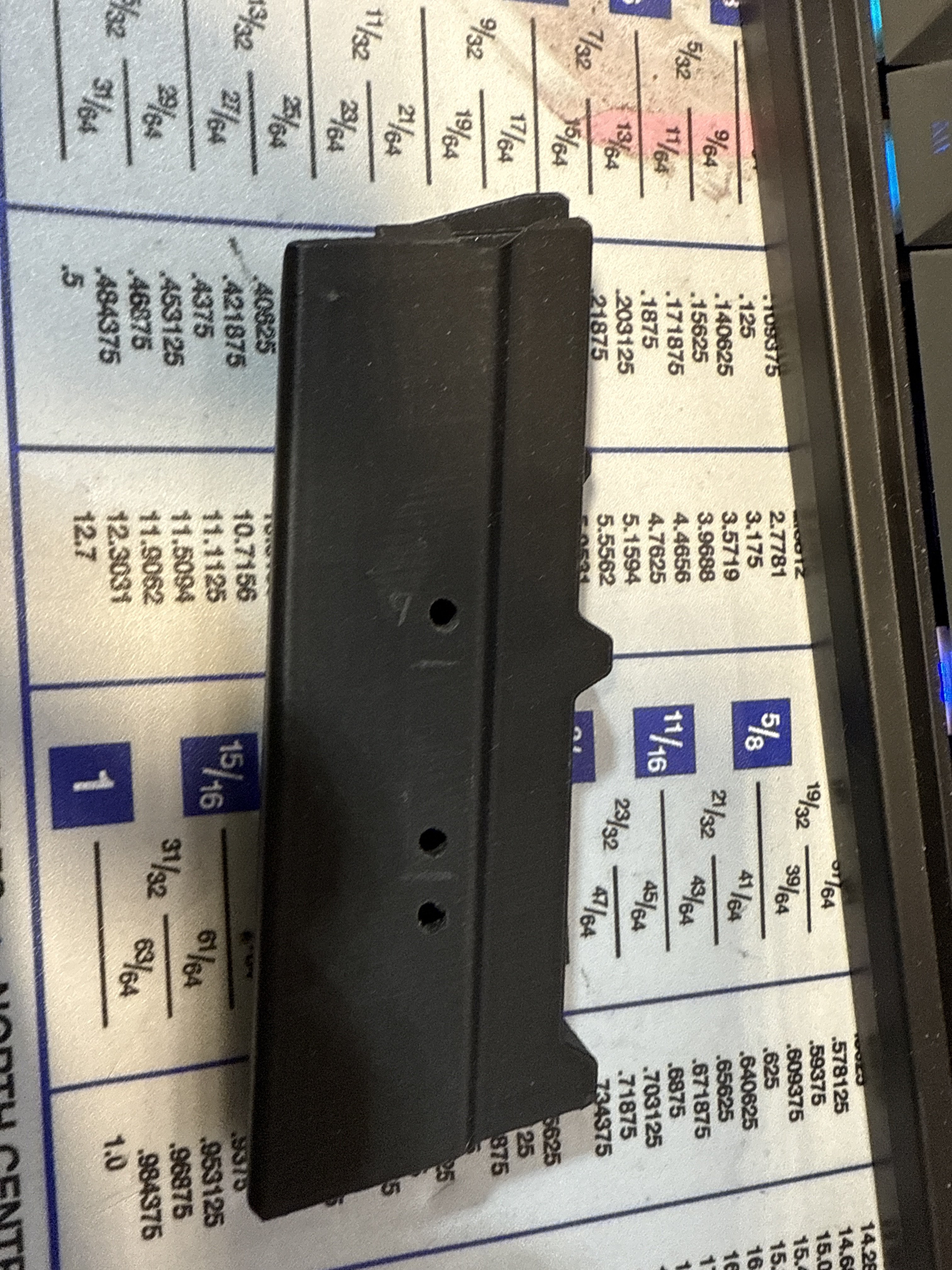

I have spoke to Brad and Zane about the Tikka mags and can confirm they are a disposable item 500-800 rounds and they are trashed. I designed a billet magazine for the Tikka and have it moving into production now.
Not in a position to say one way or the other, but I’m perfectly willing to believe you that the design (dimensionally) is great. But I recall Zane Hermann saying he throws them away after 500 rds because they wear out so fast.
I think this is what you’re hinting at with the Gray Ops quality bit?
Its not just the t1x "magazine" unit itself, but the mechanical engineering and approach. I'm just talking about the form factors, ergonomics, and impact on the rifle's design and integration with the chasis and its CF footprint etc. Again, that doesn't mean Tikka t1x is a better rifle than a vudoo or its feeding / fire control is perfect, etc.

MB
Both CZ and Tikka T1x do the hanger style, and for the most part have less magazine related feeding issues.
I guess it comes down to if you want AICS style mags or not.
I like T1x magazines and was one of the reasons I did a T1x build (which in hindsight I should've done a CZ build).
I don't see the appeal over masively oversized magazine for "training" purposes when guys are running 10-15 round centrefire magazines.
Yup, I should have gone CZ also, instead of Tikka. How many CZ’s have feeding issues in a match vs 700 footprint 22LR actions? Spending $2500 for a barrelled action and $1-$2K for a chassis and then having it run like a surplus Russian army truck is not a good feeling.
