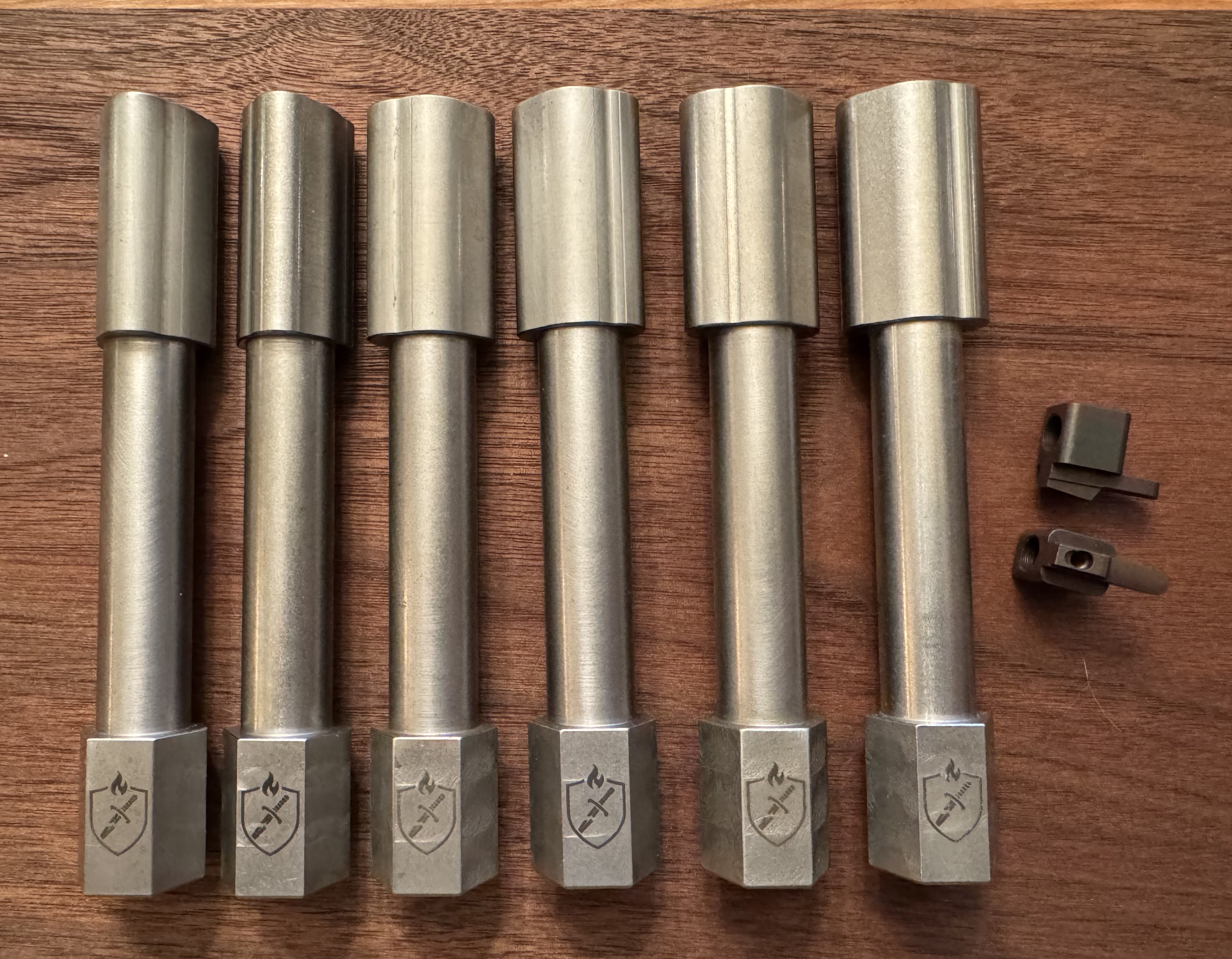

Quick Update: Available to order, email to [email protected]
Springs:
Main Springs for all generations of V-22 (most probably call them firing pin springs) are available as follows:
DDG-MS15V22 15 lbf Main Spring--Green
DDG-MS16V22 16 lbf Main Spring--Orange
DDG-MS17V22 17 lbf Main Spring--Red
DDG-MS18V22 18 lbf Main Spring--Purple
DDG-MS19V22 19 lbf Main Spring--Blue
DDG-MS20V22 20 lbf Main Spring--Yellow
DDG-MS22V22 22 lbf Main Spring—No Color
Complete Main Spring Kit: all seven springs, DDG-MSK-V22: $63.00
Individual Springs, order by color code: $9.69 each
Extractor/Pusher Spring Kit--DDG-EPSK-V22: $7.00
Magazine Springs:
Legacy Nylon Mags and Gen 1 Aluminum Mags:
Five Round Aluminum Mag Spring, DDG-V22-MS05: $5.00
10 Round Nylon/Gen 1 Alum Mag Spring, DDG-V22-MS10: $8.00
15 Round Gen 1 Alum Mag Spring, DDG-V22-MS15: $10.00
Bolt Stop Springs will be included with the specific Bolt Stop Kits for Gen 1, Gen 2, and Gen 3 V22 Actions.
Single Screw Cocking Piece:
Gen2/Gen3 60 Deg Single Screw Cocking Piece, DDG-G2/G3-60DCP: $83.00
Next Week:
Firing Pins for Gen 2/Gen 3 Repeaters and Gen 3 Single Shot will be available to order. I'll announce when I'm opening the ordering and will provide pricing at that time.
Thank you, to this incredible community, for your support,
MB
