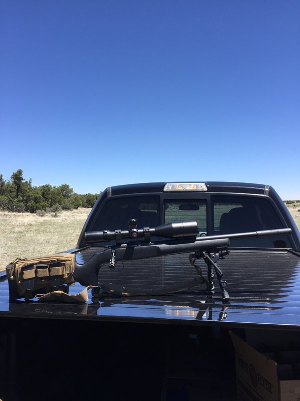

Cz455 is a great rifle to suppress.
Anything bolt action will be much easier to suppress over a semi auto. Pick something you like and go nuts with it
[No message]
I absolutely love my CZ455, it's a blast to shoot and its stupid accurate. I love the bolt action suppressed .22, pics above I haven't completely figured out posting pics...
