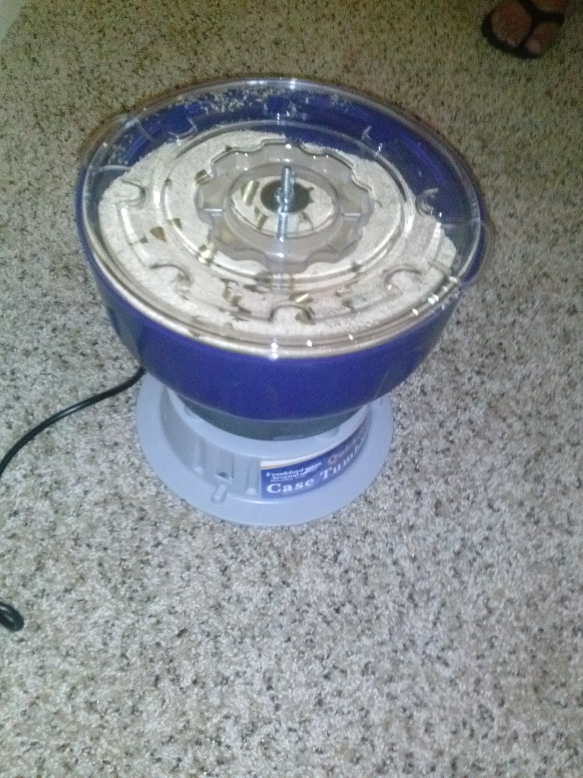

The kit comes with the tumbler, a bag of media (I think it's conrcob media but I can't tell), a bucket, and a media separator. The directions for set up where pretty straight forward and within 5 minutes I dumped in the fist batch of of brass. The tumbler has rubber feet to prevent it from vibrating off your bench top. My favorite feature is the clear plastic lid that allows you to view the polishing process and check on the progress of the brass without turning off the tumbler or taking off the lid.

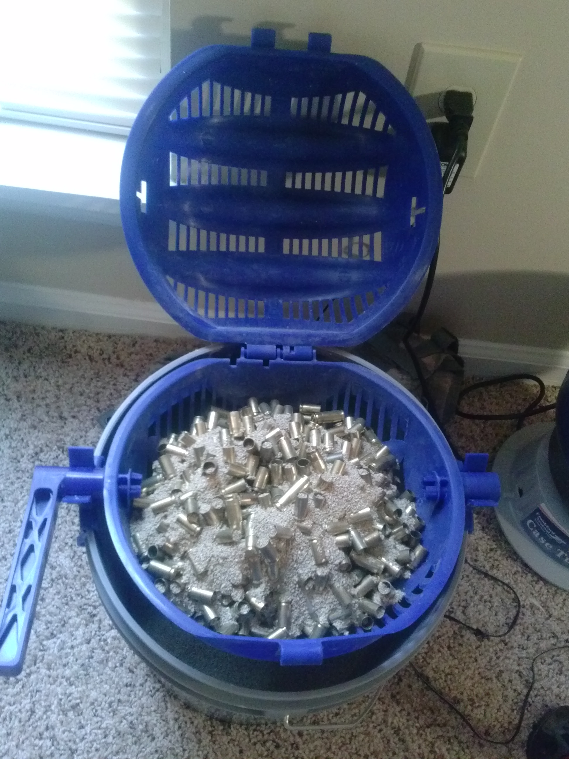

I found that this tumbler was fairly noisy, but most are. When I put it behind a closed door it doesn't make noticeable noise in the rest of my small apartment. After I ran a batch of nasty .45 ACP for about 4 hours, I powered it off and dumped everything in the separator. The separator, in my mind, is very poorly designed. The set comes with two plastic clips that snap on to the included bucket that hold the separator in place.
![CAM00512.jpg CAM00512.jpg](https://www.snipershide.com/shooting/data/attachments/12/12168-cf2dbbf2aa7a685ee662e433963b8dc2.jpg)
This clips easily slide around the bucket and come out of alignment. It also comes with two stiff plastic sheets that clip on to the bucket that are supposed to prevent the media from flying all over the place when cranking the separator. The problem is that when they are attached to the bucket, they get in the way of rotating the separator. dumb.

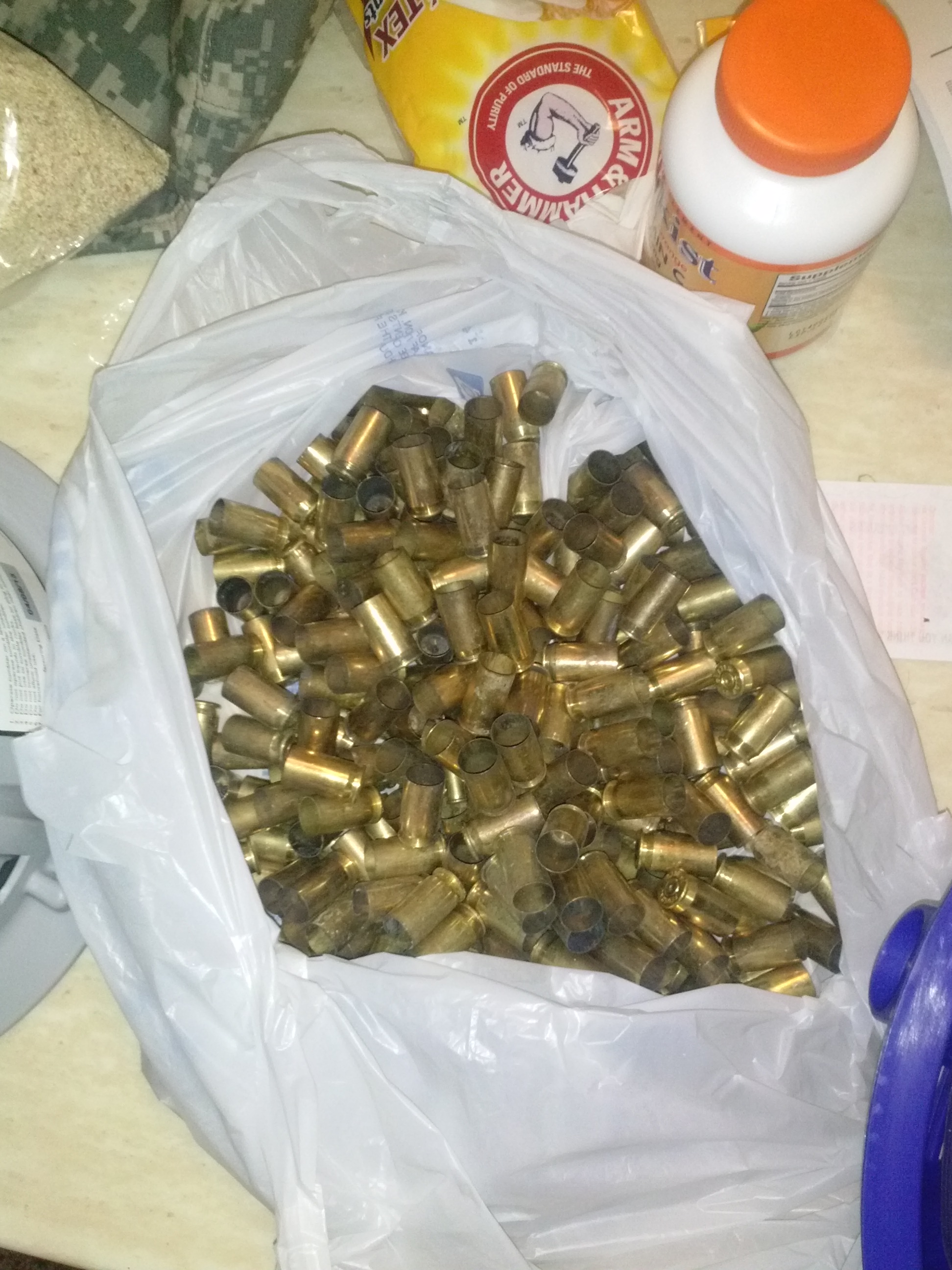

Before and after pics
![CAM00509.jpg CAM00509.jpg](https://www.snipershide.com/shooting/data/attachments/12/12166-00584a51f398456f6630c7ad712aa85e.jpg)
I have the luxury of having access to basically an unlimited supply of range brass from the local range here, so I decided to assemble the tumbler and throw in a load of .45 ACP. The tumbler did an excellent job cleaning and polishing it up. For the price, I would recommend this system even with the crappy separator, it's better than nothing.

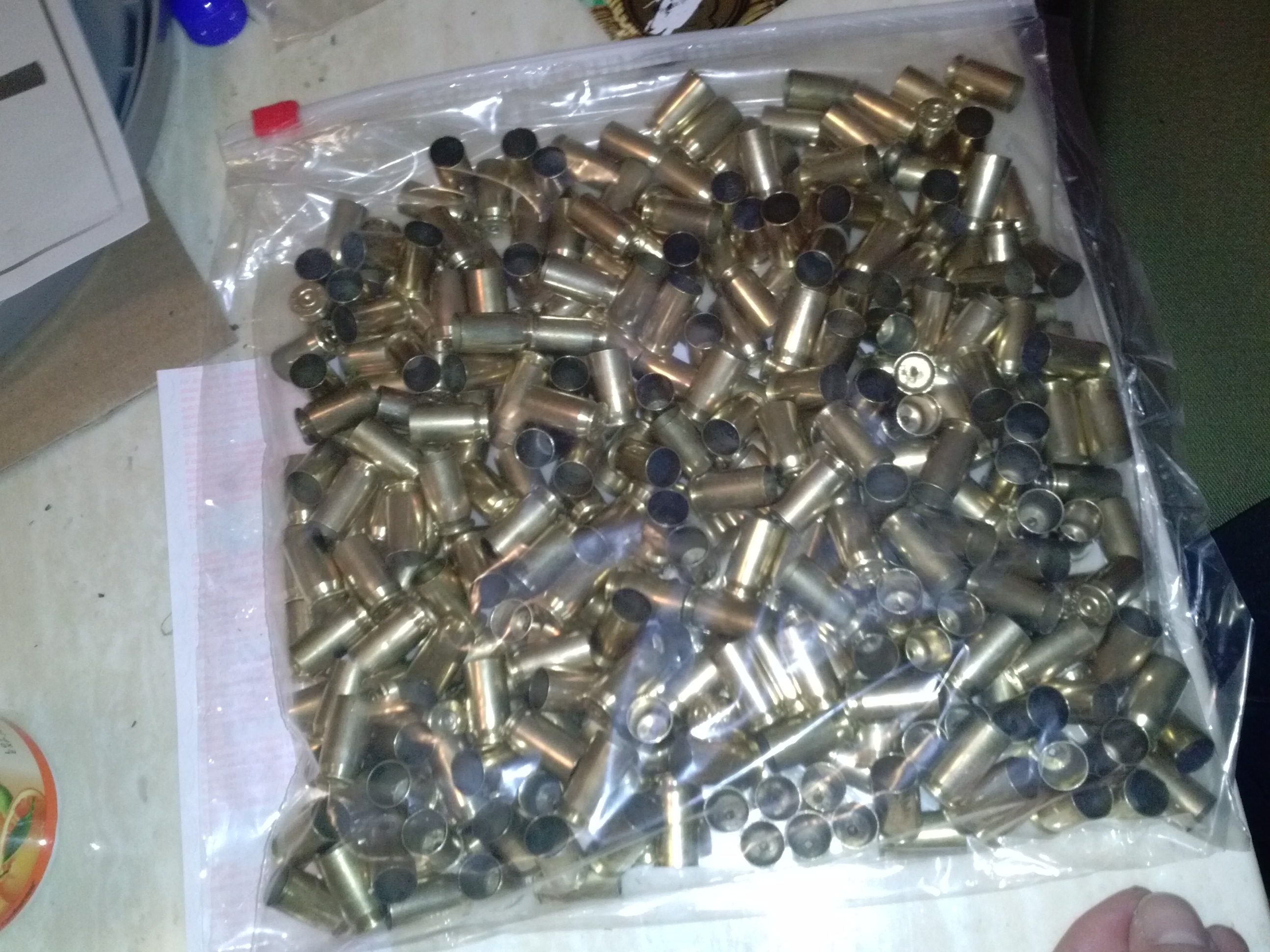

![CAM00511.jpg CAM00511.jpg](https://www.snipershide.com/shooting/data/attachments/12/12167-6dc2a6dc466a40a3e247a27c56f8bfcc.jpg)
