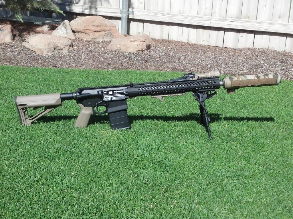

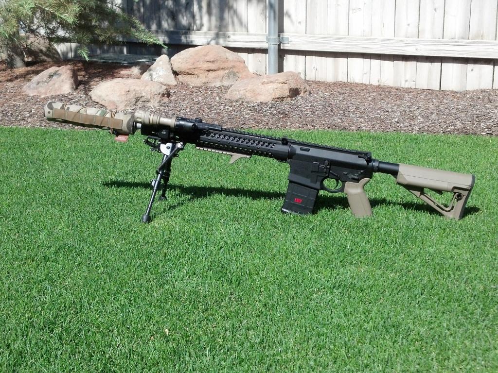

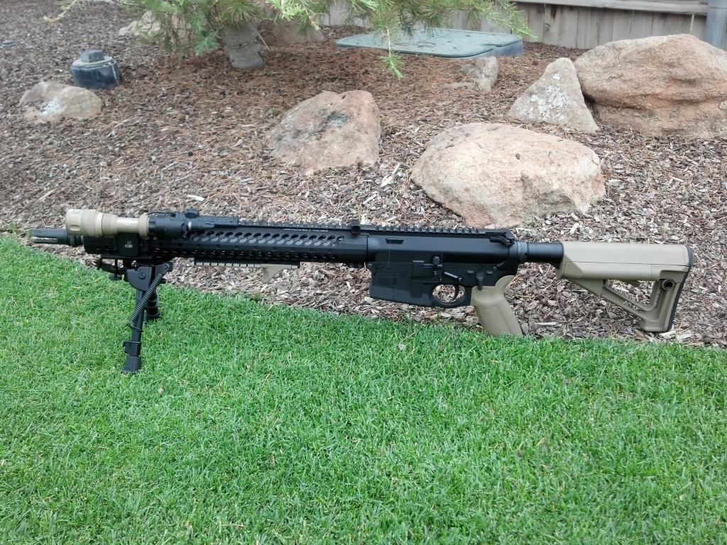

Got mine done for now.
MI rail, Syrac Gen II adjustable gas block.
9.0 lbs as pictured (empty mag)
No more brass to the face except the priv match started after about 60 rounds. FGMM is fine now.
Looks nice! Was that gas block a .750? I'm a bolt gun guy primarily and trying to help my Dad get his GII recon all setup
