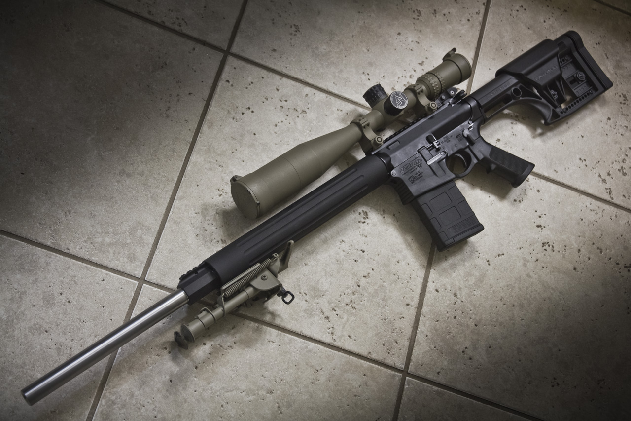

Just got my G2 Bull, weighed in at 10 lbs even, just as advertised. Now sits at 14lbs. Charging the weapon takes some effort and an oversized latch is definitely needed. Trigger isn't bad for a factory offering, but I definitely would like something lighter. The supplied magazine was sloppily put together, with floorplate only slid on half way. The rest of the rifle is much better built, and much nicer than what I have seen of past DPMS. Mine has hardly noticeable upper and lower wiggle. Size wise it feels like it splits the difference between and AR15 and AR10. Its about 2 pounds lighter than my previous 20" barreled AR10NM with the same configuration.
Heading out to the range in the next few days weather permitting, I'll post shooting impressions afterwards.
now that's my kind of rifle! that's one sick stick! kick ass rifle

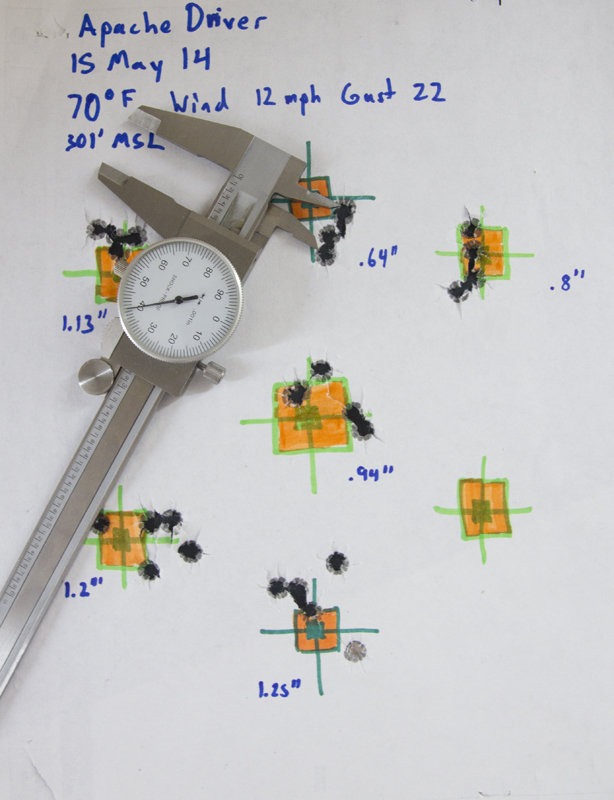

Took the G2 bull out today, but didn't have much time so I only put 50 rounds through to zero and start to break it in. The range here was 100meters. I used 10 rounds of steel cased brown bear to find the paper and getting a basic zero. No issues feeding crappy ammo in it. A 5 round group with it measured at 2.5 inches.
I then switched over to federal GMM 175gr, and got much better results. See attached image. Not as good as I wanted, but I was in a rush and had a crosswind blowing from 12-22mph. Avg was 1.19 MOA. Broken in, on a calmer day with more time to shoot, I can see this easily being a sub MOA shooter.
All brass ejected at 5'oclock and all primers were cratered. Charging was still difficult but showed signs of loosening up. Both Magpul and the DPMS supplied magazine worked without issue. Recoil was milder than expected, and I do not feel the need to put a brake on to make the shooting more pleasant. The LUTH AR stock work magnificently and is hands down a better choice when compared to the PRS in my opinion having used both. The trigger felt better today and I may give it a few more range days before deciding what to do with it. Still needs an oversized changing handle latch, and a new pistol grip for my larger hands. Debating on swapping out for the MI hand guard, since as the factory unit works for its intended purpose. Unless I can realize some decent weight loss from swapping, this one may stay on.

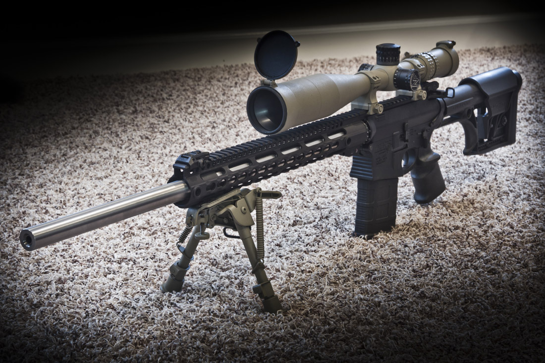

Added a few more mods. A 15" MI keymod rail, Sierra Precision grip, Badger Latch, and BUIS. I'm awaiting a keymod bipod stud to finish it off, its just resting on the harris now. Then I'm blasting the whole thing in FDE.
I got the rifle for $1050 and then subtract the $50 DPMS rebate. Things added up though, and where its at now is $1700 not counting the glass. Making it about $100 cheaper than the low market price on a G2 SASS, but then again the barrel isn't threaded and doesn't have a muzzle device.
The factory free float was a PITA to remove, since I don't have an action block to secure this upper in a vice. I had to come up with a homebrew solution and needed to buy a strap wrench to remove it.

All finished in its final form, another range trip this weekend to rezero, and get the BUIS sighted in.
I'll have to try some basic trigger enhancements, but It's hard to not go with a Geiselle after using them in the past.
