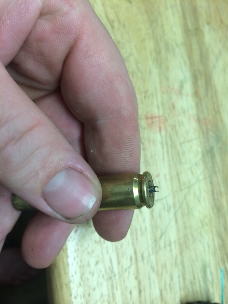

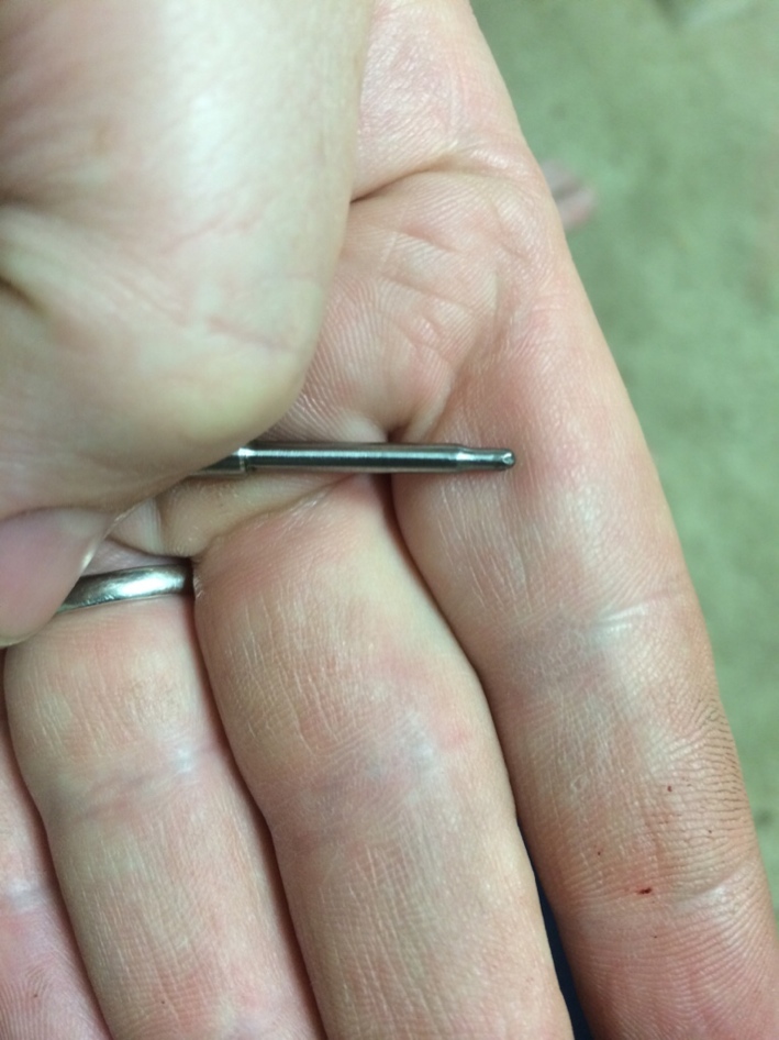

ImageUploadedByTapatalk1409427665.640618.jpgImageUploadedByTapatalk1409427681.138847.jpg
So I had my first run in with DPMS customer service a few weeks ago.
I am still in search of the "Load" for my GII Recon. So I decided to try some 150g Hornady soft points over some BLC-2 that I picked up a year or two ago.
The only data I had at had with that bullet and powder combo was from Lyman. So I started off at the starting load of 45g going in half grain increments to a max of 48g. I lowered my max by one grain because I am using lake city brass.
Well at any rate. My primers started doing this at 46 grains. I double checked my scale and data and every thing was fine. Primers at 45 and 45.5 looked just fine.
I am using lake city brass And primers were CCI LRP (not magnum).
I called up DPMS and told them what happened. They had a come apart. "Did you read the owners manual, you know reloads void your warranty" and on and on. I finally got the guy calmed down and explained to him that I realize reloads void the warranty and that's why I was asking to buy a firing pin and not asking them to give me another. So $40.00 later I have a new firing pin and oddly enough that crater is much smaller than it was before. I wish I had some primers left over to show the comparison but it is much better.
