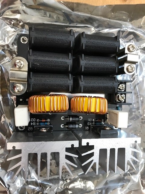

Hi guys,
almost desperate in the meantime as I don't get my annealer to work - any help warmly welcome.
Have received two new ZVS 1000W boards and checked them carefully - used that proceedure and found all ok:
Pete's 1000 Watt 12 to 48 Volt ZVS Induction Heater Troubleshooting Guide
But after putting one into the unit - exactly the same problem: Ventilator in the power supply stops and voltage goes down to around 3V, current around 1,6 A. Without a load the unit delivers 48V and the amp meter also shows 1,6A (why actually without a load?)
No idea any more. Do you think the power supply is broken? I posted earlier that I tried already anoher one with 24 V but that one had only 5A I just noticed - so maybe that test was not representative as to low in power.
The power supply I use is a 750w 48V, have no alternative load to check it. Just tried with one 220V 100W light bulb, that works.(glowing gentle only)
Really lost now...and hoped to have it up and running before x-mas....

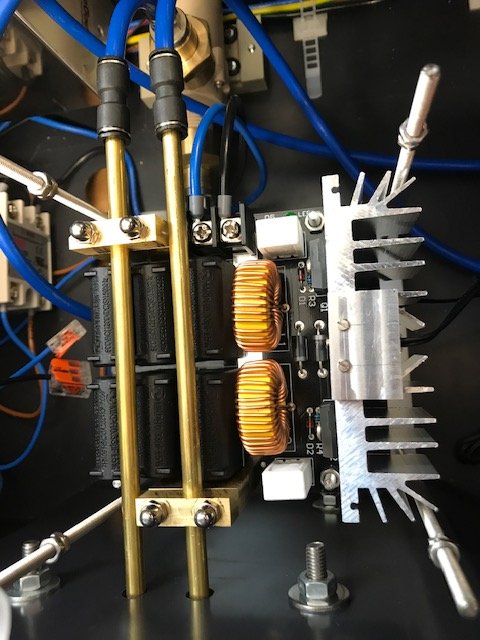

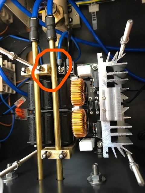

As you can see on the picture I made two more stable connectors between board and could. Used brass for this - so should be all fine. That's actually the only thing I modified beside the coil.
Can the board be tested without the coil or will is destroy the board? That's something I could still do.

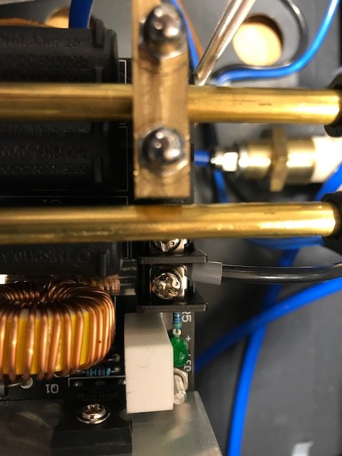

With your wiring, the blue wire is positive and black negative? Is the right hand tube on the coil touching on your new connecter, it looks really close in the photo:
What type of power supply are you using? 1.6A is very low when connected to the ZVS, and very odd the voltage is folding back at such low current. You haven't inadvertently applied a current limit on the output have you? my coil needs about 4-5A @ 42V just to energise an empty coil.
Thanks for all your patience with me.
Finally I found the reason! Now it is clear but I never thought about it before. On the photos you can see that I build a little aluminium block holding the thermo element I put in to be able to see the temperature of the Mosfet cooler. Well, that alone is maybe a good idea but not fixing the block to both Mosfet coolers!!! That was the short I couldn't find.
Now it is heating the brass in seconds - great!

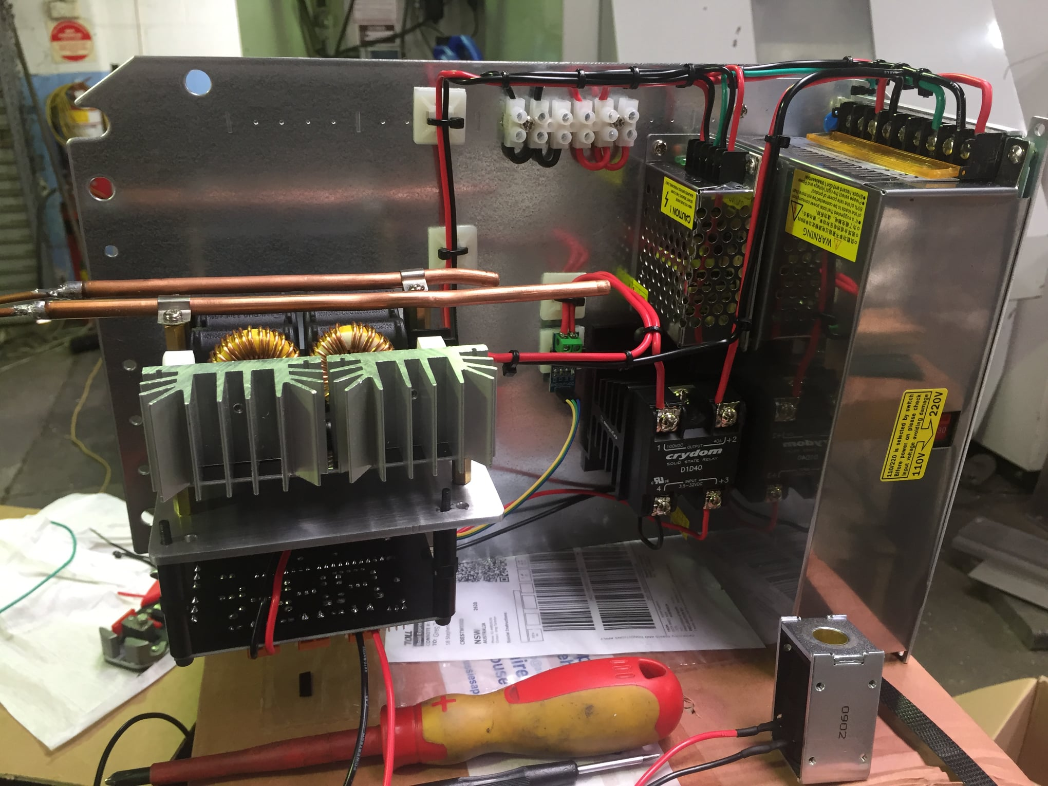

I've got my new annealer just about sorted, I'm just waiting on a closed loop stepper to arrive for the case feeder. It really cranks the cases through! Heating is amazingly well controlled, have a look at the Tempilaq on the cases at the end of the video.
Impressive setup!! Looks & works fantastic
Can you share more about the case feeder and your coil winding?

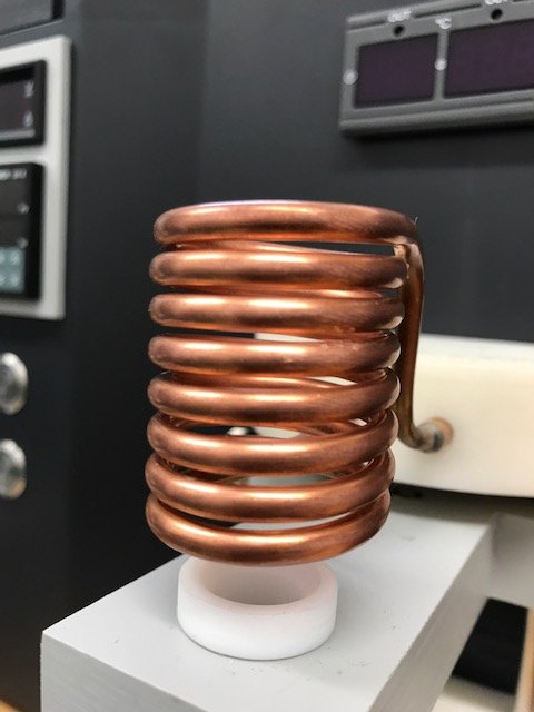

The case feeder is a work in progress, I've had it going but wanted to run it off the arduino as well so it's got feedback of its position. Most of it is 3d printed currently, this is about the 5th prototype. Another week or 2 and I'll give a full rundown.
The coil is 3mm copper tube, The first one was 7 1/2 coils around a 28mm mandrel. This one is still 7 1/2 but double wound to make it shorter. I slid the insulation on first then wound the first few coils around a mandrel and the outer ones around the inner then opened them up a little so they weren't touching. It works much better with short cases like the BR.
The coil has coolant pumped through to cool it and a little radiator at the rear of the machine. It uses one of the ZVS boards, a solid state relay and a 48v 1000W power supply controlled by an MGNZ Arduino control board.

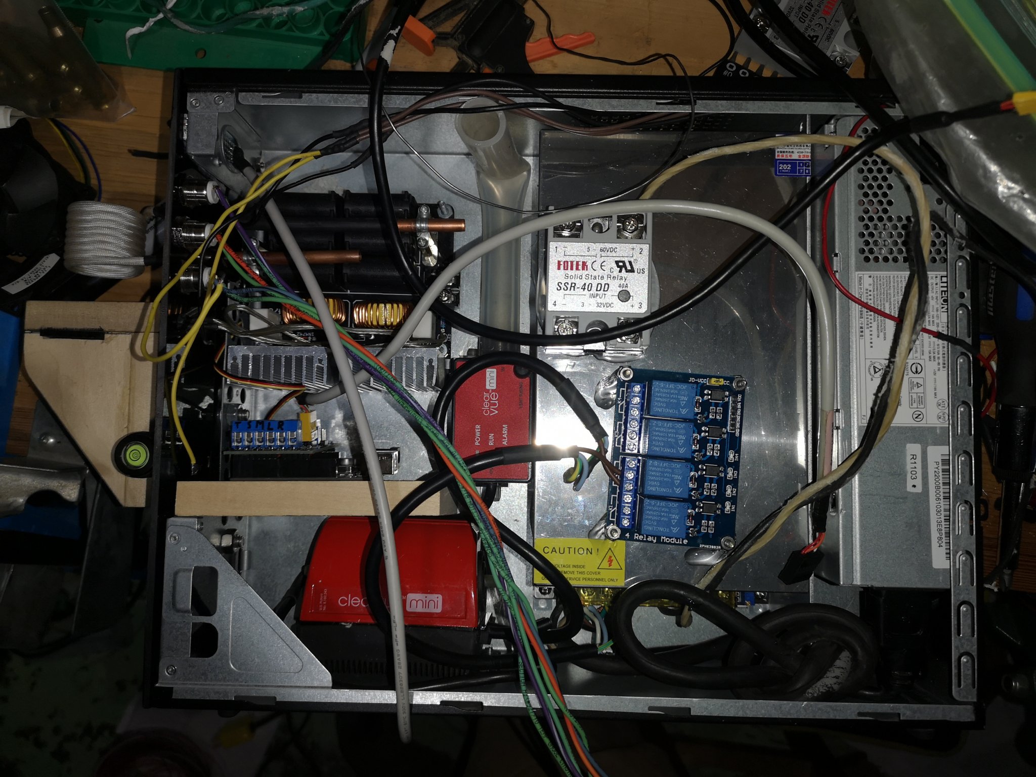

I found this thread after I'd decided that I wanted to try building an induction annealer and signed up for the forum so I could see the pictures people have posted. I was about halfway through figuring out the program for a really simple Arduino run annealed when I saw MGNZ's excellent writeup and shamelessly decided that was probably the way to go. I had an old computer that I decided to gut and use the case as well as the power supply, and I've got it nearly done now. I have a seperate 42v 1200w supply running the zvs board, so the PC supply is only used for powering the Arduino and cooling fans. A bit overkill, but it was there. I ran most of it on the bench to make sure it would actually work before mounting anything in the computer case, hopefully I don't run into any cooling issues once it's all enclosed. I still have to mount the Arduino board and the radiator, plus a little more wiring, but I'm hoping I'll be able to get it running this weekend.
Kristian
Reactions: JBarton
Kristian
Very nice. I will say that if you are automating and running many cases with that RC servo drop (love it by the way) you will really want to consider water cooling the coil quickly. Fans towards the heatsinks will also help you out. These parts do get warm when doing many cases in mine.
Thanks. Yes, water cooling the coil is in the plan, I just don't have the radiator or fan mounted in the picture yet. I'm going to put the radiator and fan pulling air out the side of the case near the heatsinks of the zvs board, and if that doesn't give enough air flow I'll add a second fan pulling cool air from the top of the case down across the board and towards the radiator.
Kristian
As much as I wanted to get everything in the old computer case I've got, I don't think it's going to happen. It all fits, but there seems to be too much electrical interference from the power supplies and the zvs board being right beside the Arduino. I tried running it all in the case, and it keeps having weird glitches, which don't happen when I've got the power disconnected from the zvs board. I also managed to cook my solid state relay, so I think I'm going to have to build a box of some sort that won't be quite as crowded. Back to the drawing board I guess.
Kristian
Kristian
In mine I have the Arduino mounted directly below the ZVS board and it hasn't been an issue. There is a 3mm aluminium shelf between the two though which might have made a difference. Are you sure you don't have a fault on the board? A short might be what killed your relay?
