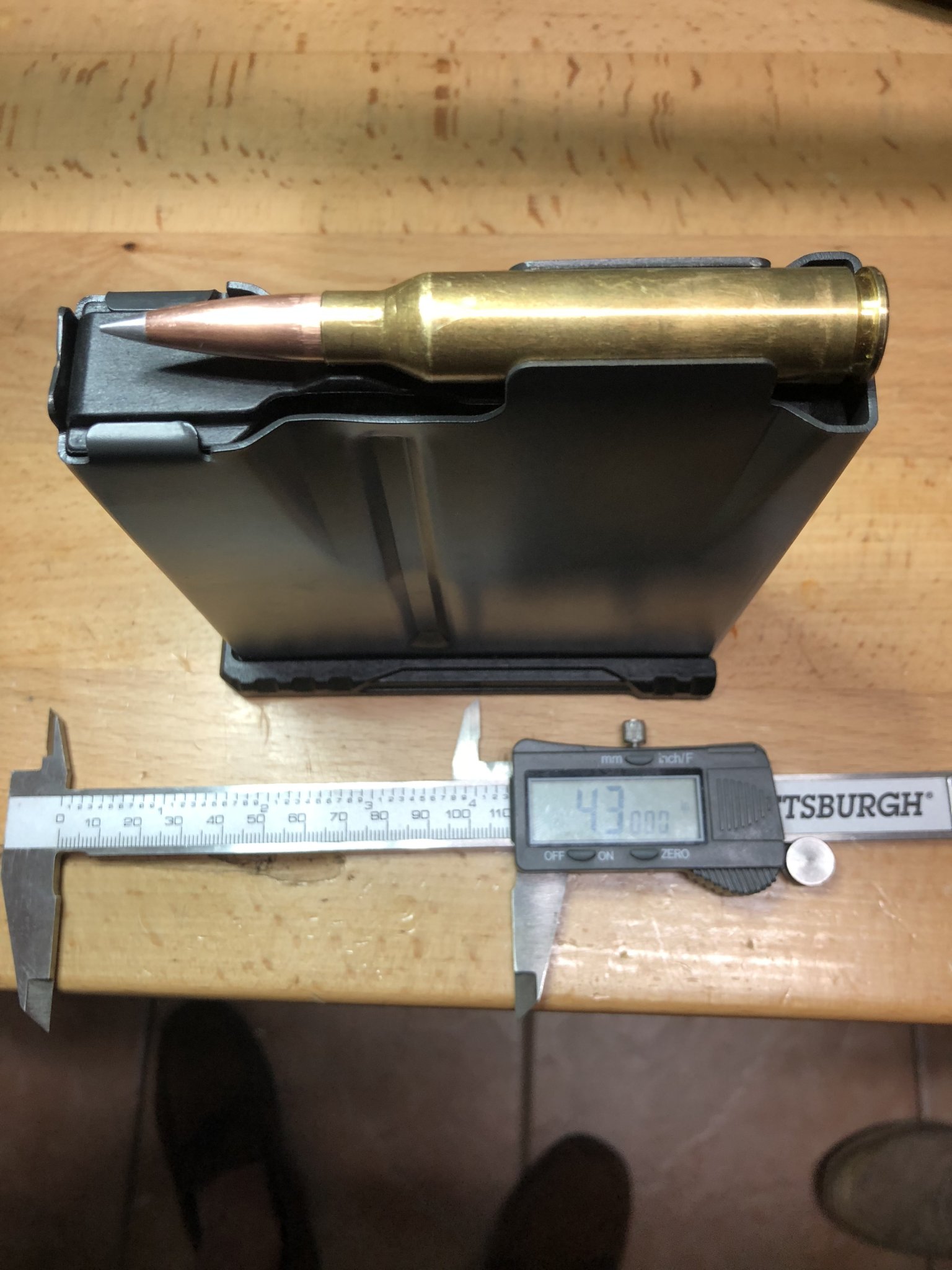

    I have 1 Bullet that I was able to talk them out of at Shot Show. I will see if my 375 dies need to modify the seating stem

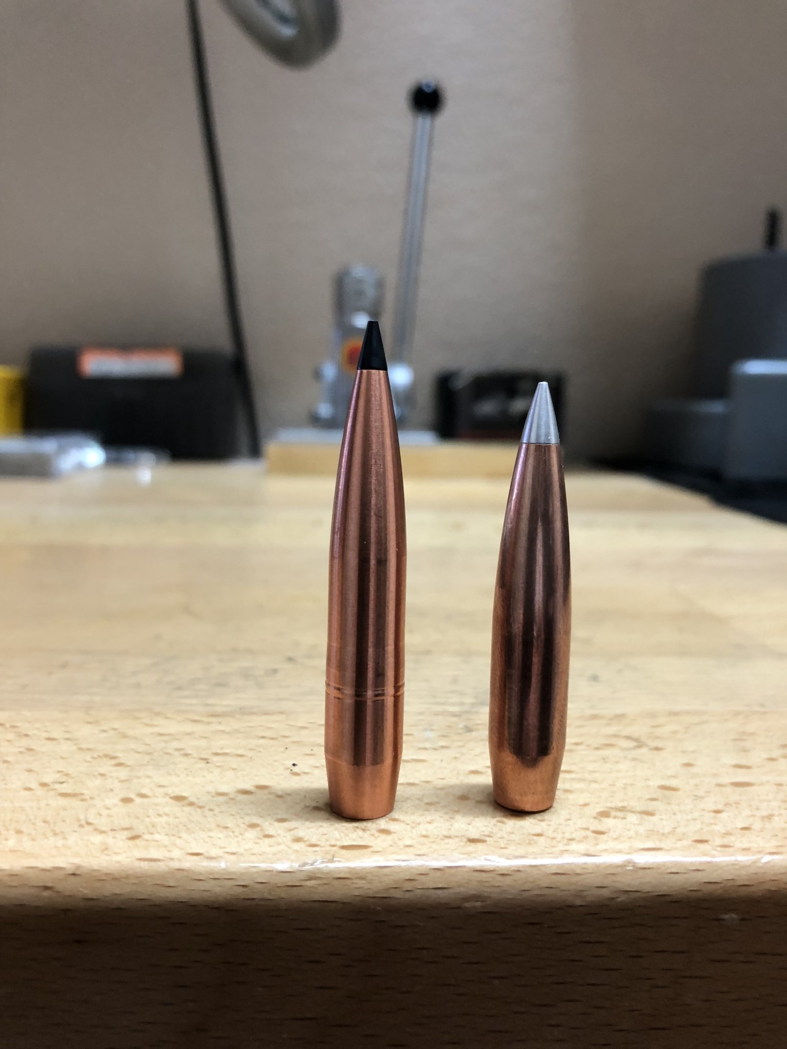

    Here is what they look like next to a Cutting Edge 400 Lazer
    Any idea on freebore requirements for these would a .250 37XC reamer be ok?
    Lead denser so they’re shorter which explains their stability in 12 twist

    Plenty of room to spare. You can chase
