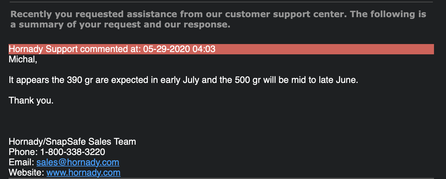

They're not new lol, they were announced almost a year ago. I'm a big fan of hornady but they really need to stop hyping up stuff that they can't deliver right away. I have 2000 on back order with them between the 390s and 500s for my ELR teams.
Thats the latest from Hornady on the A-Tips, they're coming up on a full year since they announced them.

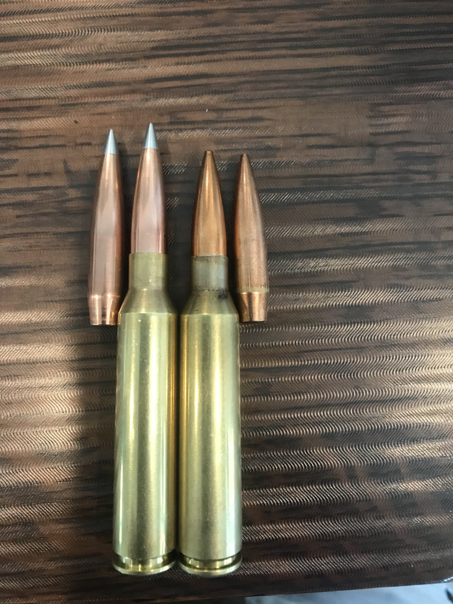

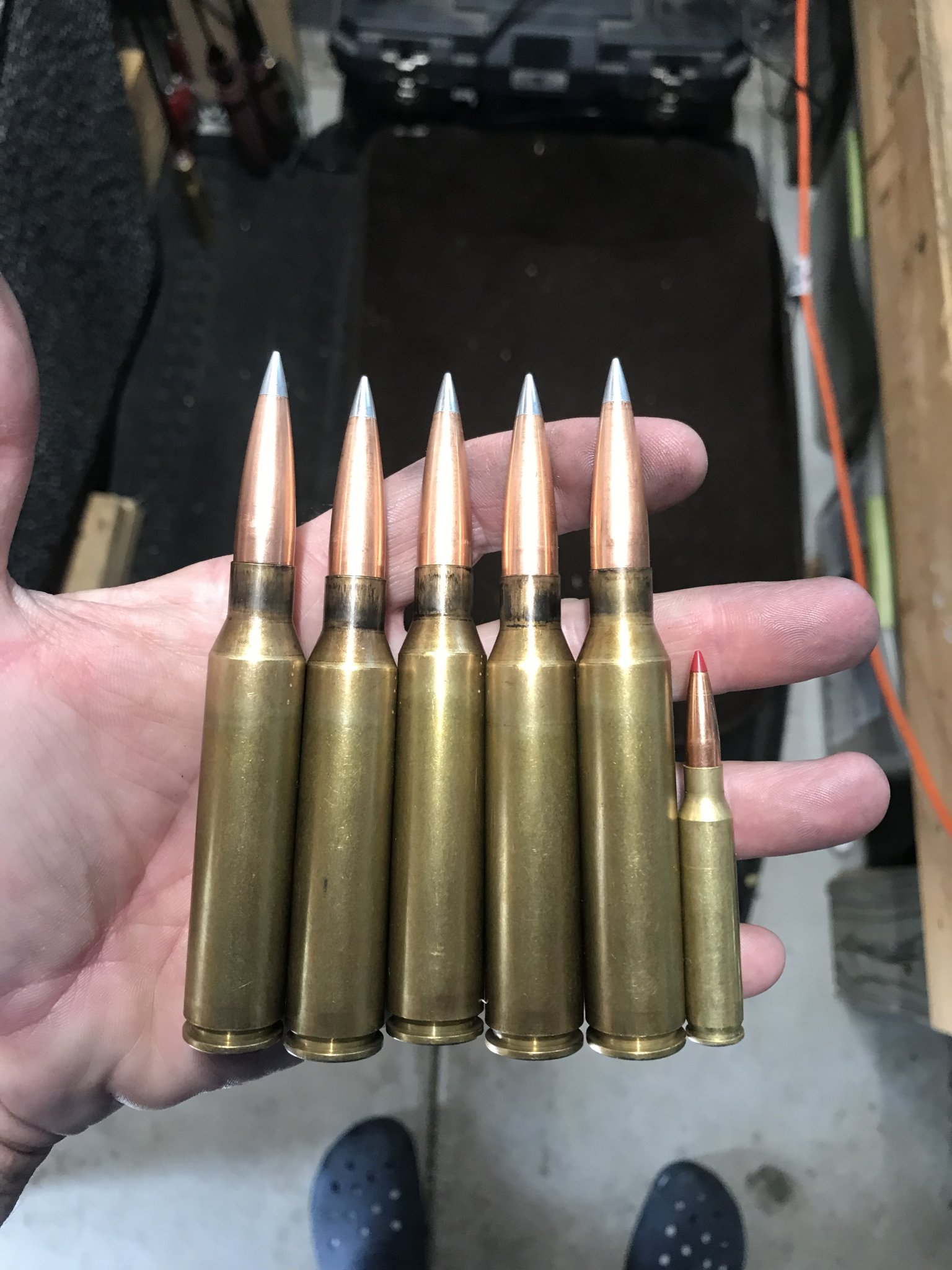

Loaded up 15 tonight, at 124, 126, & 128 grains n570 in Jamison brass (intentional weak link) with federal 215M, COAL 4.350. That’s based on QL and assuming some things aiming for same pressure as my SMK load which is 132 grains n570 at just below 3200 fps in a 35” Lilja tube. Stay tuned for results in the next few days.
You stated Jamison brass not Bertram.
Yes and I stated I’m intentionally using Jamison as the “weak link” so I detect pressure sooner during load development, something a famous rifle builder (blanking on name now maybe Ackley) has recommended online that I once read in the past.
You can see pressure on bertram sooner than Jamison by looking for ejector marks. Bertram show that way before the others do. Jamison loses pockets before showing ejector marks

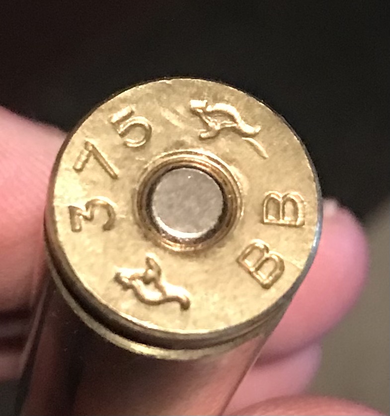

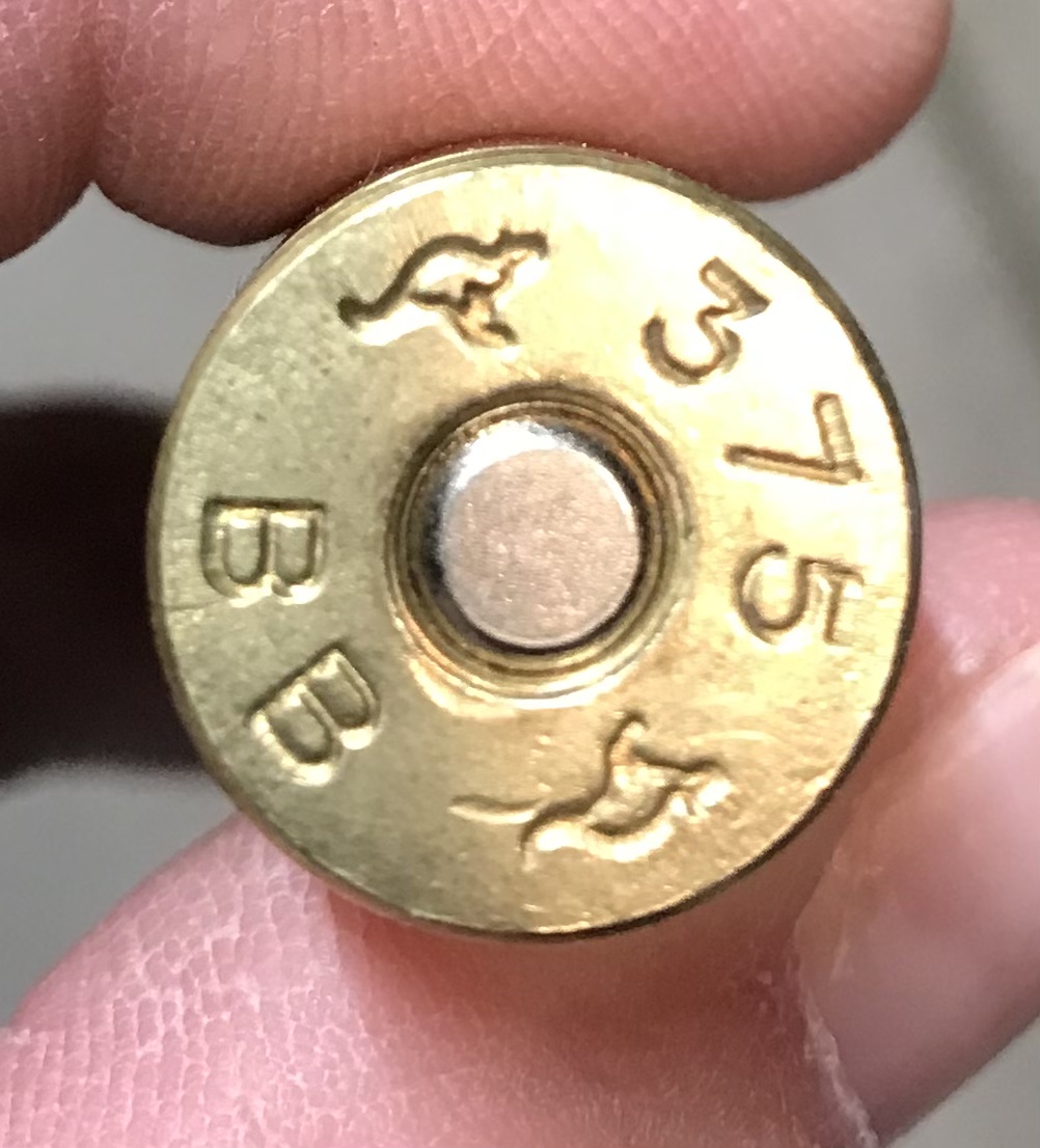

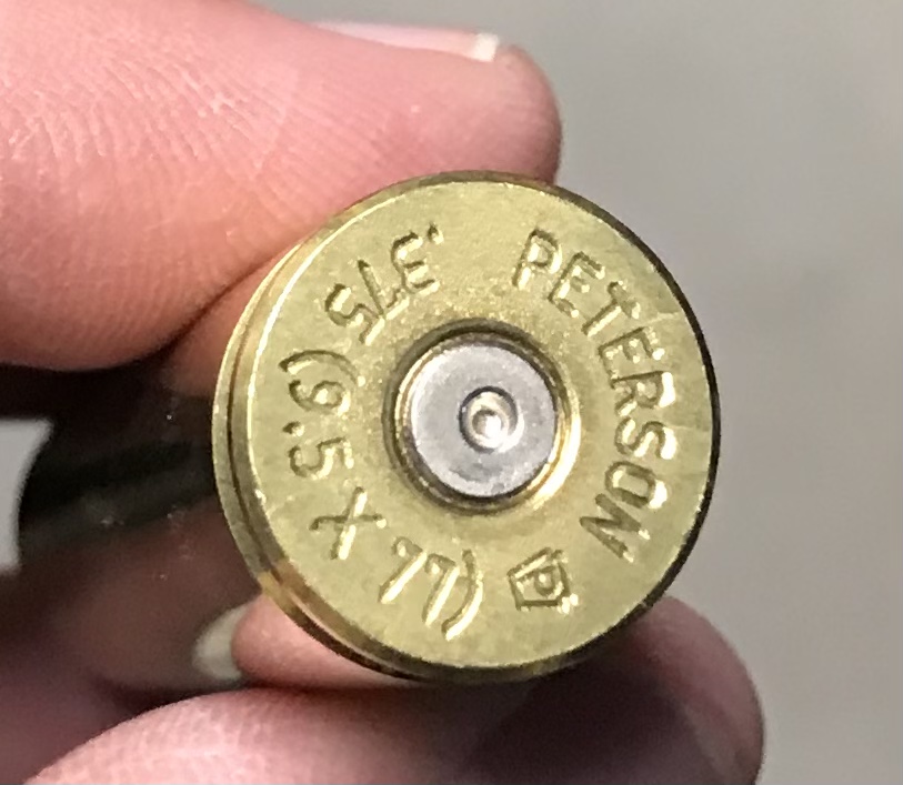

My brass stands testament for all to see. It is a max load no doubt. But I have shot over 3000 rounds of 375CT since 2013 in >6 different barrels (DT, Lilja, Bartlein, K&P), and have been reloading for over 30 years and have generally been - as a review of my posts over the years has clearly shown - a cautious pressure guy who gives a bias towards brass life. The pictured brass is 4+ fired. All can judge for themselves, and exercise their own independent caution as is always warranted.
