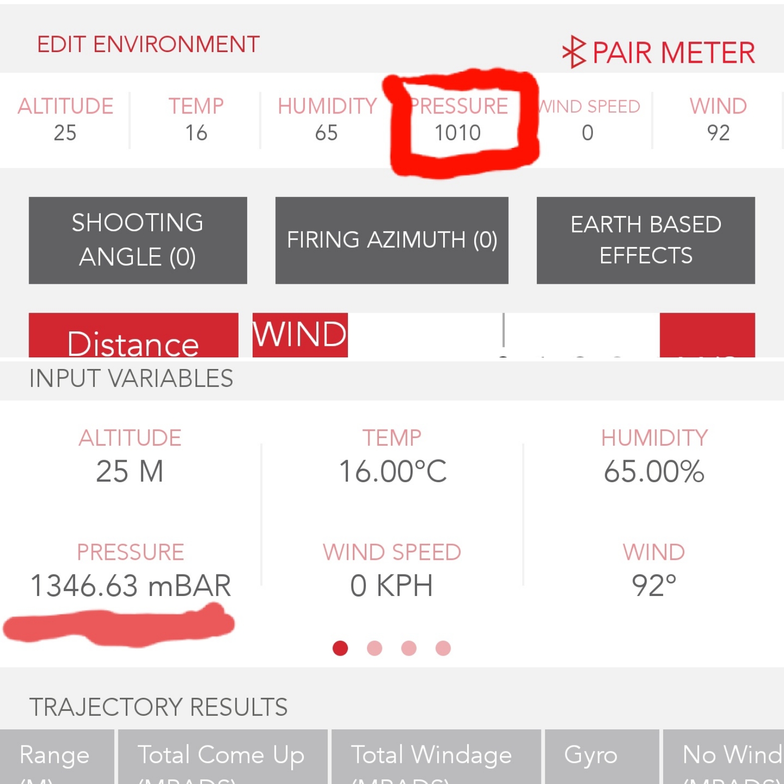

I'm a bit confused. Press unit mbar, vallue 1010mbar. Hud displays/calculated it properly but table shows 1346.64mbar.
If that is yhe case tavle view is pretty useless 😕.

Could be corrected pressure.
I just tried my app and changed pressure is changing come up.
With all the respect corrected to what? If my input is station pressure what it should be corrected? On the other side 1346mb is so high pressure that can not be taken in any kind of ad calculations...

    The last update fixed the pressure issue but turned my 4mph gun into a 7 mph gun without changing anything. Check your wind drift guys
    Anybody else has the same issue?
    Thanks

    Ok... last update on the topic.
    I had so unpleasant email thread with Hornady that in nutshell do not care about roll out of application update that will fix obvious software bug. Moreover they do not want to talk about that any more. For all of you having issue with pressure and/or wind drift ..... feel free to live with it or jump to something that works (in the meantime I found some more bugs in calculator).... for me it is a game over.... and something interesting is on horizon.
    Pitty, it was promising ..... and just promising.
