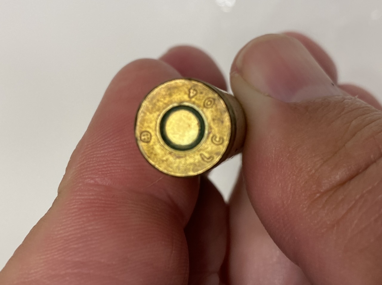

The thing that scares me is, I can't figure out whether the rounds I had in my possession were rejects or standard USGI.
Just 30 years prior, that was the same designation for the ammo I was depending on for my life.
The project was intended as a basis for an article in Precision Shooter. I just plain gave it up, I was so convinced nobody would believe it, and I was at a loss to draw any conclusions about what it all actually meant.
Like you, at the time; I decided that I simply had a batch of what should have been rejects,.

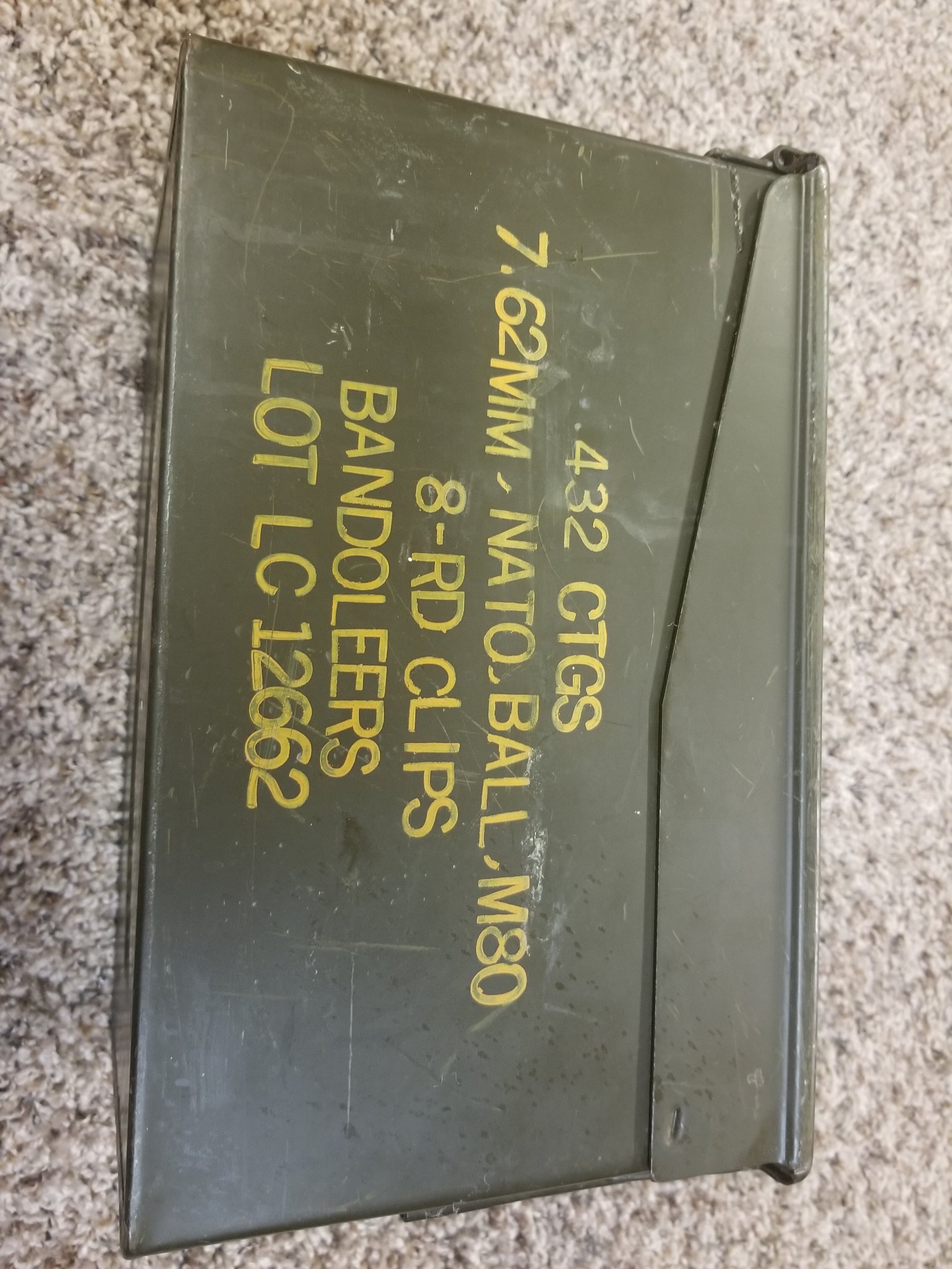

I have a bit of LC66 in Garand enblocs that was issued to Navy Rifle Team shooters in the late 60s and early 70s as it had shown exceptional (moa or better) accuracy at 200/300 out of the Navy Mk2-1 match rifles.

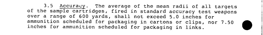

This is from MIL-C-46931F (29 March 1991) for M80 7.62mm NATO Ball ammunition:
So boxed and clipped ammo (for M1, M14, and other rifles) has a slightly tighter accuracy standard than belted (for machineguns and miniguns), but is still no great shakes (roughly ~ 10 inch groups at 600 for rifle ammo, ~ 15 inches / 2.5 MOA+ for machinegun ammo -- out of cherry-picked/controlled test barrels).
M80 Ball (Overhead Fire Application) was spec'ed to a tighter standard, as soldiers were crawling under barbed wire and obstacles with machineguns firing overhead. Uncalled fliers bad.

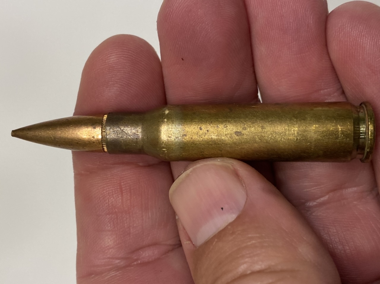

I loaded a couple of mags with Milsurp M80 Ball. Legit stuff, not factory seconds. Seated, with a bag, It was all I could do to get 2-3 consecutive rounds within 3 inches of each other. I haven’t tried to put any match ammo through this rifle yet, but dayum!
Is M80 really THIS bad?!
I ain’t no ELR deity, but I thought I was better than this.

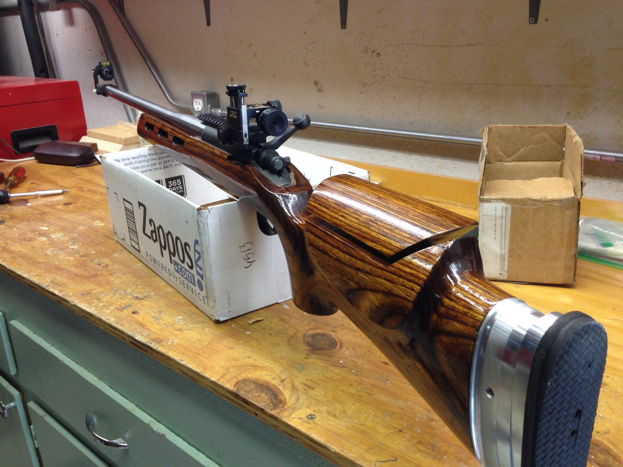

And the Radway Green ammo they issued was quite good shooting and normally did best with .299" bore and .307 groove barrels.

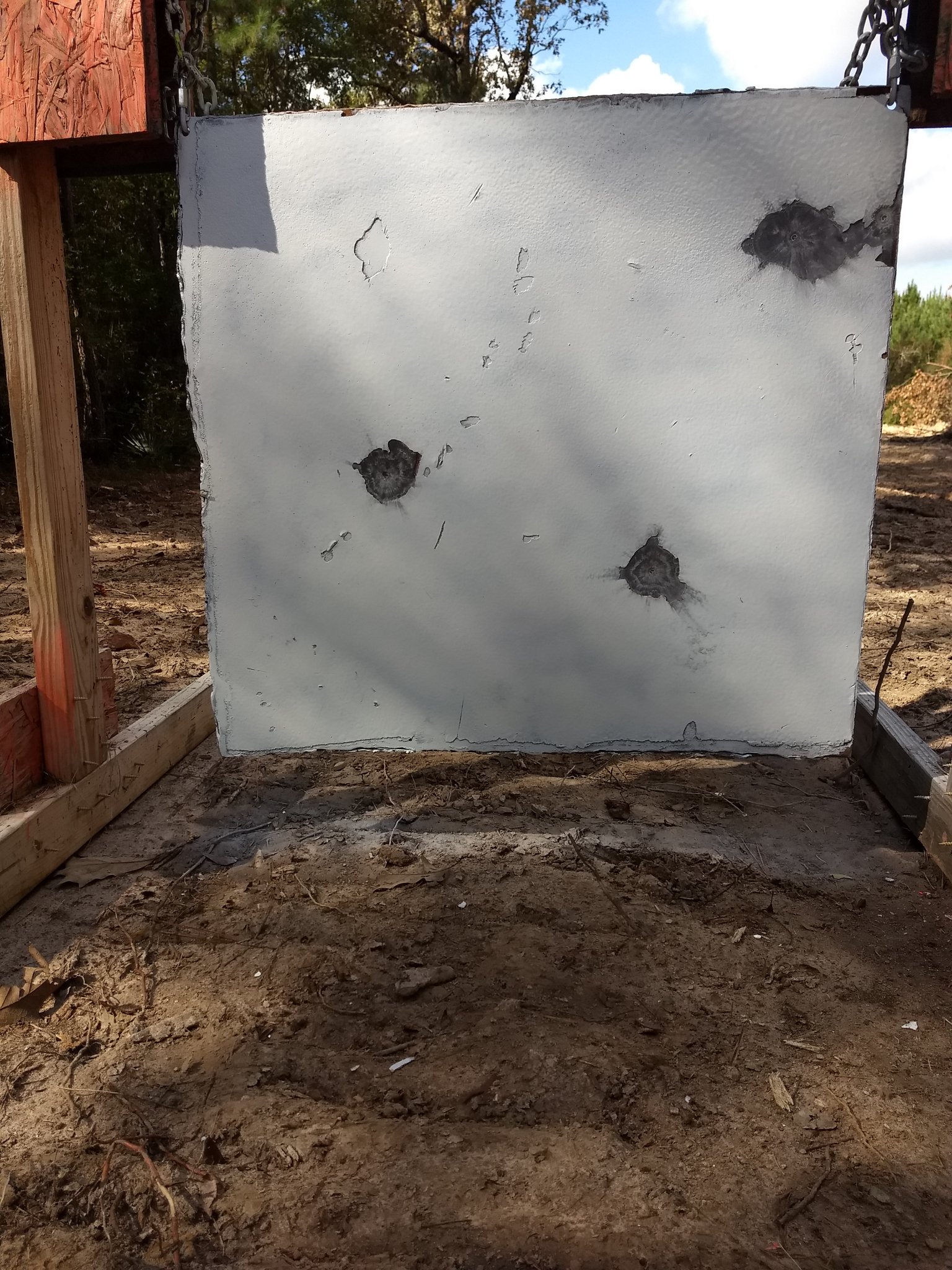

Yep. And, with good M80, I can hit this 34" square one at 850 yards.
