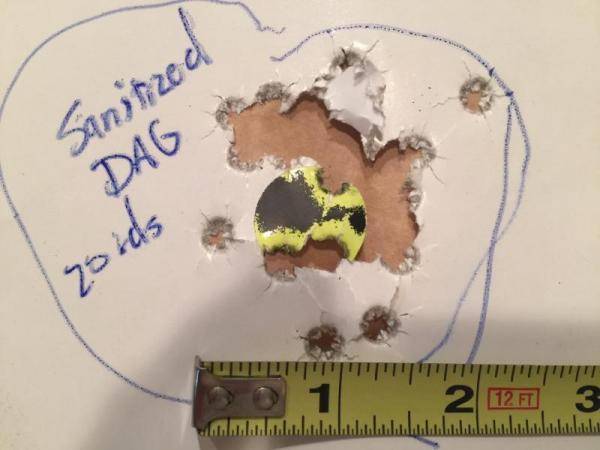

Is it me, or is M80 Ball horribly inaccurate?!
The "sanitized" DAG surplus is a great load out of my OEM PSA / DC Machine SS 18" barrel.
Not every surplus I tried shot as well ( shocking , right ? ).. the Hirtenberger '83 also did well.
The GGG 2003 ball ammo was very close to equaling FGMM 168gr group size. ( Sadly GGG altered the powder, and charge weights on the 2008 ? ball loads. )
While this era doesn't have as much readily available 308 surplus, a earlier era allowed shooters to find a surplus their barrel liked.
20rds , rapid'ish fire, 100yrds ,off the bench, scoped, bagged.. all the usual stuff.
What is sanitized DAG ammo?
I shot German DAG from several rifles and it shot very well. Easily 1moa on most days. My only concern was the cupronickel jacket being hard on rifling.
