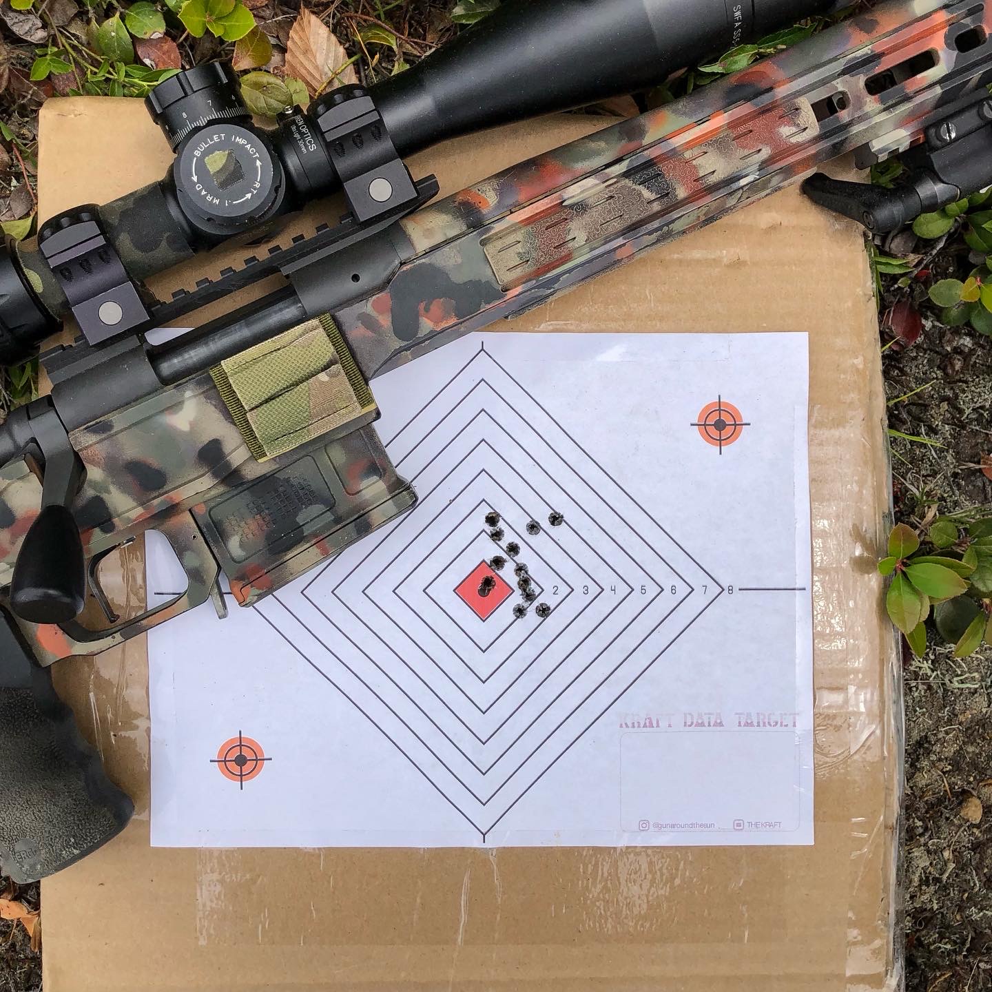

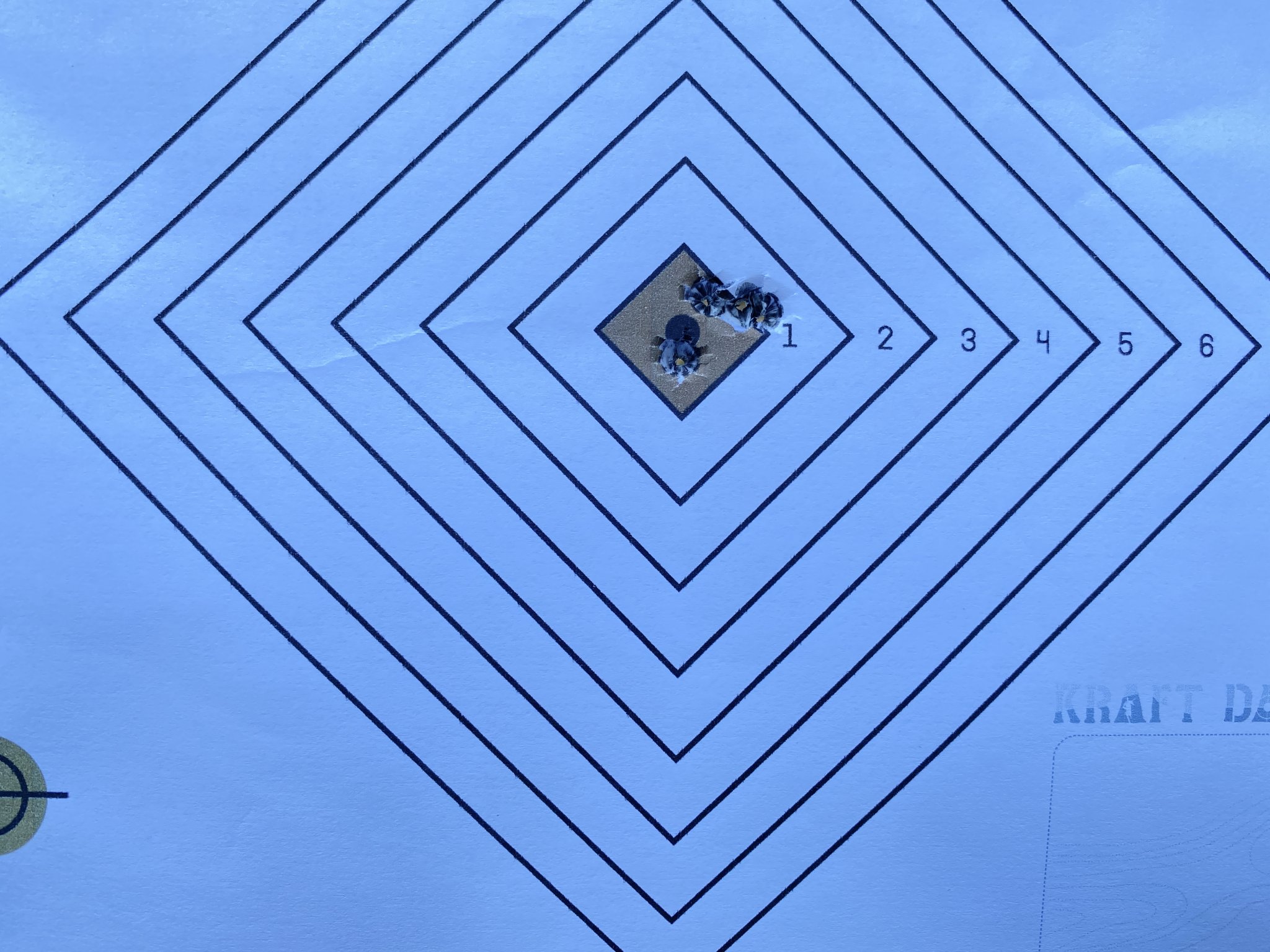

6.5 CM - hunter 16lb rifle - NF NX8 4-32 (light for hunter class)
Impact action and barrel - 2750 rds (still tight groups)
Treated it like a match with generous time - steady movement between positions, but build a position and shoot, not going slow to find premium stability.
Learned - rushed my first two kneeling and standing shots - 1/2 second more patience to settle position and rifle vastly improved consistency - DUH. My problem in real matches too, lol.
Fun stuff - thanks for putting this out there!View attachment 7562130View attachment 7562131View attachment 7562136

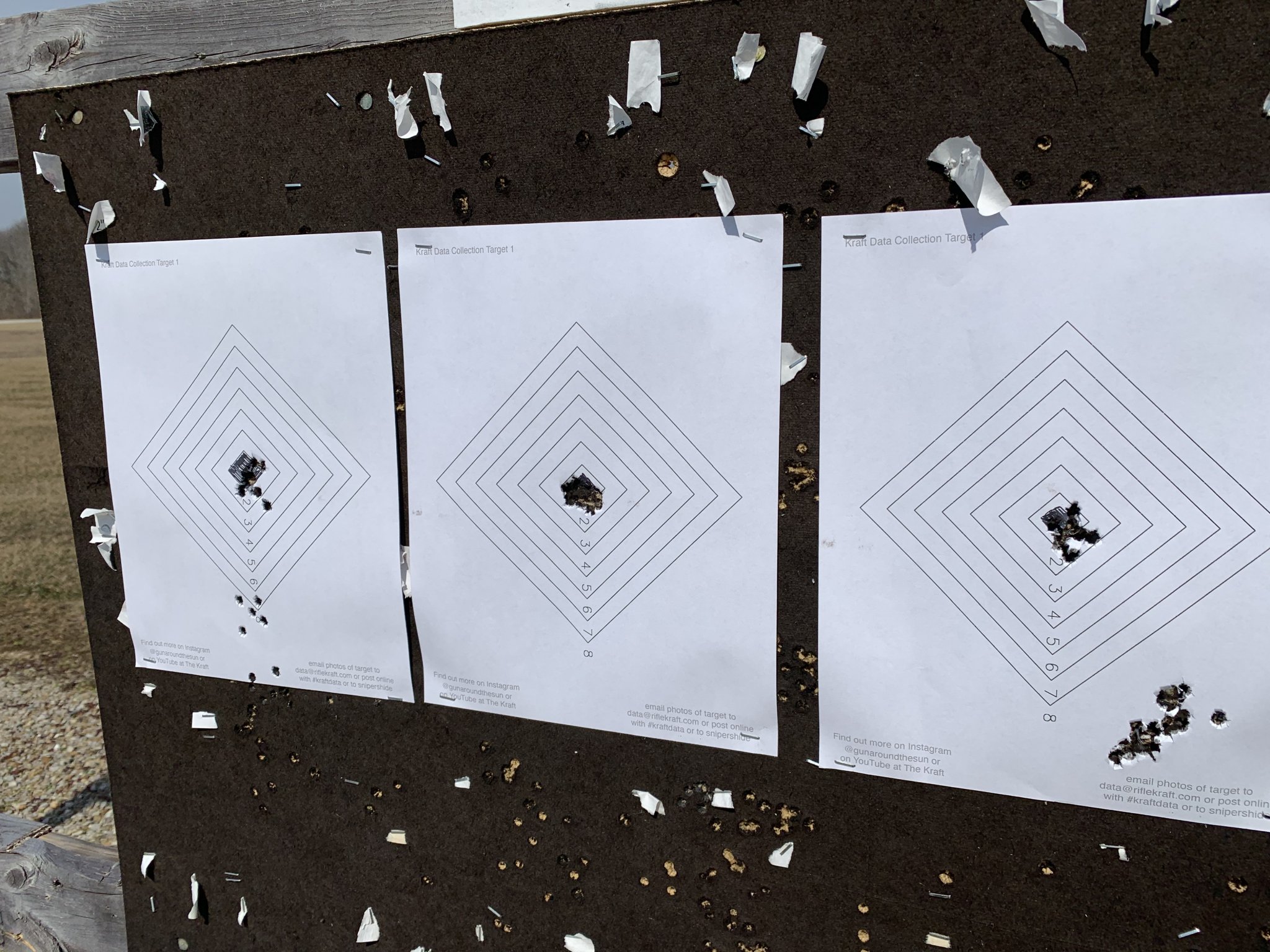

So let me start by saying that I didn't perform the Kraft test as outlined. I did a similar drill I've been doing for years. Especially with the old 308s and my hunting magnums so I could see where and more importantly why I was getting offsets. Blaine Fields who brought us FFS, one of the early ultra-robust programs was my inspiration as years ago we where discussing the positional offset feature in his program. Truth be told, many of us used to load hard into the bipod, later push hard into the barricade, or strap up our tripods and when the bags came along, most of us saw a large offset between these heavily driven positions and the gun lightly loaded on a bag. Of course, no time later the calibers came down and the gun weights skyrocketed; so it became much easier to "balance" the load between bipod and the bag.

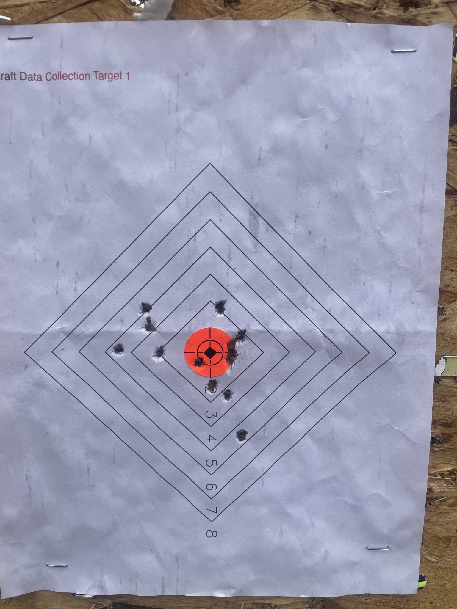

Here are 20 rounds of Berger Factory 6CM Ammo shot. Again, not exactly like the Kraft format, but same basic idea. I used 1 bag a schedium on top of an Able Table for support ( a bit less stable than a solid barricade position) for the non- prone shots.
  • 1st group 5 shots middle "shoot-n-see" the best prone I could using the schedium as a rear bag
  • 2nd group 5 shots lower "shoot-n-see", kneeling on a bag/able table, top of tripod slow. You can see that just like the standing 1-2 shots pulled low, I have a low string, which probably has to do with trigger press (rushing).
  • 3rd group 5 shots upper "shoot-n-see", Standing on a bag/able table, top of tripod slow. Because there were not too many shots on the target when I rush the trigger on the third shot, I knew it was bad. I could easily see the problem, more importantly, I can see the trend is to push slightly right.
  • 4th Group 5 shots, like a dot drill -.1mil adjusted: The individual shots on the left side were fast prone, going as quickly as I felt I could as if I was on a stage.
No way could I have seen the trends and mentioned above if I used a single target. I would not have known that I am getting a bit of vertical stringing kneeling from the lighter loaded rifle or a bit of right pushing (shooting left-handed) standing etc.
Now here below is everything overlaid as if I shot them all (other than the dot drill) on the same POA.
tape for reference
My only point for posting is to get us to think about the value of using multiple targets on the same paper. If you can't shoot medium-sized groups maybe it should be multiple papers. Either way, breaking up your positions has a lot of value; that said you have to be honest with yourself and use the aggregate of all the groups like the single Kraft target to get an idea of what your total group size is.
Food for thought on round 2 of the Kraft project :)

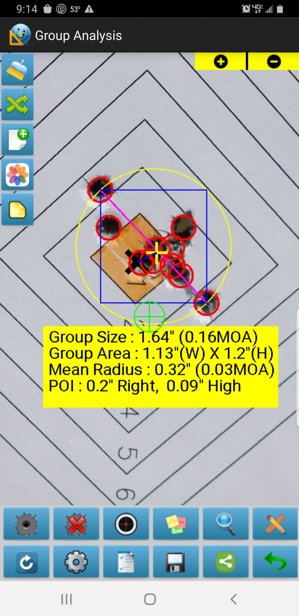

For it to be .16moa it would need to be 1000 yards.
Oh I see, didn't even notice that. Yeah, APP was set for 1000 yds - not sure how that happened since I never touch the setting. I just saw the group size of 1.64 inches and go with 1.6MOA - didn't even note the parenthesis next to it. Thanks for the catch, fixed the app settings.

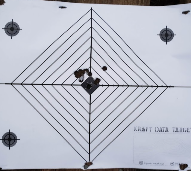

DT SRS .308 155 SMK surpressed.
Apart from zero issue and 2 bad positions I think it is a good training tool.

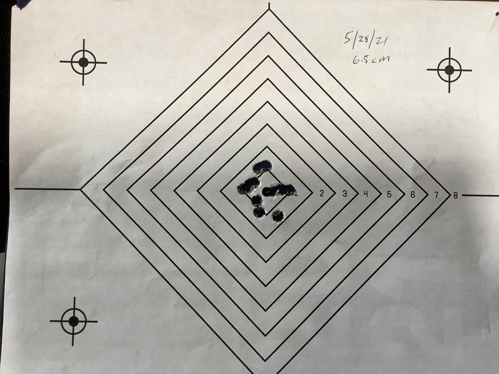

Still been hitting this hard when I go to the range for practice.
spun a new barrel on and took the opportunity breaking it in to fireform some brass and get some practice in.
Easily my best and most consistent groups ever.

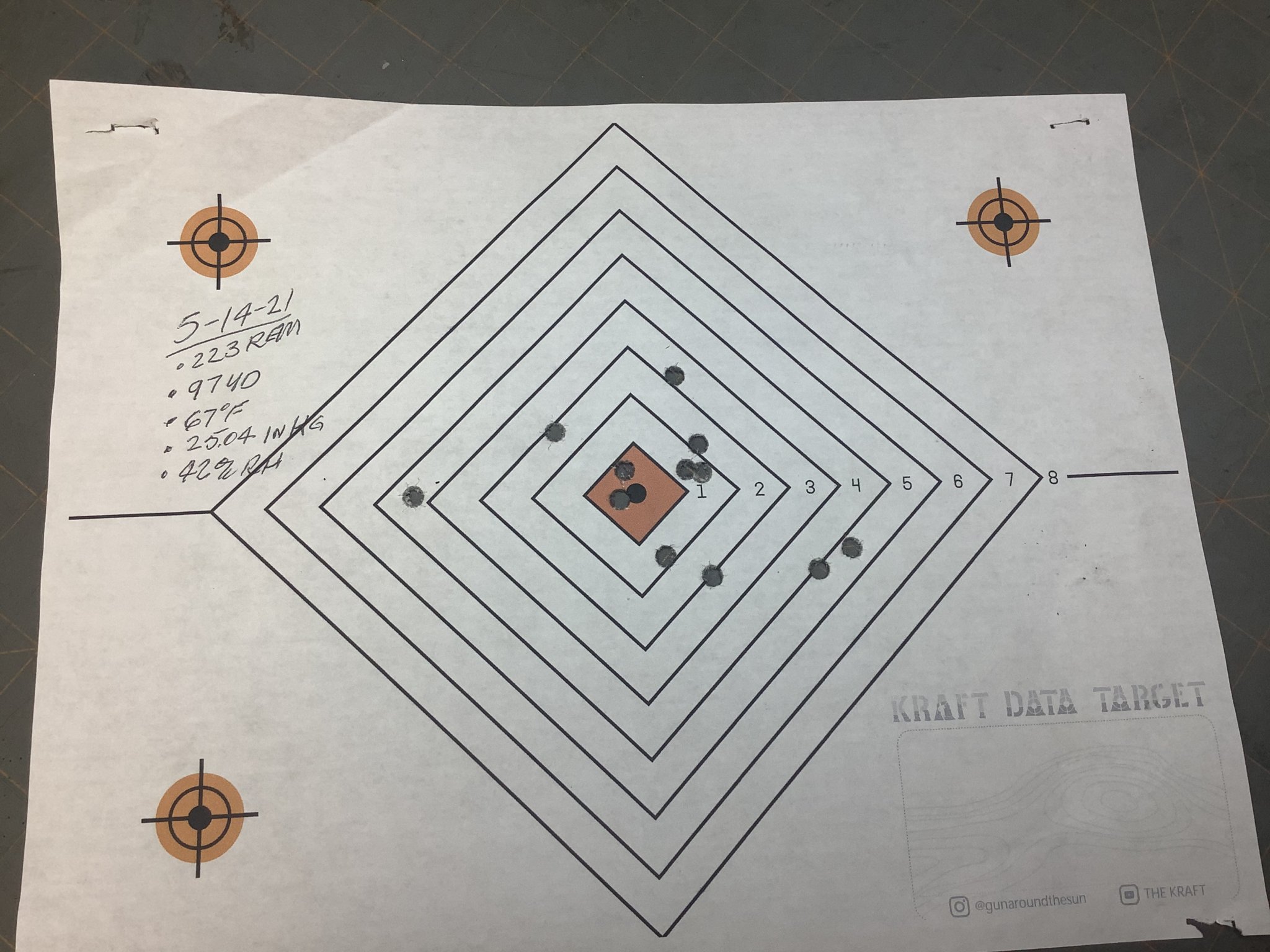

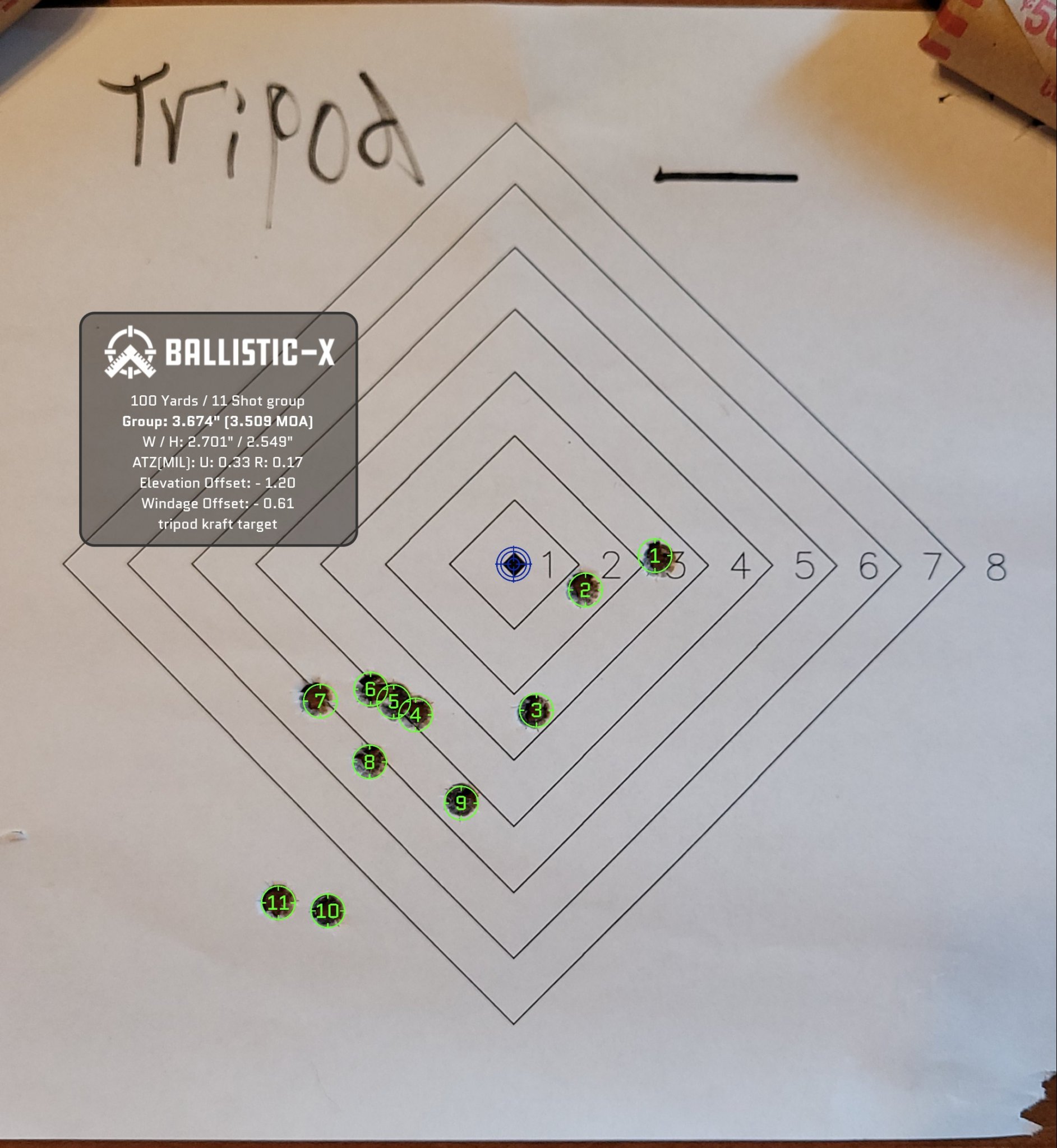

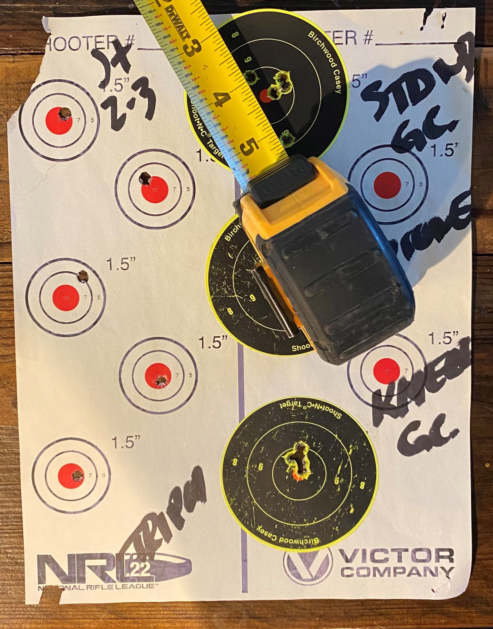

1st time trying the Kraft challenge
1st time using a gamechanger
1st time shooting positional, (been dry firing but normally prone or bench)
Step ladder, pint size gamechanger.
Again, no. If you manage recoil consistently across positions, your POI is going to be the same (minus your wobble). The horizontal you are talking about is the wobble. And pretty much any vertical as well.
You see a POI shift when you drive the rifle differently.

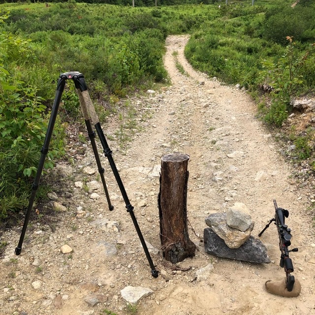

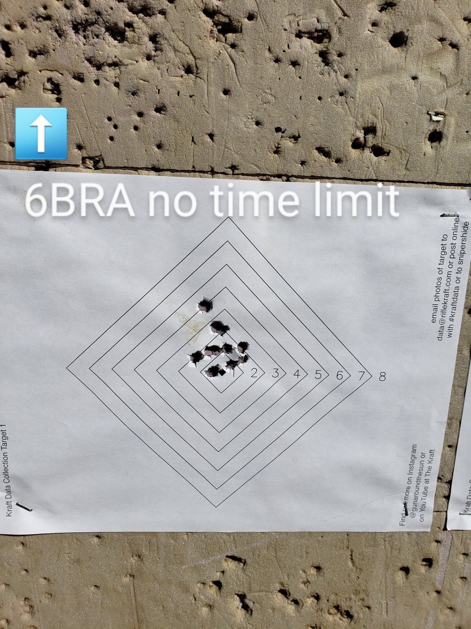

Most recent effort. MFC laid on top of a tripod for support. 6BRA. Took my sweet ass time and still managed to shank one of the seated shots.

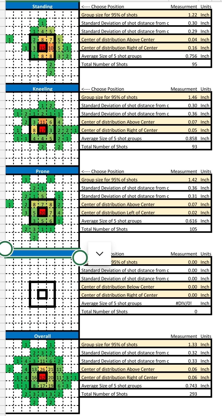

That Idea was scrapped for the long range data collection as it was to clumsy and I went for something else but I still use it for close range dot drills.
I then enter into a spreadsheet and create this. I have slicers setup so I can only pull a specific rifle or weather wind condition etc. Etc.

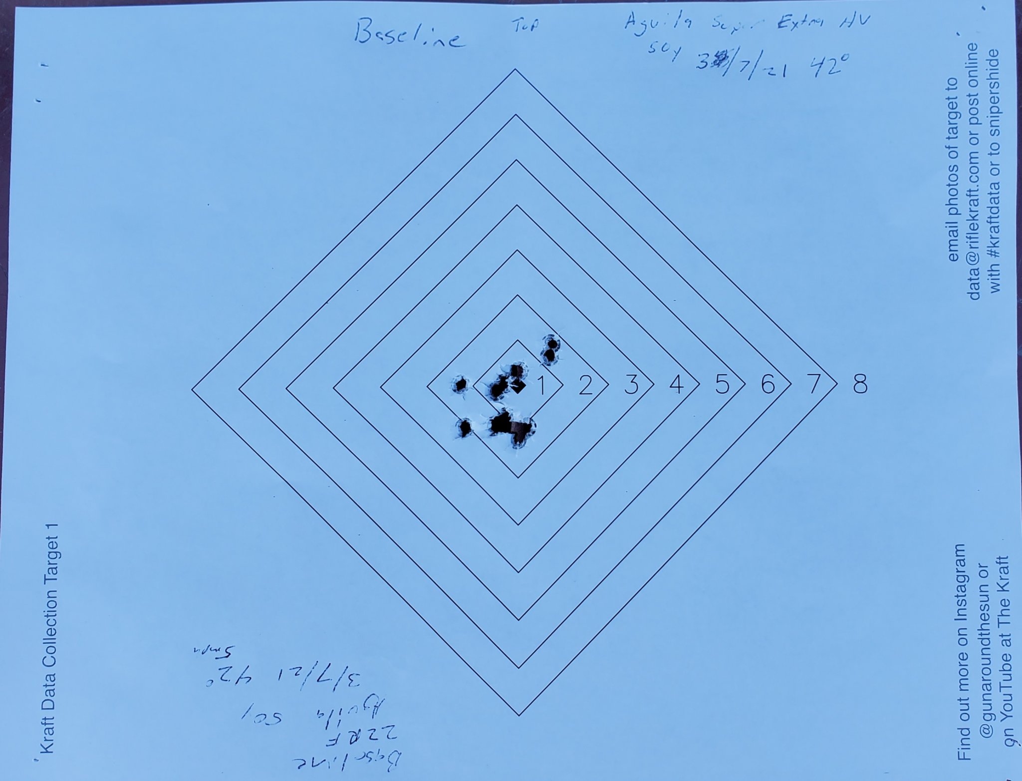

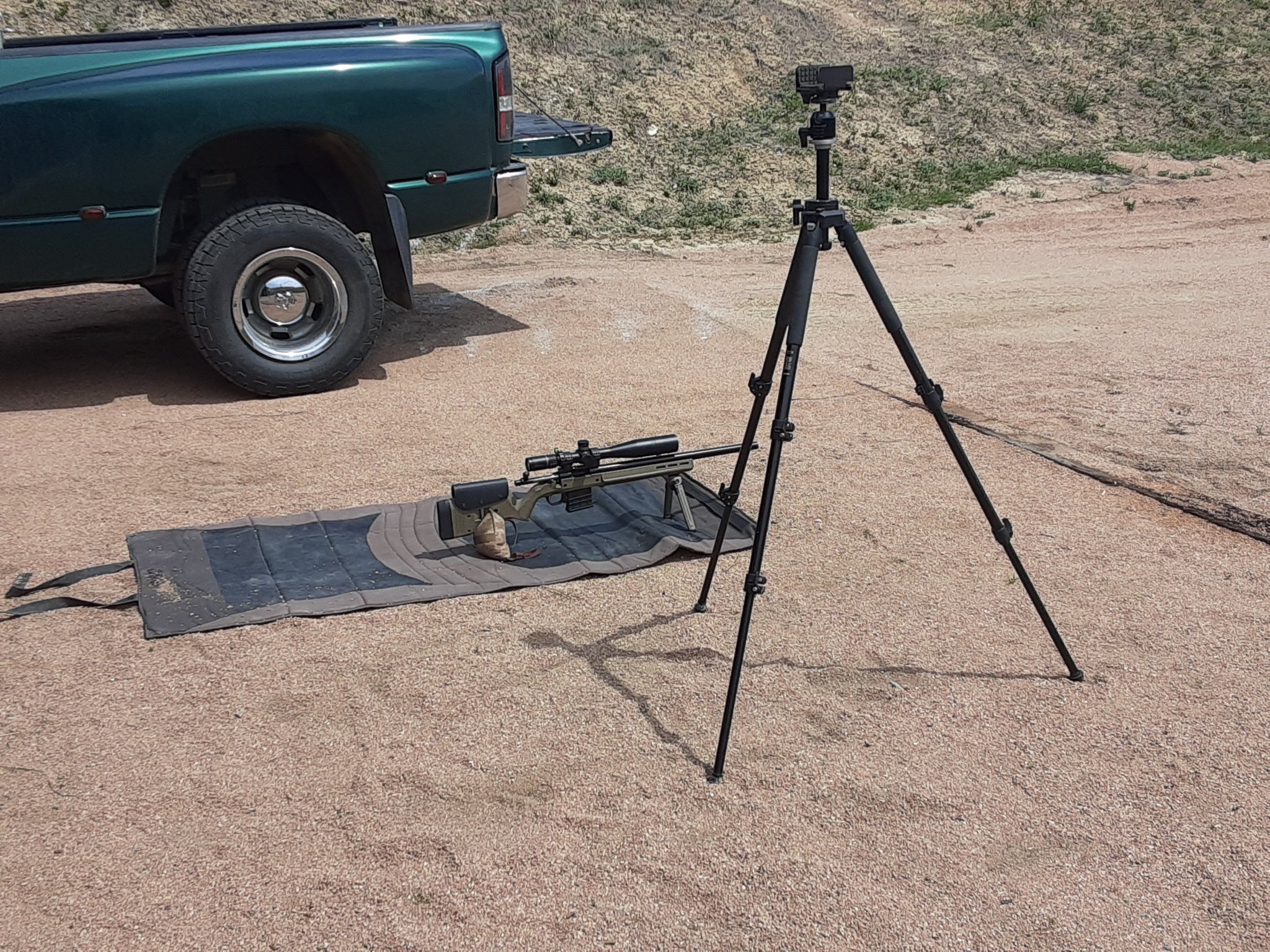

1st try with 22lr trainer......Tikka tix 22lr stock barreled action, XLR chassis. Eley Contact ammo,
Seated, kneeling and standing shot from RRS with anvil.
50 yards target reduced 50% twitchy winds 3-7mph 10 o’clock to 2 o’clock light rain
100 yards 3-5 mph 2 o’clock heavy rain.
Lowest right impact is stray shot from guy two lanes over. Confused my white paper target for his shoot n see!
1st attempt with 22 trainer. Given that I have more 22 than match ammo this will provide great training insights on position building, NPA, and wobble zone management. Ill sprinkle in some 308 for recoil management training.

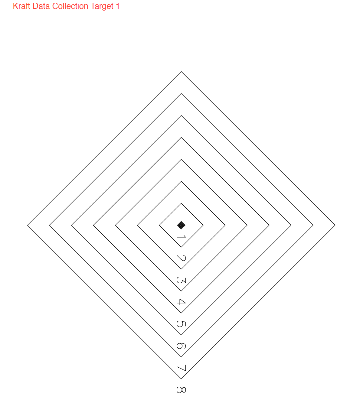

Sniper's Hide and Chris Way of Kraft are partnering up to collect some data from Shooters.
Chris is a very data-driven shooter, he is a competitive shooter and loves to analyze data. He Krafted a precision rifle course of fire designed to be shot at 100 yards and collect data from multiple positions.
To get into the background, Chris is training for Assassins Way and has competed in several national level precision rifle events. You can follow his YT Channel or Instagram Account. For further background, you can listen to Chris on the Precision Rifle Podcast.
The idea of this target is to shoot multiple positions, this is meant to be dynamic, to replicate positions one might find in the field or in competition.
We are looking at the basic position, all supported.
  • Standing
  • Kneeling
  • Sitting
  • Prone
Supported Positions
We want a minimum of 3 shots per position, and make it realistic. Don't build a better position because you are not on the clock. We want you to engage these positions clean and free, on-demand. In other words, don't use a bench with additional support, we want this to be as organic as possible.
Use the calibrated target below, we don't need comment on the paper, but details will help. We are strictly collecting data to compare across a wide range of shooters. We want just want you to post a picture of your group, If you want to discuss that is no problem at all, the more discussion the better. But the reality is Chris simply needs the image of the shot group.
I would recommend a tripod, but a barricade is an easy way to accomplish this drill.
If you want to include caliber and rifle information that is no problem at all. We are really just looking at the group.
Download the target, go out to 100 yards and shoot the positions, Then post your image here or email to Chris at the address on the PDF.
You shoot the same target for each position, we are looking at the overall total group size based on the changes in position

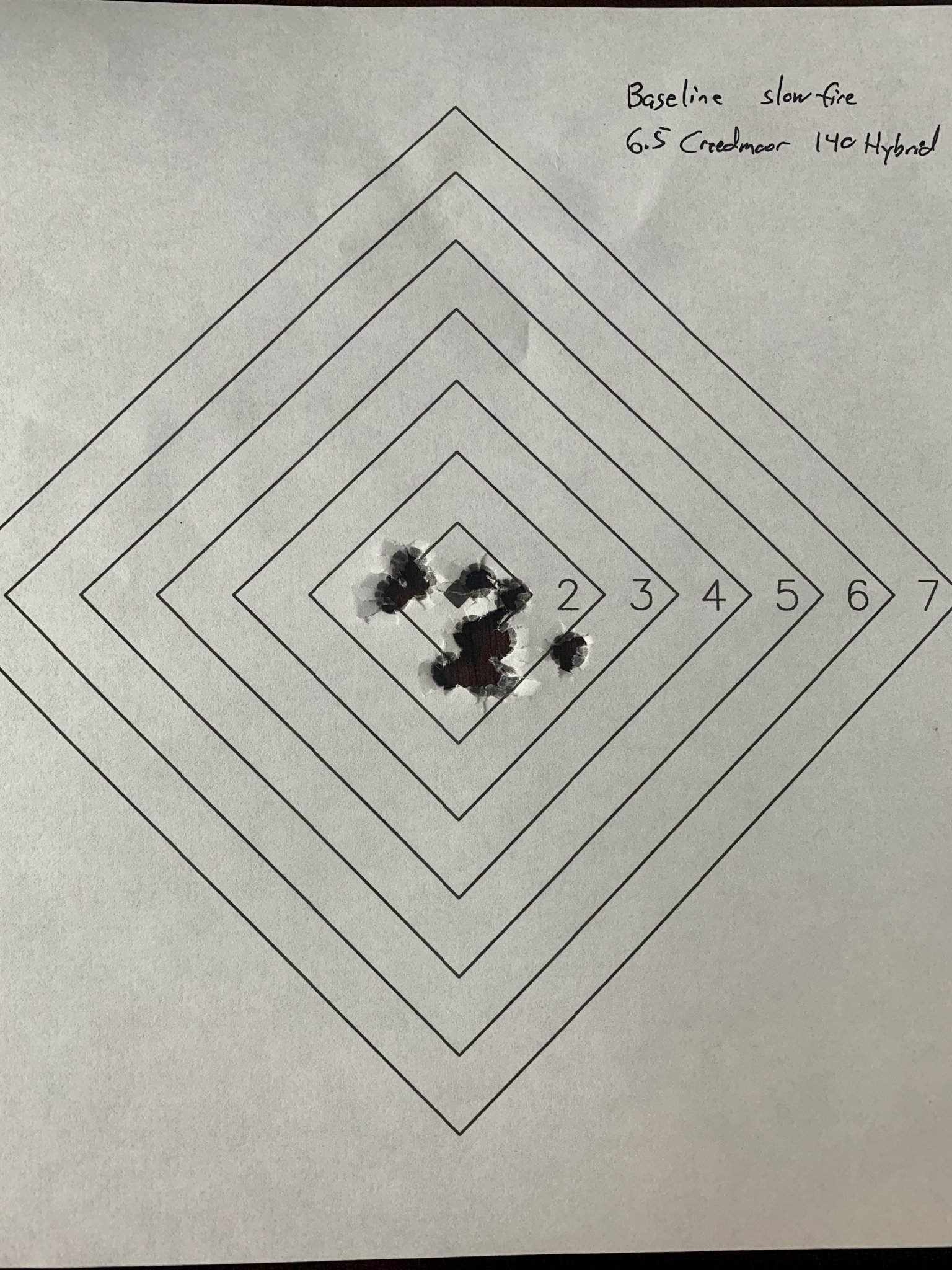

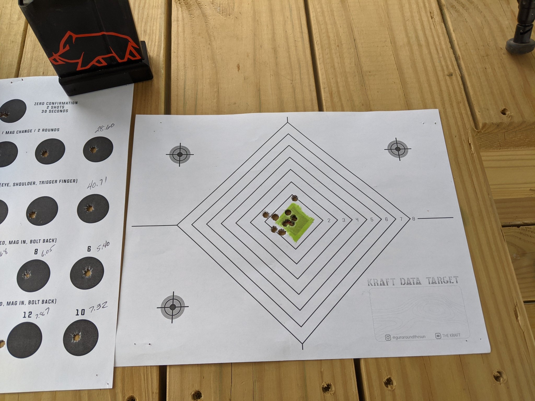

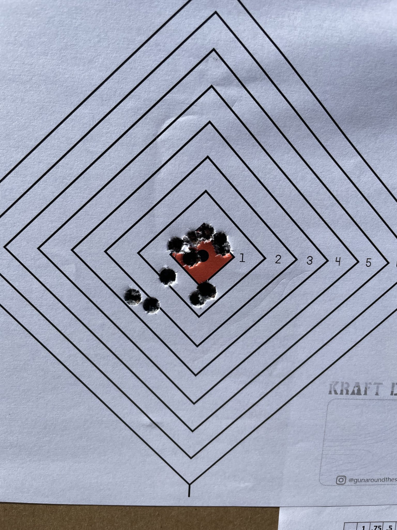

Finally shot a respectable target this morning. 6.5CM, GitLite gamechanger on a tripod/plate for the Sit/kneel/stand shots.
Reactions: RS14

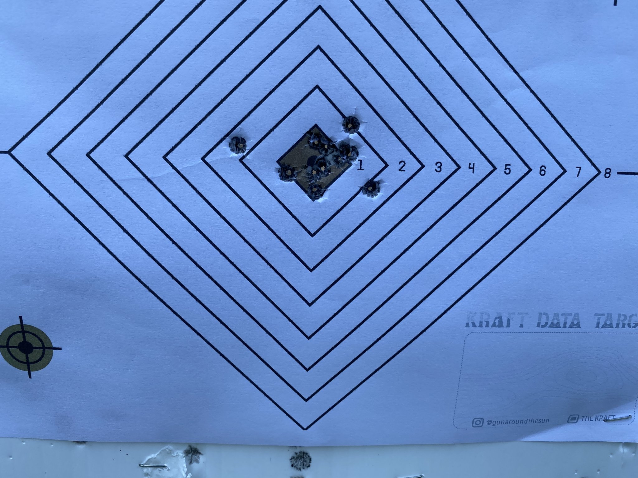

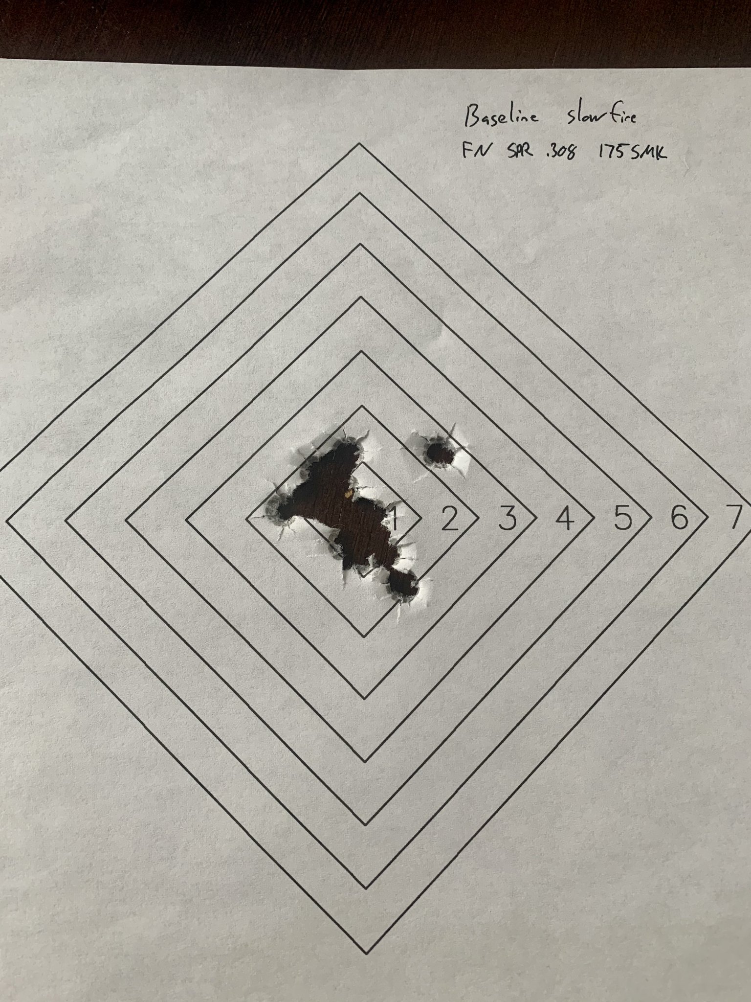

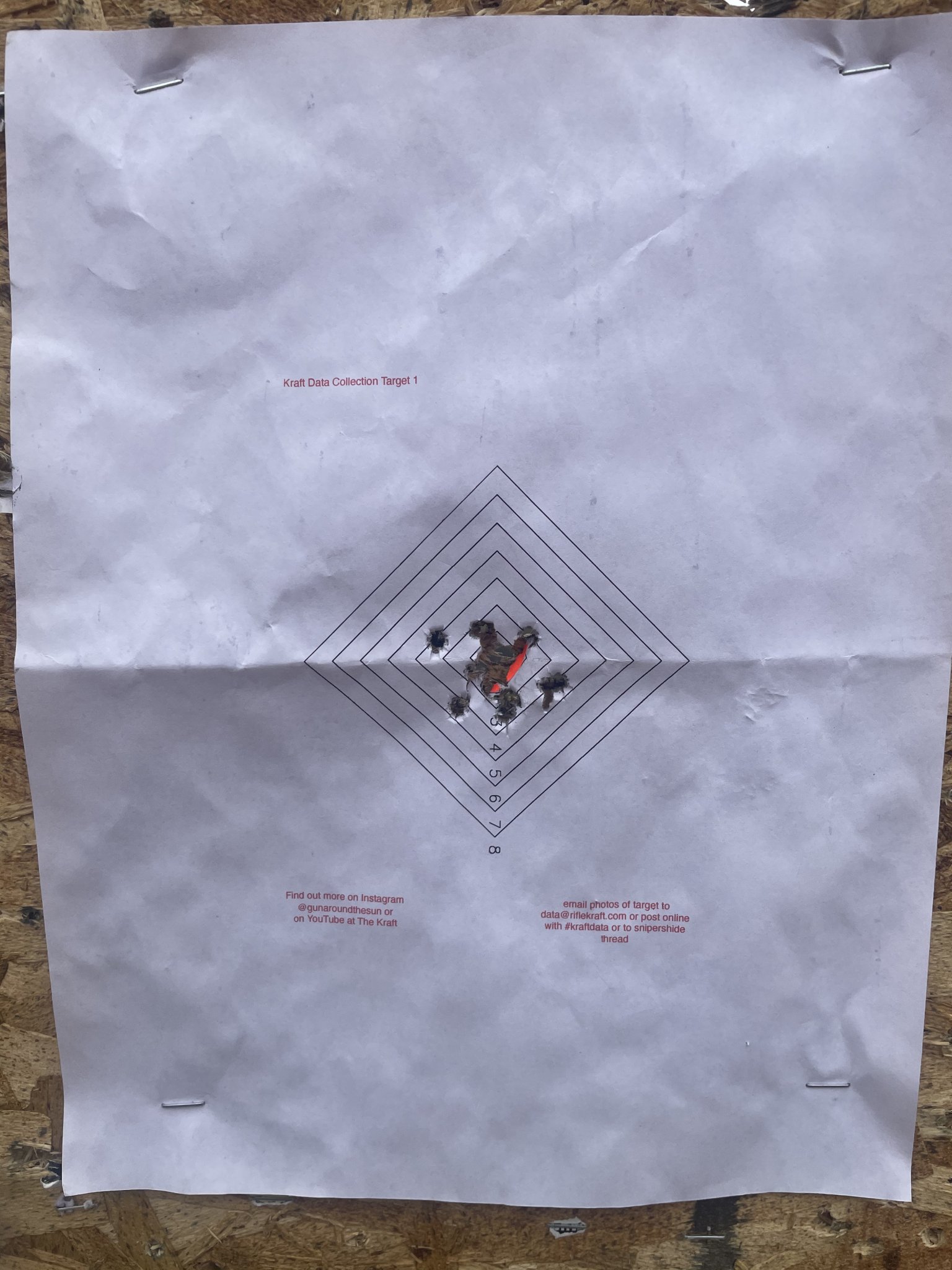

Go easy guys... I'm posting this but I am well aware of how bad it is. There is a LONG story behind this and I'm posting a separate topic to discuss and ask some questions.
The gun is a Steyr Scout in .308. Scope is a Leupold Mark 4 MR/T 1.5-5X and ammo is Lake City milsurp M80 Ball. Tripod is a Jim Shockey Primos Trigger Stick Gen 3. The Primos is about as unstable as you can imagine. I shot standing and kneeling using it but the sitting was done from cross legged and slung up in the Ching Sling.
All things considered, it was a good start and illustrated where I need improvement. I need a more stable platform for standing and kneeling before I can get too serious about it. I'll ask that in my other thread though.

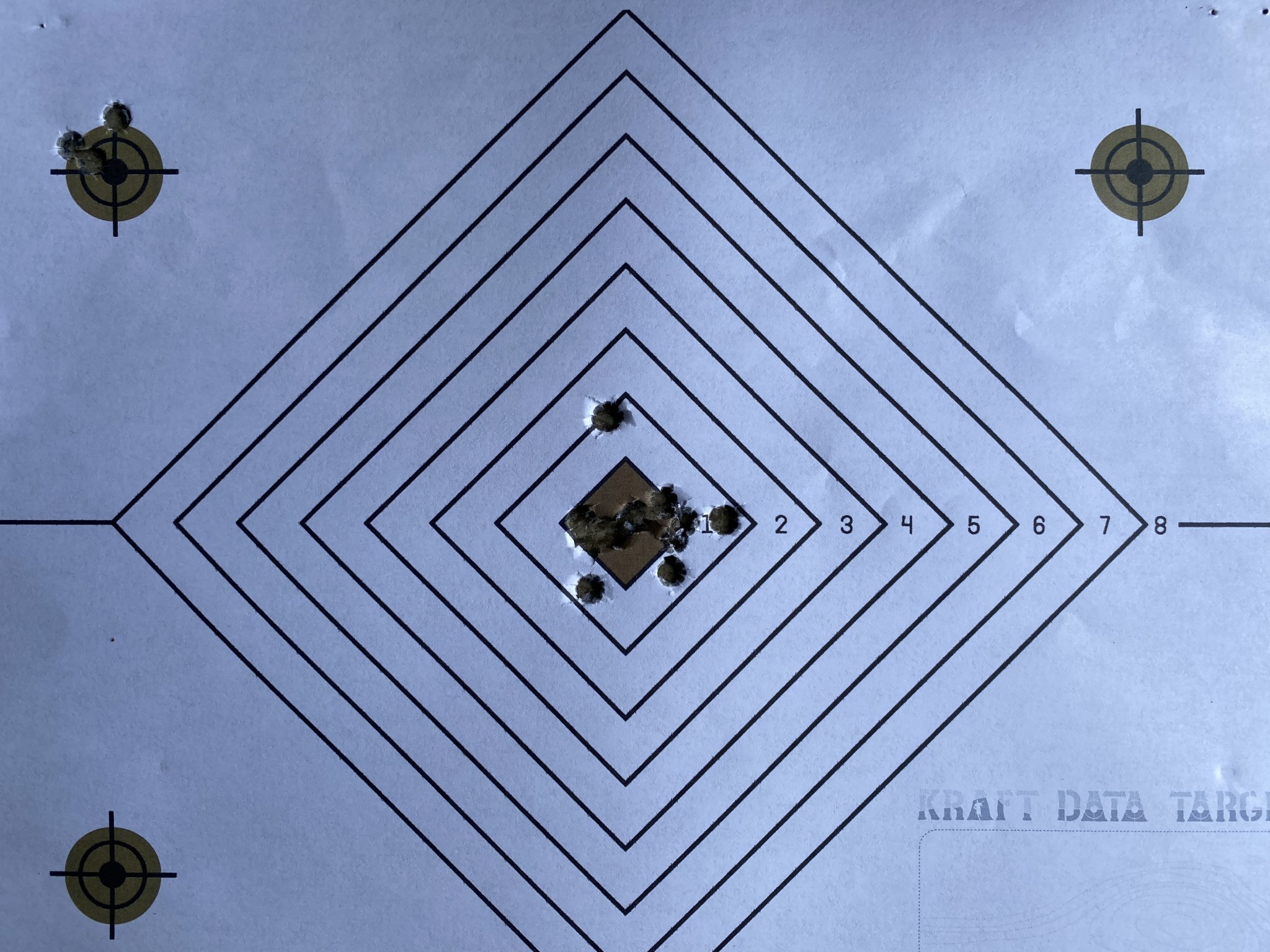

I'm a little late to the party, but here is my baseline. I did it twice because I set the tripod poorly the first attempt (too tall).
6.5 Creedmoor, Barnes 140gr Match Burners, 2,775 FPS
Impact / Proof / ACC
Schmedium Gamechanger
Standing - Tripod
Kneeling - Bench
Sitting - Stool
Prone - Asphalt

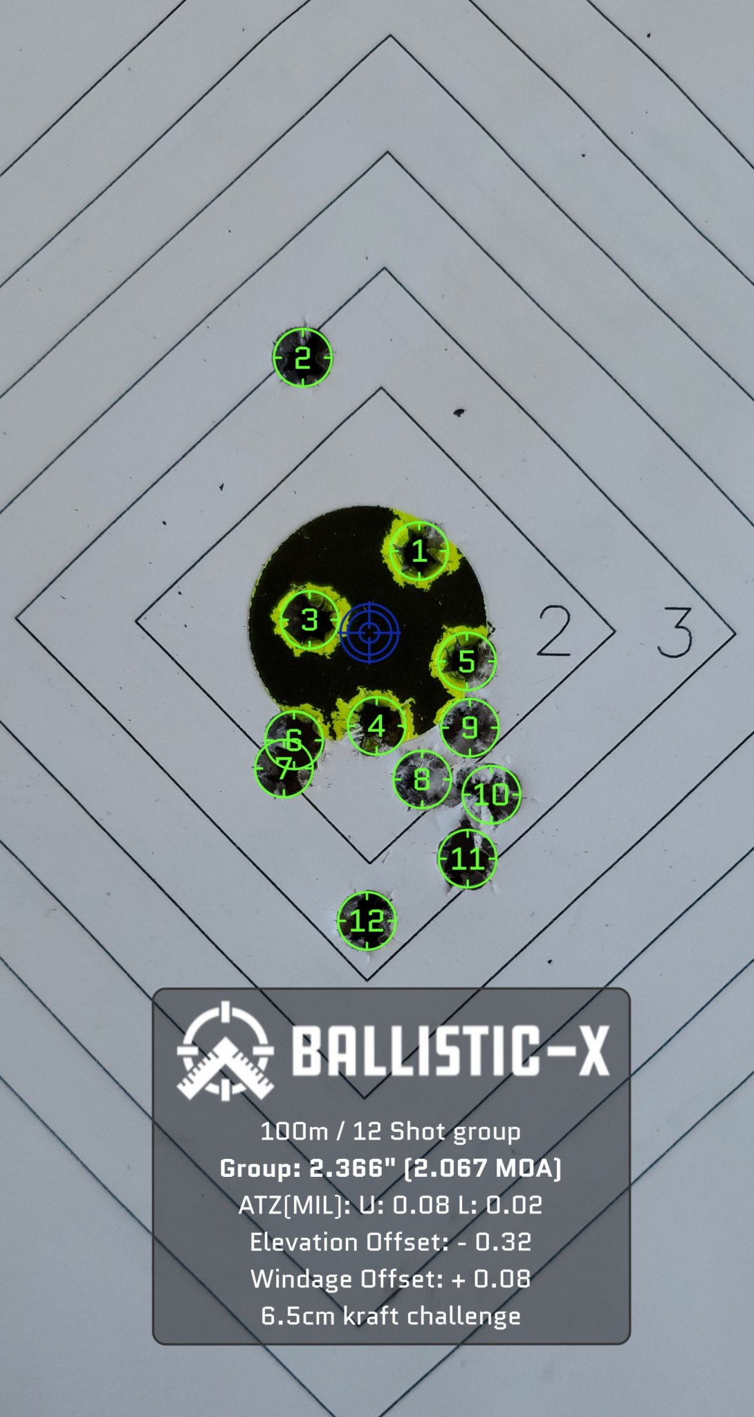

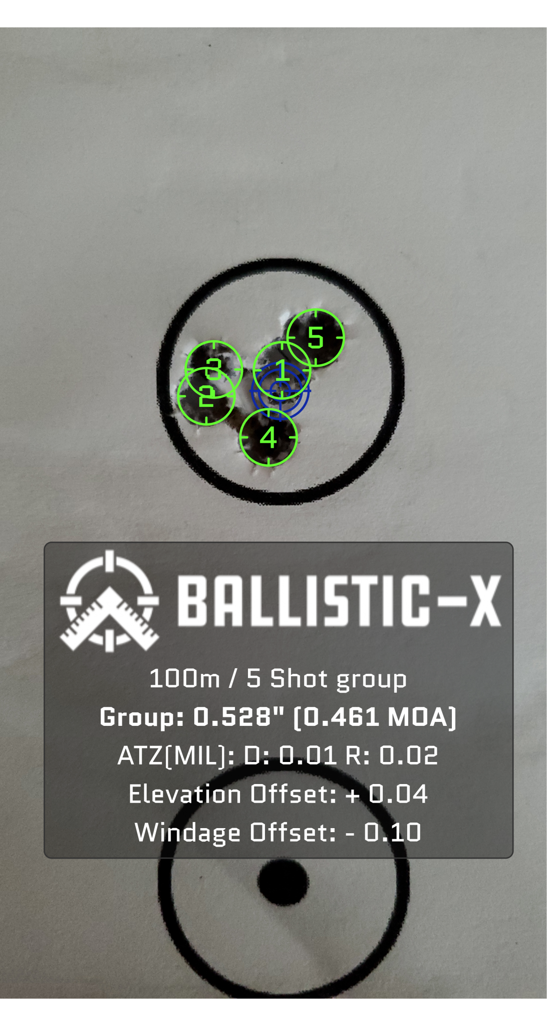

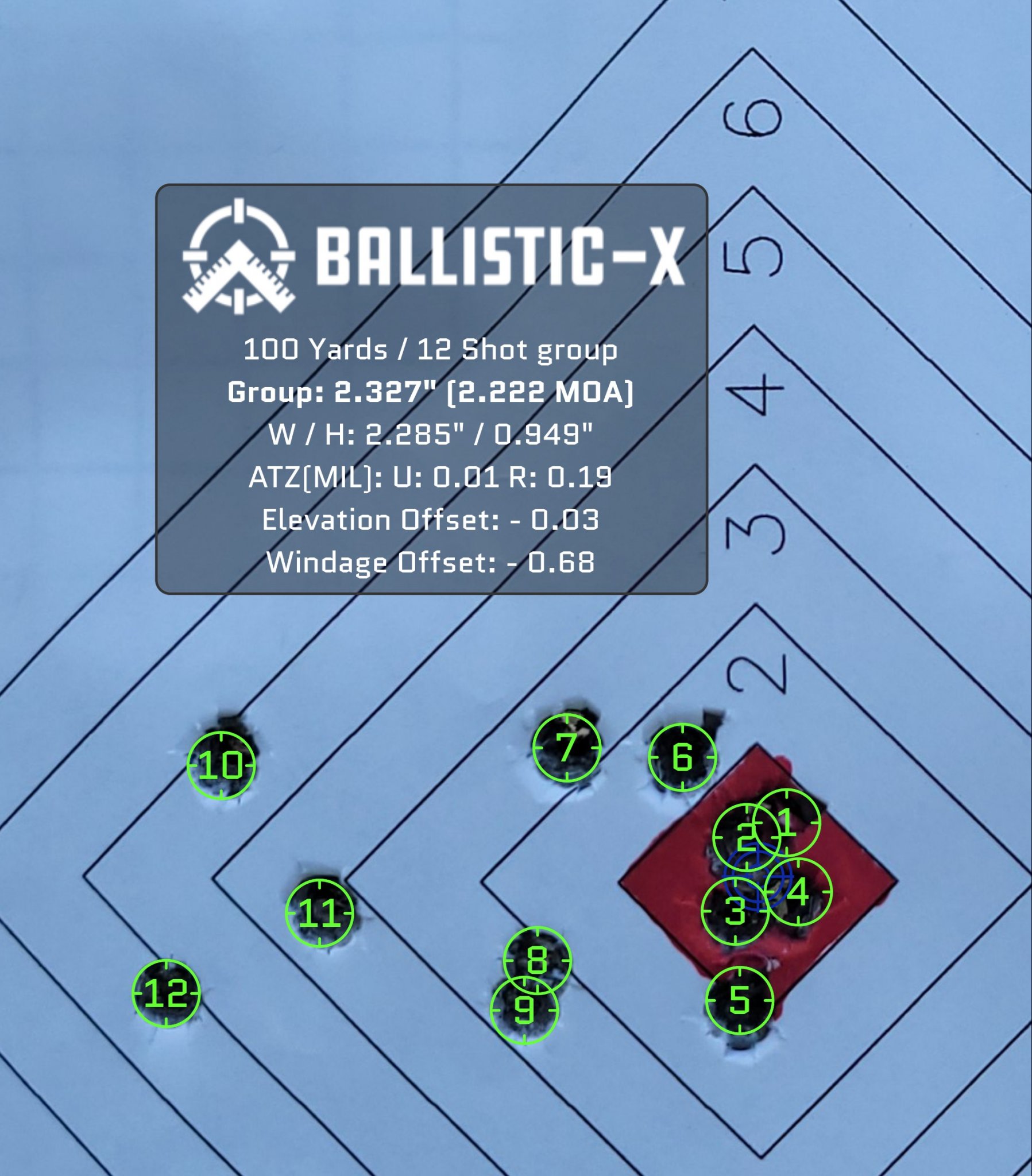

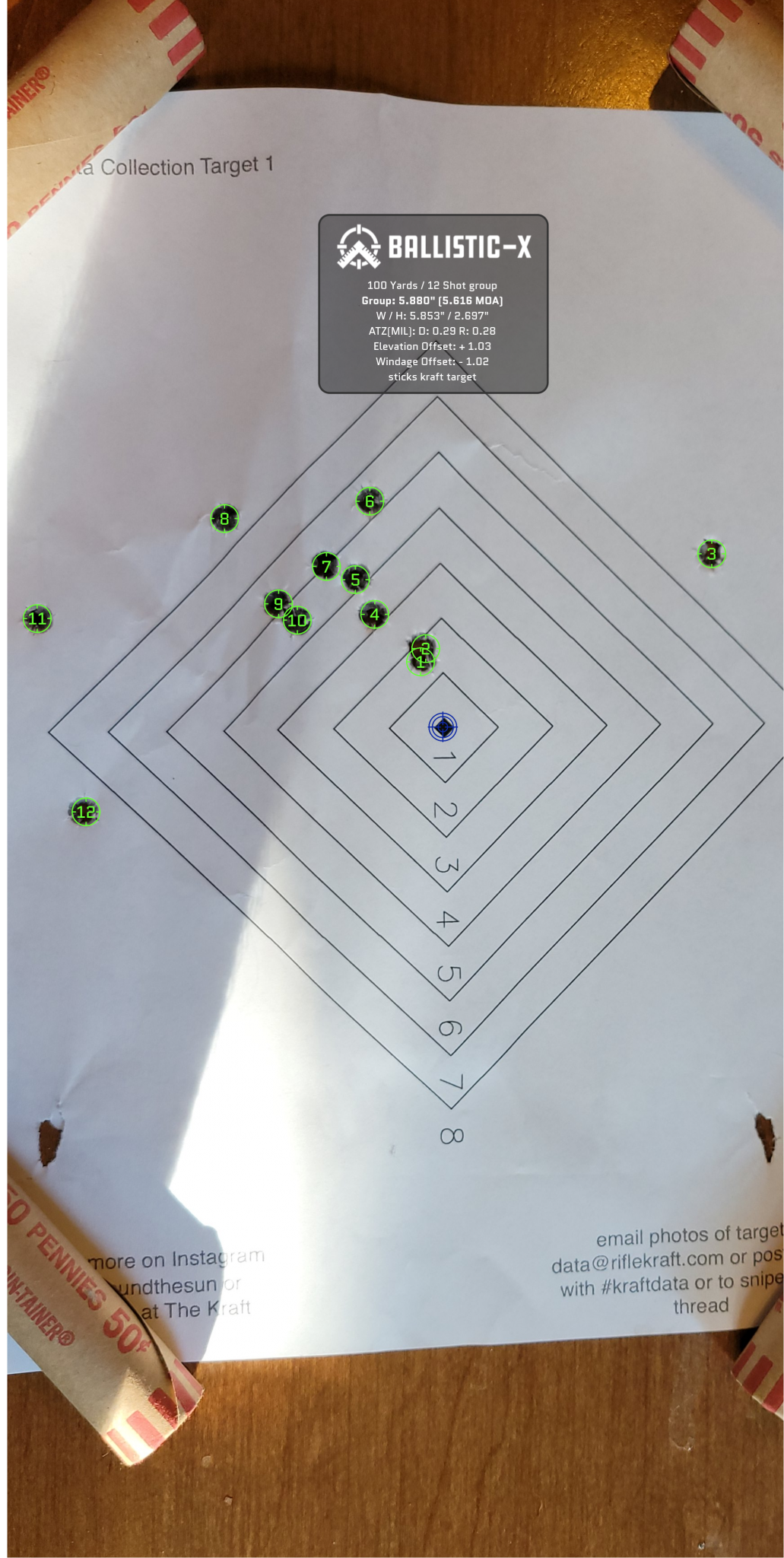

Ran the drill twice today with my 6.5 creedmoor practice load. Haven't fully zeroed cause I forgot to reset the turrets from my long range load. I felt more stable off the walking sticks but apparently tripod was better. Wow I need practice if I could only find time lol
  • Ballistic-X-Export-2021-06-20 18:34:08.958100.png
  • Ballistic-X-Export-2021-06-20 18:37:46.989365.jpg

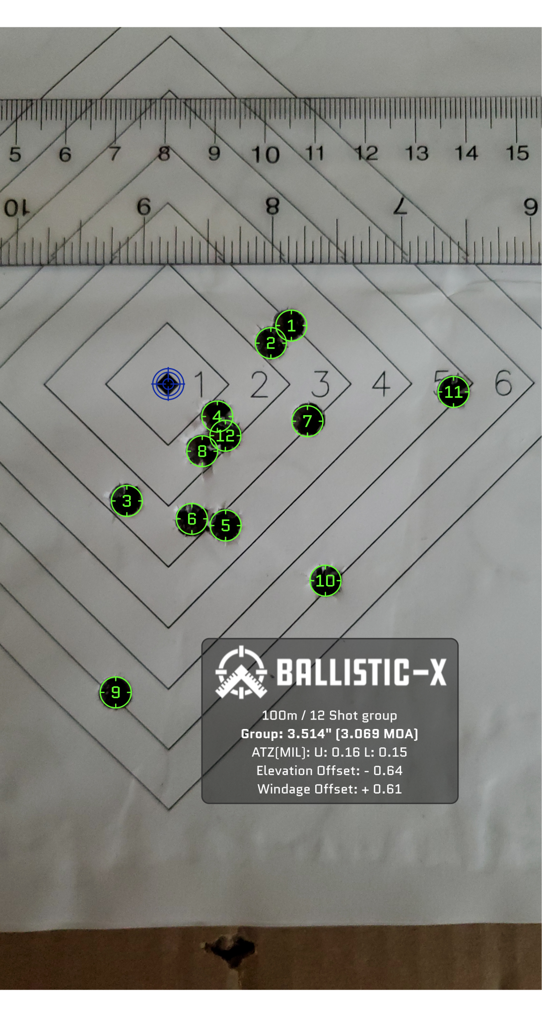

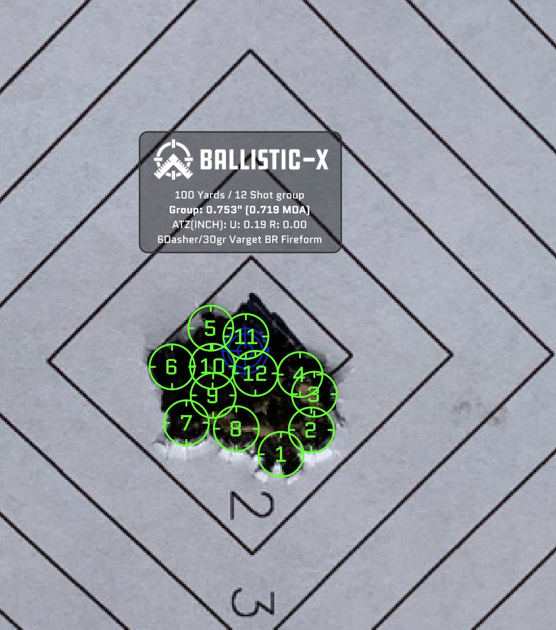

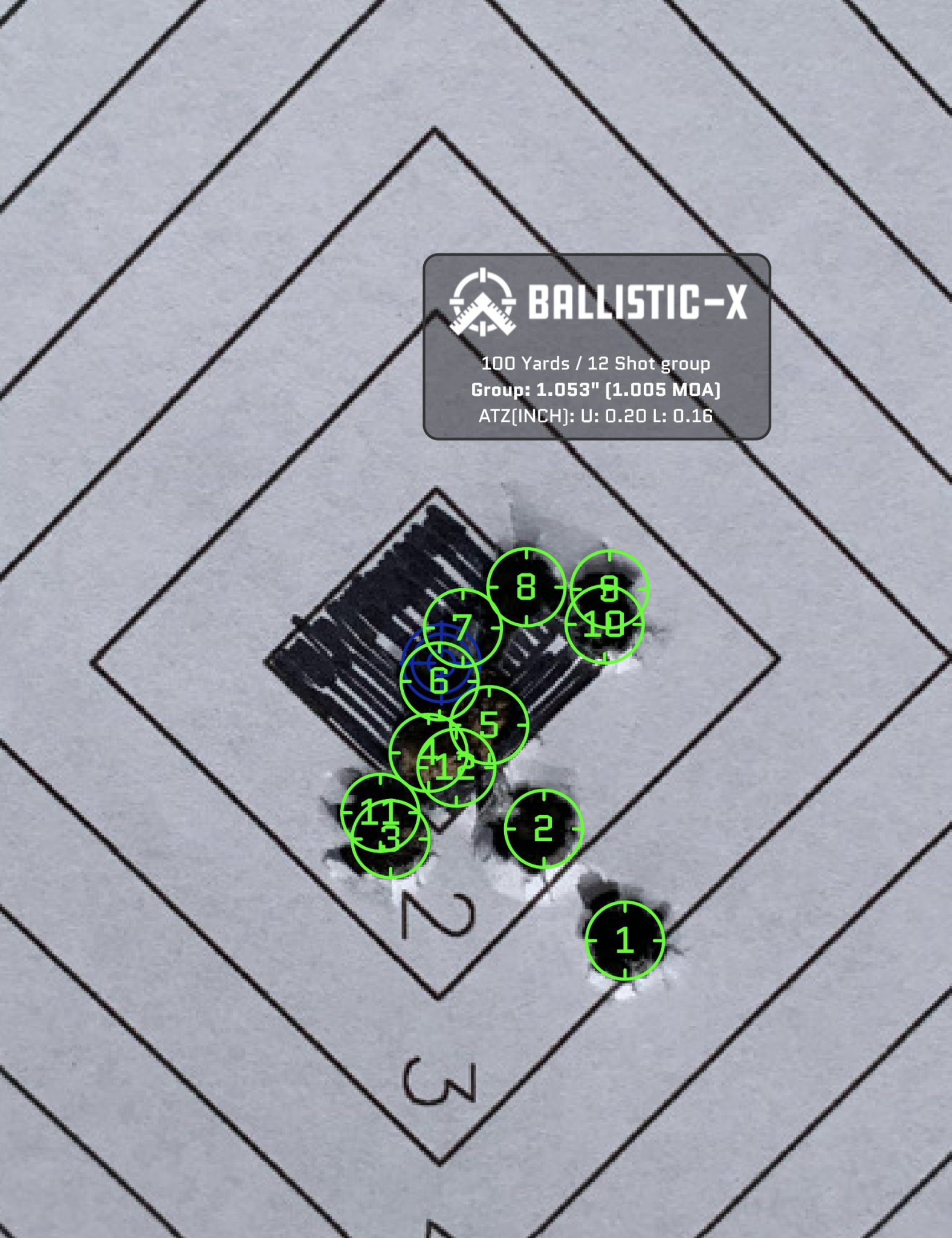

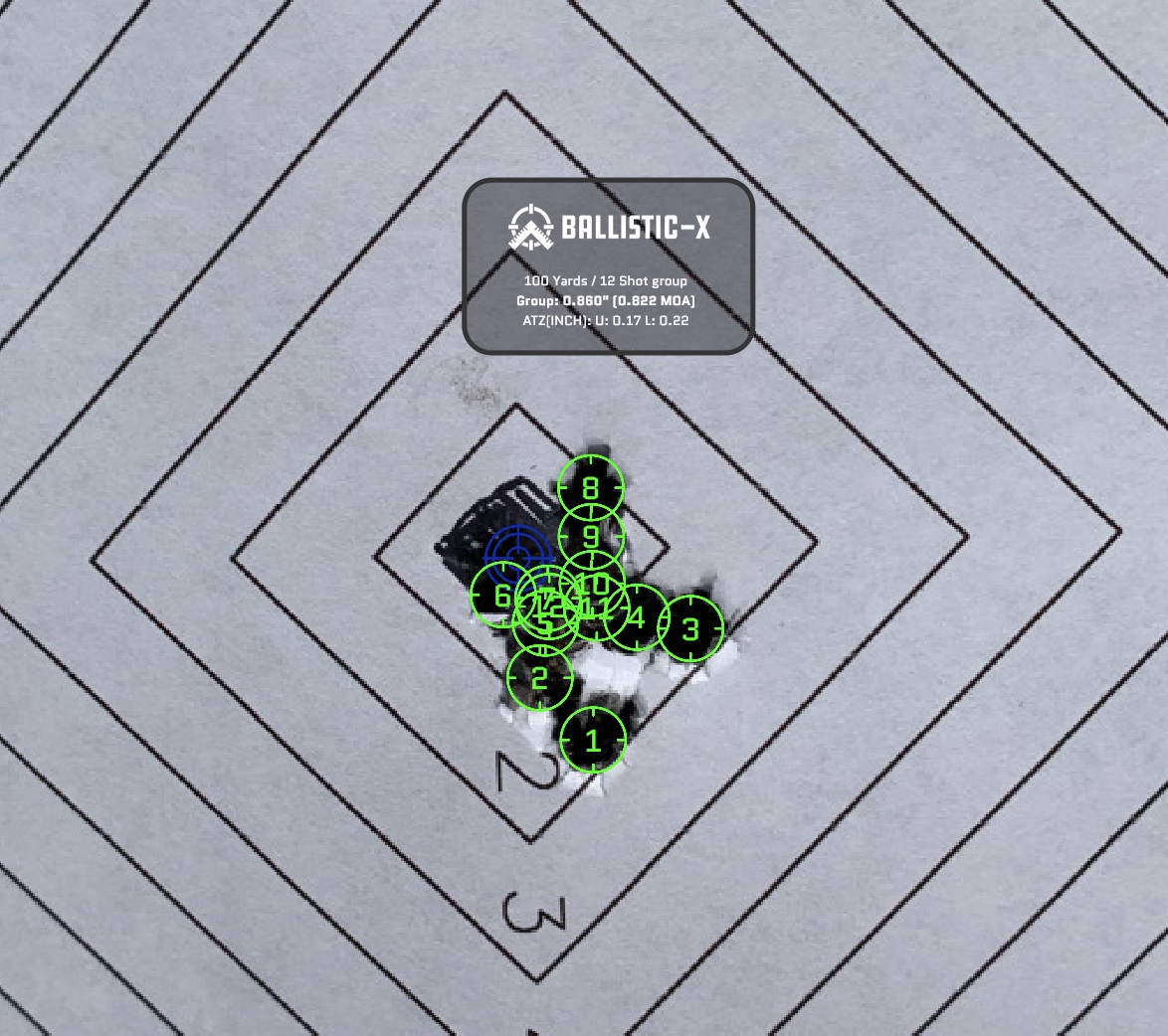

So this is my third or fourth crack at this. Was working out to be my best attempt yet but then the last set just totally went sideways for me. Definitely having the most trouble vertically. Can't seem to steady up my wobble zone. This was off my tripod using a bag for standing down to sitting. Prone off bipod and rear bag. I feel locking onto my arca would provide better results but in the spirit of the assessment, I tried to keep as "in the field under time" as possible.
Ballistic-X-Export-2021-07-02 16:17:29.883744.png
Also shot this from the prone after.
Ballistic-X-Export-2021-07-02 16:09:42.913947.png

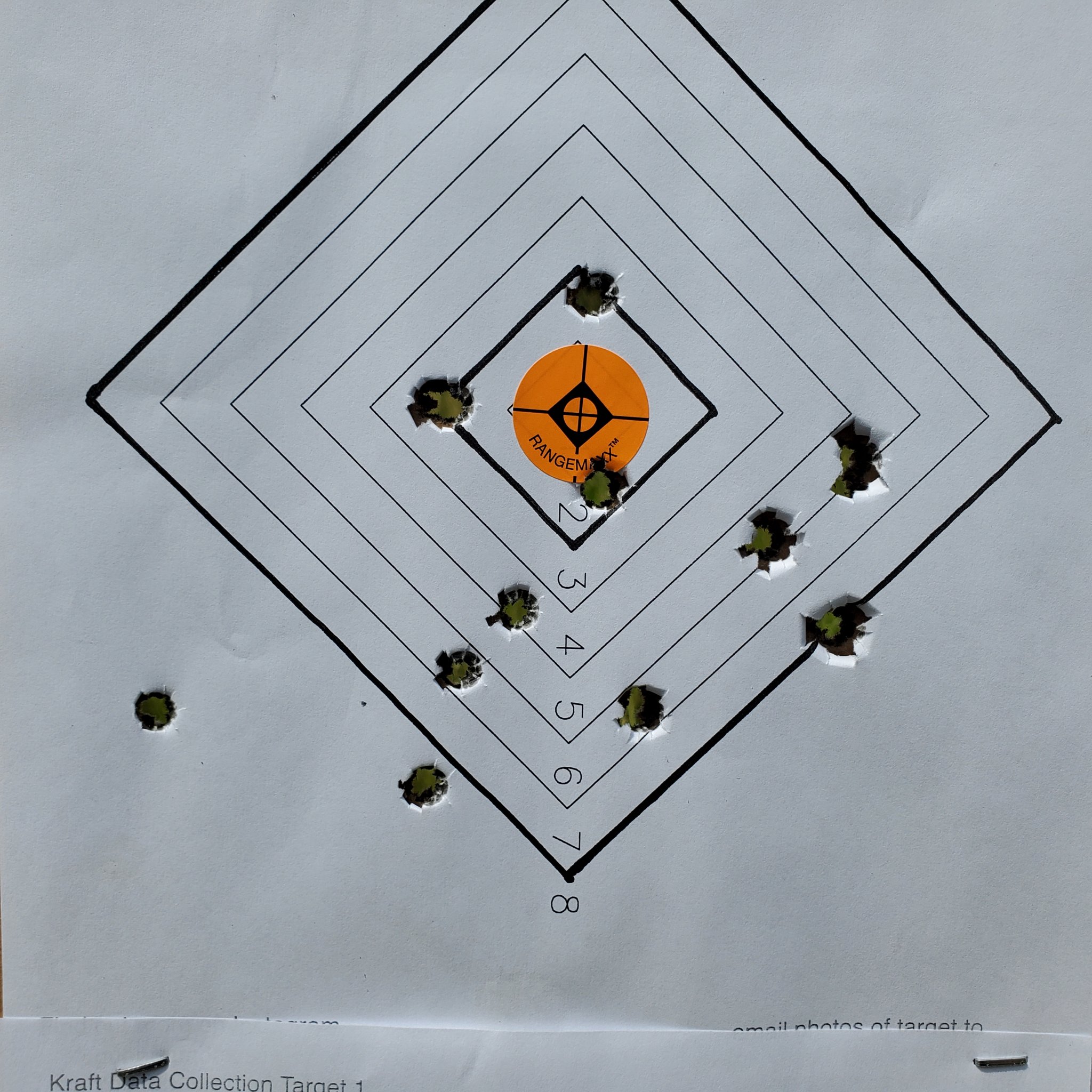

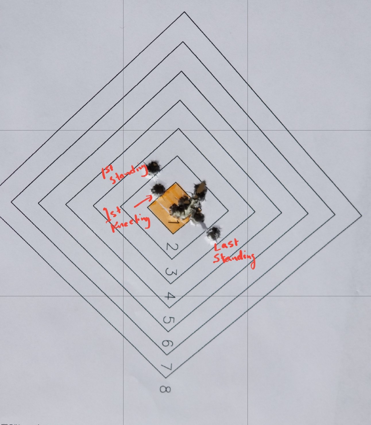

It was all going so WELL!… …until the second and third kneeling and third sitting.
Oh well. What I learned was where to practice more. I struggled to get my wobble down on those shots.
First four.
Full twelve.
And quick vid for the lulz/constructive criticism.
Reactions: Just Chuck and RS14
First four.
Full twelve.
Couple quick things I saw:
-When standing, lock your knees out. Control your elevation by splaying (or bringing closer together) your legs
-When kneeling, being that you're choosing the height of your tripod, I'd set it up so that you can plant your firing side foot flat and be able to support your firing side elbow on your knee with your leg bent at about 90 degrees (vs the lower, deeper kneeling you're using)[/MEDIA]
So changed up my tripod adjustments and also bought myself a pint sized Game Changer. Still having some trouble getting comfortable with crouch. My body just doesn't seem to like the position at all. That's where the one high shot came from. Assuming it wasn't a total fluke, it's definitely a major improvement over my previous attempts.
Ballistic-X-Export-2021-07-09 14:35:43.112842.jpg
First four.
Full twelve. View attachment 7663182And quick vid for the lulz/constructive criticism.
Everything in positional looked fine. Slight bend in knees is fine. As long as your bones are doing the support and not your muscles.
Prone, check out Velayo’s video on “building the bridge”. That’ll square away very small issue with prone.
And, we don’t always control height of barricades. So, I wouldn’t adjust it to make it easier all the time with knee support.

Interesting observation, when I saw this originally demonstrated folks were shooting off of bags in the standing, kneeling, and sitting. Is shooting it locked into the tripod the goal?
The goal is to put all 12 shots inside the 1” diamond. That’s my goal anyway. Consistently.
Reactions: seansmd
Whatever you want to work on. If wanting to work on locked in, go for it.
Also, I personally think it’s easier to shoot off a bag. Running a tripod locked in and shooting small is a skill of its own.
