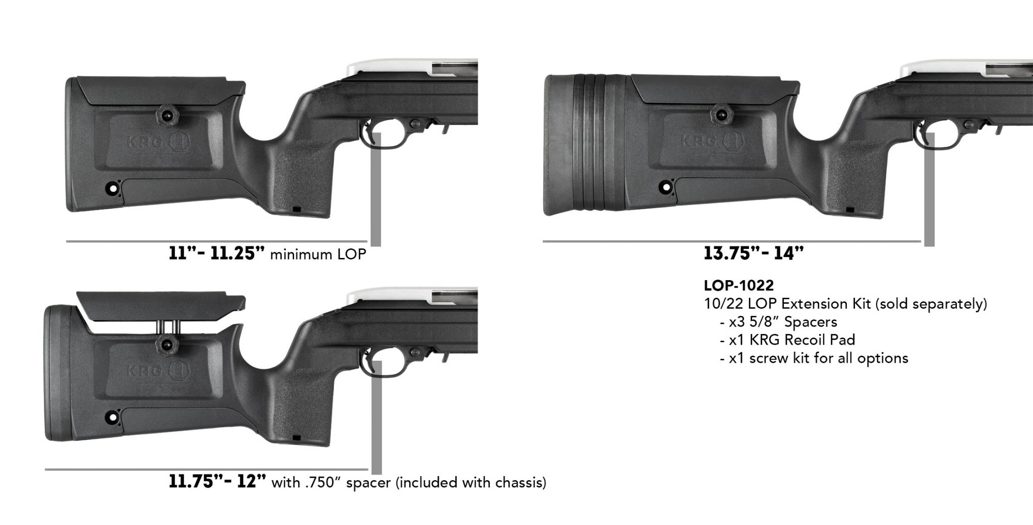

I'm not familiar with KRG stuff or Rem700 either but do you suppose the buttpad they sell would be a correct fit for this 10/22 stock? Between the 3/4 spacer it comes with and what looks like 3/4-1" for the buttpad it'd be a good LOP.

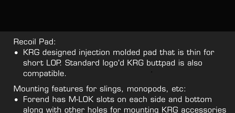

Also, adding the .750" (3/4") spacer brings it back to the standard Bravo LOP (without recoil pad). The thick KRG recoil pad is about an inch thick so between the 3/8" spacers, the 3/4" spacers, and the thick recoil pad you should be able to get long LOP's if you want it.

Do you have a rough idea on when the tool-less LOP kit will be ready?

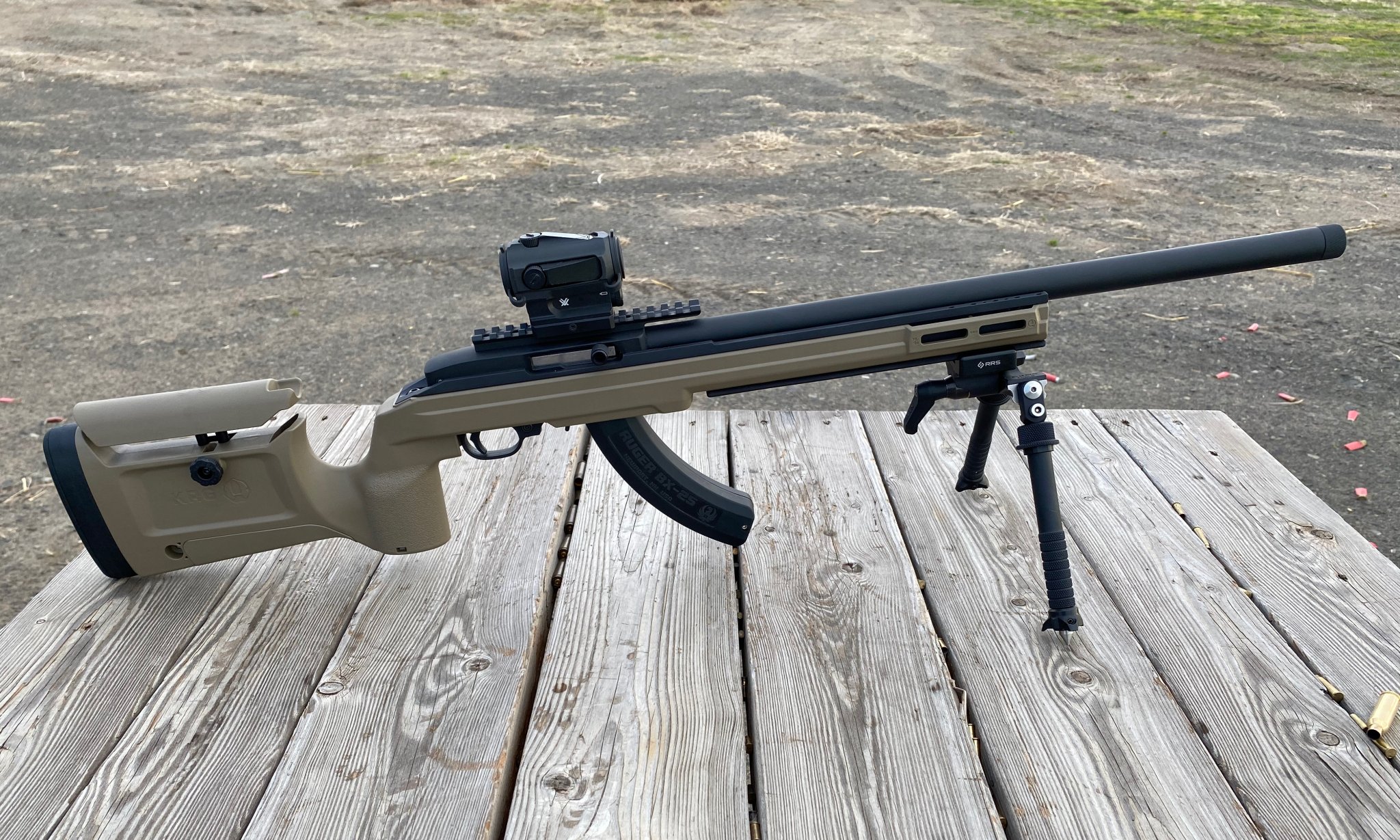

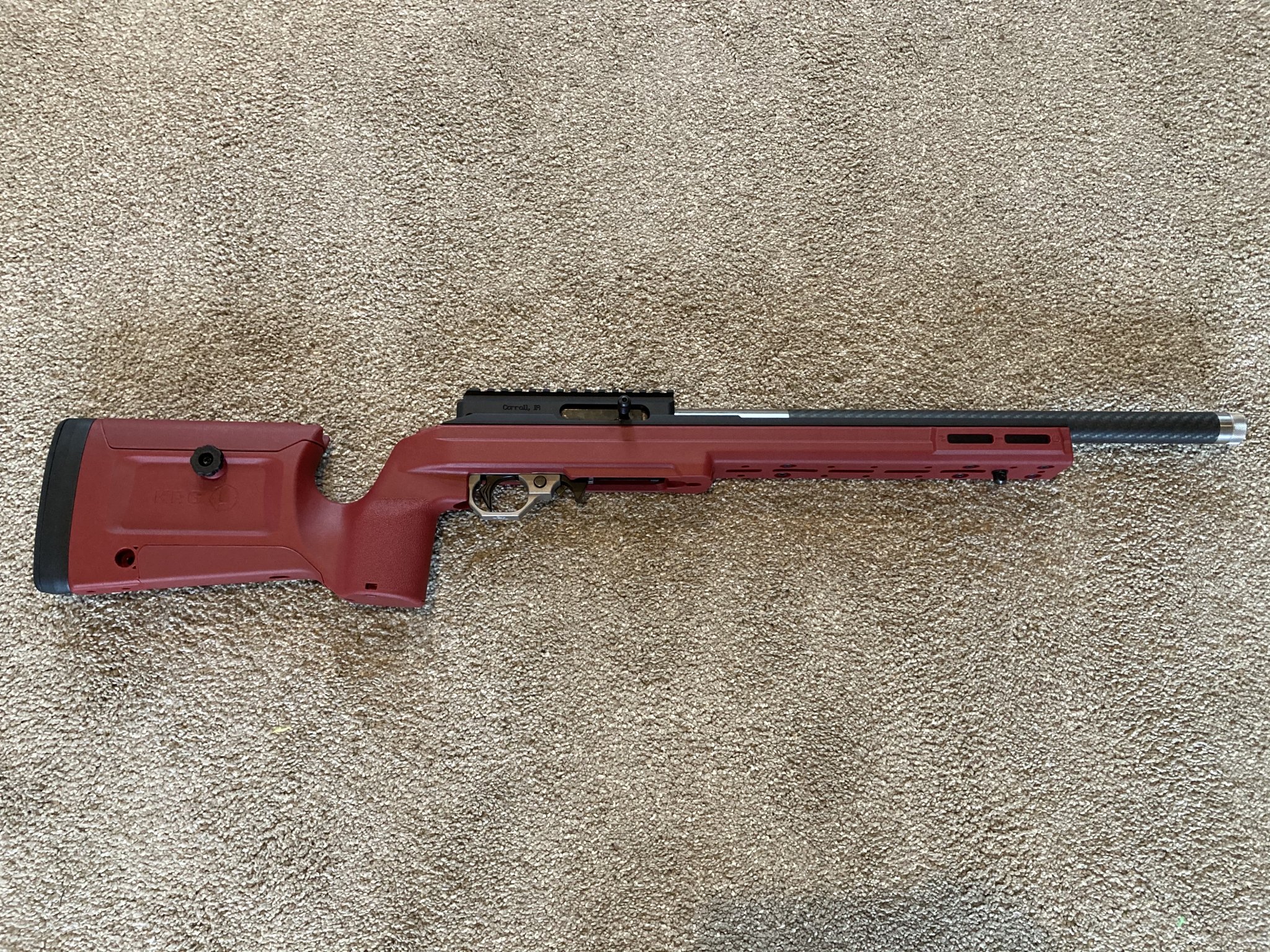

Mine showed up today. I like it! No surprise though since my T1X has been wearing one for a while now. I will get pictures soon.

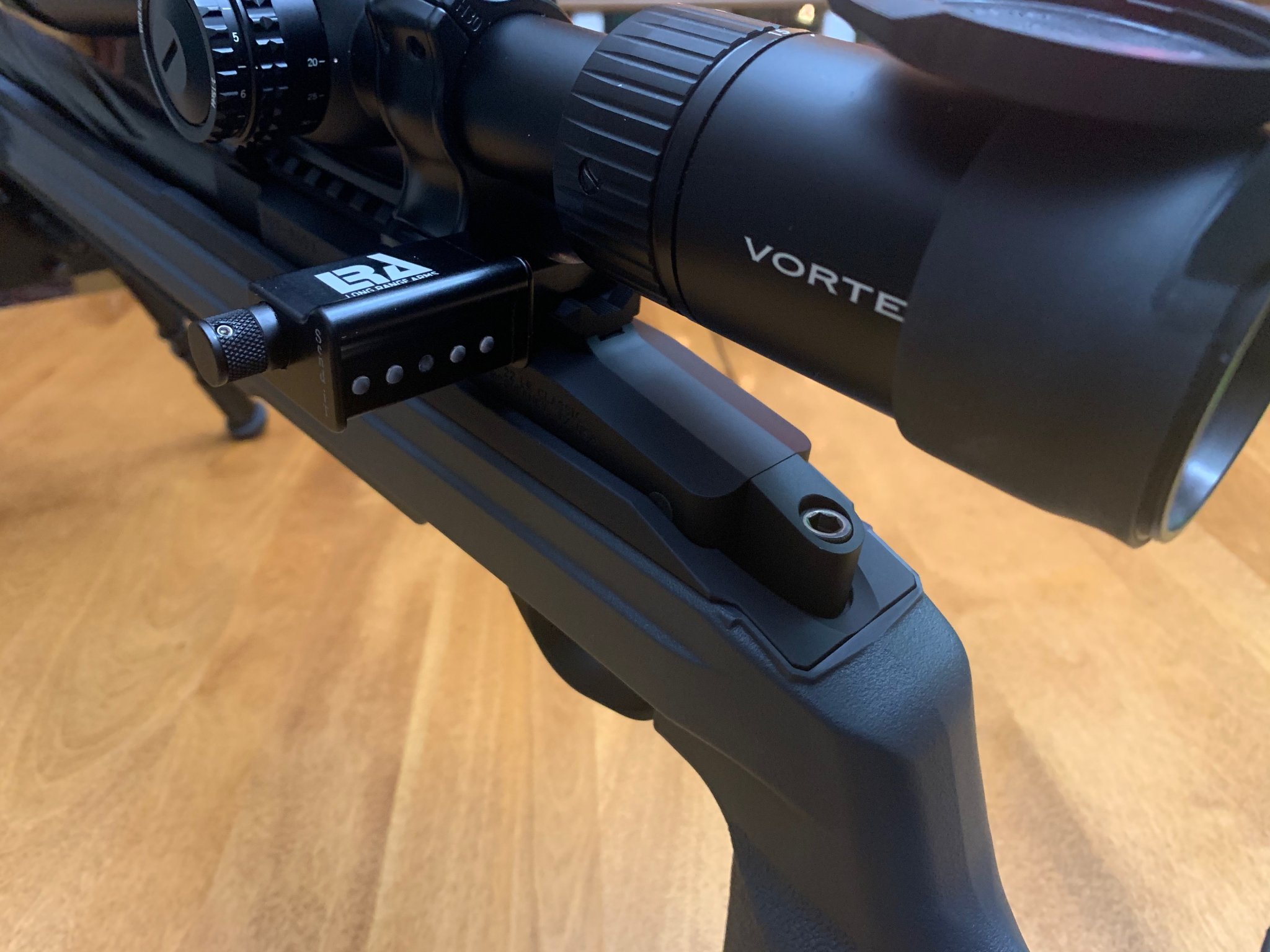

There is a note in the specs that the Kidd receiver needs an additional rear tang screw ordered separately under fasteners (for $1.00).
My Bravo 10/22 came this afternoon also. Very excited to go shoot. I added shot of the rear tang with the bolt to lock down a Kidd receiver. This was something I was wondering about. It isn't anything like the Victor Titan. It is very simple, a screw attaches the cup to the rear tang where the second action screw would be on a R700. It comes with a short bolt installed if you don't need it (so the tang looks like a Bravo R700 without the Kidd extension).

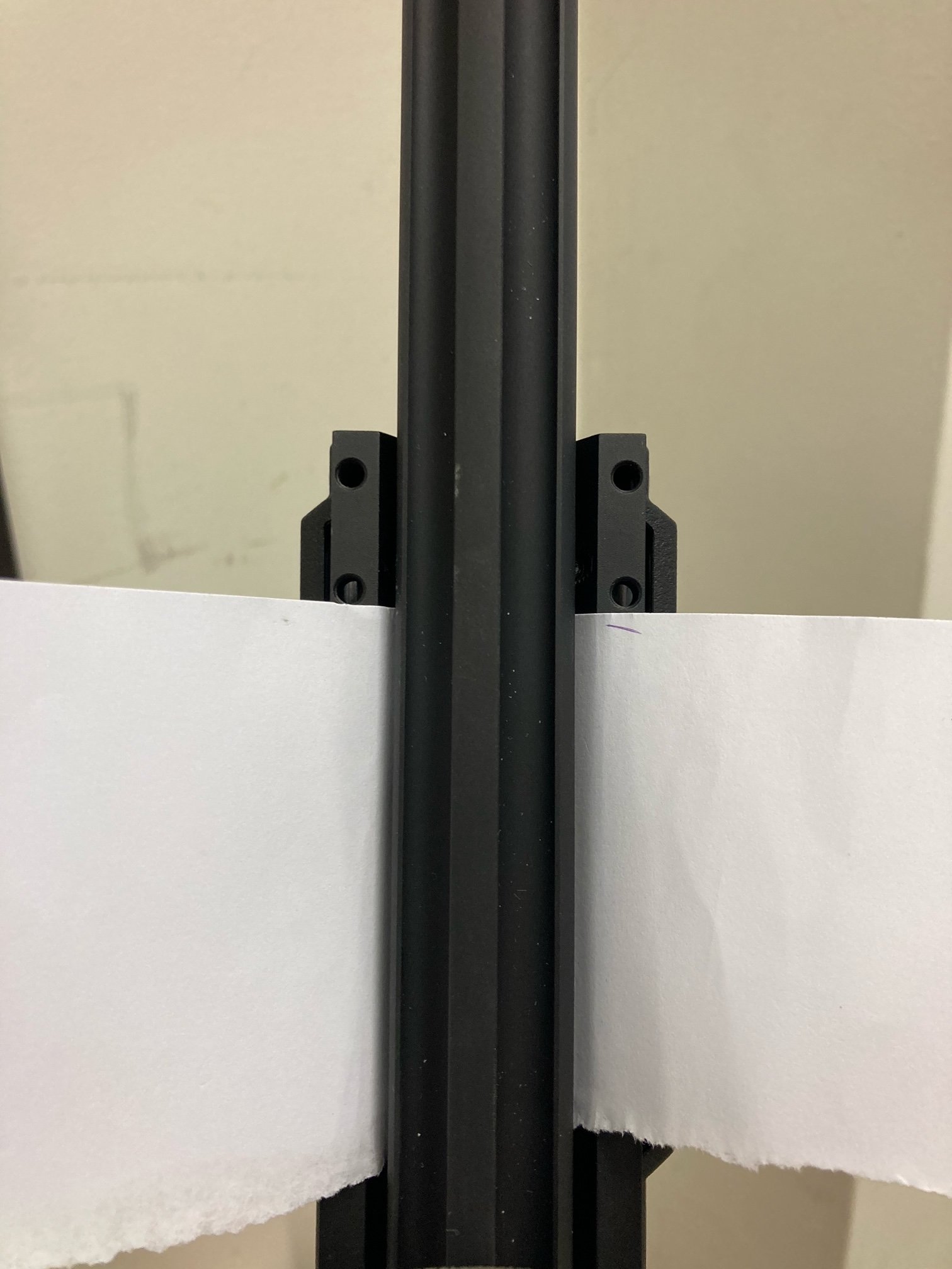

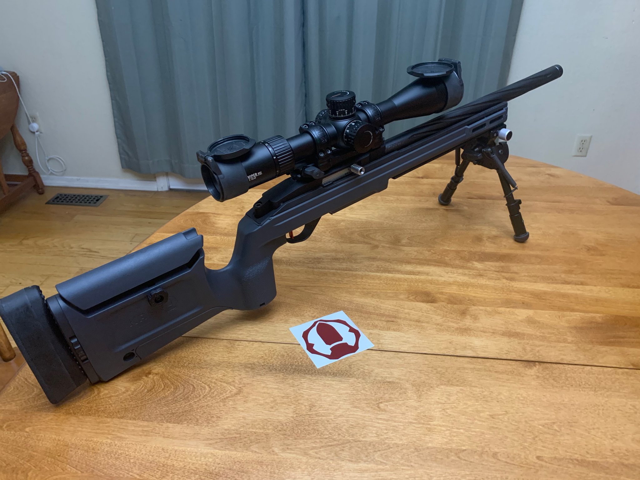

Can people post photos of how the barrel fits for clearance of a .920 bull barrel. It states a .920 barrel is GTG but not a bull barrel which I've always known (in 10/22 world) as a .920.
It's got about 1/16 inch of clearance with a .920 barrel. The product page says their existing spigot mount won't work with a bull barrel, not the chassis itself. They explicitly state that the chassis supports barrels up to .920 in diameter.

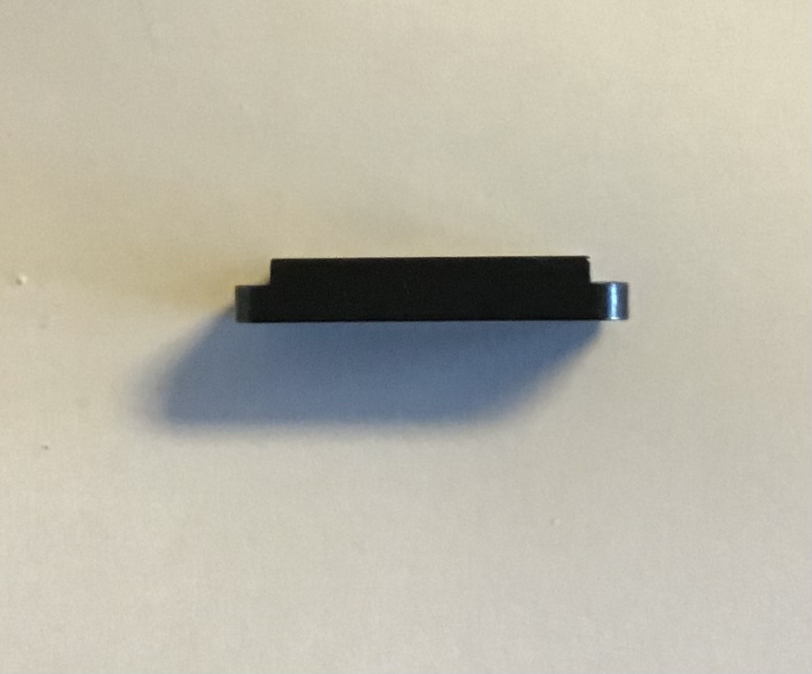

My tacsol .920 barrel is contacting the aluminum chassis at the tip of the forend
Just got mine in and put it together and the barrel was contacting the forend. Took it apart too see if I messed up how the spacer goes (it fell out off the groove when I was putting the action in) and flipped the removable spacer upside down. Now it clears fine, but I’m not sure that’s how it’s supposed to be. It seems like it’s sitting up out of the chassis too far. do you guys have it thick side up or thick side down?

For those that are having problems with their .920 bull barrels contacting the chassis at the tip, what brand receiver are you using? If you are using a Ruger, is it possible that the receiver hole is not perfectly square to the receiver? I know that there are a lot of Ruger receivers out there that have canted barrel holes.
I’m using a factory ruger receiver
One way to check for a canted hole. Take your stripped receiver with the barrel attached to it and lay it sideways on a very flat surface. While holding the receiver flat on the surface, measure the distance between the end of the barrel and the surface. Flip the receiver over to the other side and repeat. The two measurements should be the same. If not, you have a canted barrel hole in the receiver.
Here is a link showing what I described. This is from Victor Company website.
Was the barrel a tight fight when installing it into the receiver? Did you use the standard v-block for attachment? Is it possible that there is barrel droop? This can be caused by a slightly loose fitting barrel and the v-block pulling down on the barrel.
