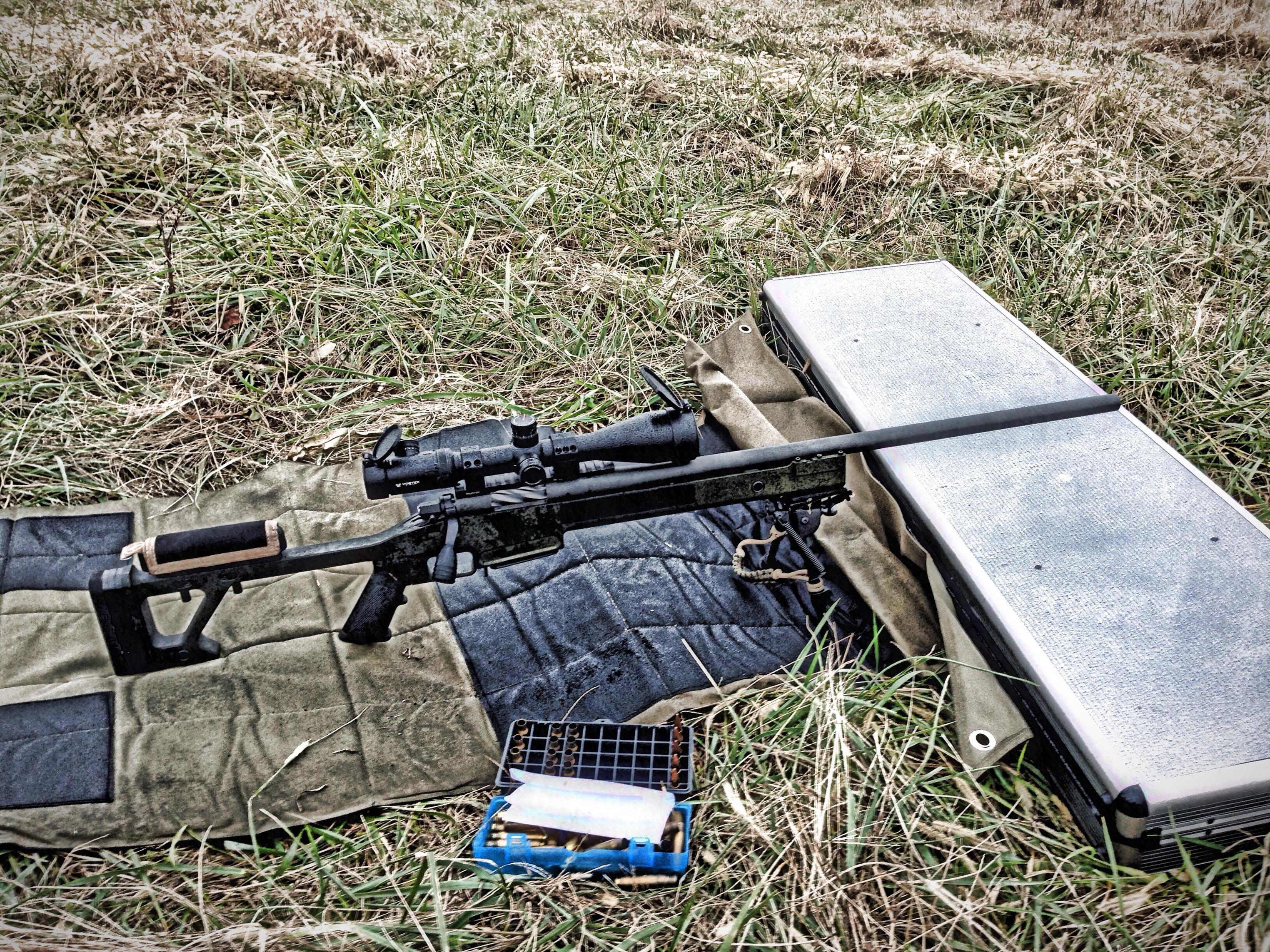

Looks like an excellent starter build! If you have the itch for a more upgraded stock look no father than the krg X-ray chassis. Fully adjustable with a mag system for $550! Definitely post pics up of the rifle and groups! I started similar to you except with a sps varmint and this is how she sits.
Just click on the pics to enlarge them.

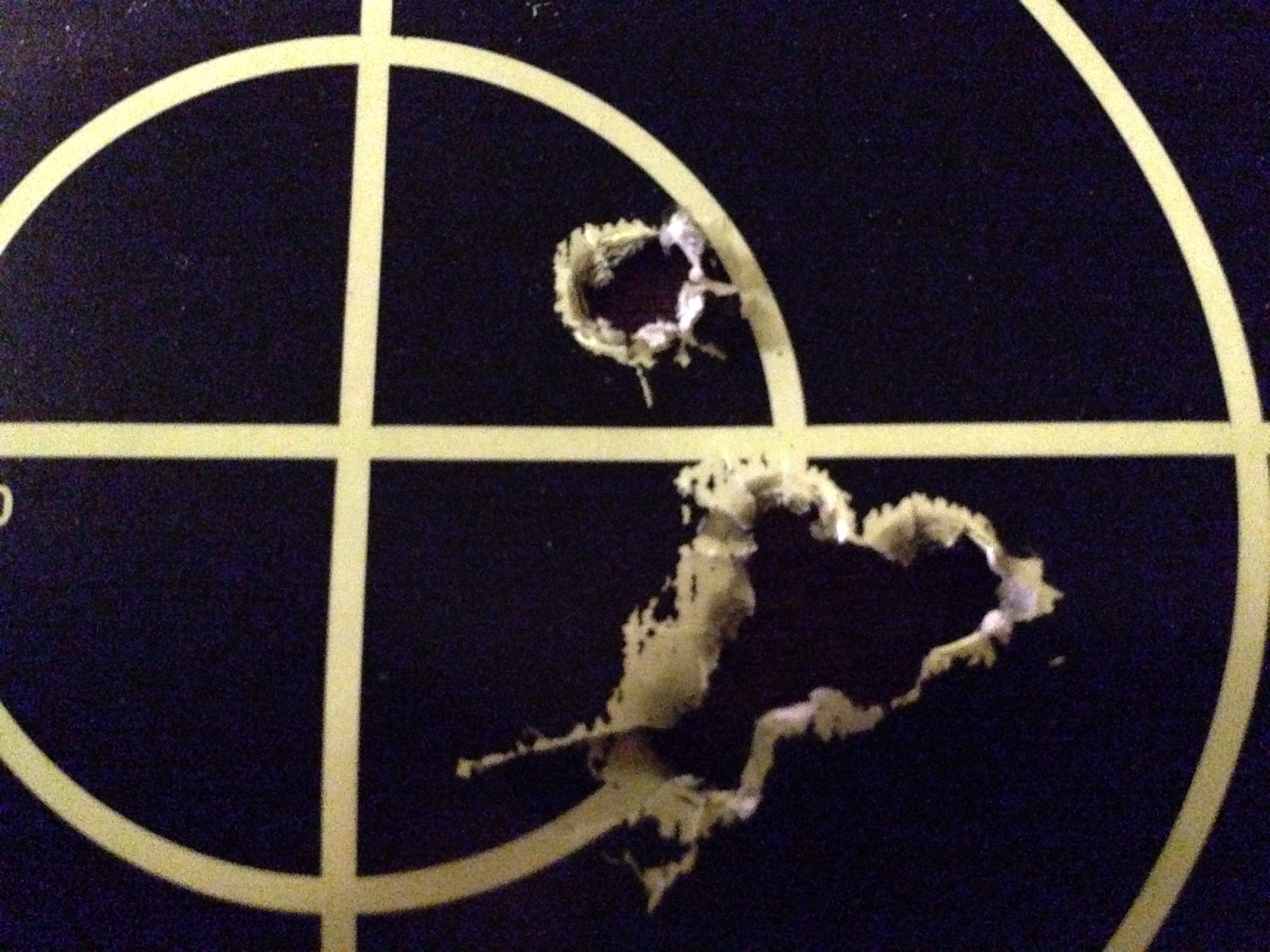

And this is a five shot group with 155gr lapua senars 44.5 gr varget with lapua brass! The one not touching the group was a cold clean bore shot!
