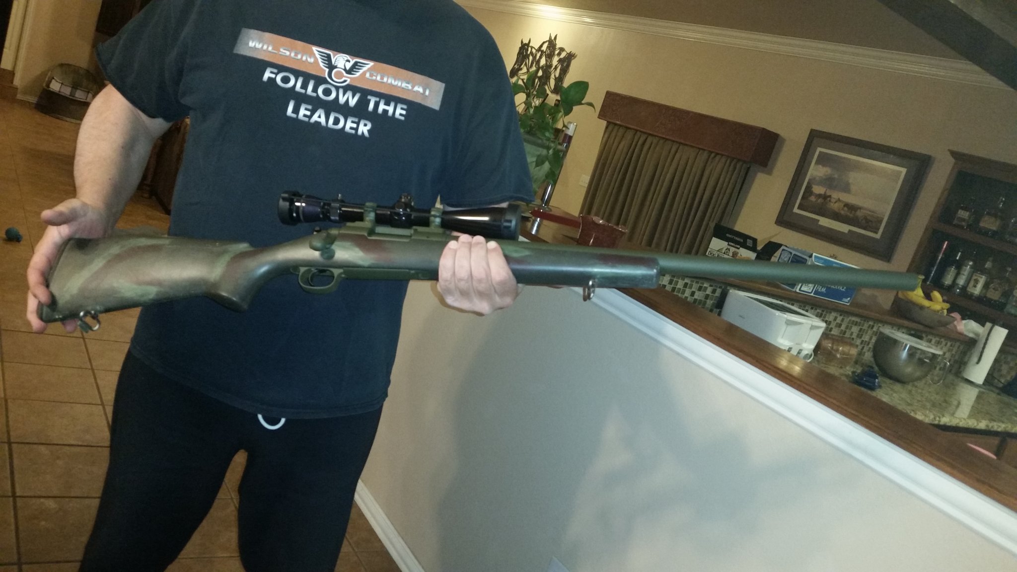

My best shooting rifle is a mutt I put together using parts spec'd for USMC rifles from the M40 to the M40-A5.
A fantasy gun but a fine tool none the less.
Who knows, perhaps my spec A1 built at PWS would shoot paper just as well, perhaps better, if I lost the MST 100 and mounted the Premier from the fav gun on it.
Its not 1979 anymore and its good to see these cousin guns paying tribute and still working.

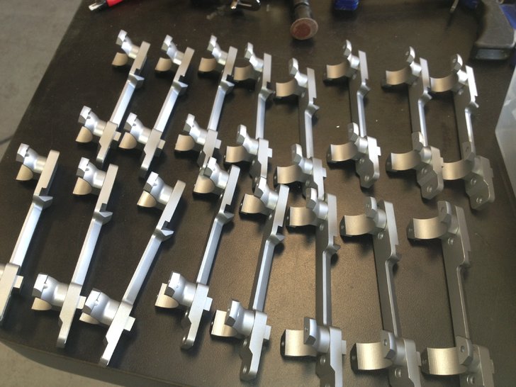

IMG_0129.JPG For the folks that have been contacting me for M40A1 scope bases, I am making a batch for a builder in MO. I am going to use all the material and make some extras. If you have been wanting one contact me I will have a handful of extras. PM, Email or text.

Thanks J!M. The money from the donated mounts will go to
https://www.gofundme.com/4j0uzs8
The eBAy seller won't be taking payment, instead the buyer will pay to Ms. Hannah's gonfundme page. We are currently sold out of mounts as we filled an order for a builder in MO. The only 2 remaining are the two that we donated. I have had requests for many more and I will cut more as soon as we get time for M40 projects. Thanks to all the customers over the years and please donate to these people who are suffering if you can.

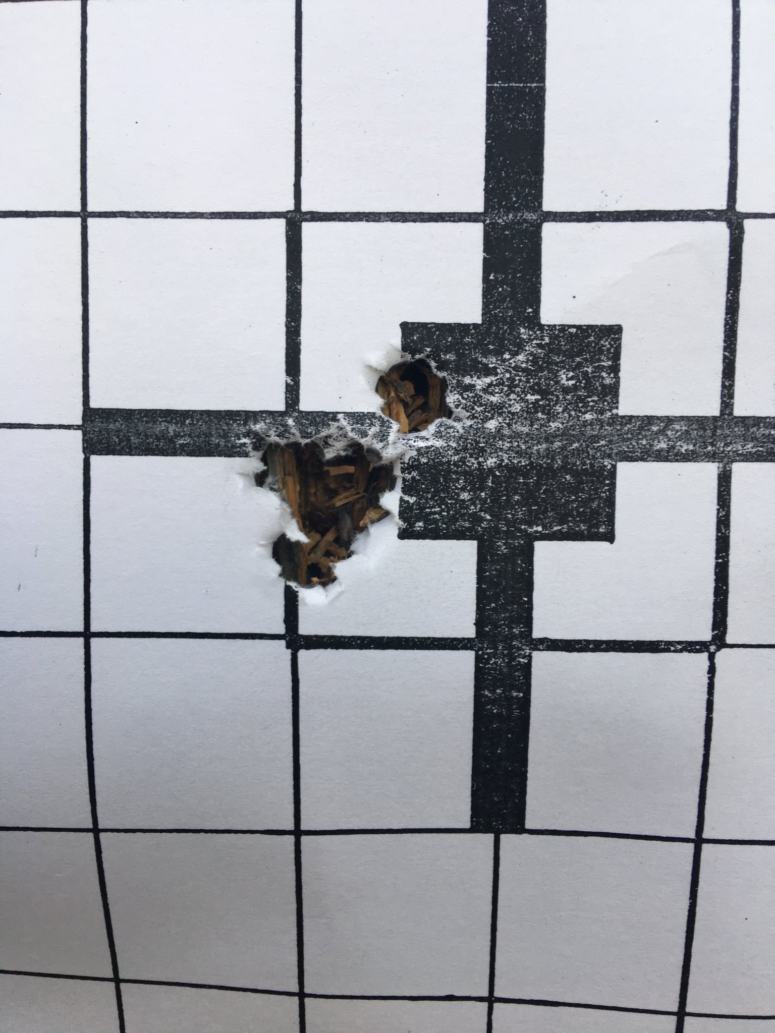

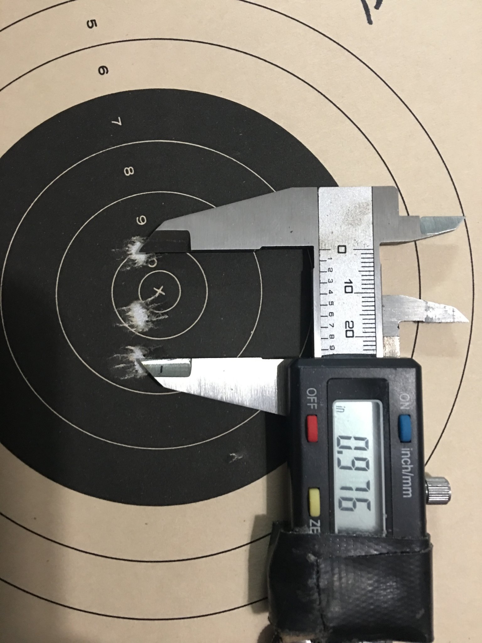

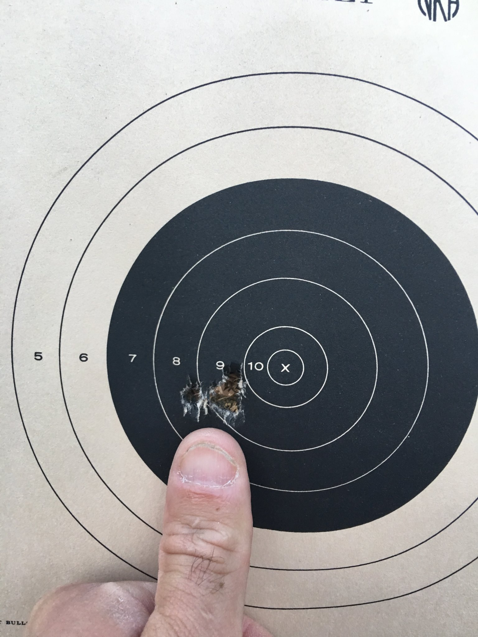

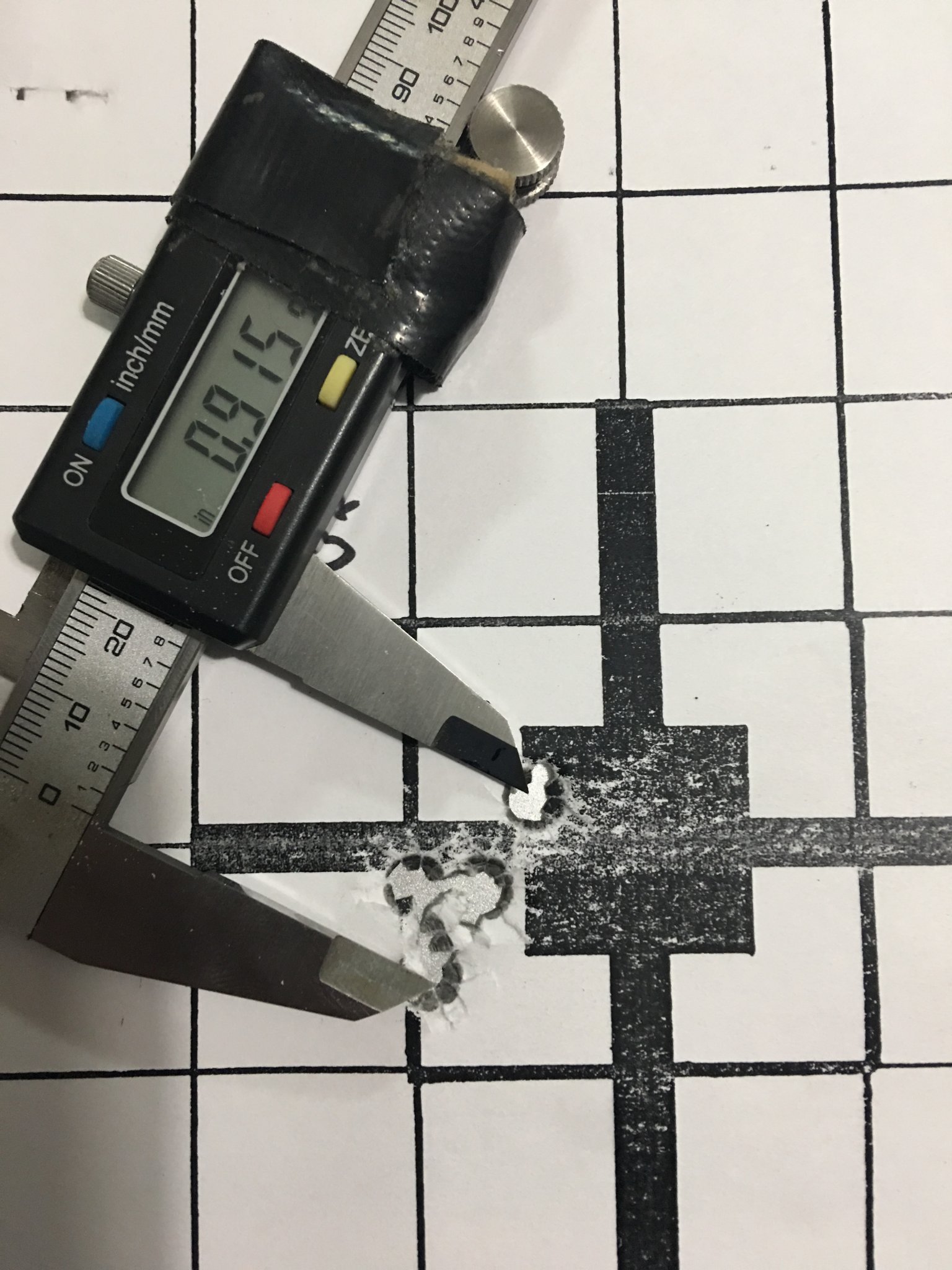

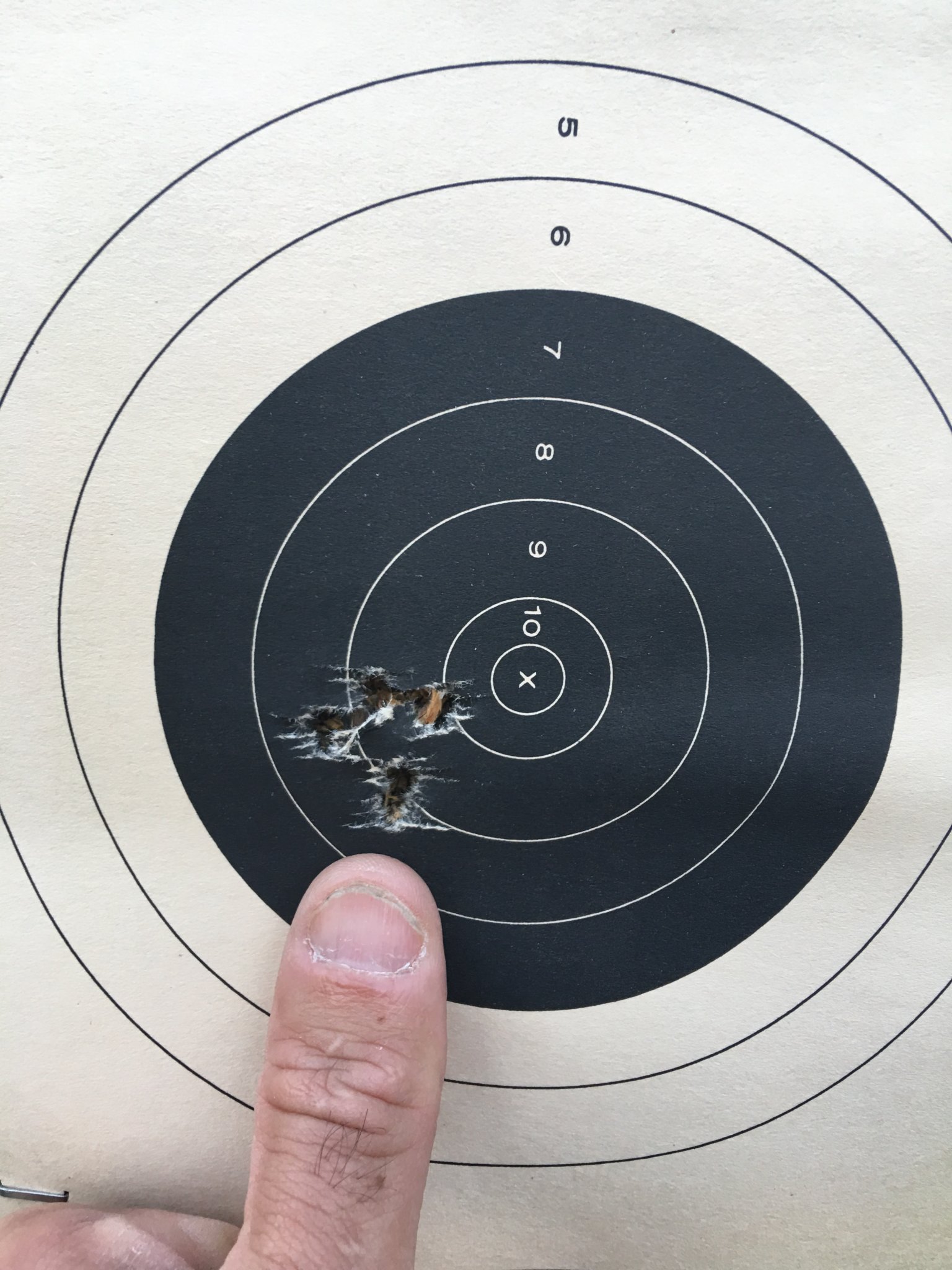

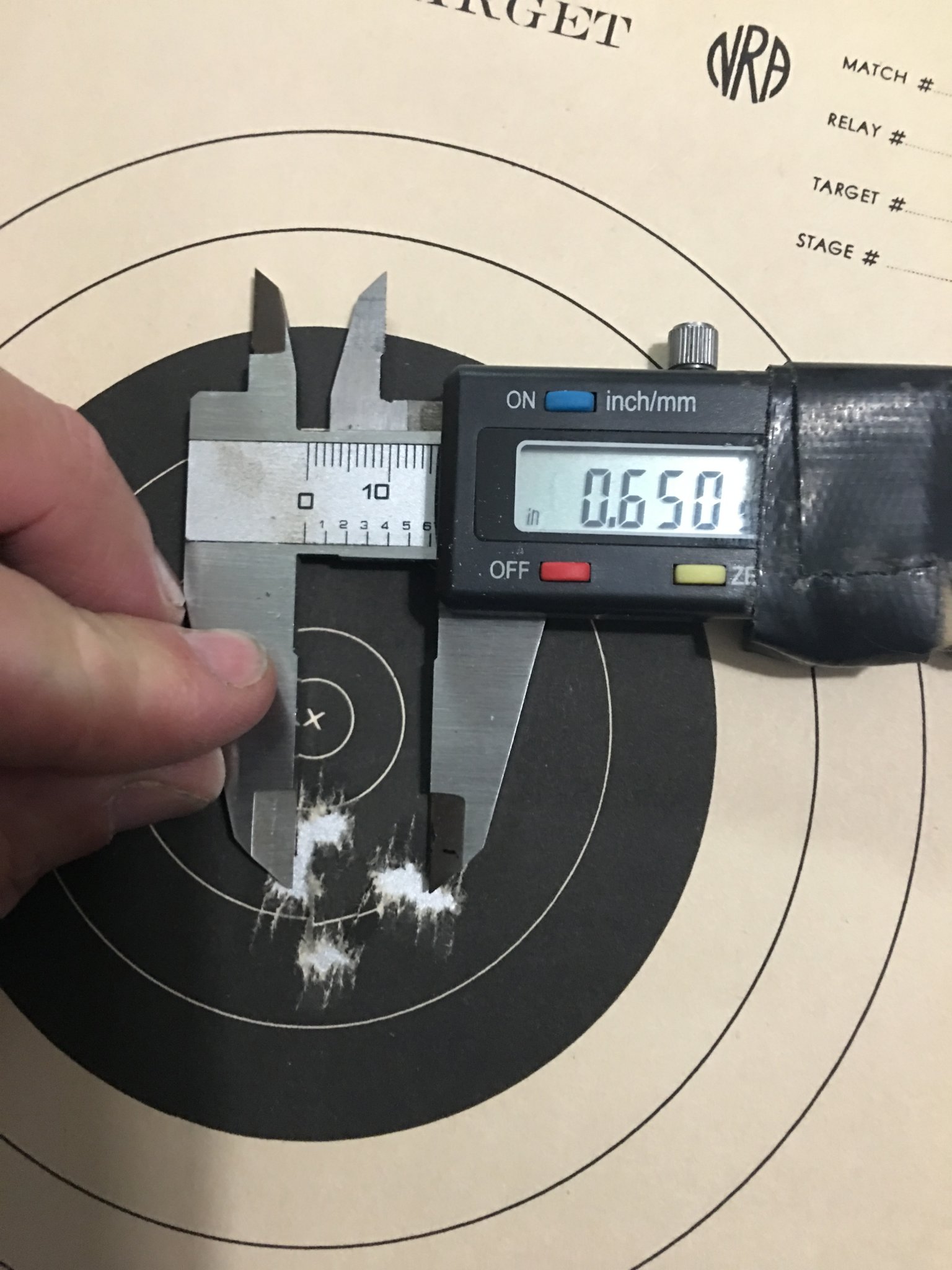

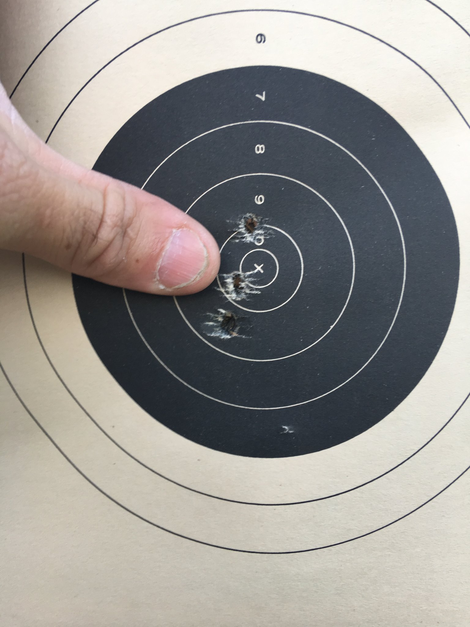

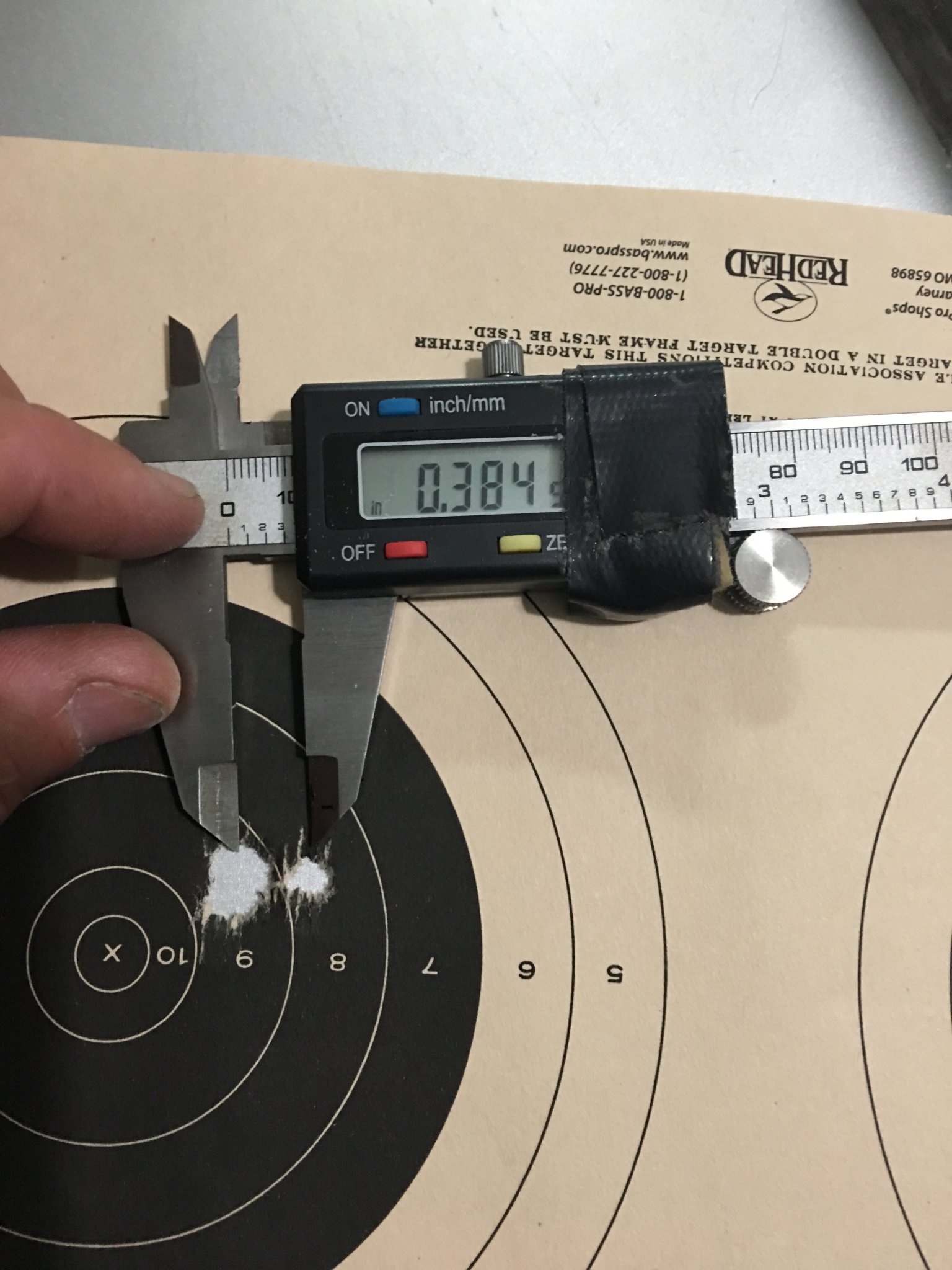

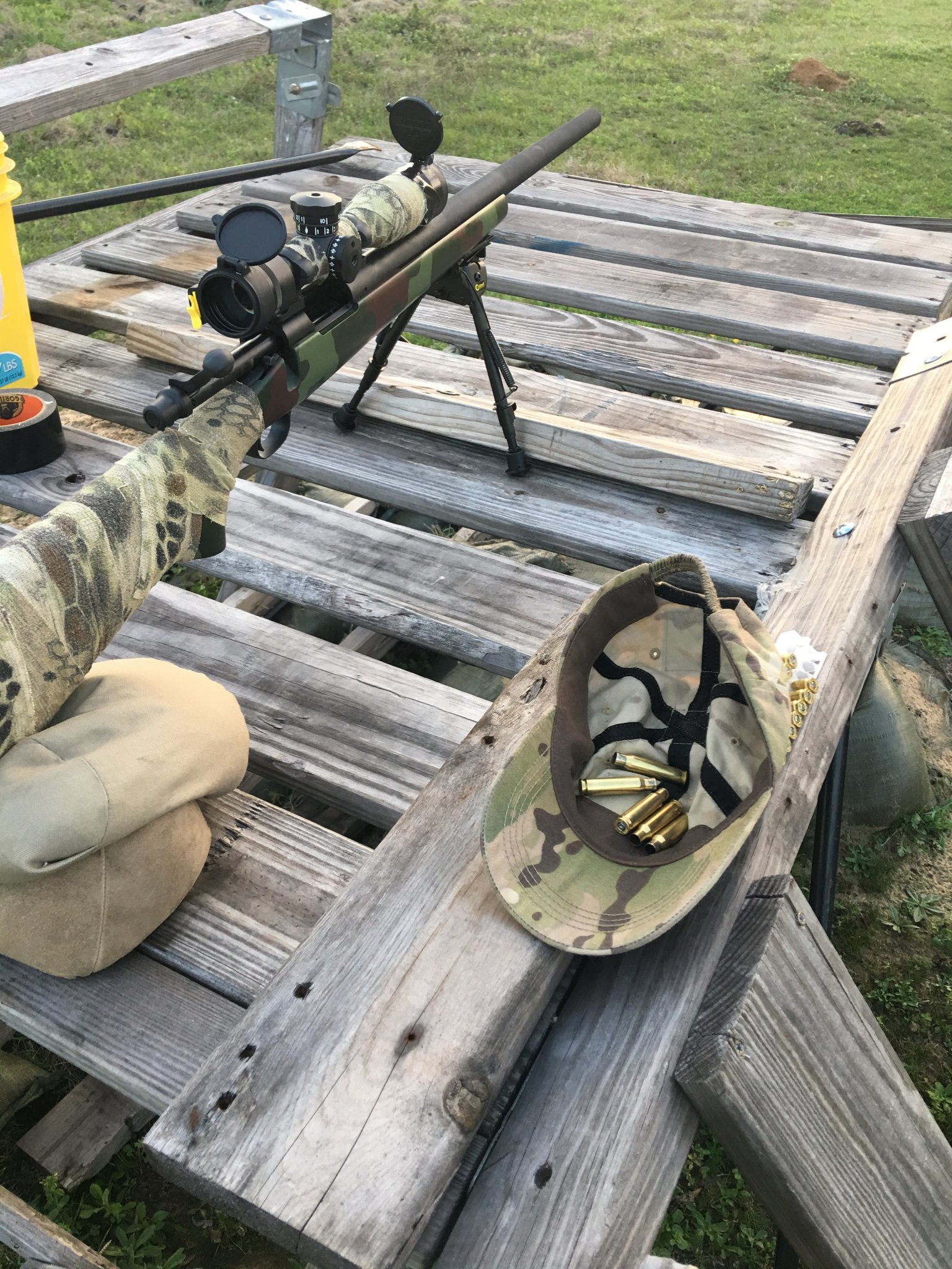

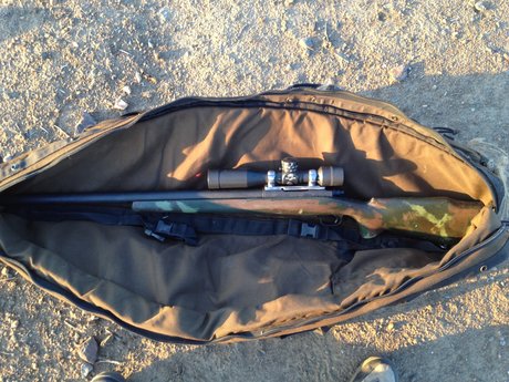

I took Reyvn out Saturday afternoon and ran rounds 16-33 through her. Ammo was FGMM 175. This was the first session on the flat range which is 104 yds. I had previously shot from the second floor of the garage which is a 92 yard overground distance and about a 94 yard hypotenuse. I noticed I still need to come right on the MST to have a perfect zero but I wanted to get rounds downrange and as long as the groups were decent I had decided to keep shooting. The target pics with my thumb were taken while the targets were on the stand. The one without my thumb has 1”squares so no need for a reference. The target pics with the calipers were taken at the kitchen table when I had the calipers so the orientation of the groups looks funny but keep in mind that in reality all groups except the first were slightly left and a hair low of center.
My position wasn’t ideal. I had a bipod braced against a board out front and a poly bead bag on a leather sand bag at the rear.
First three. Cold gun, cold shooter
Five
Beauty shot out of order
Second 5
Third 5

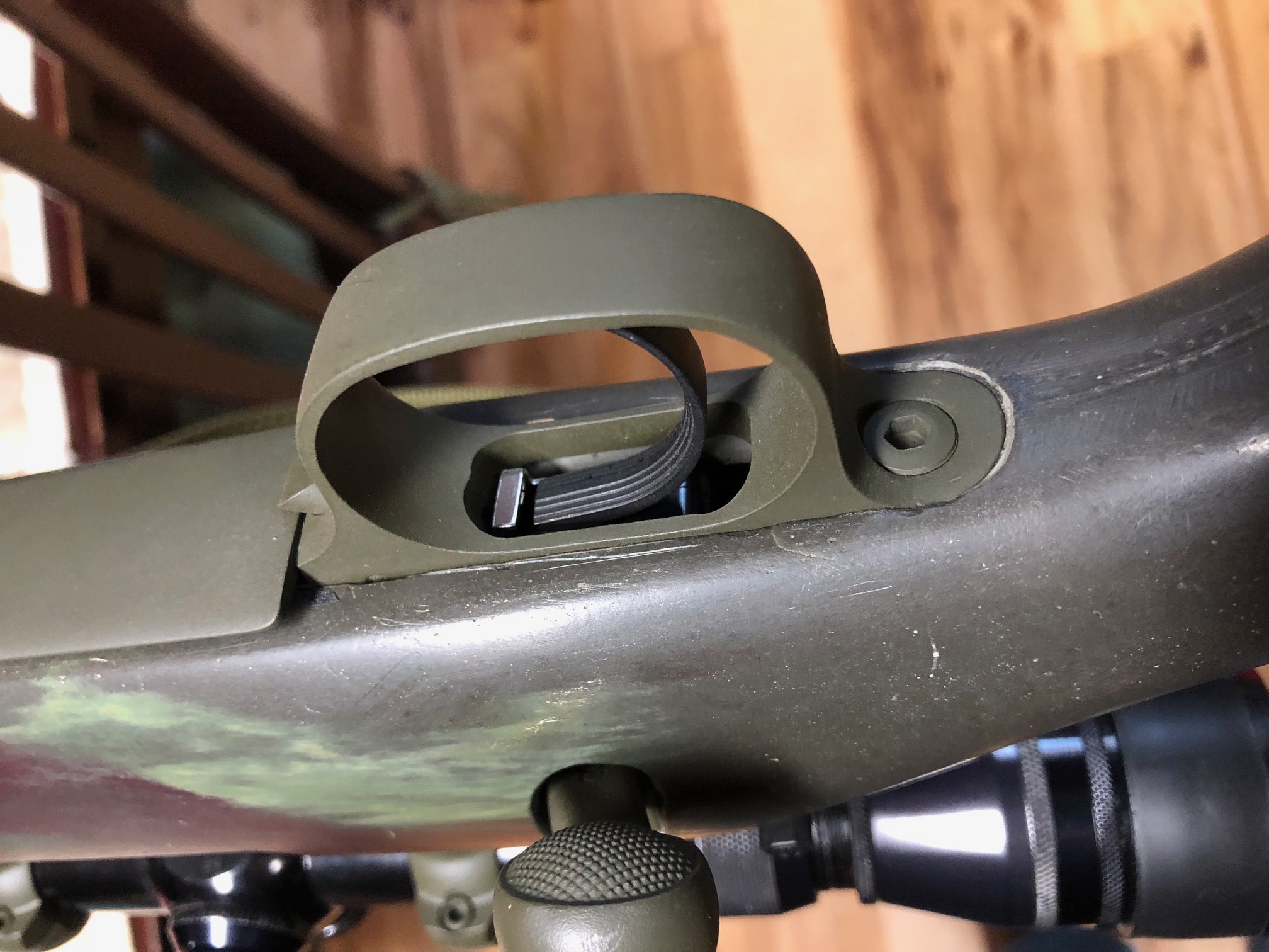

For those interested in a trigger for an M40A1 without heavy modifications, this information may be helpful. I built a rifle on a this Return stock 2 years ago. I replaced the Timney trigger (installed new when the rifle was built) with a TriggerTech trigger. The Timney trigger failed. I am not interested in a Remington era trigger from back in the day.
With the TriggerTech trigger I had to grind down the bolt release on the trigger for it to seat properly. Other than that, the new trigger fit perfectly. I like this one for the grooved trigger surface for finger pad placement. Time will tell how well the new trigger works out. There may be other triggers out there that I am unaware of that will fit in a return stock without heavy modifications. This is just an option.

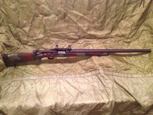

Got the parts in hand for a M40 build.
The preferred builder is no longer building.
Who can do a proper build these days? Who can cut a legit clip slot/thumb relief spec build?
M40 or M40A1?
Both can be done at GAP, but need to specify you want the M40 clip slotting vs the M40A1 if that is what you are looking for. GAP can also do the US stamp and proper barrel markings if doing a M40 build.

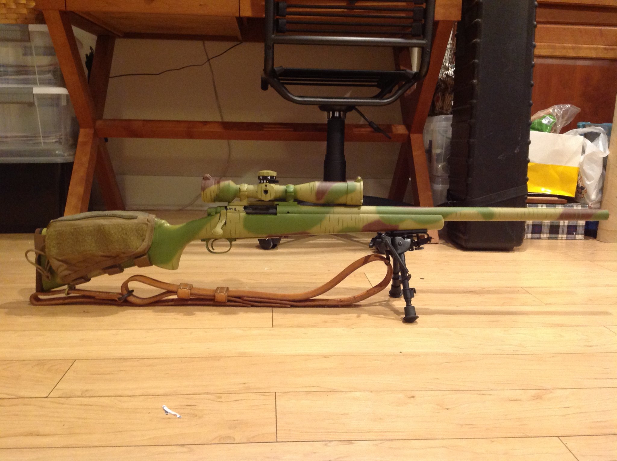

GA does absolutely supreme work. Feels like I just checked it out of the armory. And Iactually carried an A1 in Iraq. In 2005. That is until another guys Mod 0s’ mildots melted while still on the wire. So he got my scope. Everyone else had an A3 with USO Mods or Mod 1s. One guy actually Used his own Leupold M1 Mk-4 in country. I got mine for just over 5Gs already put together, GA rifle, correct ring/mount, MST 100. All never fired........I’m just a lowly swine. Never went to school. But, now I have a few rifles from when I used to be dangerous. After my children, my M40A1 is my most valued possession. If I were homeless and needed to eat, I would not sell it.
