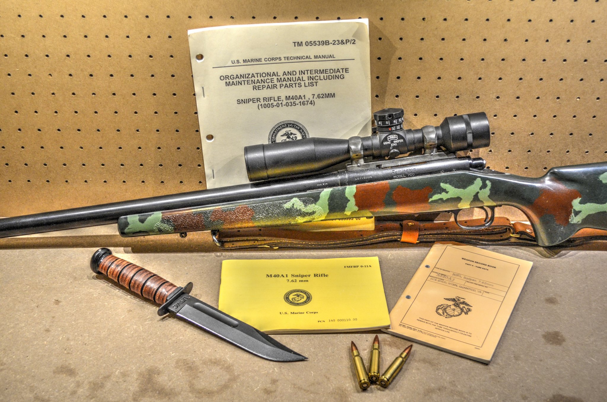

Opened up one of my old gear bags and found a Kabar at the bottom. Every M40A1 needs a Kabar :LOL:

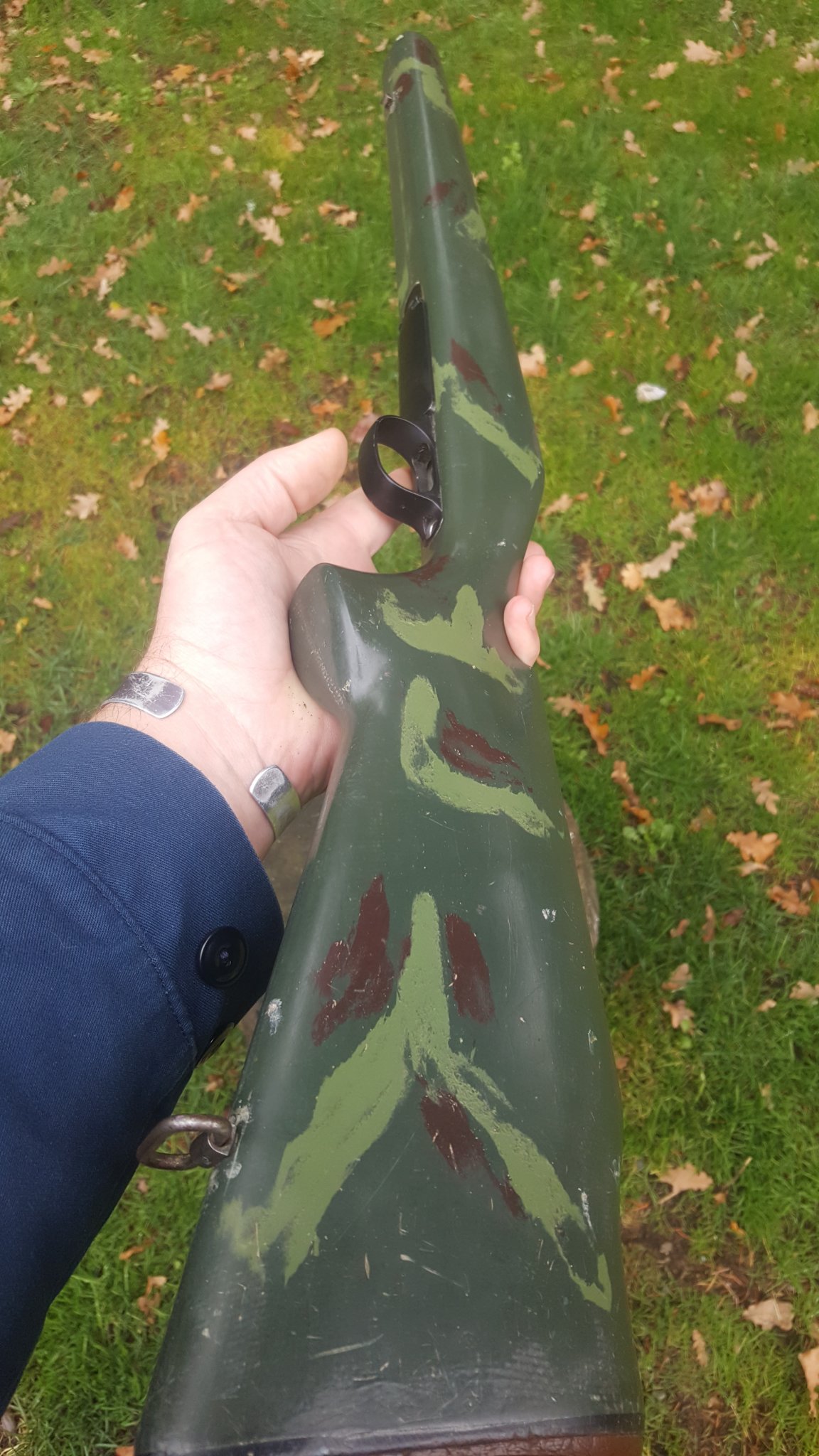

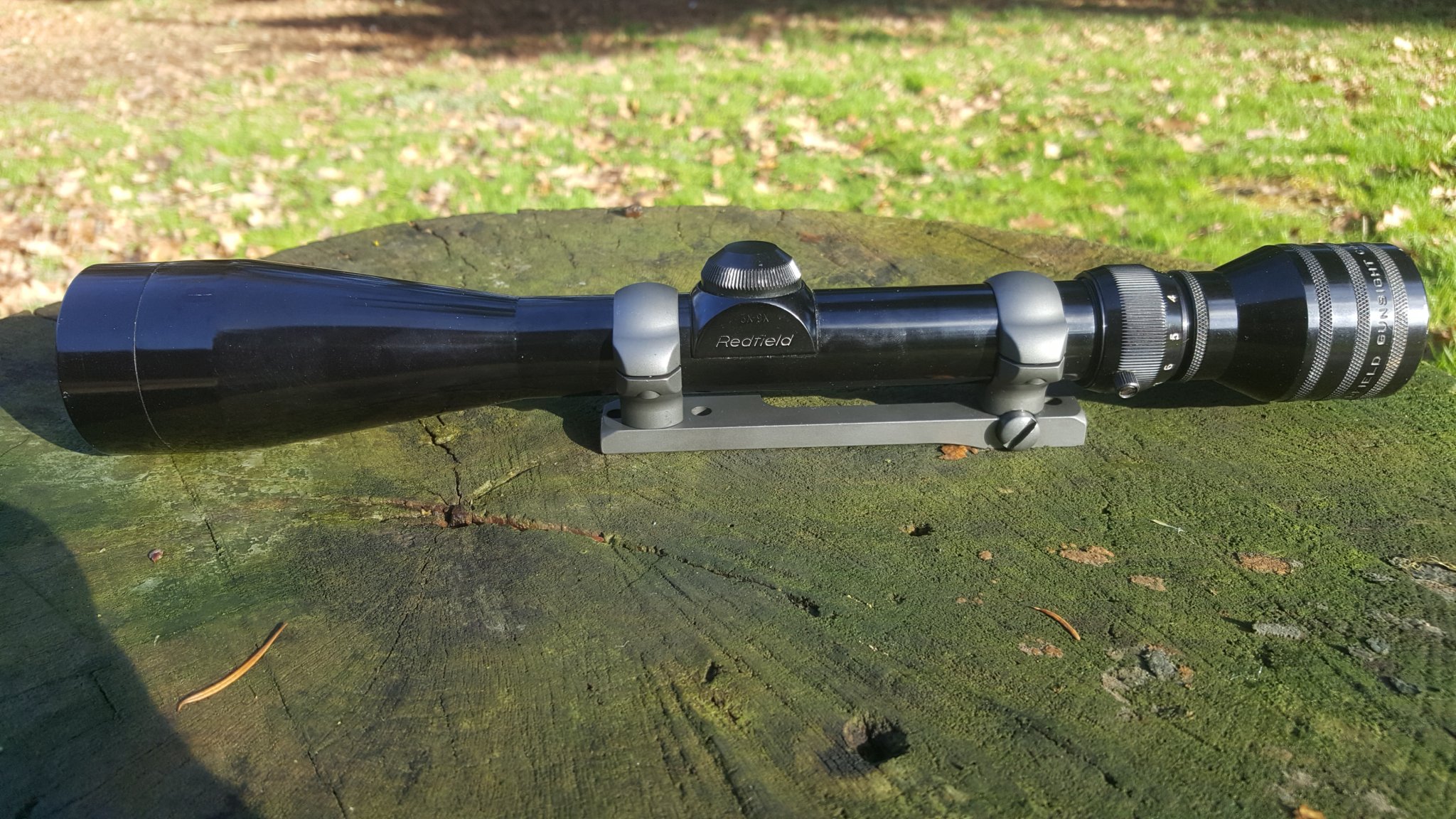

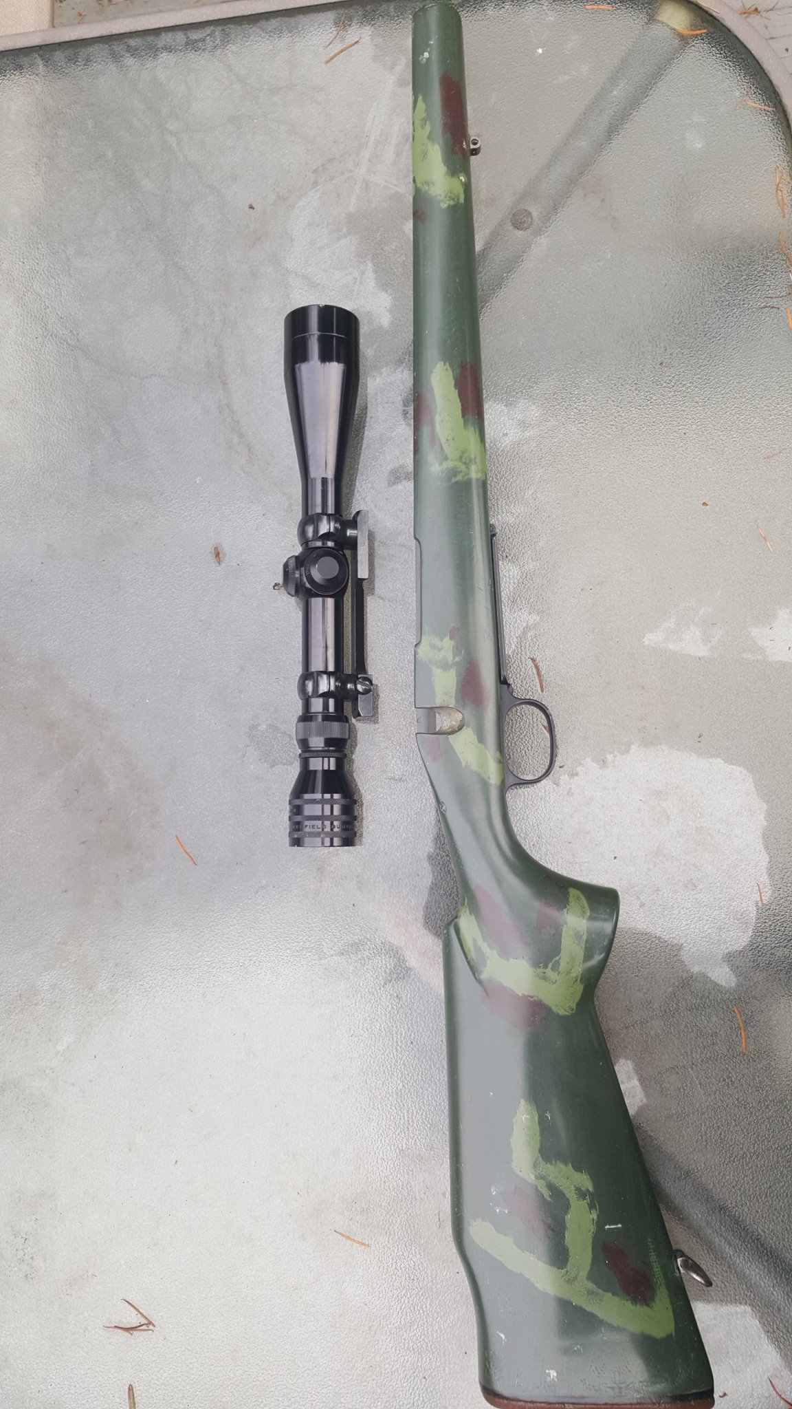

Seeing that today is both the USMCs and my birthday- figured this would be fitting. Snagged another return stock on Friday from a 100% solid member here (thanks again man) I'll be building an early gun off of this one with either a Redfield 3x9 or Weaver T10. View attachment 7180681View attachment 7180683View attachment 7180684
Wow that must be an early one.
No concept of camouflage. Just dragging a booger hook coated with color through the mold.
Awesome looking stock!

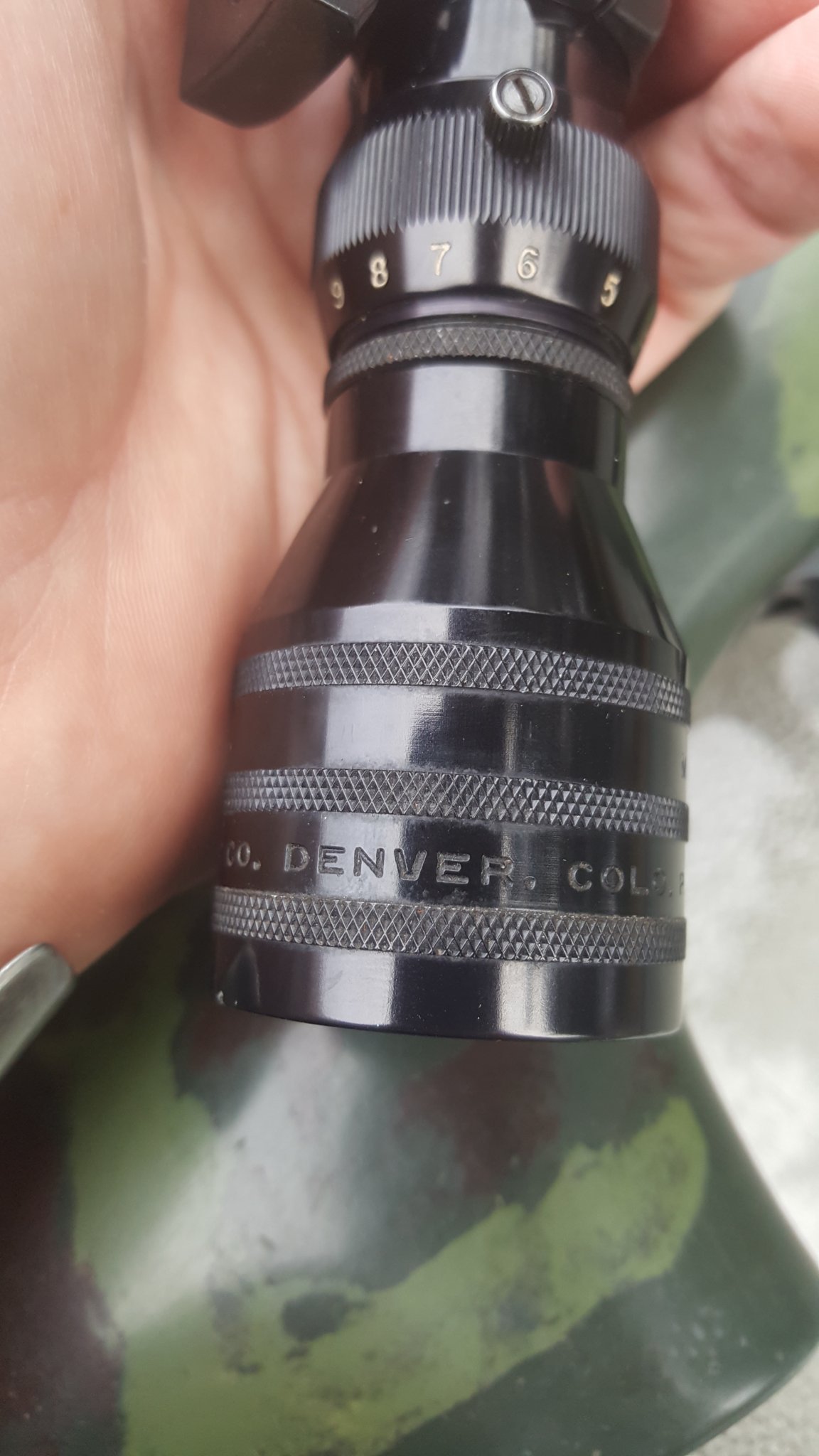

Still poking away at my early a1 build. Hart barrel on order, found a Denver era Accu-Range, parkerized the rings and base the other day (welding next) and still searching for the right 6 digit. Getting closer.

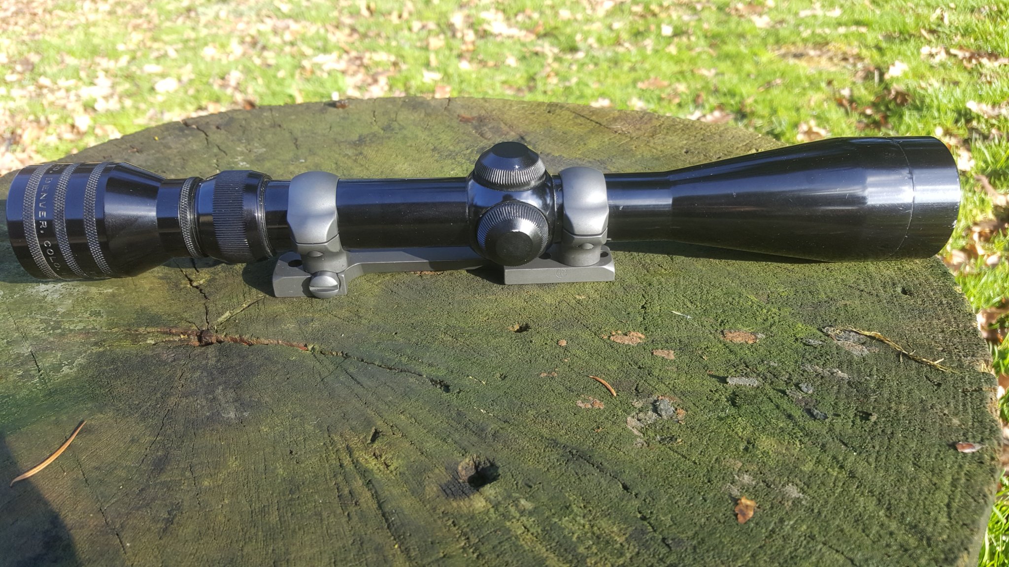

View attachment 7218201View attachment 7218203View attachment 7218204
The A1 transitionals also used 700SA bases, so there's no need to weld up the corners (unless you like the squared corner look). Some 40X bases even had rounded corners, so it's a mixed bag on appearance. Just make sure you have 4 welds per ring, don't weld the windage screws to the base, and you'll have to mill out the front ring in order to access the front receiver screw. Here's a few pics of an original USMC welded 700SA mount:

The welding of the rings is the plan (leaving the chipped corners) Great info/pics- thank you!

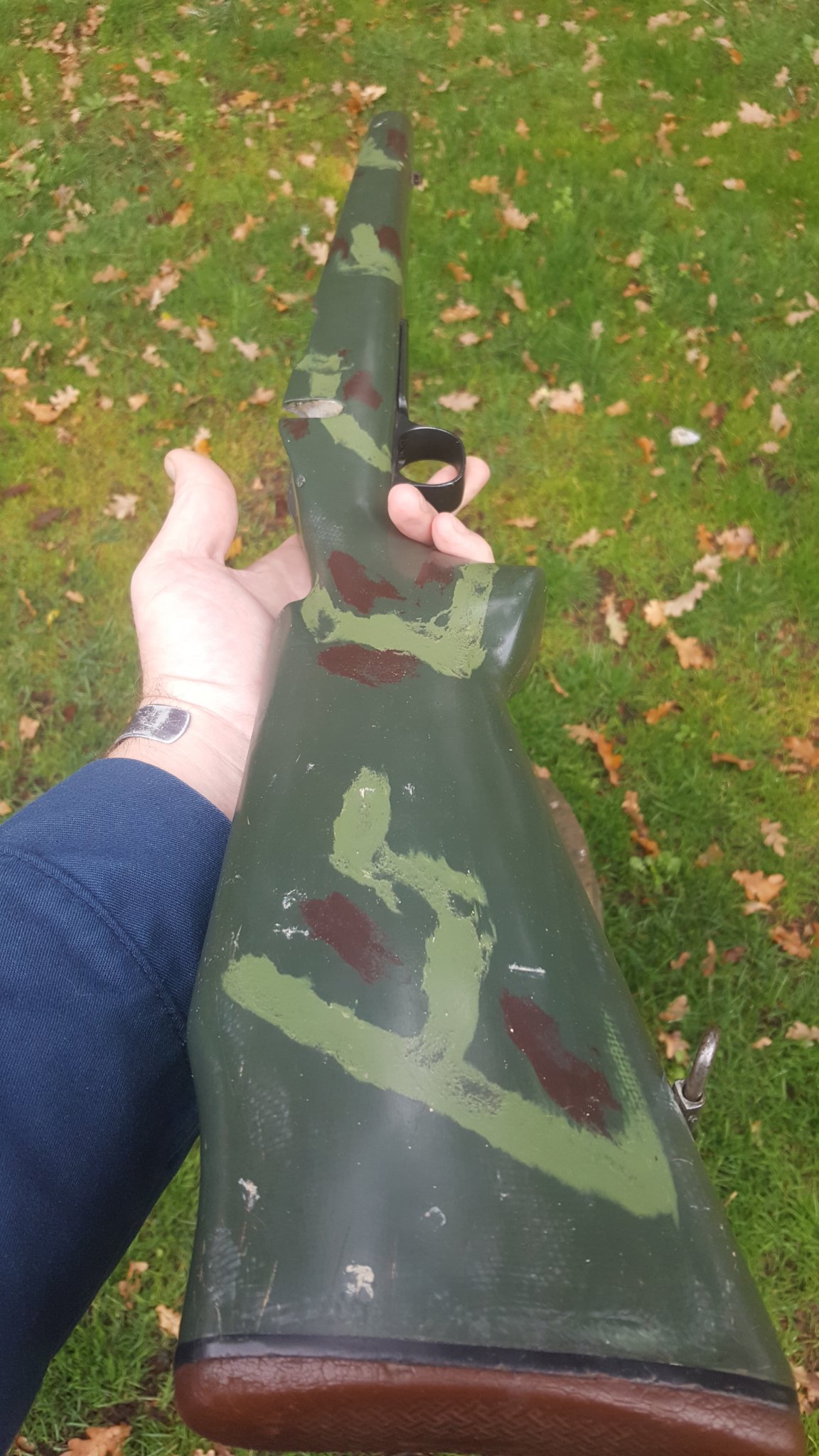

Was that the last four on the stock? Was this your service rifle or clone rifle? pics help

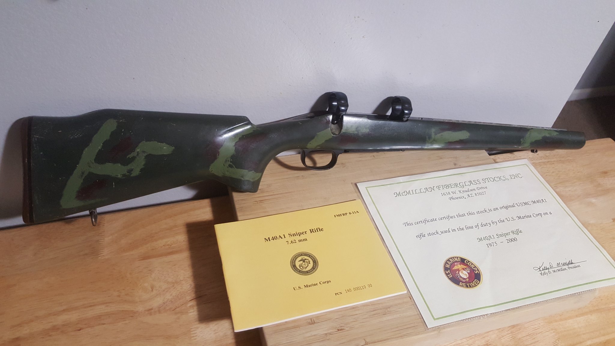

From Dick Davis at McMillan stocks.....
The early so called “smear” patterns were made with the old semi-translucent dye based color concentrates and were only produced for about the first two years of production, from about 1974 thru 1976 (about 200 stocks). Then the more opaque milled color concentrates became available in about 1977 and all the subsequent stocks thru the early 1990’s were made with them ( about 800 stocks). The camo pattern is the “Forest Camo” color, not the Woodland camo.
Regards, McMillans
Mine? It was a GAP built clone on a field painted smear stock. 5899 were the last 4 of the E prefix serial number and the MST100 was also special ordered numbers matching 5899.

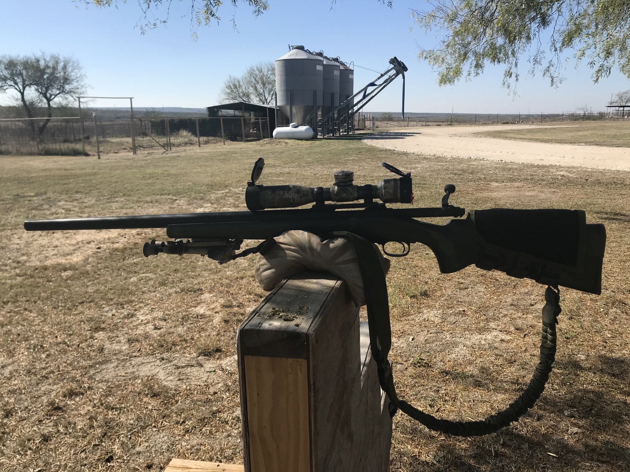

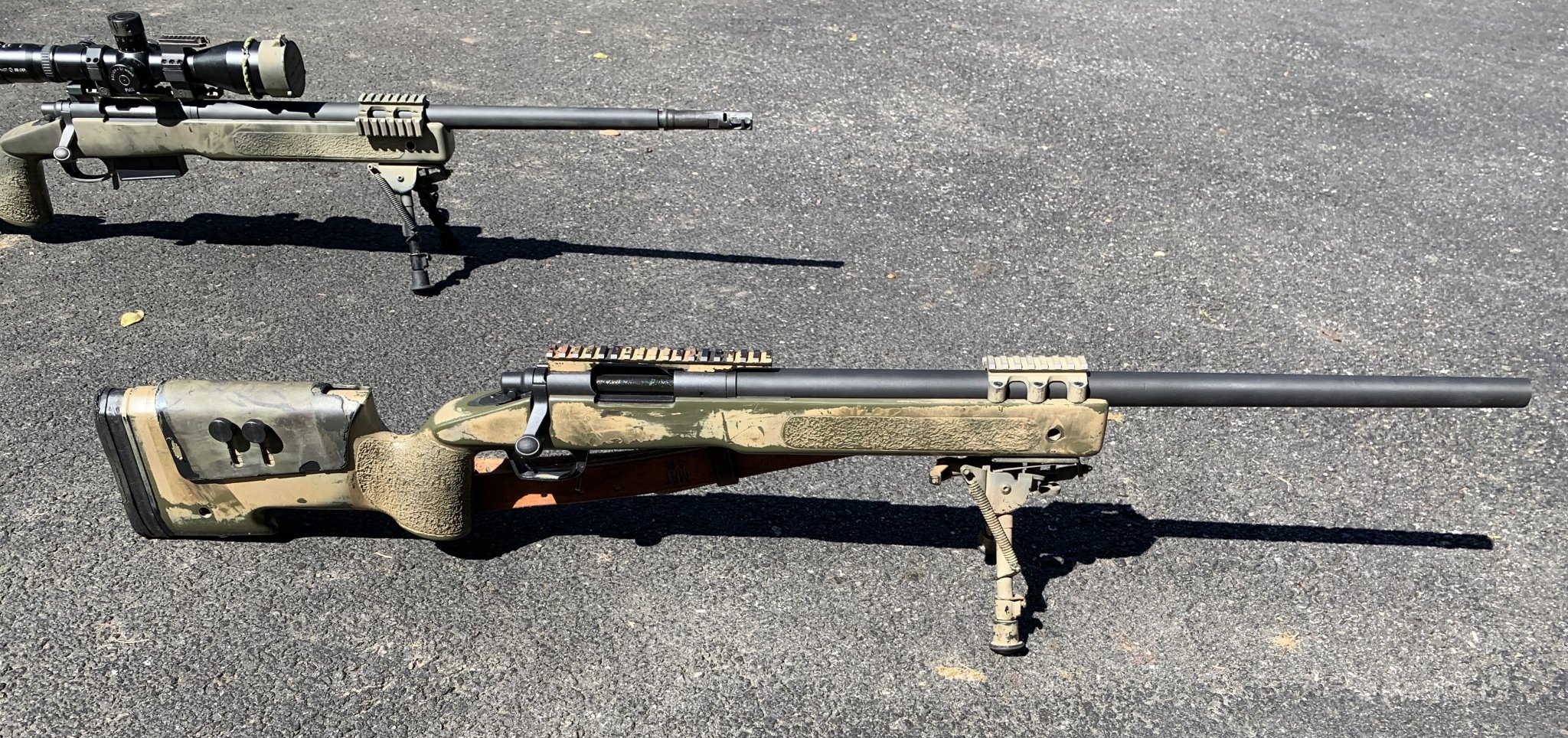

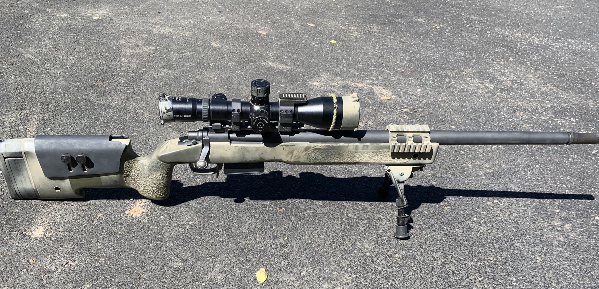

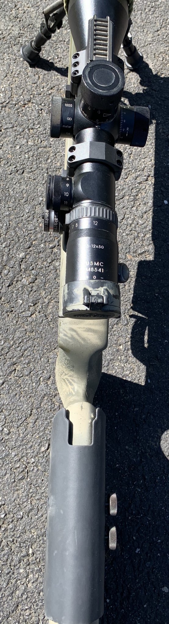

I figured I would add a little to this thread. I had to grab a random bipod for the A5 for the photos. I also included a demilled retirement/presentation m40a1 into the pictures. This has been the culmination of years of collecting a part here and there.
SUPER NICE! Are the A4 stocks both issued stocks? I'd sure like to find a 8541 scope like that, but the last one that I was offered was out of what I could afford at the time. Where in TN are ya, I'm in Nashville.

Yes sir. I was outside Memphis. Thanks!
