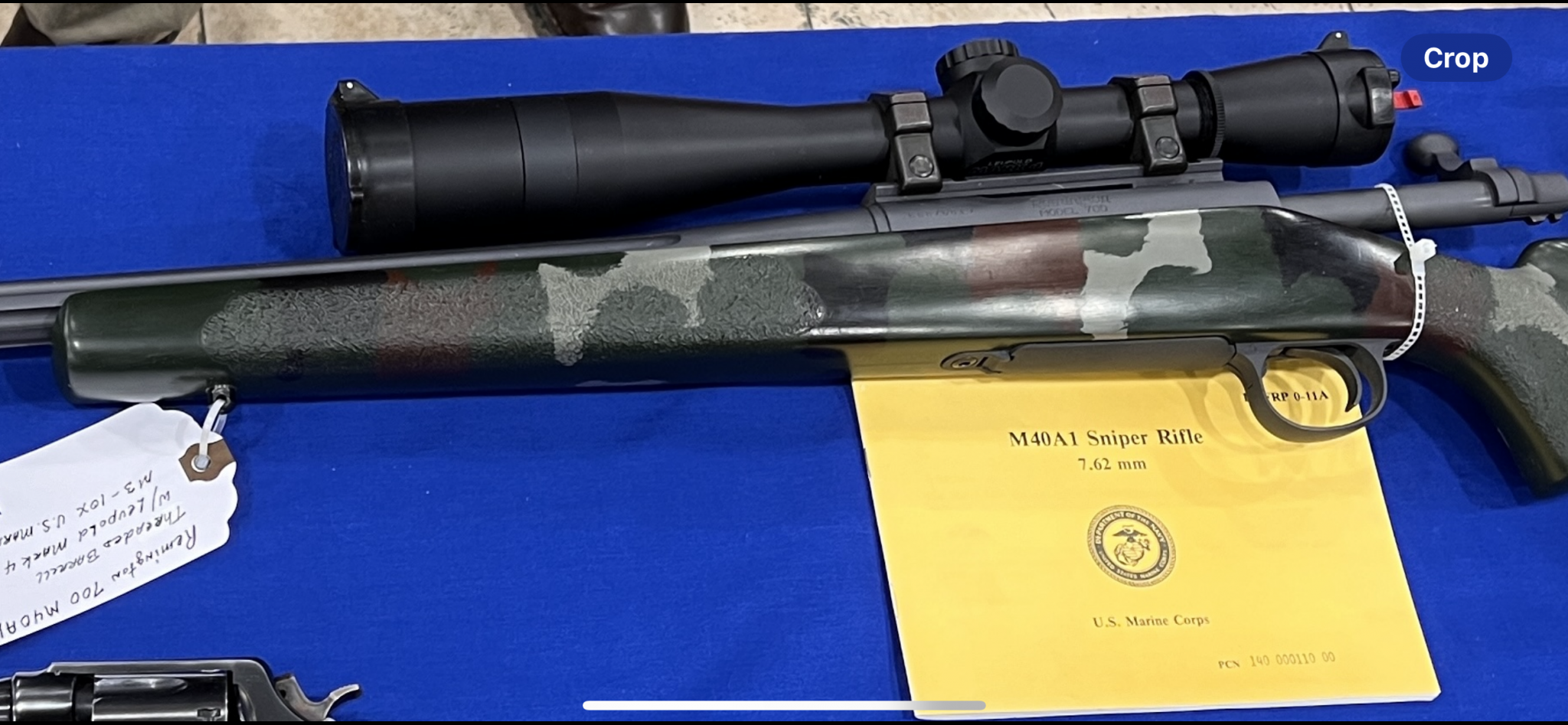

Couple nice M40A1 pictures I found tonight:

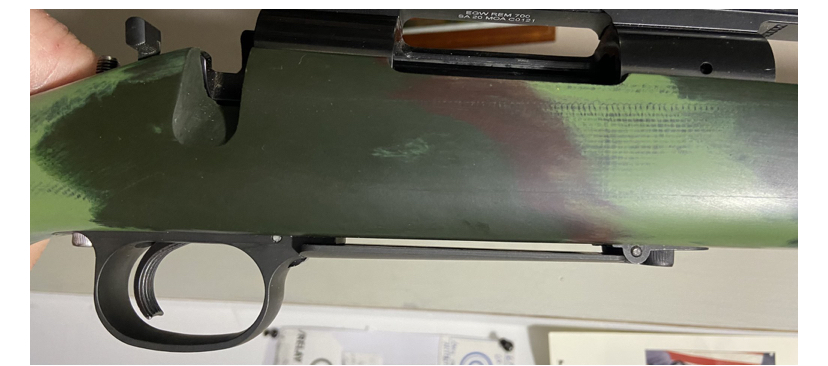

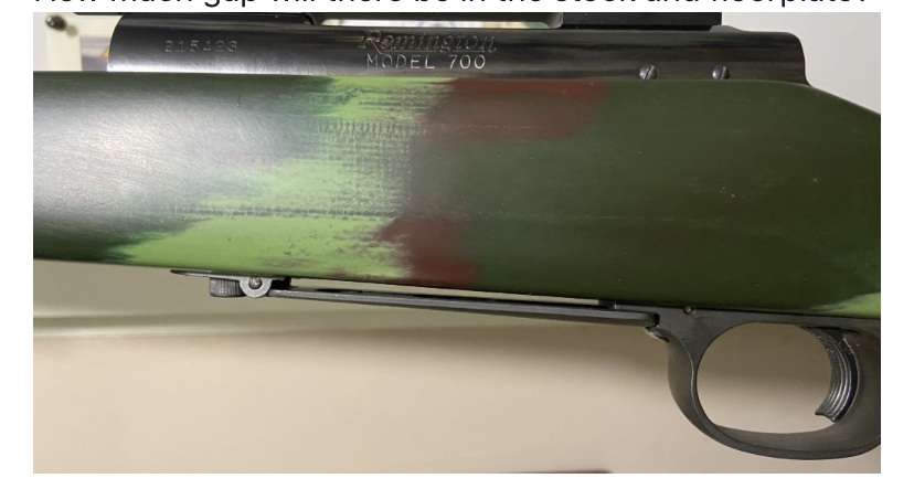

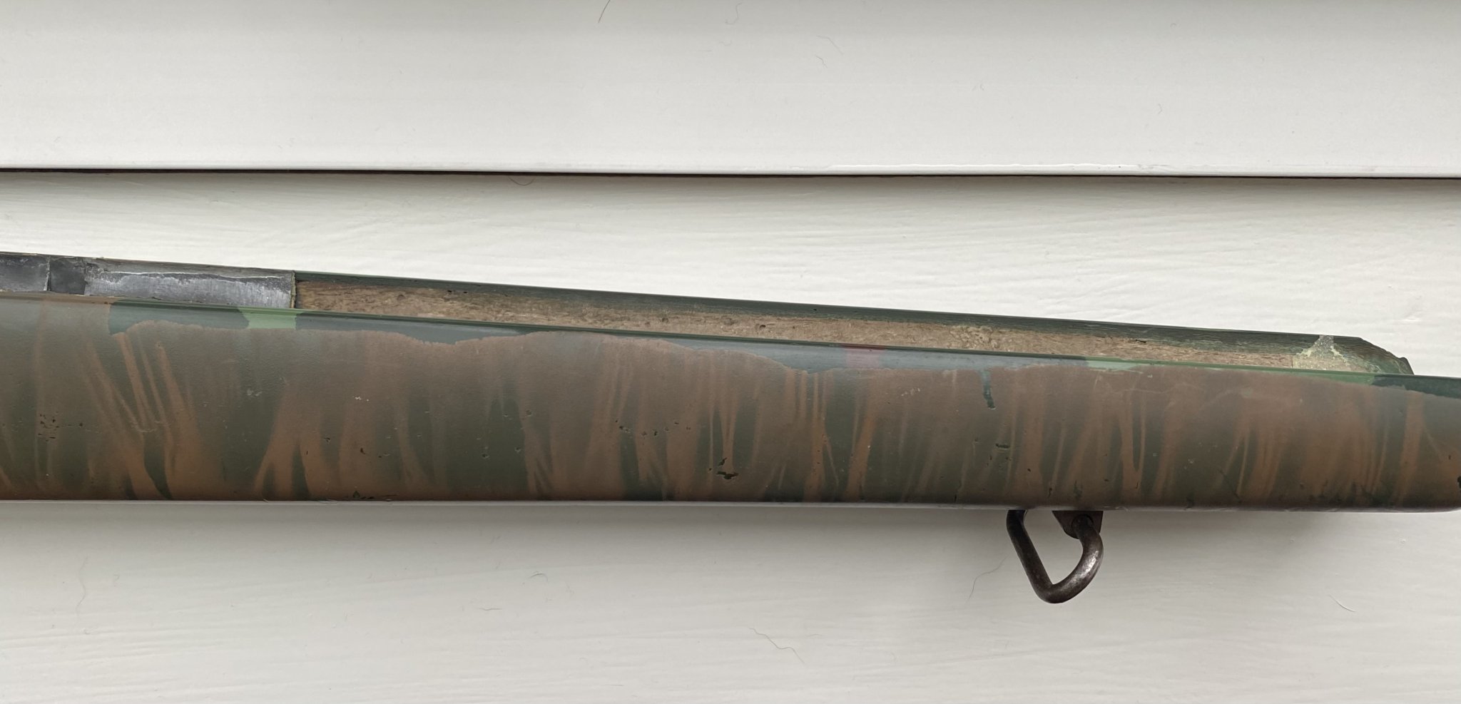

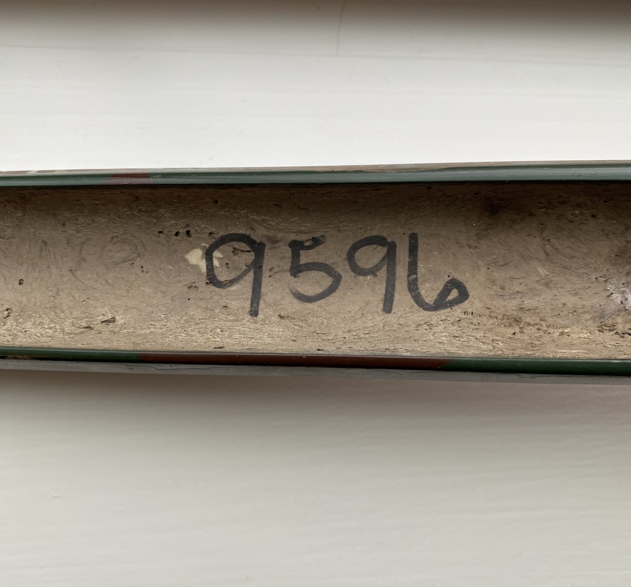

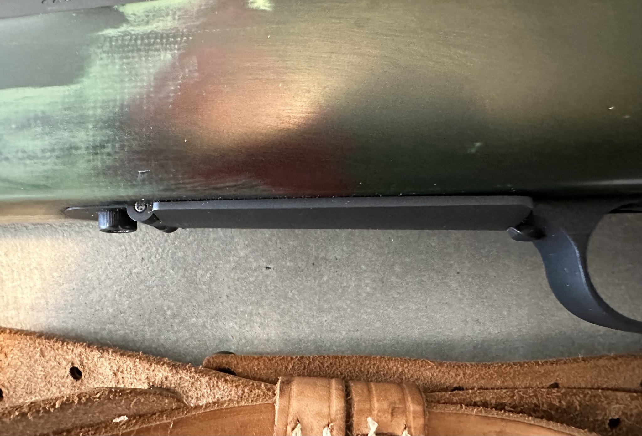

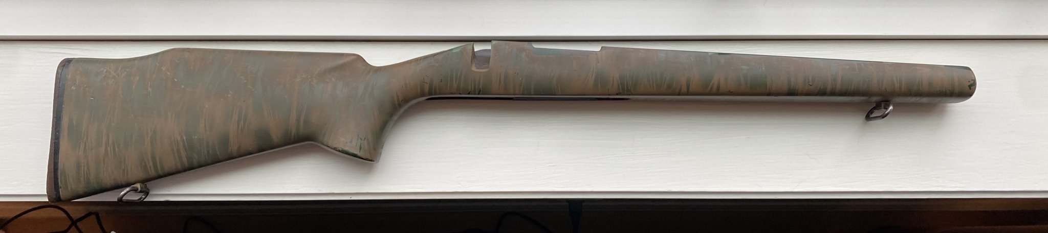

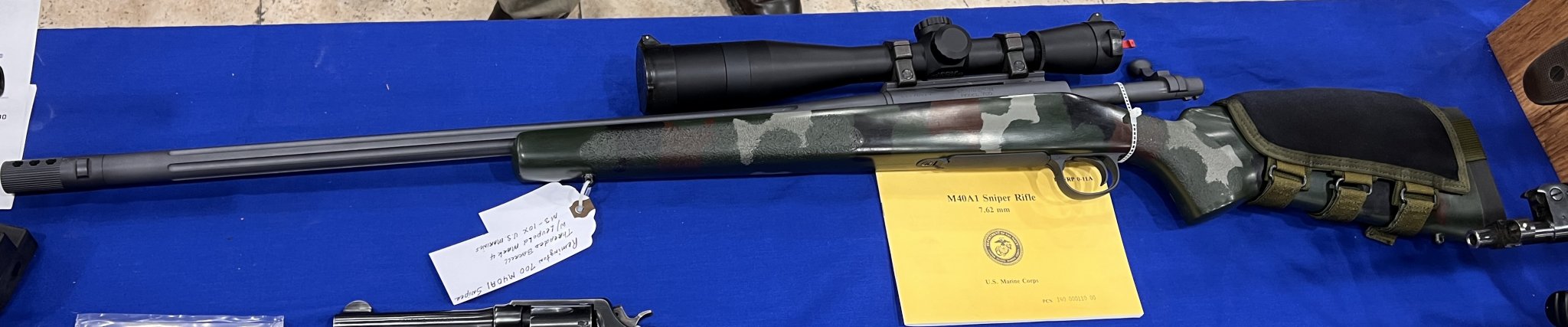

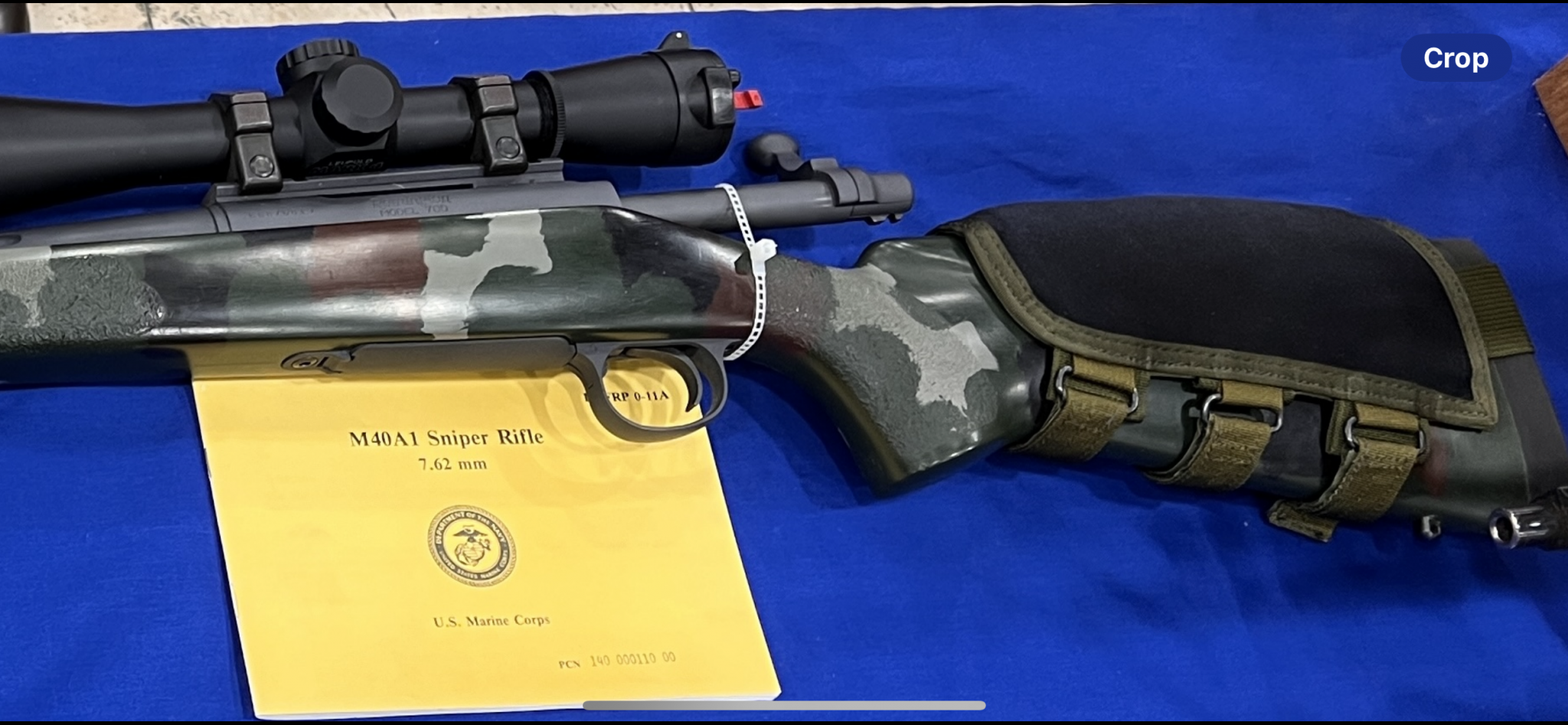

Can anyone provide any assistance ID’ing or any knowledge about any M40ish rifles Remington’s Custom Shop built? I say this very loosely for this reason: A nice but older gentleman at a local gun show has this rifle he stated he got from the wife of his friend that passed away. He also stated that the fella that passed away waited 6+ months to order the rifle directly from Remington.
It’s an E series prefix (so definitely older), inscribed Remington 700, possibly a PTG or Badger bottom metal, smooth faced trigger, not clip slotted, fluted barrel, and a recognizable muzzle brake/suppresser host that I can’t recall. He’s calling it a M40a1, but apart from the smear stock I can’t see anything that shows it to be anything other than a custom built 700. It has badger rings and a mark 4 10x fixed scope. Condition is 10/10, fella said he didn’t think his friend fired it. Obviously there is no paperwork, just word of mouth. Any help or leads as to just what this is?!

Unfortunately, thats nothing like an M40A1. Its a nice custom 700. And may have been inspired by the A1 and thr best the person could do.
I don’t think M40A1s were ever made by Remington or their custom shop. I think the A1 was a marine grunts and craft special. @USMCSGT0331 and @Redmanss and others can tell you more. Im just a cloning nerd.

I appreciate all the info! More so wondering if it’s possibly a custom shop gun. Trying to figure out that muzzle brake too. It has two indentations at 3 and 9 for a suppressor but I can’t place it. I knew it actually wasn’t an a1 or any iteration of a m40, however that’s what it was represented as by someone who obviously meant well but isn’t knowledgeable. There are no makers marks that would be typical of a custom rifle either on the action or barrel.
Wanted to share it here because I knew there were a ton of folks with a lot more experience and knowledge than I possess. Thanks for the info!

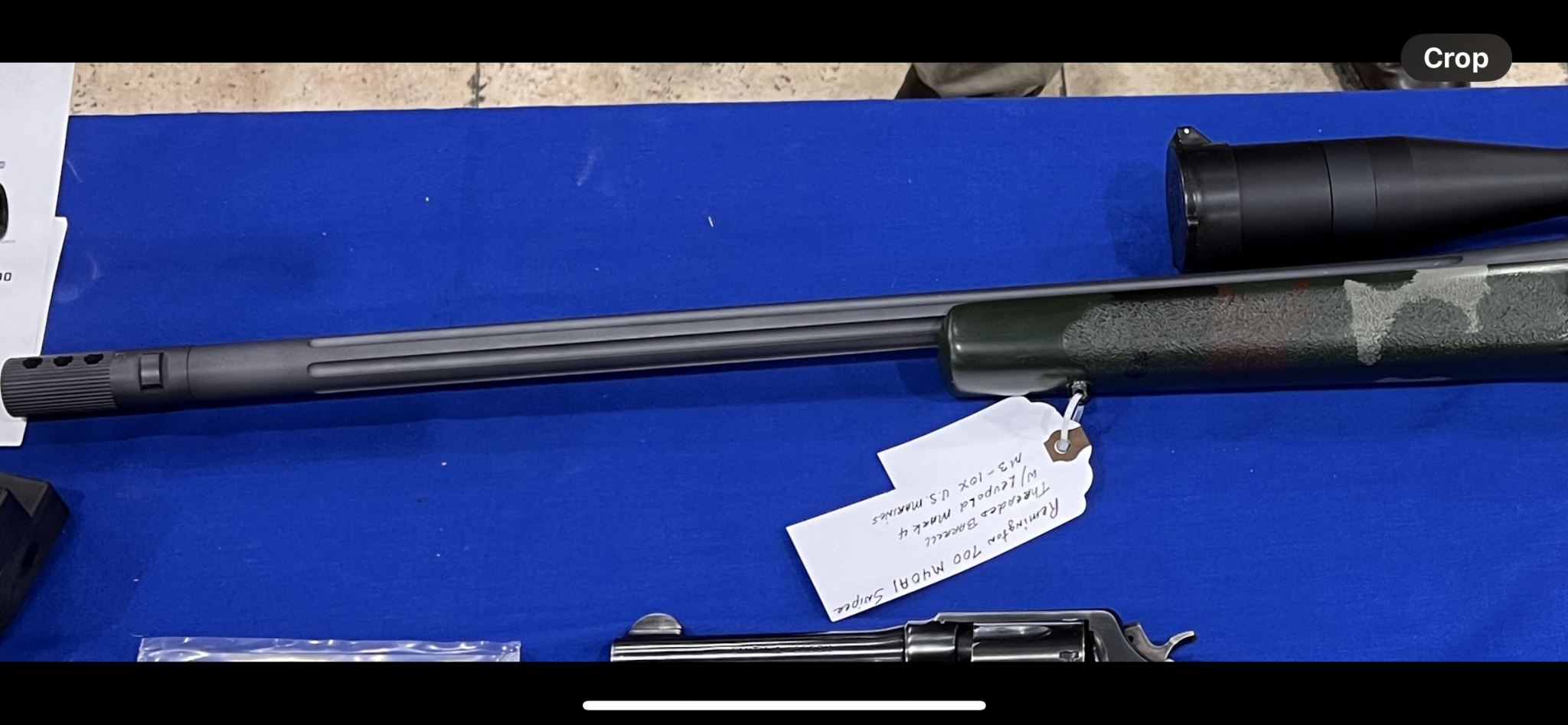

As you and others have identified already, it’s not anything M40A1 - well, unless you count Tom Berenger’s “M40A1” in the 1993 movie Sniper. 😉
But here’s my observations:
- It has a McMillan HTG stock in molded-in woodland camo (not smear or even USMC forest camo) with textured grip and fore end, sling studs instead of Witchita sling swivels, and what looks like a black 1” decelerator pad.
- it has what looks like a Leupold Mk4 10X M3 or M3A scope on it with Ultra or early style Mk4 rings. If the scope has a mil-dot reticle in it, it would be worth more than a “regular” Mk4 10X with current production rings, as it would fit well on an earlier M24 build.
- The bottom metal looks like a regular BDL floorplate (which Badger never made, to my knowledge). It does have a flat, smooth finish to it though (unlike the gloss finish of the older factory floorpkates, or the crinkled finish of the newer factory floorplates). So this could imply an aftermarket floorplate like PTG, or one that has been custom refinished?
Any custom markings on the barrel?
Nice older build overall though.
Some folks just love to “strap hang” on the M40A1 designation to try to boost their cred, because they don’t feel their shit has it to start.
That rifle is as much an M40A1 as a Kia is a Mercedes. They’re both rifles, the similarities end there.
Give a hard pass on that one, simply because they’re full of shit and who knows what else is wrong with it.
If it was actually made by the Remington Custom Shop, it would more than likely have something like "Remington Custom Shop" engraved on the top of the barrel. This was extremely common for them to do, I have both rifles and bolt action pistols in my collection with this marking on the tops of the barrel. For rifles with a carbon fiber barrel, they marked it "Remington Custom Shop) elsewhere (I'd have to check mine). Unless the rifle is actually marked this way and/or has documentation proving it's provenance, I'd say that this rifle is just a generic rifle build, and not something that was made by the Remington Custom Shop.

You're completely correct, and unfortunately every rifle with a McMillan HTG stock is always an "M40A1," no matter how incredibly wrong it actually is. Same thing with all rifles that are built on a McMillan A4 stock, those are suddenly M40A3's or M40A5's. I can't tell you guys how many "XM's" I've seen over the years, just because the rifles have a McMillan A1-3 stock and a shorter barrel. Just because 1 part of the rifle is sort of correct (even though it's the wrong color and has other issues), idiots immediately call it an M40xx or whatever other military rifle it might look similar to. It's disgusting, and I see it on the forums all the time too.
This happens with all sorts of other rifles. Over on ar15.com it's a major problem with people posting some garbage AR15 build that has a Daniel Defense handguard in the Mk18 and M4A1 Block II clone threads. Literally everything about the AR15 will be completely wrong, but since it has DD FDE handguard, the owner think that it's a Block II clone. They clog up really helpful clone threads with trash, and then get absolutely butt hurt when people call out their trash.
Some of these guys are completely clueless, others are trolling, and the worst are the people who are complete assholes who fake everything and purposefully lie to customers. For example, take a look at the trash that Rocke Guns has listed for sale on Gunbroker. That asshole just makes whatever he feels like making, engraves completely fake markings, and them tries to pass the guns off as super rare contract overruns or whatever. How GB still allows him to sell stuff on their auction site is beyond ridiculous. He lies about everything, and the buyer thinks they bought a real military/police/whatever firearm. The buyer will tell all of their friends that he just got a genuine item, and just can't internally process the fact that they bought a fake gun.
As for the above rifle that's in question, it sounds like the guy selling it knows what he's doing, and it's wrong. He obviously put an M40A1 manual with the rifle, and even of the Remington Custom Shop had built the gun, they wouldn't be supplying M40A1 manuals. He put "M40A1" on the price tag that's attached to the rifle, and he's been calling the gun an "M40A1." He's calling it a Remington Custom Shop build even though the rifle isn't marked and there's no proof of it being built there. The guy sounds like a typical scammer. I wouldn't doubt it if he's been told by multiple people that this isn't even close to being qn M40A1 sniper rifle, and he just stubbornly claims something stupid like "how do you know it's not an M40A1, have you seen all of them that were made?" Also, that's not a smear stock on that rifle, it's just a regular HTG stock with the wrong camo pattern and incorrect grip/forend molded-in texture. There's literally nothing correct about that rifle in regards to it being an A1 clone, and it probably wasn't built by the Remington Custom Shop. The entire rifle is one big lie, and the seller should be ashamed of himself. And if the seller were an honest man, 5 seconds after a Google search he would know that this isn't any type of M40xx clone build. He either knows the truth and wants to lie to customers, or he's willfully ignorant.
@ChiefSillyHorse, sorry about the negativity, none of this is directed at you, this falls squarely onto the shoulders of the seller. I just can't stand shit like this, and sellers like this need to be called out on this nonsense.

No offense taken at all… I figured as much of an answer was coming, but wanted to verify with those that know a lot more than I do about these things. As per my original post, I had serious doubts about the rifle, and I think there’s no doubt the gun is just some custom build that’s been passed off as something way cooler (intentionally or not).
The best part about this post is that I learned more about M40’s than I previously knew. I’ve used the resources of the Hide for many years and it never fails me!

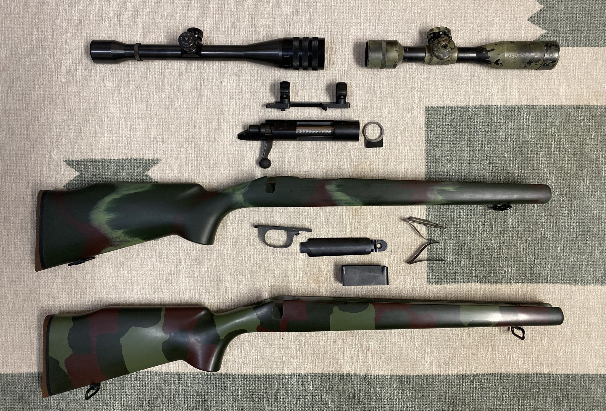

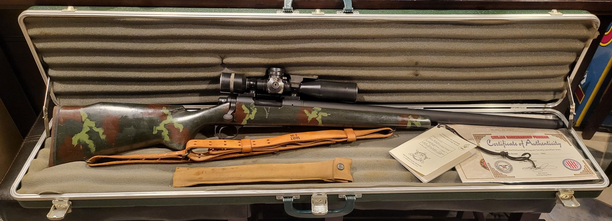

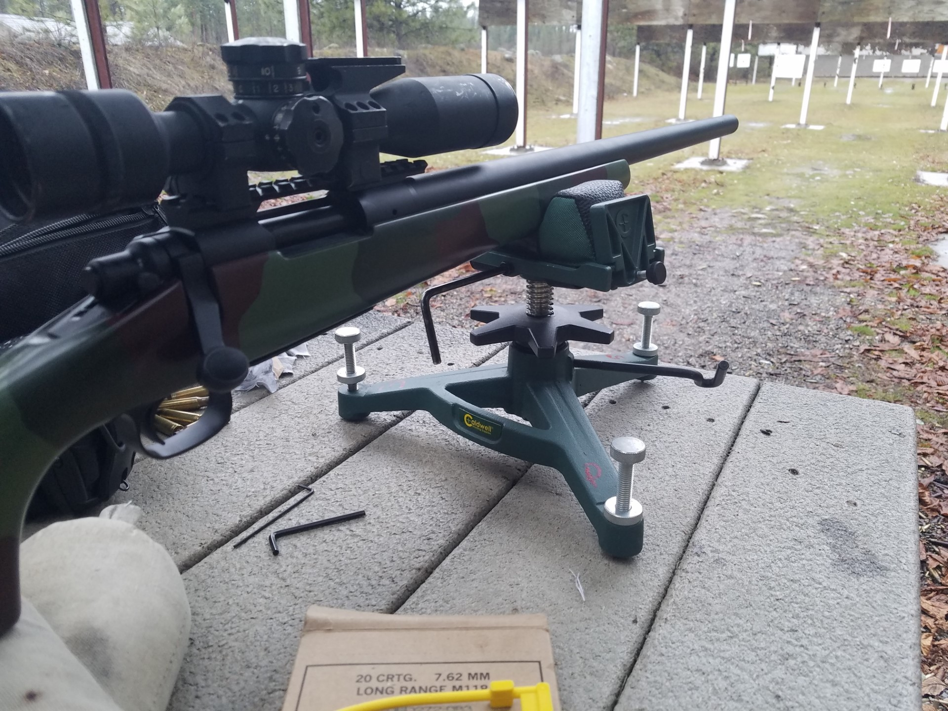

Made it out to the range today and brought mine for a test run. Today the weather was nice, a quartering breeze that swung left to right and in the 60's. Shot these three groups with Remington Premiere 168 SMK top, M118 LR 175 gr SMK middle and Fed Gold Medal Match 168 gr bottom. The flyer with 118LR in not surprising, if I had taken the time to sort the ammo I might have weeded it out, but a single flyer in five seems normal for that lot.
I did the break-in when I sighted the scope about a month ago. Cold bore first shot was in the inner 3/4th inch ring of the paster. I'm looking forward to taking it out to my private 1/2 mile in a few weeks. Between relatives passing away, selling a house, moving a house load of furniture, tax season and assorted projects my time is limited these days. Today was a nice day at the range and the results were very nice.
I put an order in for the PTG M40A1 repro bottom metal a few days. For $200 it includes the complete guard and floorplate, guard screw, and action bolts. We will see.
It will be going in a new McMillan usmc spec stock inletted for the M70 bottom metal. Hoping for a reasonably good fit but I'll get out the dremel if need be.
It will be going in a new McMillan usmc spec stock inletted for the M70 bottom metal. Hoping for a reasonably good fit but I get out the dremel if need be.

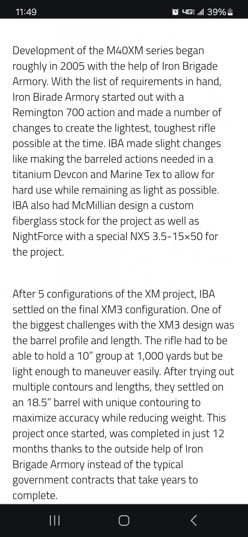

Iron Brigade Armory not Remington made the XM3's....
Looks like it likes the gold metal match the best. How far out were you shooting.
My little review of the PTG bottom metal:
Finish and machining on the part are excellent. It's nice not having to piece together different parts, and the black finish is perfect.
Mine fits the same as @ChanceDoane's, which is frustrating, as I have to find time to access a mill. I'm just not interested in trying to level it with a dremel.
The threaded escutcheon pin is a nice inclusion, and was pretty easy to fit. I carefully hogged out the space for it, set it in place, surrounded it with Devcon, then carefully screwed down the trigger guard to make sure it was at 90 degrees and centered. I waxed the bottom with shoe polish to prevent any sticking.
My only other gripe would be the action screws - neither are long enough for the rear, and one will need to be cut. Not a huge deal, but just one of those things that could have been done by PTG since the kit is for such a specific stock. With those things in mind, it's a good value and is sturdy as hell.

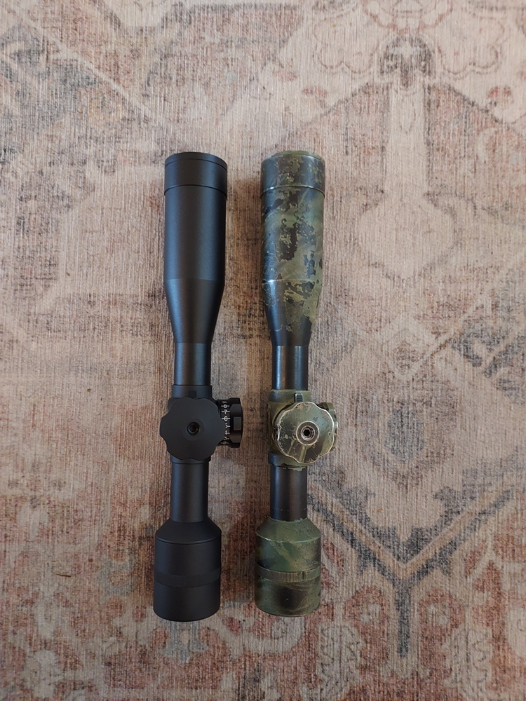

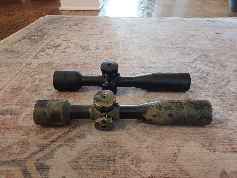

who makes an airsoft replica.....
I bought this one from Action Airsoft. If you search for "Kitagawa Kogaku Seizosho - MST-100 Style 5.8X Fixed USMC Mil-dot M40 Day Scope" several different companies show up.
The good: The scope is almost identical to the original Unertl, it's relatively cheap >$400;
The Bad: It says that it's only 5.3 power, It's chinese, I haven't checked it out to see if it tracks properly...
But the scope does look legit, it is aluminum so it's about half the weight...I'll post how it works on my M40A3 trainer once it is complete.
Sorry for the delayed reply. This was just 100 yards, I was very happy to finally able to get the thing dialed in after prolonged bad weather in my area. I have 800 yards on my private rifle range an hour away and will take it out there sometime in June.
