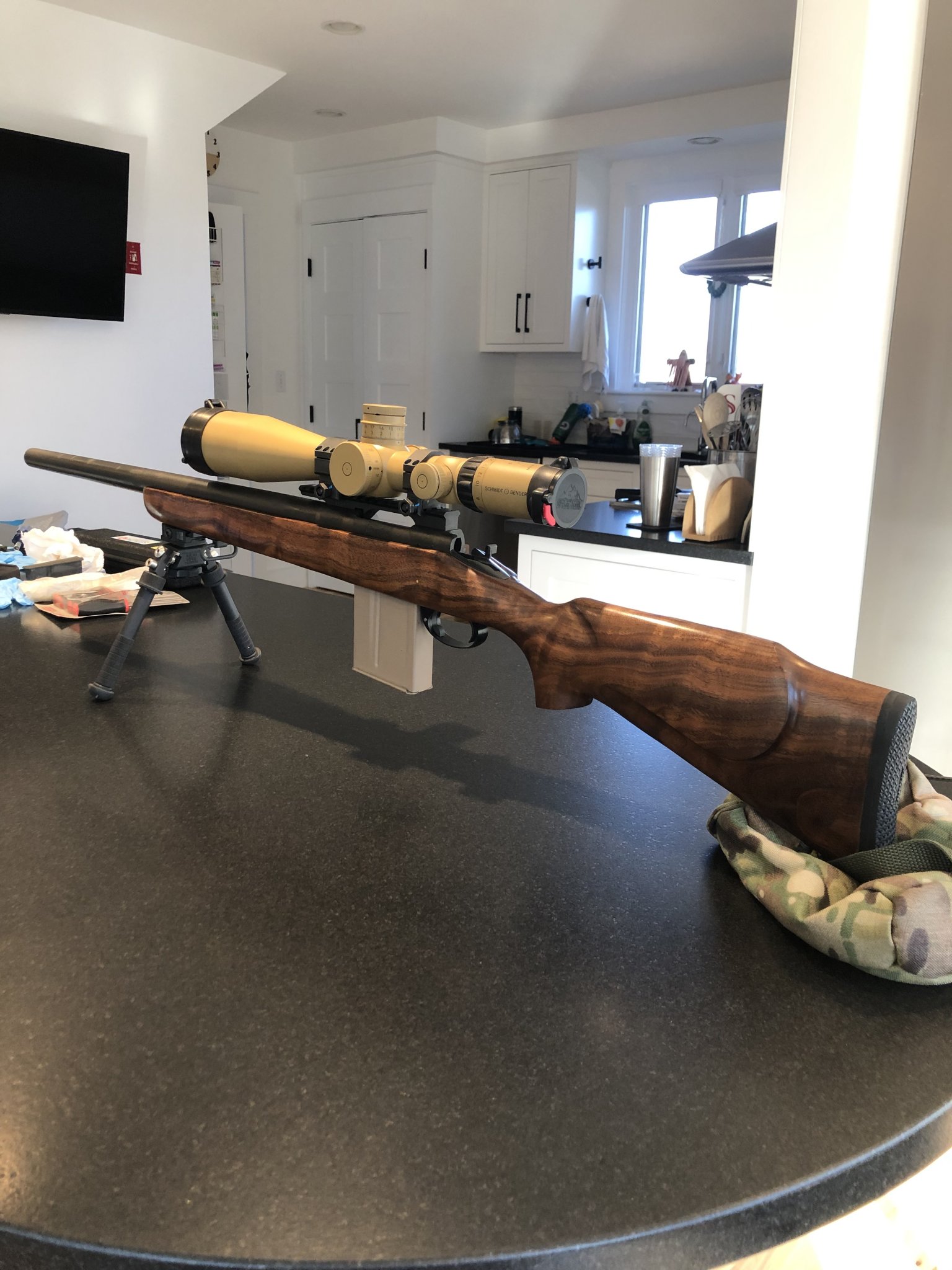

I sold this rifle to a friend of mine a long time ago. He called me and said he had not shot it for 10+ years and said I could have it back. I have been reading that these things go for big money now. Unfortunately I dont have the correct scope and Im not gonna pay for one either so this is the best its gonna get. When GA built it they clip slotted the action for me anyway. Just glad I got her back.

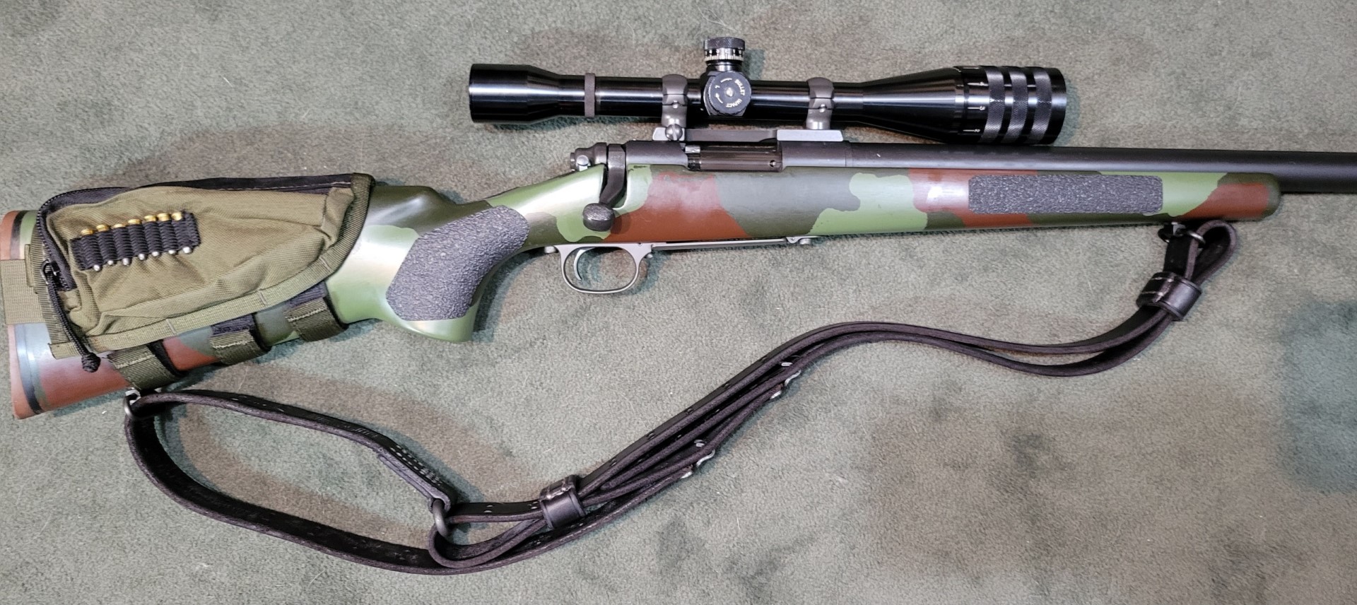

I kept mine a single shot... by far my favorite rifle :cool:

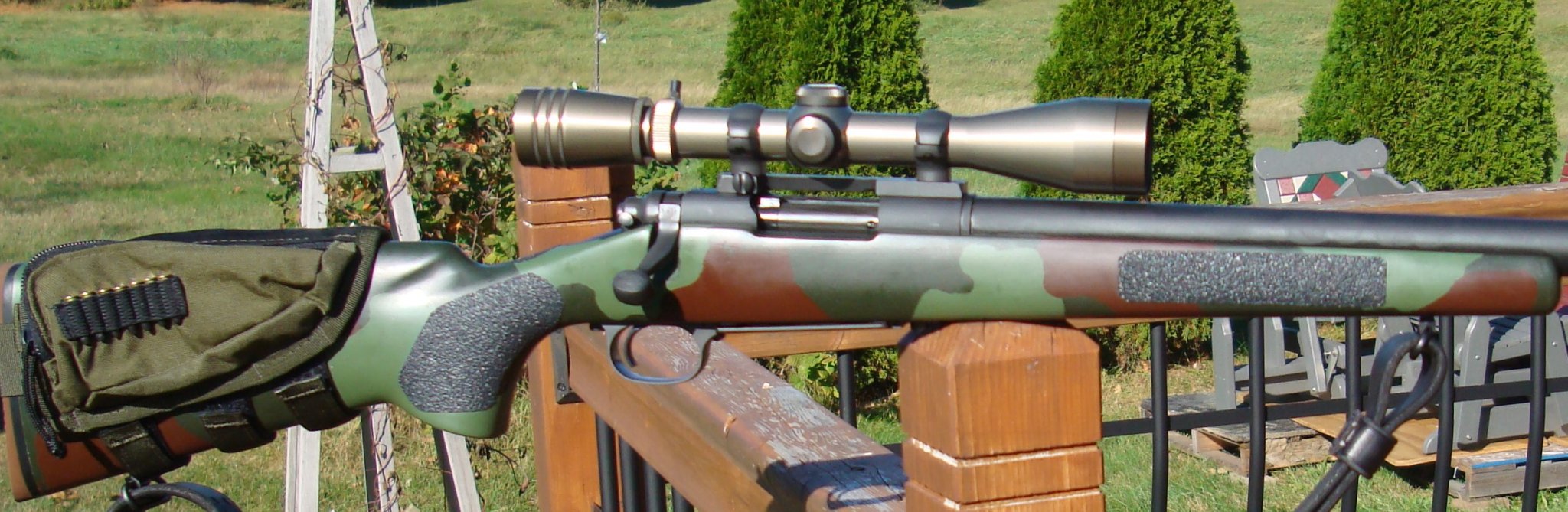

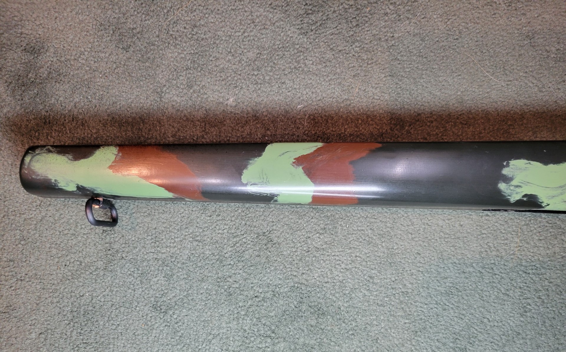

Welp....guess I'm doing another a1. Snuck well under what I was expecting. Not sure if smear or forest yet. Will take better pics when it gets here.
View attachment 8168127View attachment 8168128View attachment 8168129

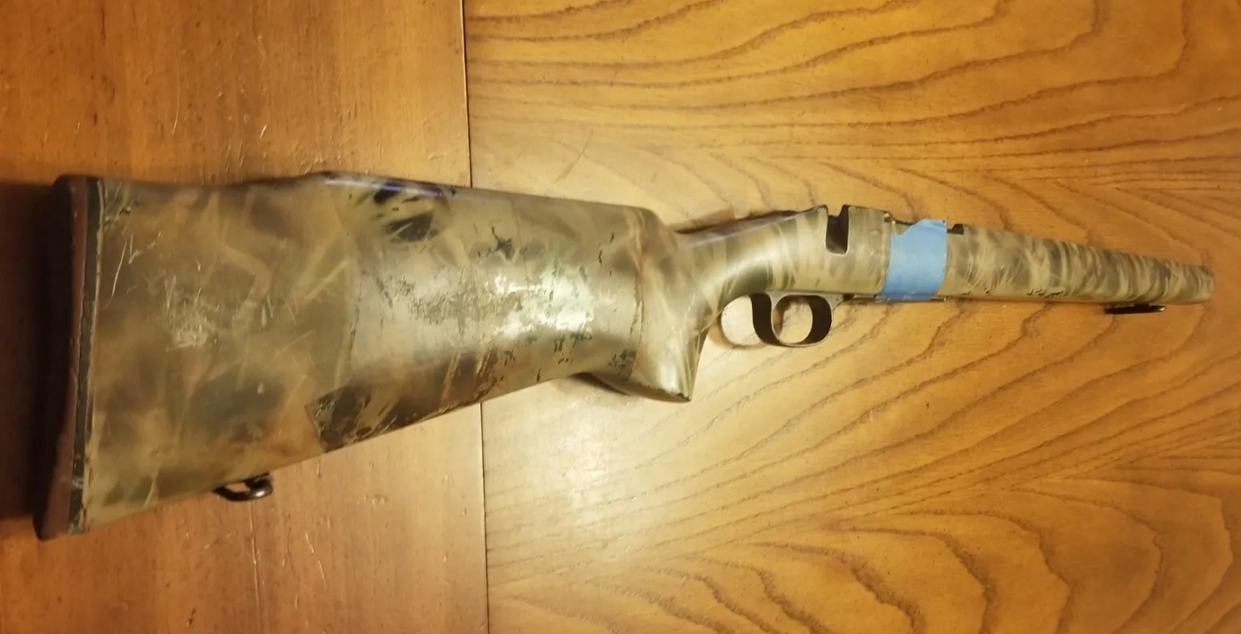

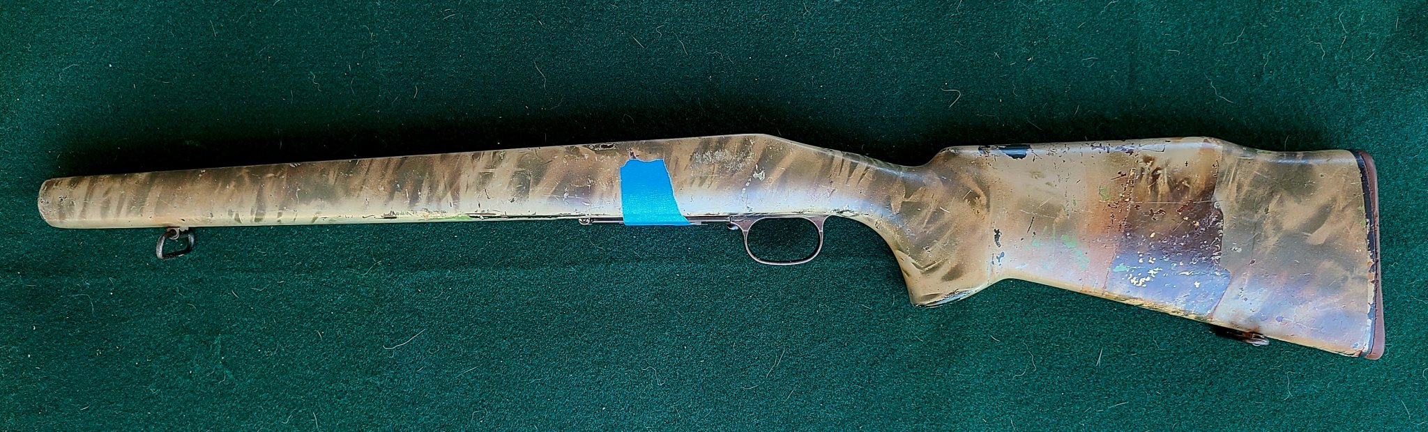

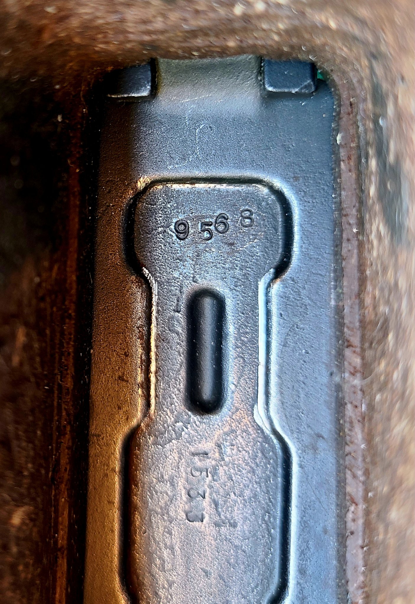

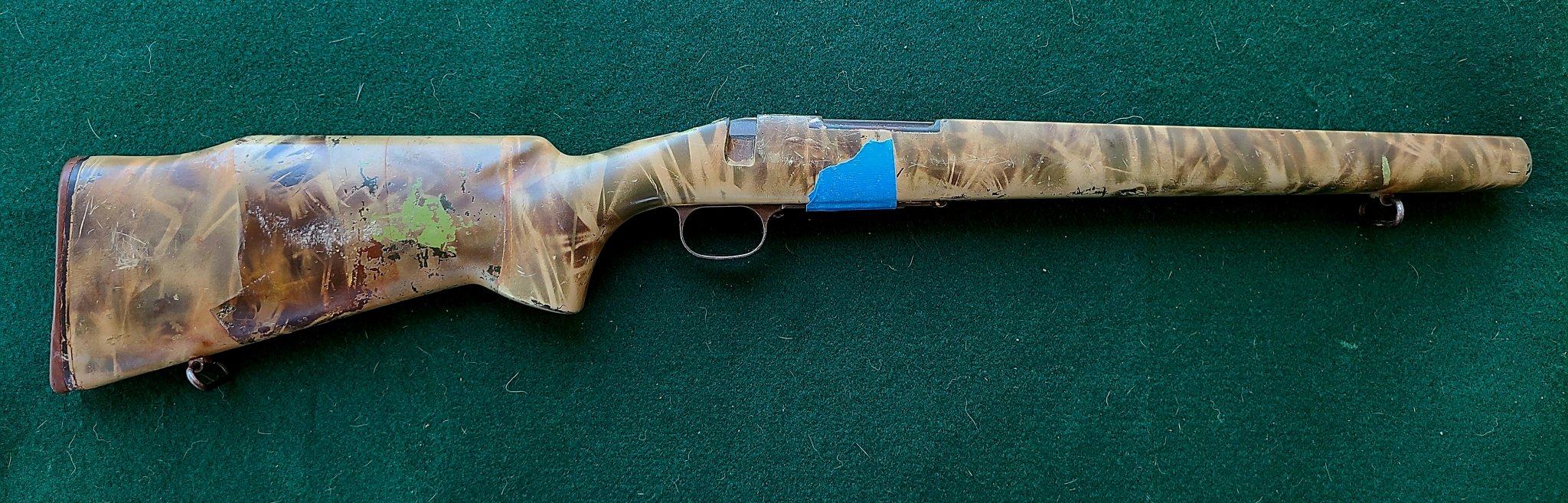

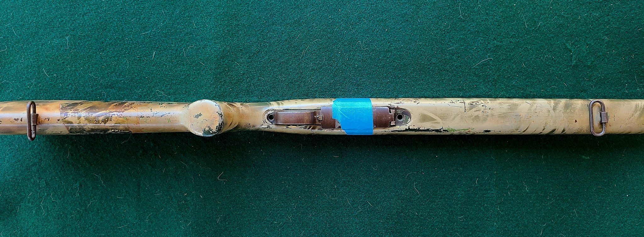

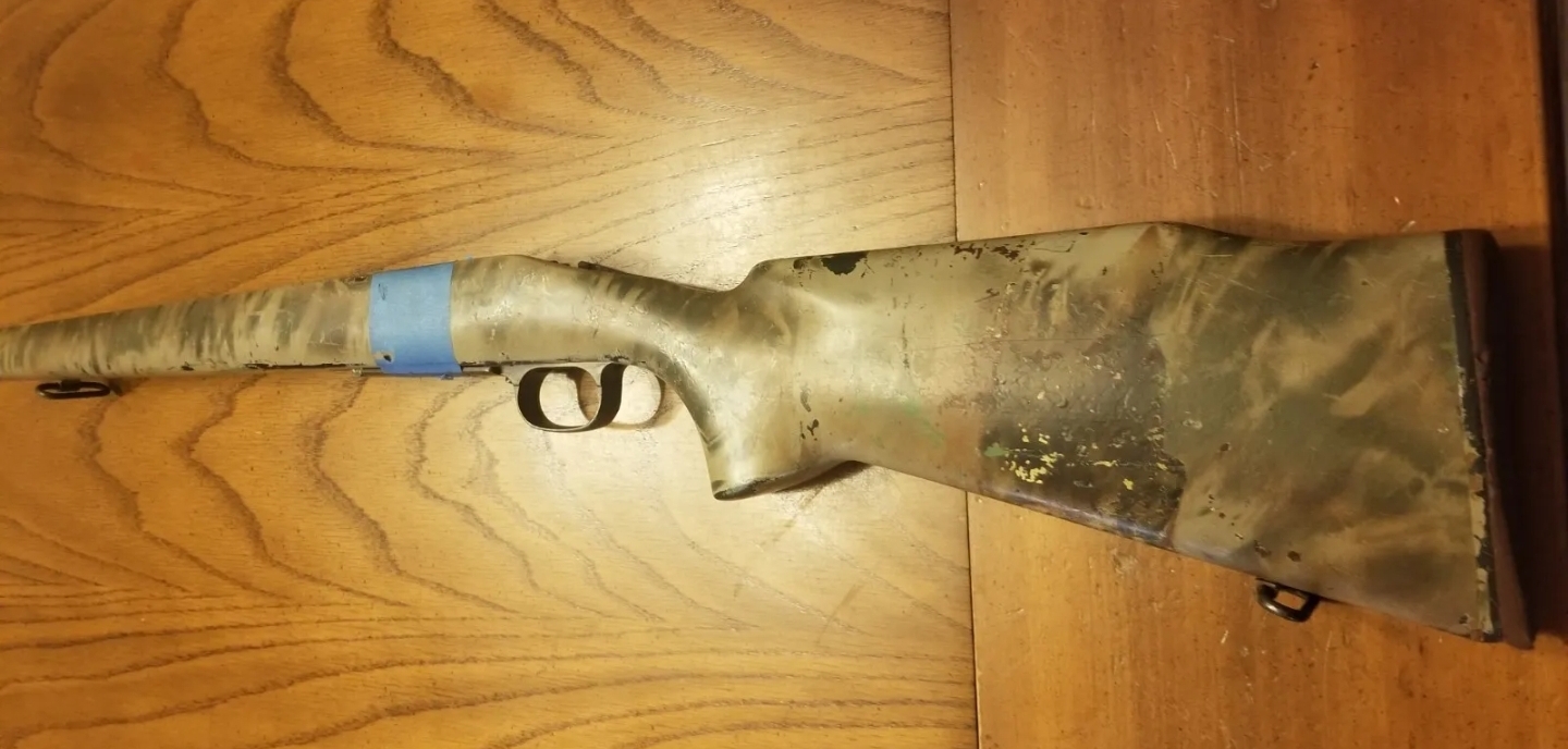

I purchased a rifle off GunBroker basically to get this stock. I had to replace the butt pad and install the correct sling swivels. It is a hollow civilian stock, but it was weighted by a previous owner, so it feels pretty close to the correct weight. Unfortunately, it is inlet for a stock Remington 700 bottom metal, so I will have to stray from the correct bottom metal on this build. I'm thinking a good steel bottom metal that has the standard Remington shape will be a good compromise... does anyone have a suggestion as to who makes a good steel bottom metal?
View attachment 8174193View attachment 8174194
Sunny Hill Enterprises makes a steel bottom metal.
Also another good option would be Badger Ordnance. Although I think Badger’s bottom metal is just thicker aluminum.

If the inletting is too large for a Winchester bottom metal and trigger guard set, just have your gunsmith completely fill in the lower portion of the inletting with bedding material and recut everything for the Winchester bottom metal and trigger guard. I've seen gunsmiths like LRI completely fill in all the inletting and recut it from scratch. You don't need to go that far, just do the bottom of the stock where the bottom metal inletting is.
If the Winchester stuff has an outline of bedding material around it, get a paint and gel coat set, and bring out your inner artist! There's guys on this forum who have been able to color match and gel coat McMillan stocks before, I think @crazynoto has done it and might be able to give some advice. If you're unable to paint/gel coat, then just leave it as is with the outline or rattle can the rifle (leave it completely painted or wear it down in a lot of areas to show the stock's unique pattern).
If the inletting is too small for the Winchester bottom metal and trigger guard, then just open it up like @pmclaine suggested. Once it's properly cut, bed the Winchester parts and if there's any odd areas that show a lot of bedding compound, get some paint and gel coat to match the surrounding area.
I have no idea if the Remington inletting is larger or small than the Winchester inletting, but it doesn't matter much. There should be absolutely no reason why you can't use a Winchester bottom metal and trigger guard with that stock, it's just going to take a little bit more work. Hell, I might even have some extra M70 shit in a drawer somewhere, let me know if you need the parts and I'll see what I have.

Thanks for the suggestion! I didn't think it would be possible...

You also might try calling McMillan. I’m not sure if they offer it anymore. But they use to repair stocks. That way the gel coat wold be close.
I’ve checked before, and McMillan will not fill in existing inletting and re-cut for smaller anything. And this was when McMillan was still owned by… McMillan and still offered some custom stock work at their customers’ request. They will open up for larger inlets though, unless it’s for a stock they no longer support if it requires programmed mill work, such as the A2 or other discontinued lines.

I just got my Weaver T10 back from getting a mildot reticle installed by Iron Site. That reticle is really handy to use on a 22lr :cool:
Time to take off my fake Unertl and head to the range!!
This 40X .22lr M40A1 clone build is by far my favorite rifle... it has dispatched a ton of squirrels!!

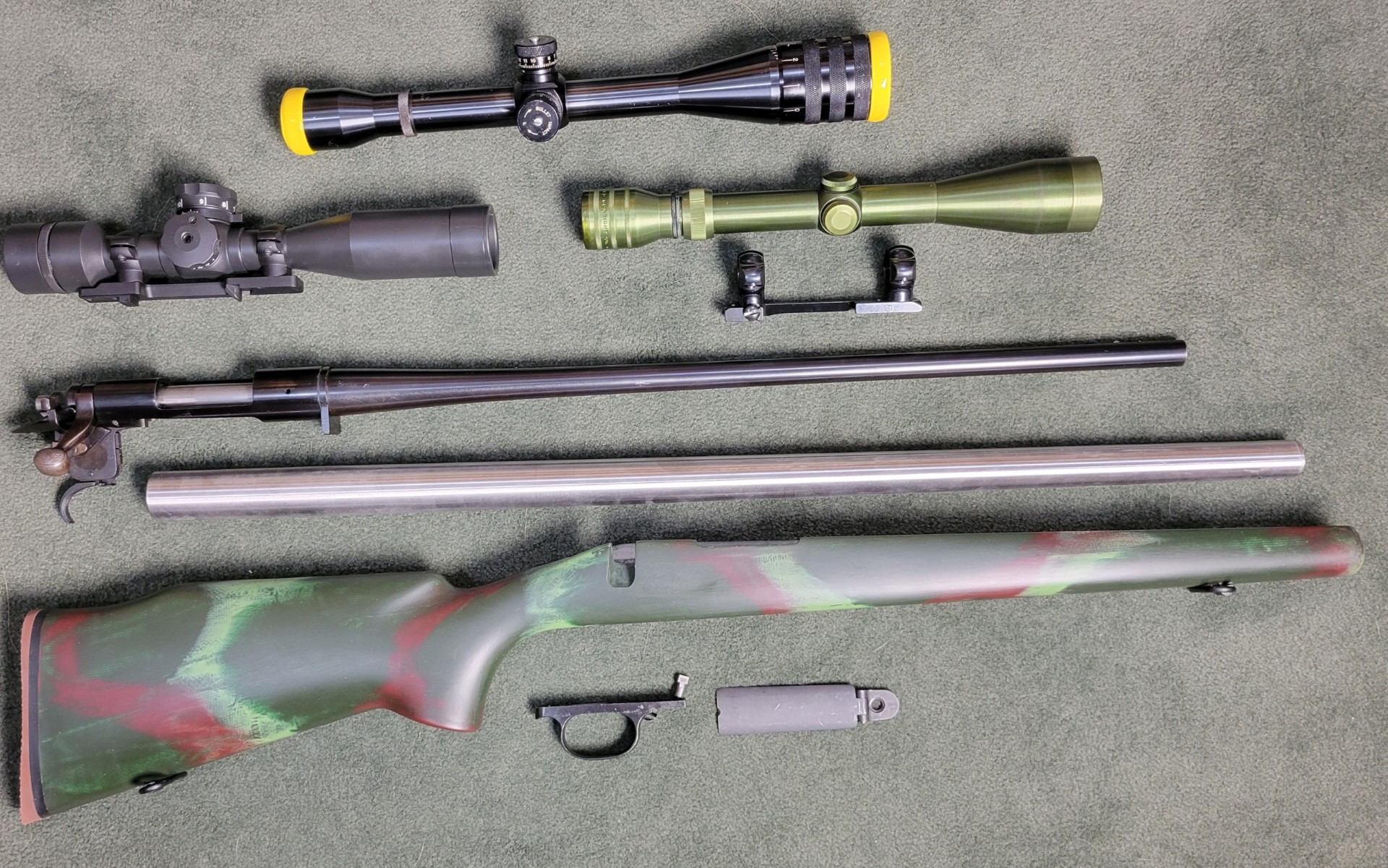

What Post 64 Winchester model 70 actions have steel trigger guards? I’m having a hell of a time locating one that is steel and the wider post-64 width.
Down to just the right trigger guard and a barrel and I’ll have all the parts collected for my build!
Reactions: D_TROS
Schneider barrel blanks currently available at Charlie's, get'em while they're hot. I just ordered one to get my A1 back up and running. It was the best barrels we ever got on our issued guns.
UPS just dropped off my Hart barrel... the last part I needed for my 6-digit build. I'm not sure on the optic I will go with, however I do plan on getting one of the LRI scope mounts. Great time to build these rifles thanks to McMillan and LRI
