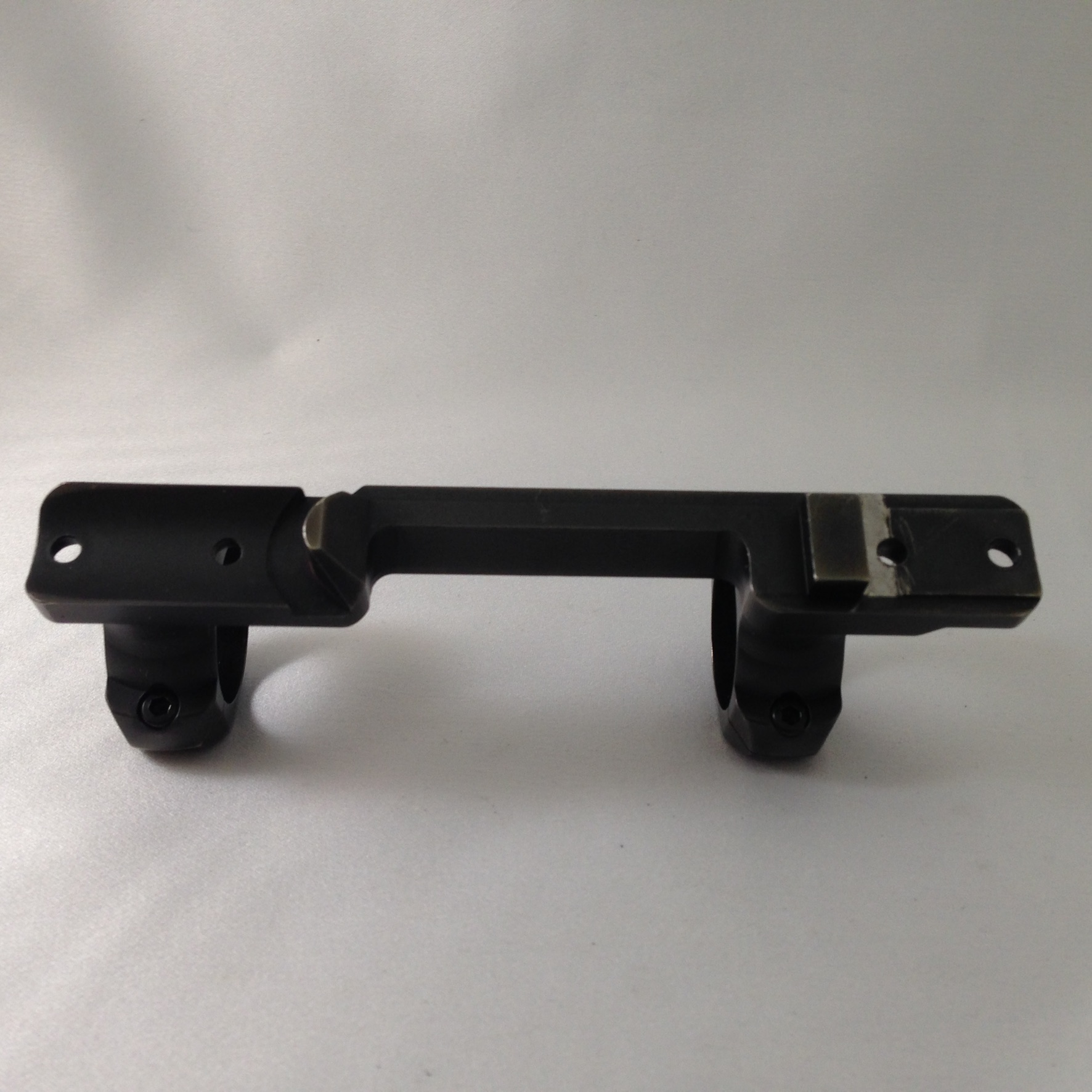

I have been on the range lately with my m40a1 and noticed my scope is moving in the rings,, yes, rings are tight and I sure as hell do not want to snap a screw off.. mount is TWOMANATTAC and seemed at first to be a good fit… what should I try and do to fix this problem.. Unertl scope…spec rifle..
Thanks in advance

Contact twoman, I’m sure if it’s out of spec he will make it right. I have 2 of his mounts and haven’t had any issues

My scope has some wear on the tube,, thinking rings are correct, my tube is out of spec,, just thinking out loud...
Keep in mind the original Unertl scopes got abused, badly. We would have constant problems with rusting at the rings, steel tube and salt water for an amphibious force don’t mix well, so we would have to CLP that area often yet still rust would form trapped between the rings and tube, pretty ugly few I’ve seen when pulled out of the mounts and we would take a green scratch pad to them to clean it up. Add the stout recoil an A1 has and potentially loose rings and you get wear. Take a caliper to it to see just how much wear you might be dealing with.
Degrease the surfaces, light coat of rosin and torque snug enough (but of course not too much), use best judgement on it. I’d avoid any other sort of shimming material, worst case I would probably order a new undersized mount for it.

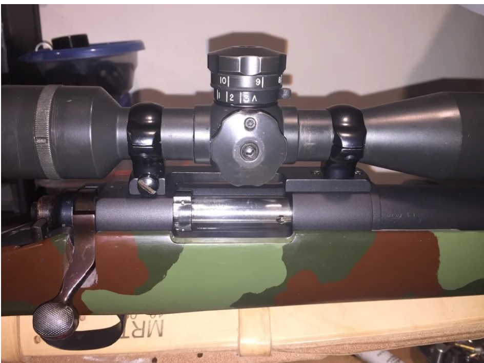

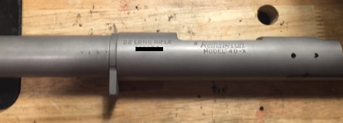

.22LR Trainer I built off of a 40-X. Had to cut the barrel down, but it was a heavy, bull barrel..
After I cut the barrel, I hand crowned it with crowning reamers I purchased online.
No lathe... Not even a jerry rigged drill..... Did it all by twisting by hand..
Bedding job I did on the trainer.
crossed my mind to try and make a .22LR elevation assembly, but got sidetracked..
Made the Tube Books a couple of years back... Think I gave them all away.... Gotta check my storage unit.

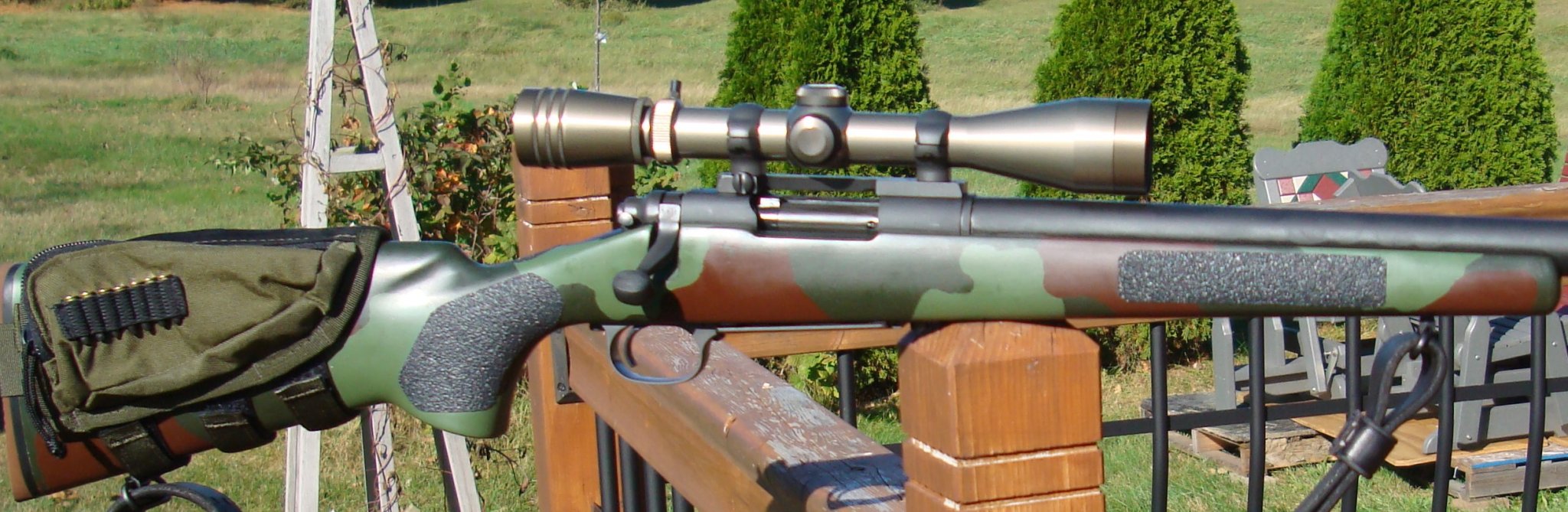

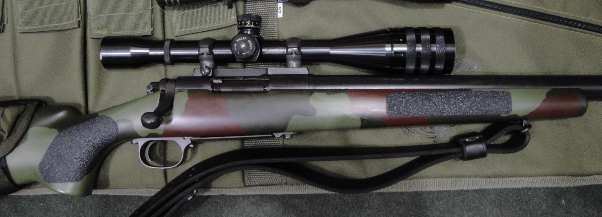

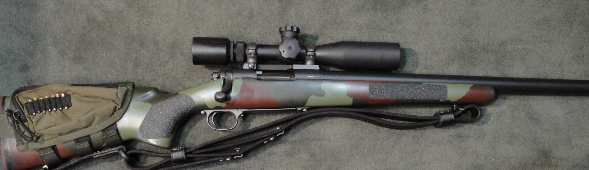

Here is the M40A1 I built.... Smear stock, CMP Unertl, proper serial # range receiver, Marine Tex bedding... Forgot who clip slotted for me. Got a couple of Unertl .50 cal from the CMP for real cheap.... Broken reticles, stripped rods, bad detents, but I fixed em.
When USO did that last run of 10x's, I made friends with someone over there and had them manufacture a couple of extra
10x elevation assemblies to convert them back to 10xs.

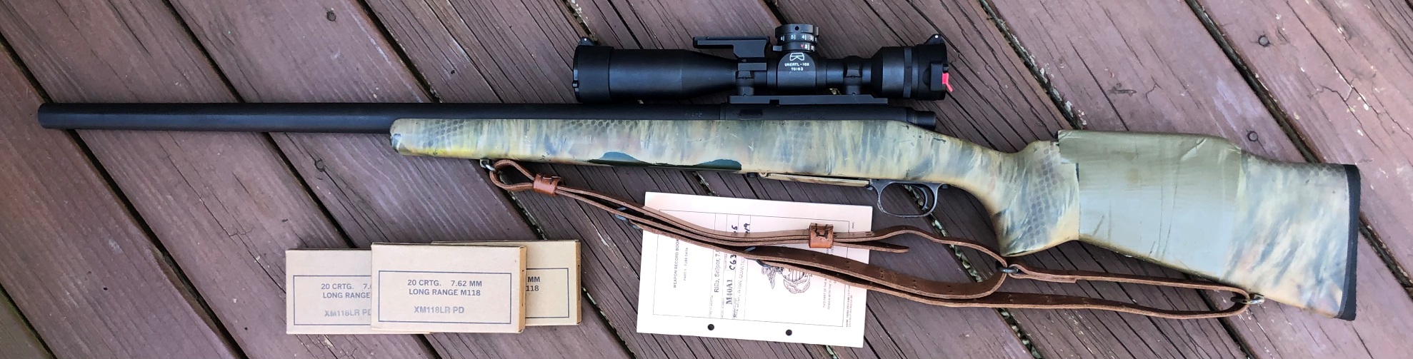

I put on a NRL Hunter match last weekend and wanted a drop gun stage.
COF was to run up, guess the range of the target, dial the scope to yardage and shoot. Bonus time for getting the hit.
Full spec build. Thing shoots lights out. Nosler donated the ammo (168 gr match ammo) and the 300 BDC mark lined up perfect with a center hit if you held for wind correctly. Not many people got hits on it and the target was easily 2x as large as vitals on an animal...the main reasons I hate fudds on internet bragging about 500+ yd kills...how many animals did you injure before that...
Pic is a youth shooter sizing it up. He could not get eye relief (IYKYK) so he didnt fire it.

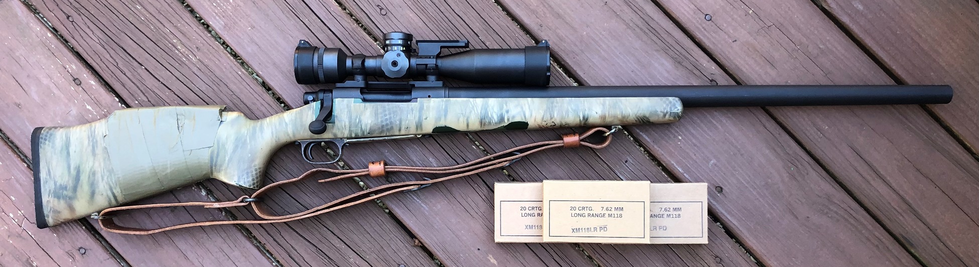

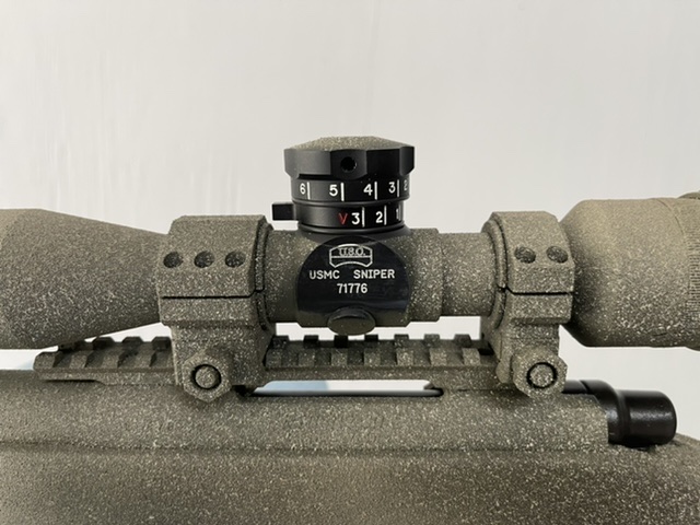

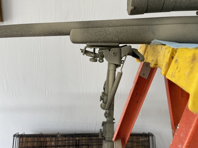

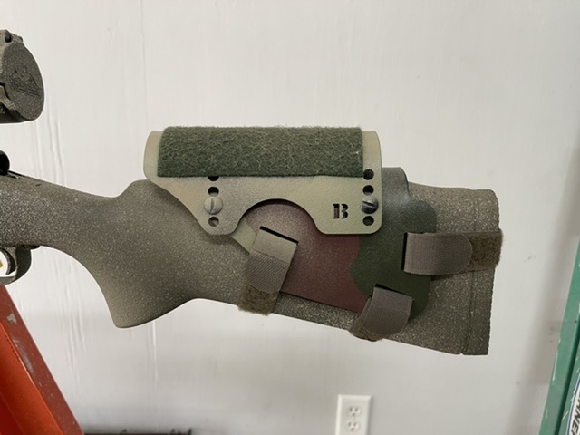

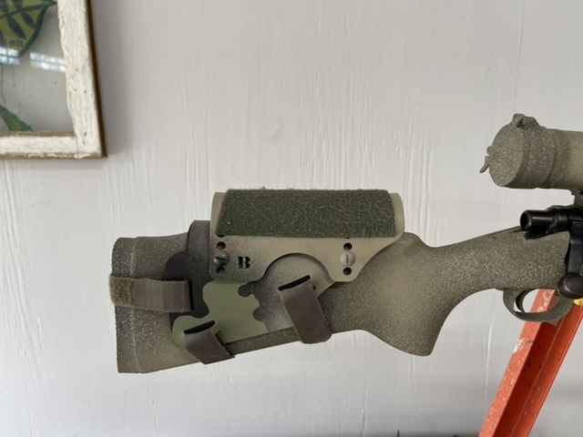

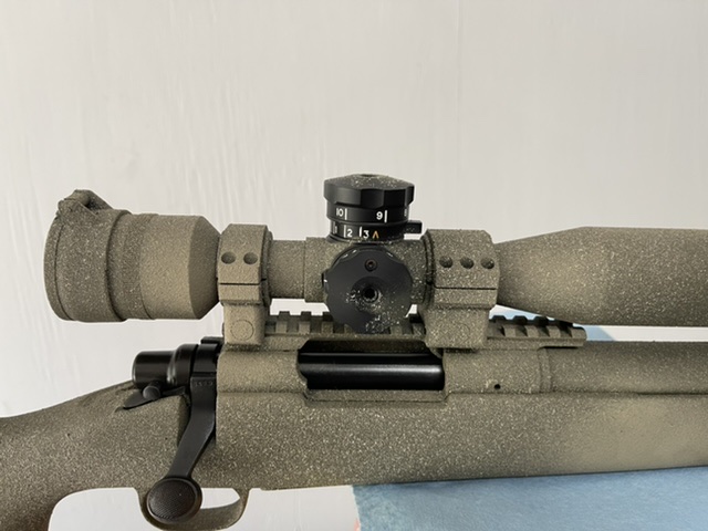

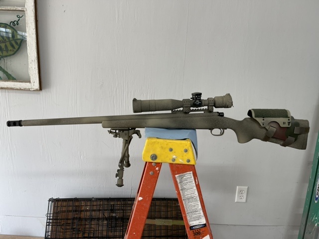

After 5 years of “as newly built” condition, I decided to paint The Reyvn. Same paint techniques/colors as my MK12s and MC6SD.
Of course, I changed the mount system to the A3 (I think?) to increase comfort and shoot-ability. It made a world of difference, along with the McM installed adjustable buttplate system.
