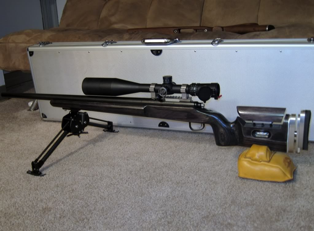

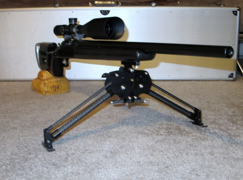

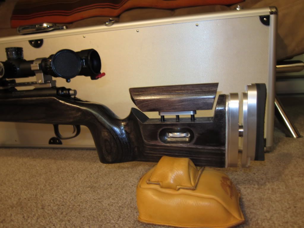

Nothing special but hoping that it will shoot better than my older tactical rifle. Remington 700 action, 28 inch Obermeyer barrel (1/11 twist, AMU contour), PRT F/TR stock (with one of Alex Sitmans 3-way adjustable buttplates to save weight), Centershot bipod (again to save weight) and a NF NXS 12-42x56 mounted in Murphy Precision titanium rings and bases, again trying to save weight and overall it worked. Rifle weighs 17.2, allowing some room for a longer barrel if this one doesn't shoot. Pictures aren't that great, but you get the overall picture.

Nice looking rig ya got there. I particularly appreciate the longer foregrip; I would have never guessed it was a 28" pipe if you hadn't stated it. The stock is really well-proportioned for the metalwork.

Okie, haven't actually shot the rifle as configured, broke the barrel in, no real load development as yet. I have 155 smks, 155 lapuas, 185 Berger bts and alot of 180 jlks on hand, for powder varget, re-15, re-17 and vv550. Going to try them all and see what happens, chamber is 95 palma match, so that's a limiter. I really like the longer forend, I think its going to be a real bonus when I get a longer barrel. The stocks ergonomics are great, its very comfortable to lie behind..

Monte thanks, it been a pain and a long wait, originally ordered an XLR stock and it wouldn't fit, so I called Ray Bowman and he thought I would be over the weight when finished if I got one of his completed stocks, so I got the stock from him just semi-inletted with the cheekpiece installed. I called Alex Sitman and he told me his 3-way buttplate only weighed 1.2 lbs. In the end up it really worked, I have some weight to play with, I think the rifle should shoot decently. As for the missing barrel nut, I never claimed to be smart, just ask my wife. If anyone was to ask me about shooting f-class, I would without doubt suggest the Savage Model 12 F/TR if they were starting out, it really has it all, (if I had only thought for a second before I started down the build path) another example of not being smart. XTR, with regards to powders and bullets, I have enough of Steve bullets on hand to last quite a few matches, but I figured what the hell and I would give everything I had on hand a whirl and just see what pans out, another example of being a sucker for punishment. Luckily only last week, I found an immaculate Oehler 35P for a song at a local pawn shop, so hopefully it will help in deciding what combination will work best.

Very nice looking rig. Had Alex do one of my stocks 2 years ago, workmanship was impeccable. I have run both the 155 Scenars and 175 SMK's, at 600 they both shot very well. The 185 Bergers are a great bullet, might work better at 1K. I have had no luck with RL17 in my .308's, poor accuracy, low velocity: maybe I'm doing something wrong but RL15 & varget seem to work best.
Centershot bipod. Need to check this out, have a Remple that is great, looks just like this one except in footprint area.
