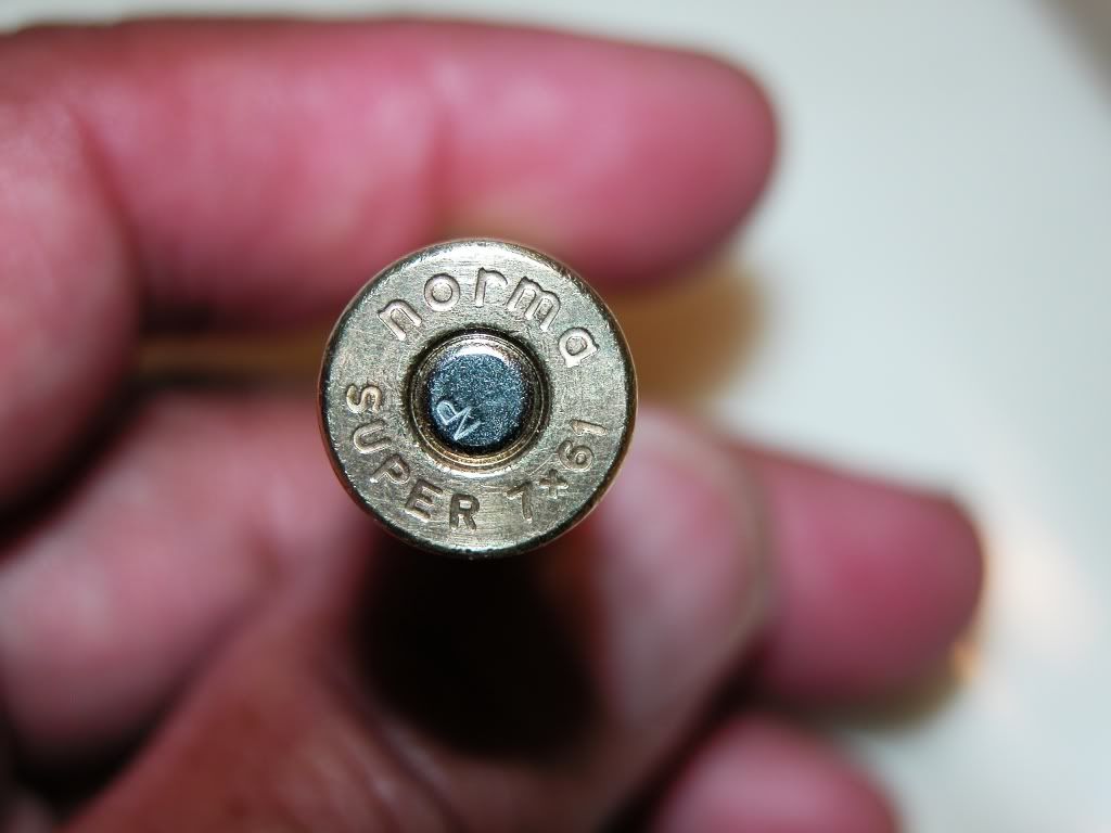

..before you make an educated guess...here are some specs and photos.....
BTW.....Dave Kiff at PT&G is making the reamer.....I ran the neck through a different bushing die [that was obviously SHORT].

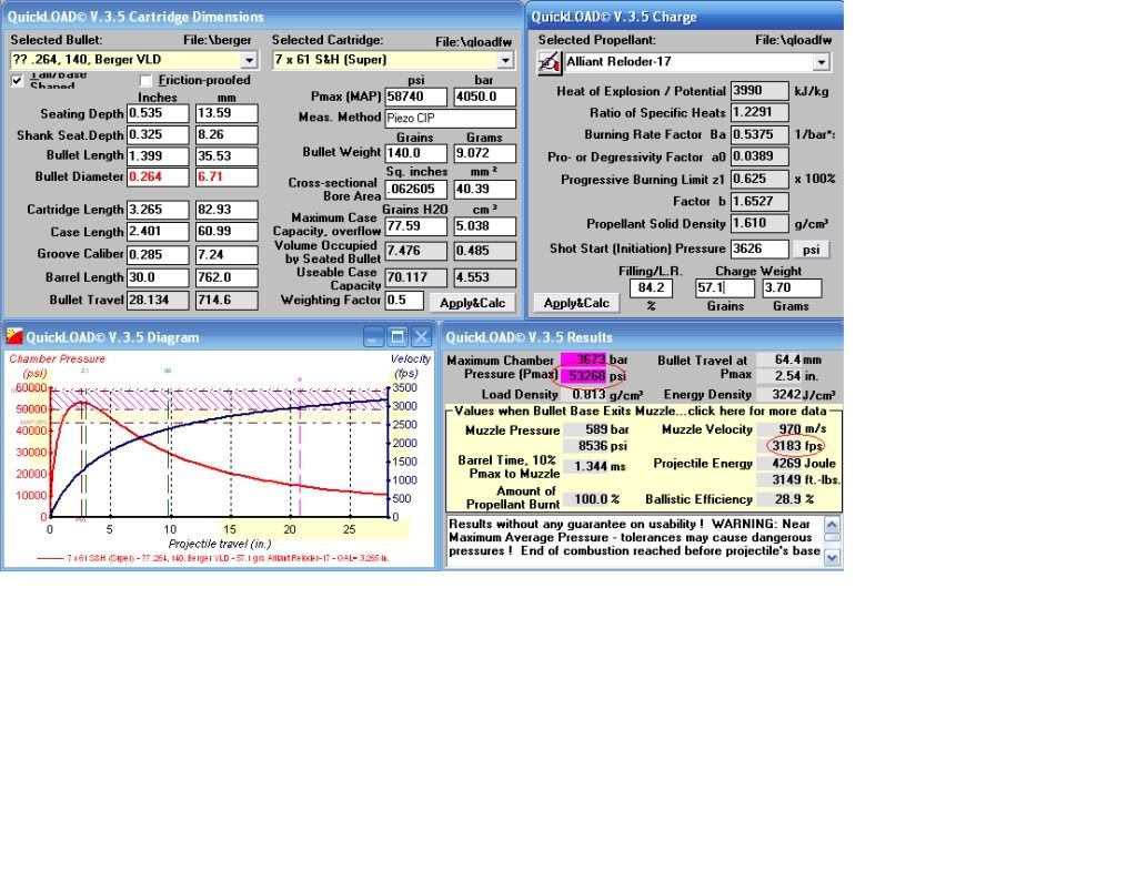

Here are the preliminary ballistics:
<span style="font-weight: bold">6.5mm 140 gr. Berger VLD
ACCURACY LOAD OBT = 1.345ms
Barrel Time = 1.344ms
COL = 3.265"
Powder = 57.1 gr. Reloader 17
Velocity = 3,183 fps
Pressure = 53,268 psi</span>
<span style="font-weight: bold">MAXIMUM LOAD shows:</span>
Barrel Time = 1.293ms
COL = 3.265"
Powder = 58.9 gr. Reloader 17
Velocity = 3,262 fps
Pressure = 58,325 psi</span>

For a 30.5" barrel:
the "venerable" 6.5-284 needs 59,157 psi to achieve 3,060 fps.
the "revered" 260 REM needs 59,874 psi to achieve 2,935 fps.
Want to know something else truly AMAZING....this cartridge will achieve
3,062 fps with 48,400 psi.....hmmnnn.....
....keep guessing.....it's amazing that this cartridge has been OVERLOOKED for so long....

<span style="font-weight: bold">We have a WINNER!!</span>
my gunsmith is coining it The 6.5 x 61 Super.....Since the 7mm Remington mag killed it around 1962 or so....Norma decided to relieve the interior walls of some brass...Norma gained about 5 more grains of powder capacity, therefore matching the 7mm Mag ballistics. Norma renamed the cartridge to the 7 x 61 Super.
But..as in a lot of marketing campaigns....the 7mm mag proved to be too popular.
One thing my gunsmith pointed out very clearly...the 44 degree shoulder on the 7 or 6.5 x 61 is/was the only factory produced "Ackley-improved" so to speak...
John...PM me your shipping address...I am true to my word...I'll send you a box of bullets!!

Uh... a 140 gr VLD @ 3200 fps is hardly duplicating 7mm RM. Have you run the ballistics?
7mm 180 VLD @ 2800 fps 2.6 mil 500 yd 7.6 mil 1000 yd
6.5mm 140 VLD @ 3200 fps 1.9 mil 500 yd 5.8 mil 1000 yd
If those numbers are real, this round TRASHES my 300WM shooting 208's and is SS to 2000 yds.
John
ETA: I won't even address the 270 WSM because nobody has seen fit to make a decent bullet for it. It doesn't stand a chance.

..yes indeed John!
from JBM:
2170 58.3 2.6 1052.7
2175 48.8 2.1 1051
2180 39.2 1.7 1049.4
2185 29.5 1.3 1047.7
2190 19.7 0.9 1046.1
2195 9.9 0.4 1044.5
2200 0 0 1042.9
16/08/10 06:51, JBM/jbmtraj-5.1.cgi

I don't doubt those numbers are real, my 6.5-06 with a 28" barrel runs 3150-3175 with a 140 Berger. Ply1951Guy used his 27.5" barreled version to rock the mile target at TVP in 52 MOA over his 100yd zero. His rifle is a little slower, the node is only 3036fps
You will be burning barrels though, pressure isn't the only thing that does it. The simple act of putting that much powder through a small hole doesn't help throat life.
I'm not getting complete powder burn with Retumbo in the 28" barrel. I think RL17 is too fast for this case. If I'm reading QL snapshots right you're only a little over 84% filled? Put H1000, IMR7828 or Retumbo in it and rerun the data. I think you'll get some better numbers.
This reminds me of a belted mag version of the 6.5-06 AI with a little more steam.
