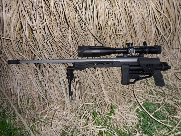

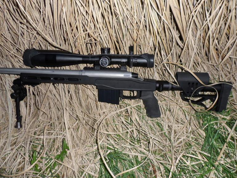

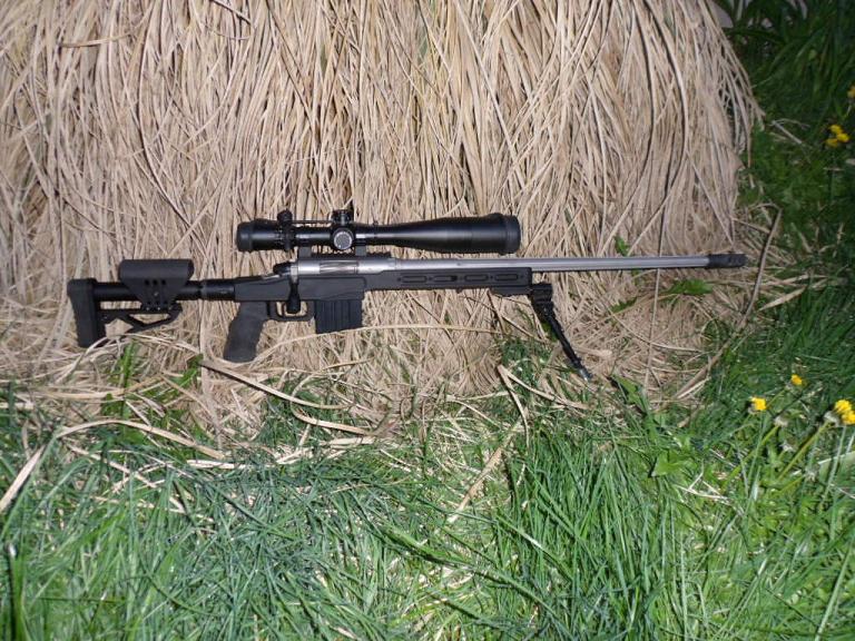

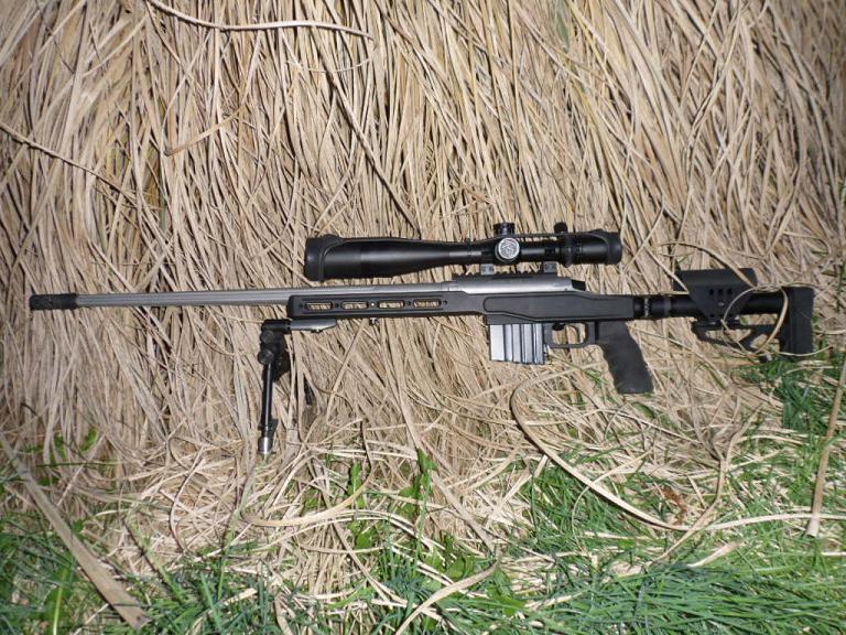

Arrived yesterday! Can't wait to out it together tonight. Pics to follow shortly!
Thanks again for the amazing service Kyle!
Sent from my iPhone using Tapatalk
Enjoy!
Thanks again Kyle. It's all coming together nicely.
This is a placeholder scope, going to switch over my 56mm NXS after I shoot one more match this weekend with my old Savage.

Wow looks nice. Did the length added by the folding stock adapter give you problems with the cheek piece distance to the scope? Wonder if using the lite buttstock with the extreme buttstock's cheek piece (already have one installed on my HS-P and it works great) may be safer to prevent eye relief issues.
I would think so. You may want to look at LOP as I would guess it would start quite long.
EDIT: LOP would start at about 13.5" plus the length of the adapter so probably around 14.25"+.
-Kyle ~ XLR
