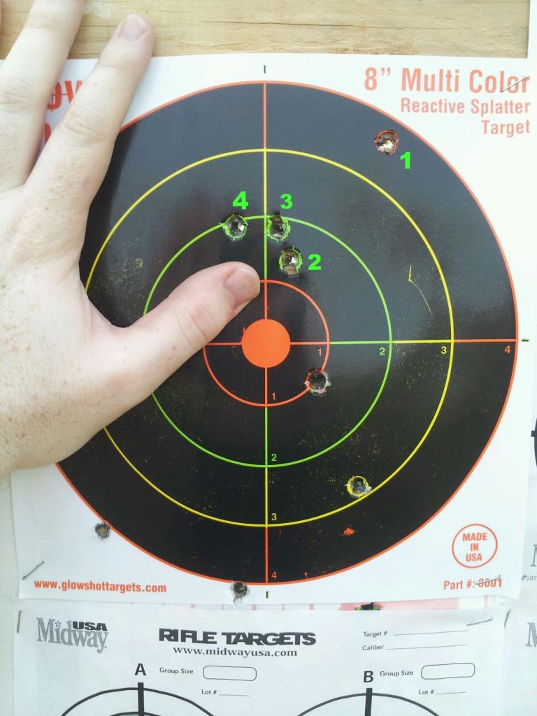

As the title says, I have recently purchased a Remington 700 sendero in .300 win mag. Sitting on top is a U.S. Optics LR-17, mounted in US Optics medium height rings on a LaRue Tactical 20 MOA picatinny rail.
I am having severe trouble sighting it in. First outing was having trouble with the bolt sticking closed after rounds fired...specifically the first round took some "convincing" to get out. It got better with a little oil, but was still sort of sticky the whole day. Also, we couldn't get the rifle to group less than 10" or so at 200 yards. In the middle of troubleshooting, we ran out of ammo. Took it home, cleaned and lubed, and came back out yesterday. Sticking problem is gone, but still can't get the damn thing to group at 200 yards....
The target below is at 100 yards.
After 1st shot adjusted windage and elevation.
After 2nd shot adjusted 1 click windage
After 3rd shot adjusted 1 more click windage
The one in the 1 ring I believe was the 5th shot.
Looking OKish so far, so we moved to 200 because that's where the zero needs to be anyway...
I shot this "group":
Dad shot this one:
We decided to stop wasting ammo and start troubleshooting, but being hardheaded I finished the box and shot this :
What say Snipershide? I don't have a lot of experience with bolt action rifles, so I'm not sure where to start troubleshooting. I figure it can be one of a few things:
1. What ammo are you shooting, be specific with us, so we can be specific back.

I've got a friend with reloading equipment, so I'll see if I can find some 190ish grain SMKs and load up a dozen or so and see if that helps.
You can let go of the twist rate concern, that 1 in 10 should fling everything stabilized up thru a 220 or 240 grain. If you are concerned about it, just check it with a cleaning rod.
+1 on checking the action screws and scope base screws. If you noticed the bolt lift got harder after swapping out the scope, it's likely to be part of the issue. The bolt lift issue will be there on unfired as well as fired brass if that is the problem. I have seen one 7mm Sendero that got the action screws tightened, that the bolt would not close on that rifle. A little grinding, followed by thread file and wire brush fixed it.
FWIW, I have shot a lot of these 300 Senderos, they do seem to like heavier bullets, 190's and up. The GMX is notorious for not grouping well, which reminds, how easy was the barrel to clean? If you have some 190 Gold Medal Match, that would be your test, eliminating ammo, seems to shoot well in most rifles.
And if you are not used to 300WM, you might have a bit of shooter induced error. Test that too - play the " I'm an ass****" game. Have your dad load the rifle, operate the bolt etc, you just run the trigger. At some point he slips in an empty chamber, if you shoot and flinch on the empty, well, that needs work too.
Had an A-bolt that was very sensitive to ammo - it was also 300 WM. 3-4" at 100 with anything other than Fed Premium, sub 1" with that. Very frustrating to troubleshoot.
Damn. Well good thing I saved all of my brass.
watch your seating depth. I run my bullets touching the lands with 75.5gr of h1000 on only neck sized brass for around 3-4 firings then FL resize them. do some research online for some loads. im sure there are a few guys in this thread loading or have loaded for a sendero.
I could almost copy & paste this issue with a recent purchase of a new Rem 700P in .338 Lapua with a nightforce scope & badger Max 50 rings. Horrible grouping at 100 yards 2-3 inches. Very long story short, I sent the scope back to Nightforce and eventually the rifle back to Remington. Both companies basically said the same..."We find no issue with our product". So good luck with getting this issue resolved... I've been dealing with this for almost a year now. Also, I noted that Remington only has a two year warranty on this rifle. By the way, it's not fun shooting over $700 worth of Lapua ammo trying to get a decent group. :) Anyway, I thought it was worth noting that you're not the only one having Remington issues. Great thread though...
Update: Bolt and Brass Pics
OK so got home, took it apart (again) and snapped some pics. Frame of reference for directions given are from the shooters position, bolt closed.
Lower bolt lug face:
Left side:
Upper bolt lug face:
Right side:
Front:
Brass, Hornady on the left Federal on the right. Notice scoring towards bottom. Is this normal? Another note, I can cycle the federal through the action no problem. The Hornady sticks bad. Same sort of symptoms: Bolt lift is unimpeded, but extraction requires extra effort (with the Hornady only). Federal is no problem.
These are the bolts holding the rail on. None seem to be taller or shorter than the others, and there are no marks on the tips of any of them. From left to right is how they were installed in the rifle from muzzle to buttstock.
Sorry to hear that, but thanks for letting me know. I just got off the phone with Remington customer service and they're sending me shipping instructions and a pre paid shipping label.
I pretty much expect them to come back and say the thing is a tack driver and it's all my fault, but I'll be very interested to see what they say about the sticking rounds.
