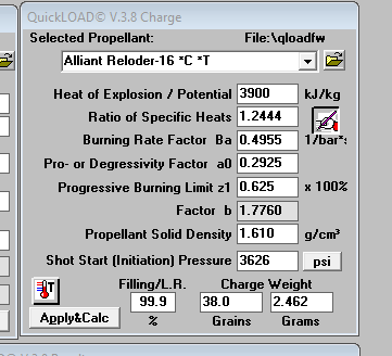

You can pull these numbers from quickload and use it in the excel barrel life calculator. You can download it here:
Looking at other ball powders I’d estimate it to be around 3800 kJ/kg or so, but it’s hard to say exactly.
I am done banned for life on that site, or until I can get a new IP address. But in QL, isn't that the BA number? The kg/kj outside temp factor.

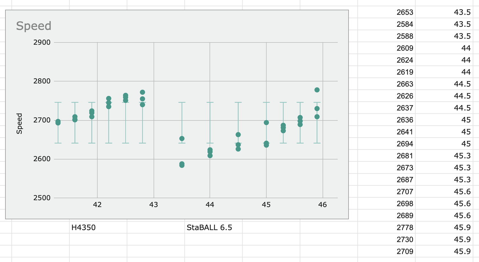

Here are the results...
42.9 Gr. 2,609 MV 12.3 SD
43.2 Gr. 2,634 MV 15.6 SD
43.5 Gr. 2,657 MV 11.9 SD
43.8 Gr. 2,706 MV 14.3 SD
44.0 Gr. 2,728 MV 11.2 SD
44.3 Gr. 2,737 MV 8.1 SD
44.6 Gr. 2,763 MV 4.1 SD
44.8 Gr. 2,784 MV 7.8 SD
45.0 Gr. 2,811 MV SD skewed due to an error ES @ 45.0 was 26 FPS.

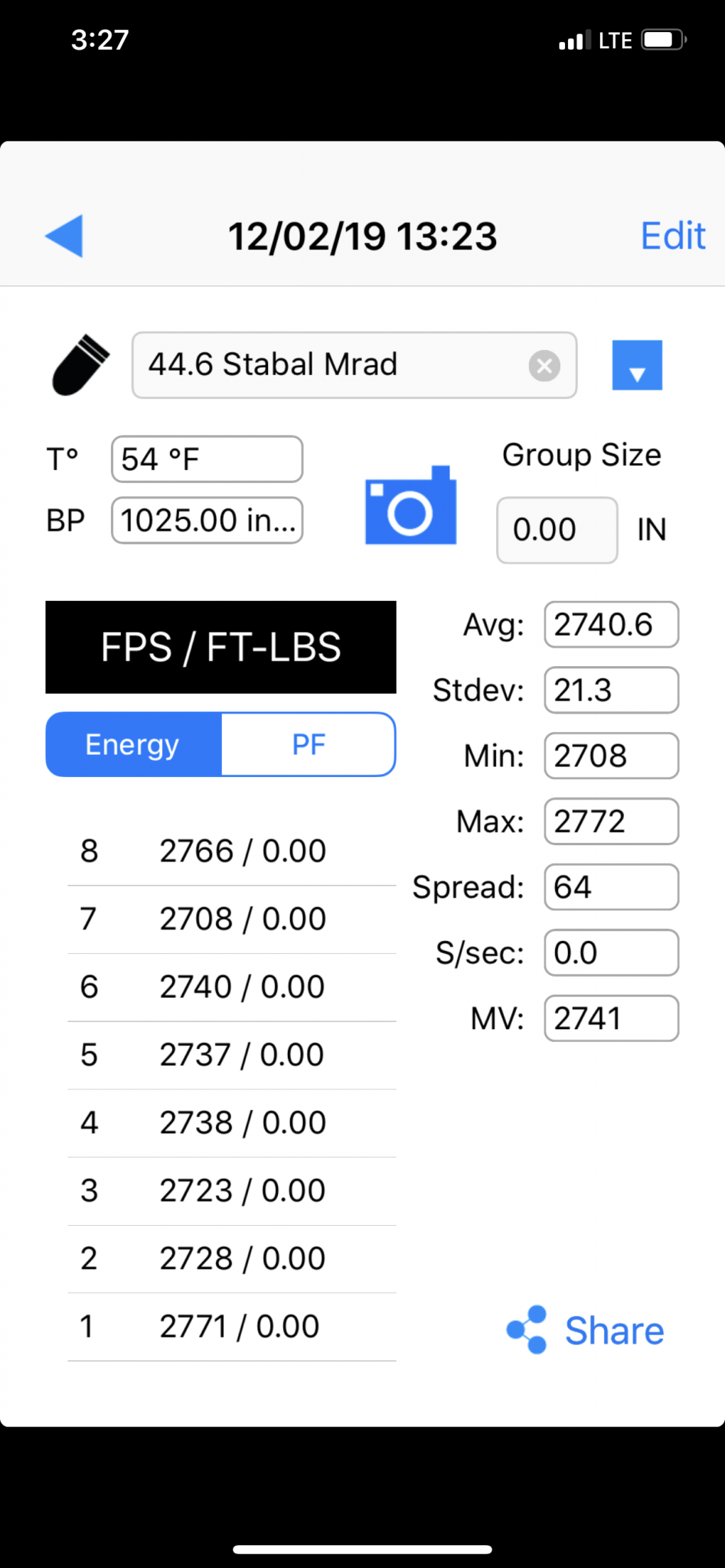

Stopped due time, have 20 rounds loaded at 44.6 Gr. and going to run these tomorrow. Going to get a 20 shot string to capture accurate SD & ES
All above shot at 300 yds from my MRAD 6.5 with bipod and mono, the best group was the 44.6 at 1.3” Surprisingly all loads group really good, OCW was 44 to 44.8 all about 1.5” high and 1” right...
The temp was 54* ammo at ambient temps, bolt opened to cool for 3 minutes between shots.

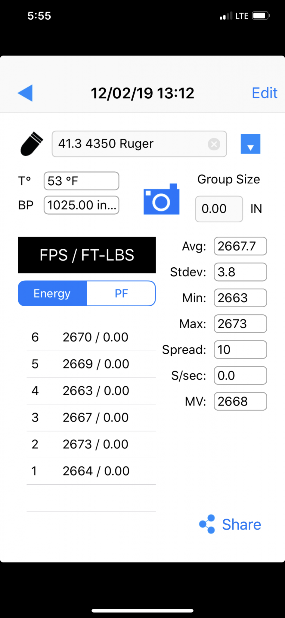

FYI 41.6 Gr. H4350 MV @ 2,752 SD 3.6. The gun likes 2,750’ish MV.

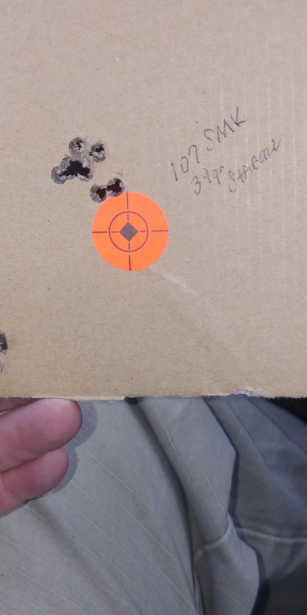

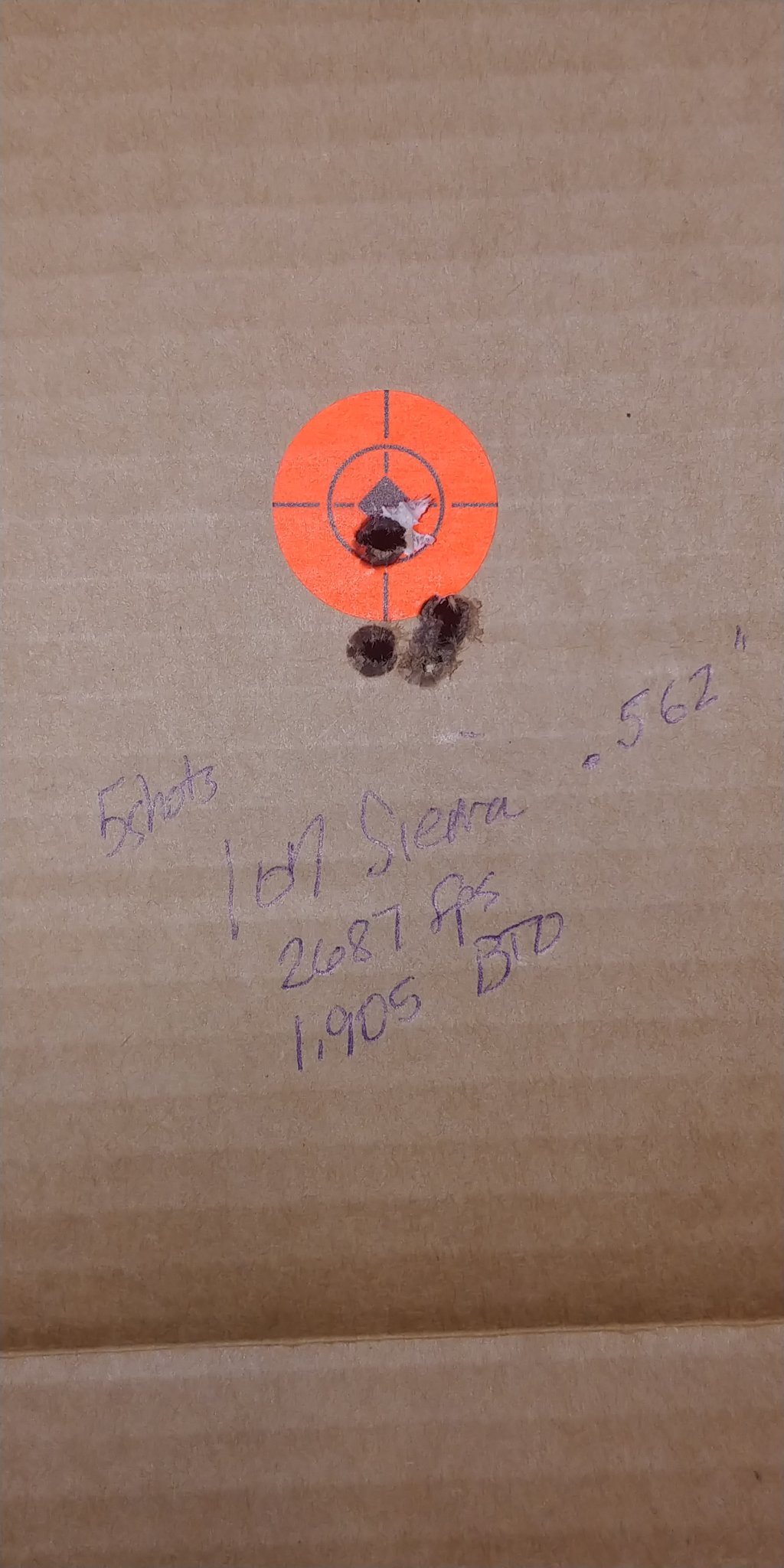

My findings with Staball in my new 6 GT are that it is dirty but cleans very easily.
It likes to be near capacity in case fill.
I've been breaking in my 6GT barrel with it and various bullets in the 105 weight and am happy with it so far.
I have not pushed it hard yet.
39 grains under 107 SMK is getting me 2940 fps and 12 SD for 10 rounds. This is with 130 rounds on a new Bartlein 7.5 twist 5R 26" barrel out of new Hornady brass.

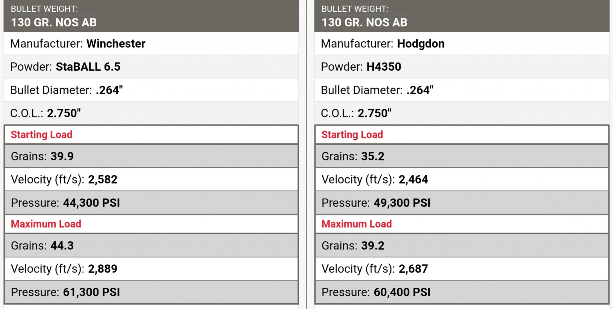

Here is the published data for a 130gr in the 6.5 Creedmoor others are similar. Only showing this since the two powders happen to show up next to each other.
