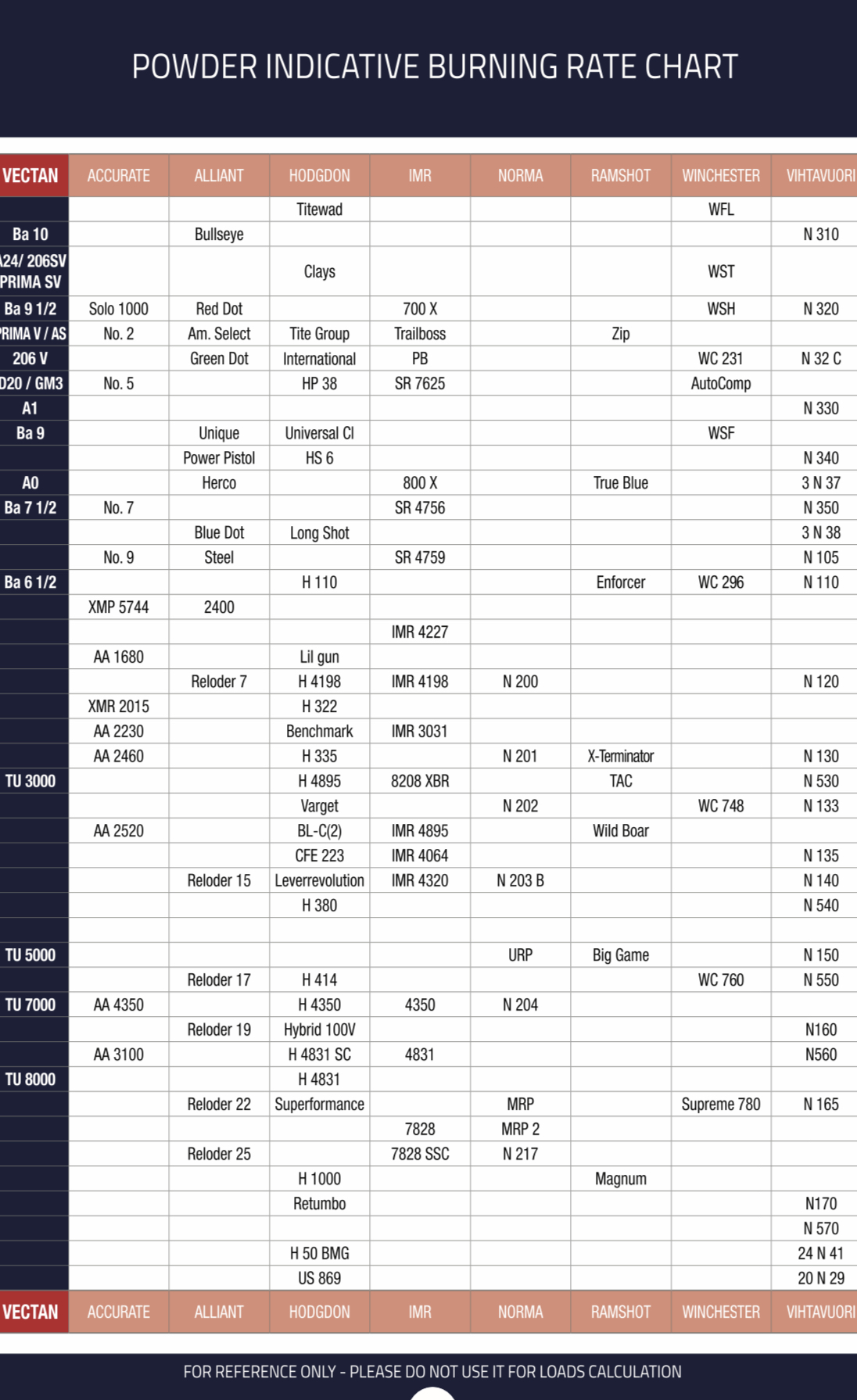

    Looks like burn rate is similar to unique and WSF so you should be able to step on it a good bit more.
