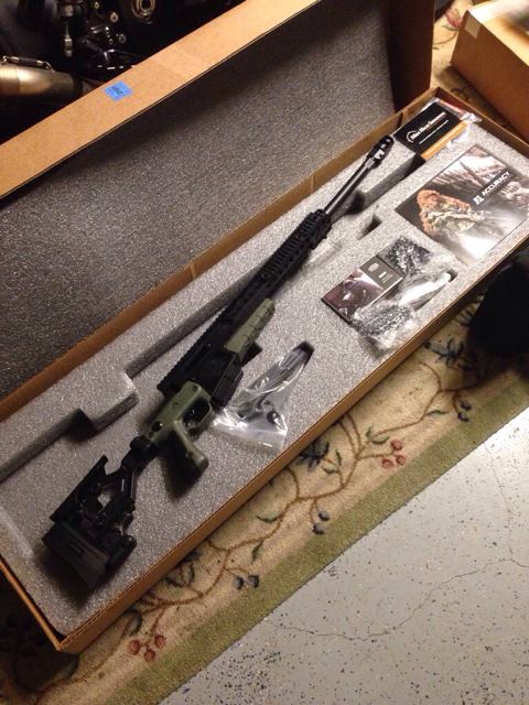

As far as the MRAD, I sold mine in January 2013 and purchased the AX MC 308 with 260 barrel and just got it last weekend. Trust me there's no comparison between the two. Build quality in the AI and materials much more refined. Didn't need the 338LM, since I have 2 DTAs with the 338LM conversion. The 338 AI will eventually have 308 conversion, but probably not until the end of this year or early next years, when AI gets caught up on their present orders. Be patient and you' have the best of both worlds!!!
Keep both and go to the doghouse, it will be worth it' as you know' having shot both, but I feel you pain! Good Luck. Your posts have always been most helpful....

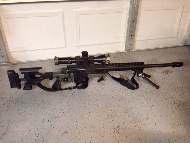

Got my AXMC 308 out to the range this morning and zeroed. Here's the first 20 shots:
First shot 4" high and second shot at the top point of the black center square. The next 18 shots took out the center of the target. She's definitely a keeper! The few shots low and to the right were me under time constraints.
