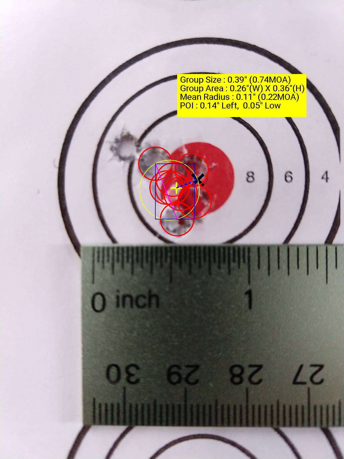

    I run a 16 on my Vudoo and did this the other day at 50 yards (10 round group). My Vudoo also has a can on it.
    This is without called flyer
    7045772
    With called flyer.
    7045777
