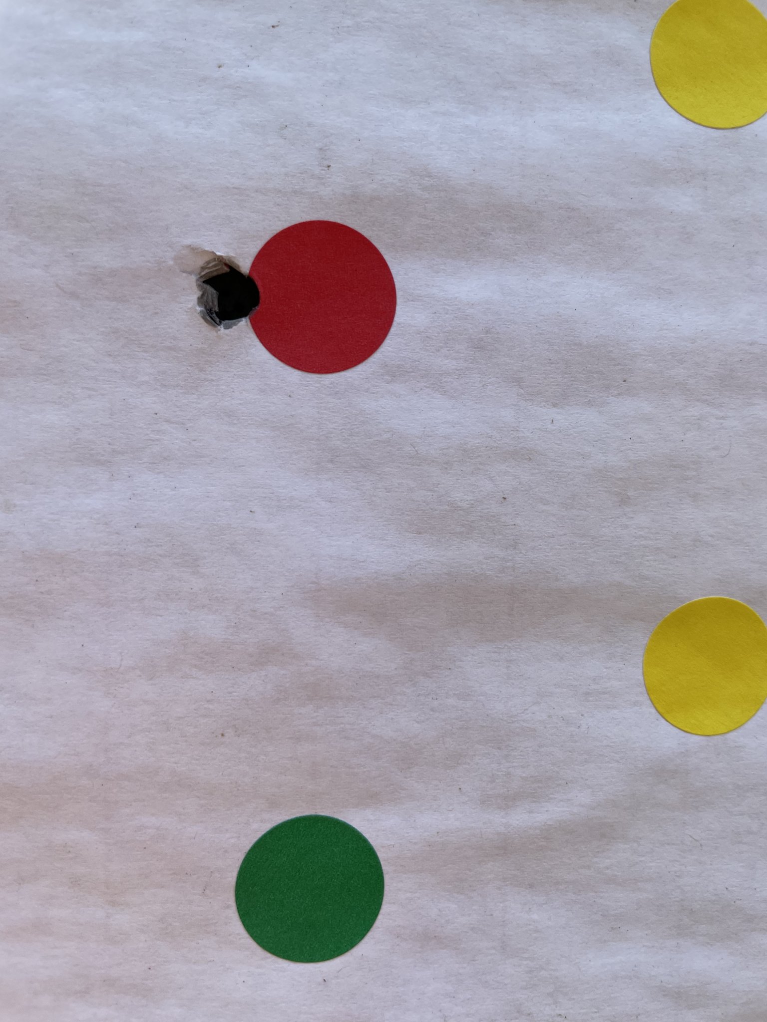

I was in your shoes last year and went the MPA PMR Pro route. Zero regrets thus far with 900 rounds on a 6CM and the 60 degree bolt throw is really nice.
I’d ditch the Bravo idea b/c getting enough weight on them is an issue.
I’d think twice about a 308 also unless u love recoil and poor ballistics🤷🏼‍♂️
Here’s the 100 yard 3-shot group I fired last week with the MPA after swapping scopes.
Mine came with the EC tuner but it consistently shoots between 0.25 and 0.50 MOA
