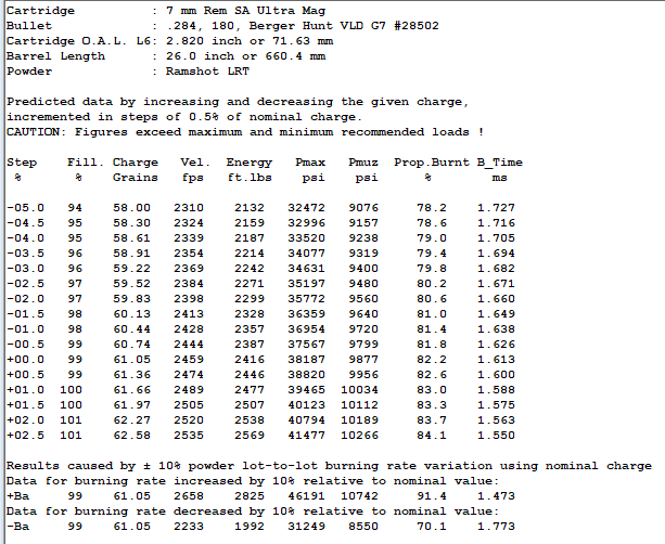

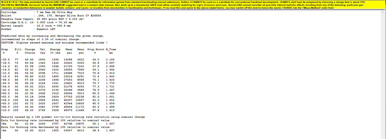

Sounds good keep me posted on what you find out
Can you post a link to the 7saum lrt info. I can’t seem to find it. Thinking of trying it in mine.
Thanks
It's probably going to be a bit too slow for that cartridge?
you and your 2.820" lol
But I also agree that it's too slow. Reason it may work in a 6.5 is expansion ratios. smaller the hole per powder column is going to need slower powders. For example if you necked up the 7saum to say 50 cal. It would have more capacity but the powder that would be ideal would likely be in the magnum pistol range.
