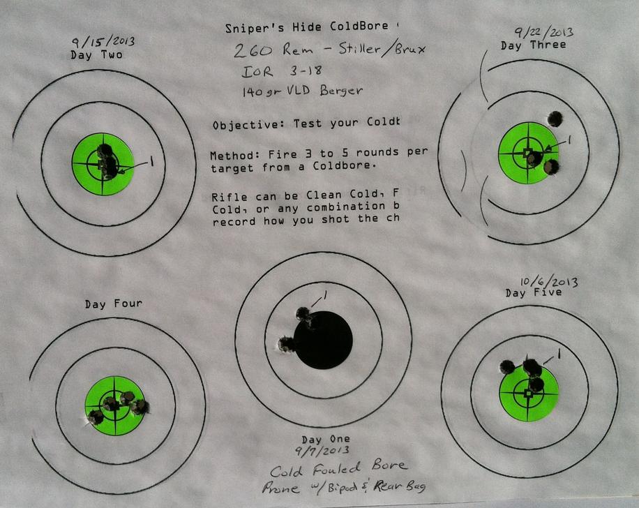

Day 4
I was going to shoot last night, but the mirage was wicked. I got side tracked with the kids and forgot to take the targets down. Well....the wind blew last night and those targets are gone. So here it is tonight.....260 rem. 140g. VLD, 5@209yds, 70*F, low humidity, 3mph R to L wind, Gemtech HVT was screwed on, that's a 3/4" dot for reference. Sun was settin' fast, so I didn't pull the trigger on the .243... 2013-09-13_19-28-09_191.jpg
edit to add: bipod, rear bag, off the bench....grass is tall out to my 200 yd berm
Day 5

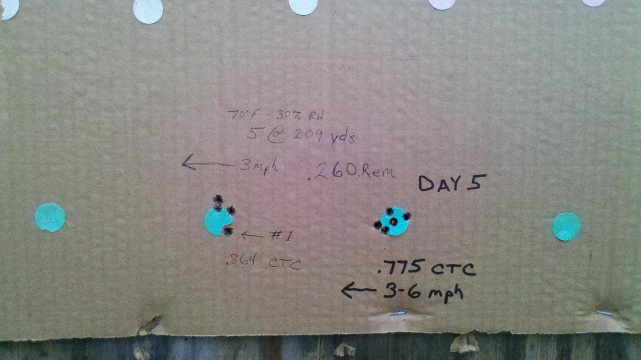

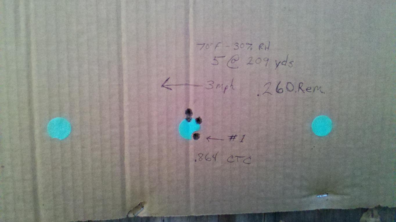

Same deal as day 4. Shot this 'morn about 0800. 54*F, 100%RH, wind was R to L 3-6ish....It's been fun, good idea Lowlight.2013-09-14_08-24-11_667.jpg
Shot day four here as my wife was yelling at me to hurry up, we had to get to my sons football game.

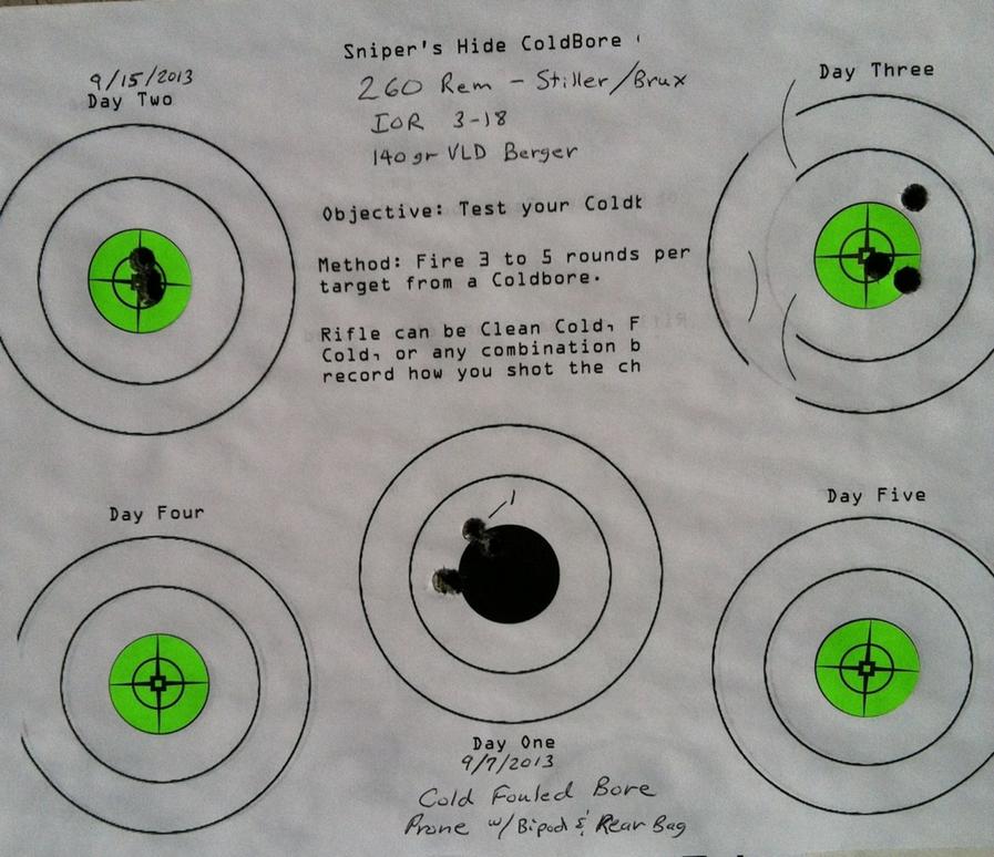

For my day two run I decided to throw in a twist and run this drill on 3 different rifles. This allowed me to (fairly) do this several times in one day since my range is a bit of a drive. The players were a GAP10, GAP HRT, and Seekins-based SPR in .223...3 very different sticks. I kept all tries at 3 shots since I ran these at 850 (600 for the SPR) and I'm not quite ninja enough to time the wind perfectly 5 shots straight. All 3 sticks were clean cold bore and I did not dry fire to dial myself in to each platform. I also pulled spotter duty so I had around 20 minutes between attempts. To give you some scale...targets were a full sized IPSC @ 850 and a 2/3 IPSC at 600. All prone off bipod and a rear bag. Factory FGM 7.62-175's and FGM .223 69's
1st up was the GAP 10. There was a steady/light right to left breeze at the treetops that I couldn't see and my CB splashed about 9" from center at 8'oclock. Without correction I sent 2 more and was greeted with the smallest 3-shot group I've ever shot from this rifle at this distance (2.5 inches). Safe to say I didn't really care that it was just outside MOA from center. To save myself a paint run I dialed a slight correction and shot the top group...all approx. 4 inches of center. This rifle has around 5K rounds through it.
Next up was the HRT and as always it was a freak show. CB is at 3 o'clock. Follow-up stacked dead nuts on top of it. 3rd went a little high.
Lastly was the SPR at 600. CB is at 2 o'clock then the wind kicked up and pushed the 2 follow-ups right. This stick is new and I have virtually no trigger time on it...I think today made 40 rounds through it to date. I'm quite impressed with it so far and it will make a great trainer. My shooting partner had one of those reactive T-Zone targets and I was tagging it easily at 300 yds.
While I didn't exactly run these the way this thread intended (shooting short range here is a PITA) I think I had more fun shooting today than I've had in awhile. In fact I'm not a gambler but today may be a good day to buy a lotto ticket. Great idea for a drill and I may make it a habit of taking a few extra rifles with me just for this purpose.
Got day three done tonight after work. Fouled cold bore still with around 150 since last cleaning. I already know nothing changes with a clean barrel. The bore is very smooth and never collected copper from day one. Barrel has around 600 rounds on it so far.

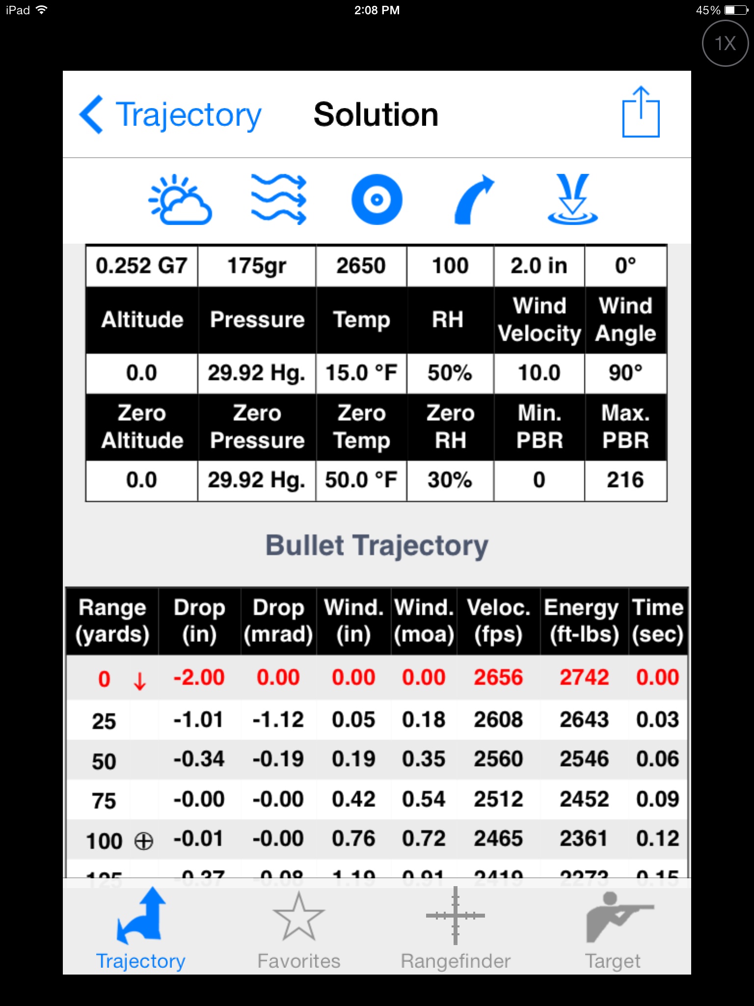

This is easy to show, running the numbers in a ballistic problem, the offset at 100 yards with zero conditions at 50 degrees and the current conditions at 15 degrees shows .01 mils.
A minute at 100 yards for a 30 degree change is huge. It's easily disproven, but it's more about his attack on me than what is really happening.

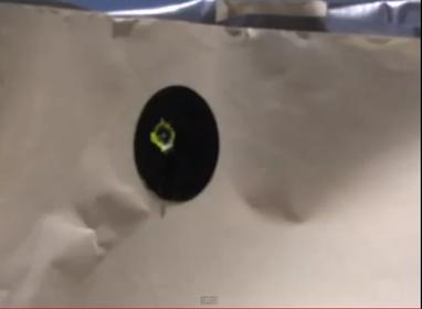

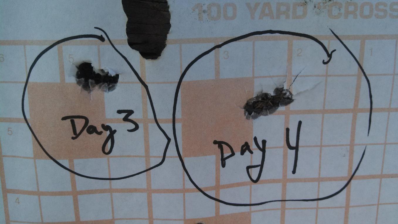

And I have demonstrated on video leaving the bullets out in the sun, running them over a 100 degrees, and nothing changed at 100 yards.
Been there, done this, several times. I have been doing this for a very long time. And I always provide information, you're perception of me attacking people is alway in response to people attacking me and not the message. You can easily see people who are honest agree with me during these debates.
So, Raise your hand if you think I was talking about internal ballistics ?
But for you, so you don't have to go to YouTube and find it,
Screen Shot 2014-01-12 at 2.42.17 PM.jpgScreen Shot 2014-01-12 at 2.42.43 PM.jpg
Your assumptions are wrong, and your single experience doesn't make it so... to move the bullet an 1" @ 100 you need a helluva lot more than 30 degrees, trust me.
if this was the case, you would be moving your zero constantly. If you are, you have a mechanical problem.
<iframe width="480" height="360" src="//www.youtube.com/embed/3UZ-mApuUoM" frameborder="0" allowfullscreen></iframe>
