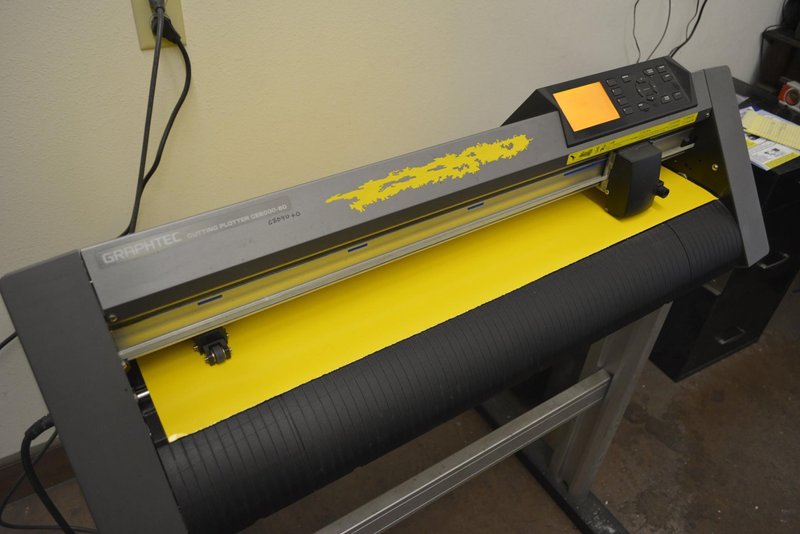

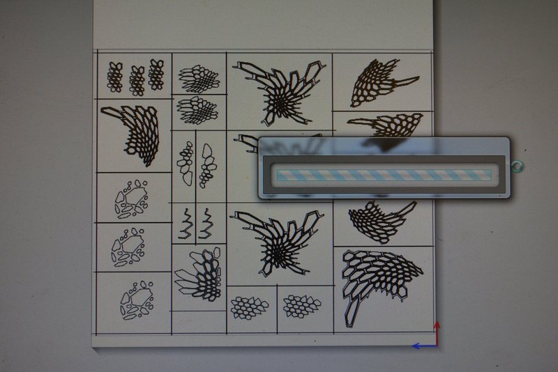

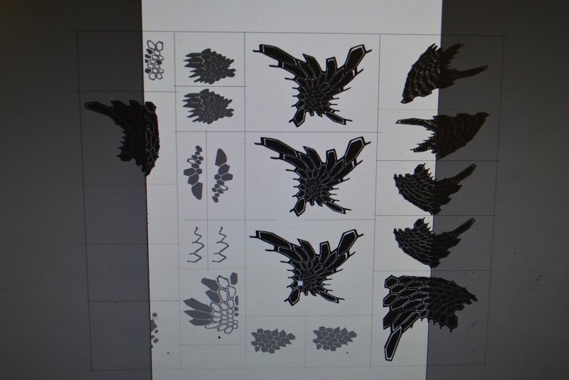

    Made in house. Happy to help. $40.00+shipping.
