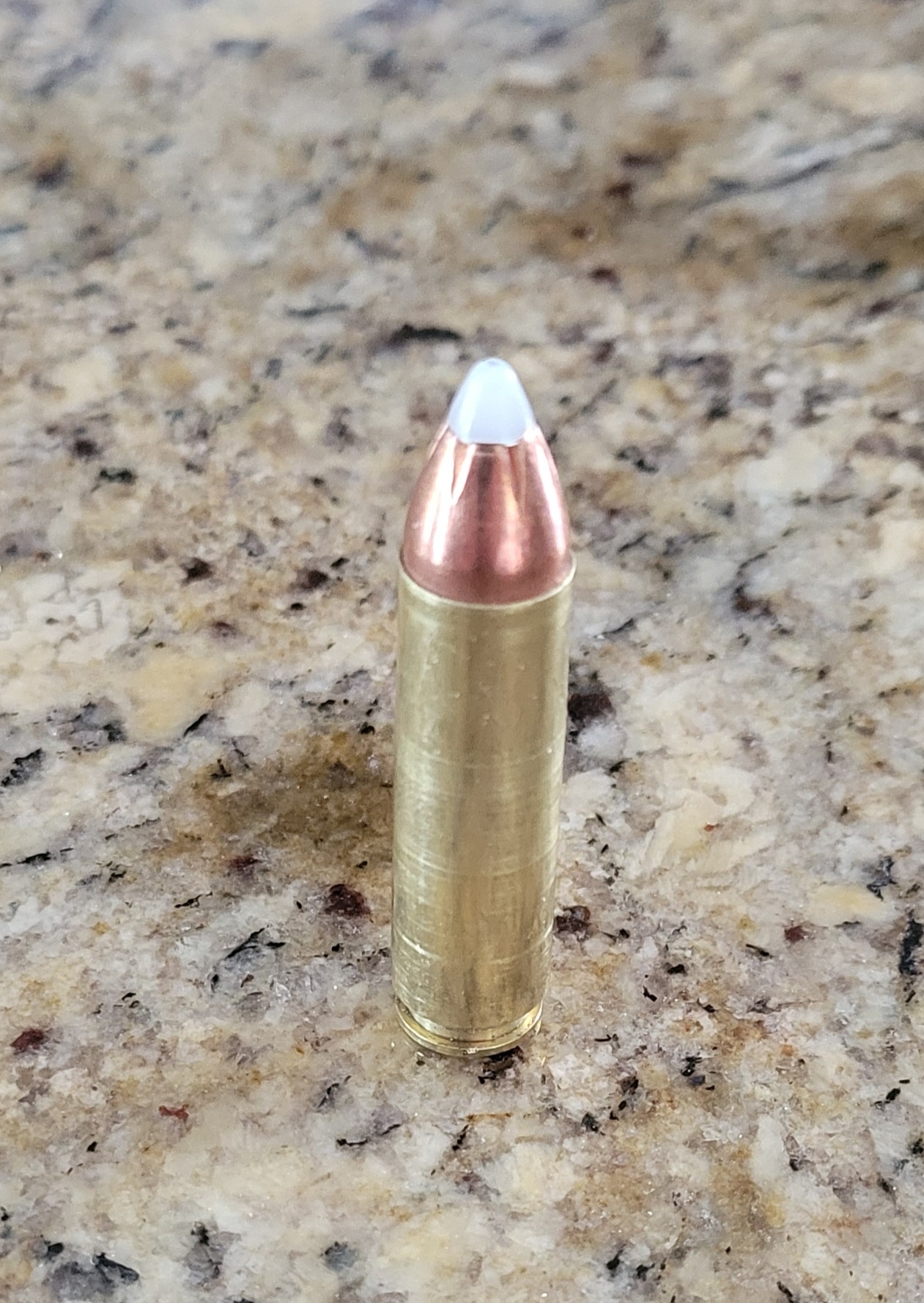

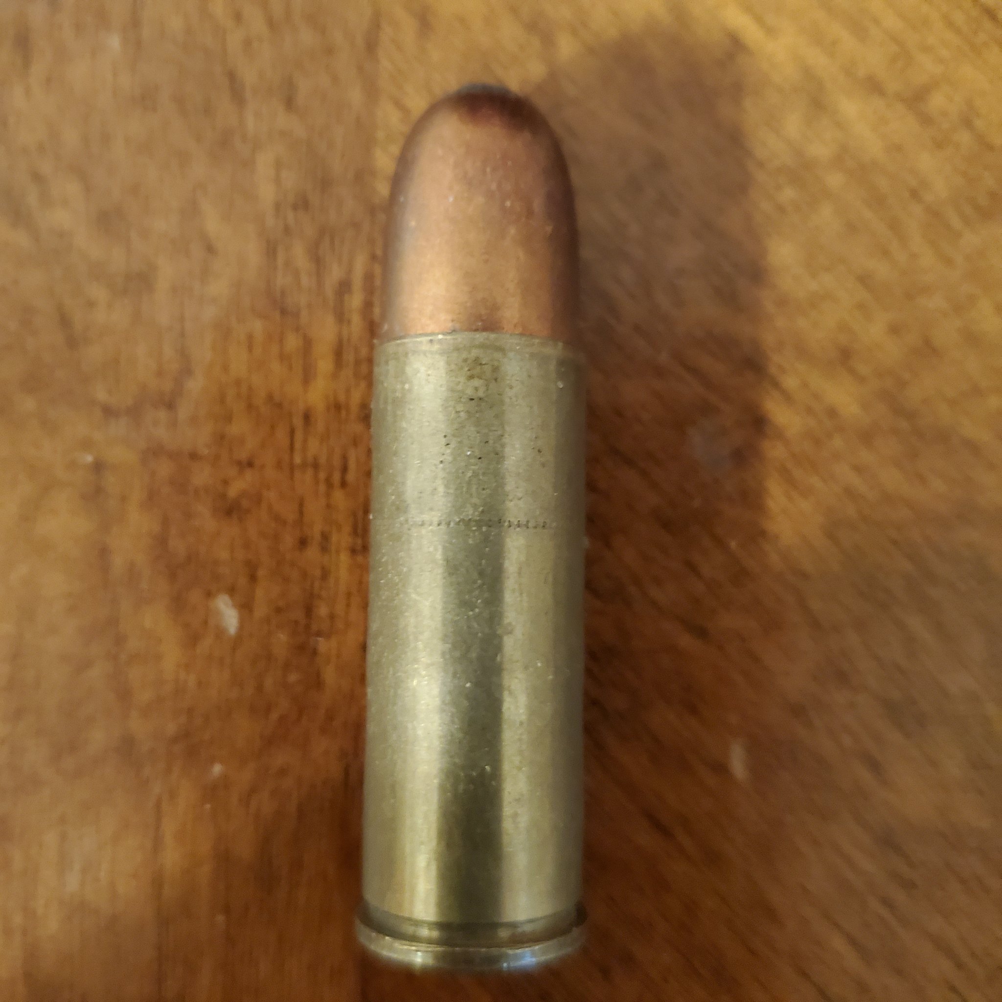

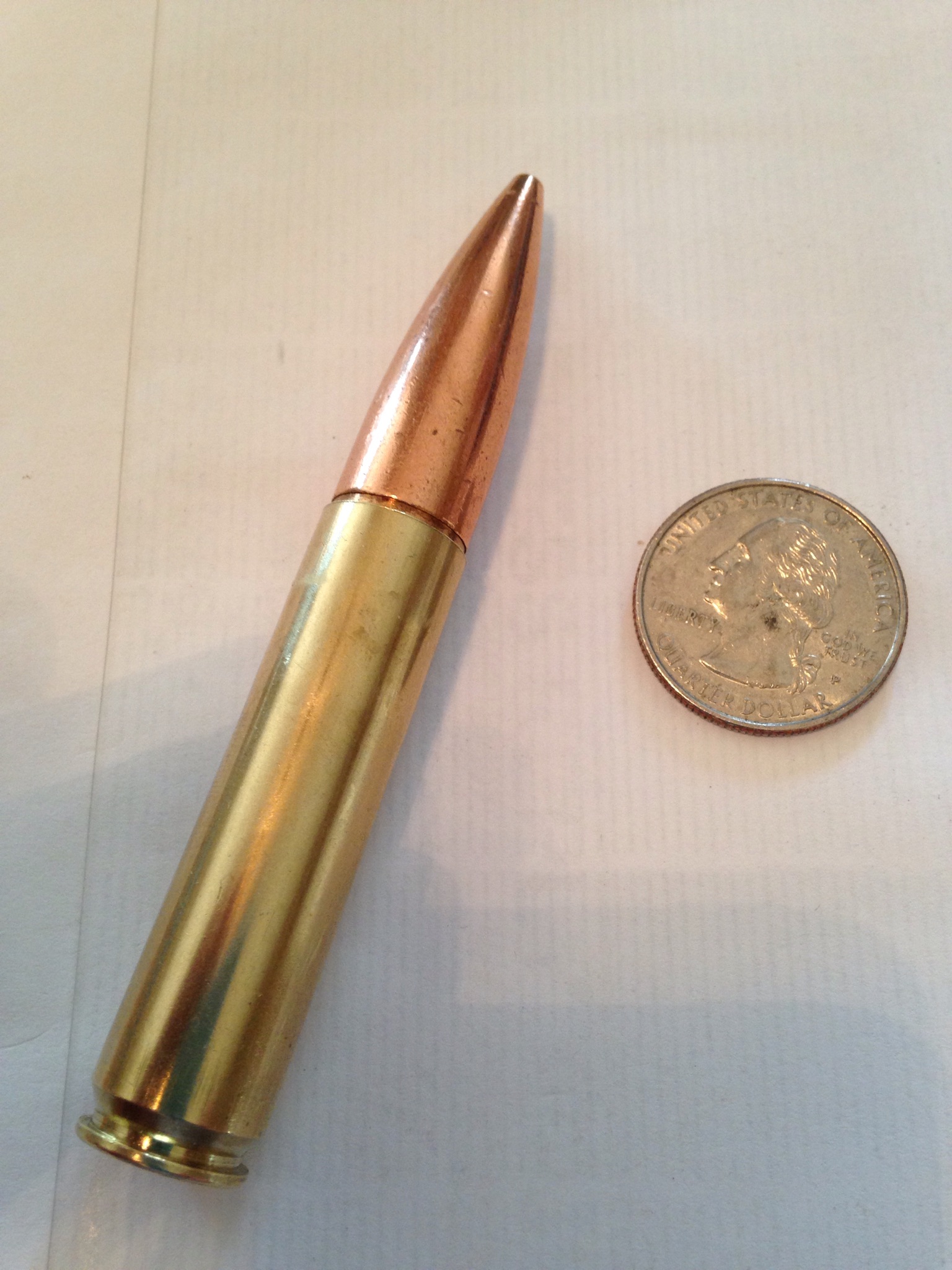

338 thumper: not my photo nor do I claim any rights to it
416 spike: not my photo nor do I claim any rights to it

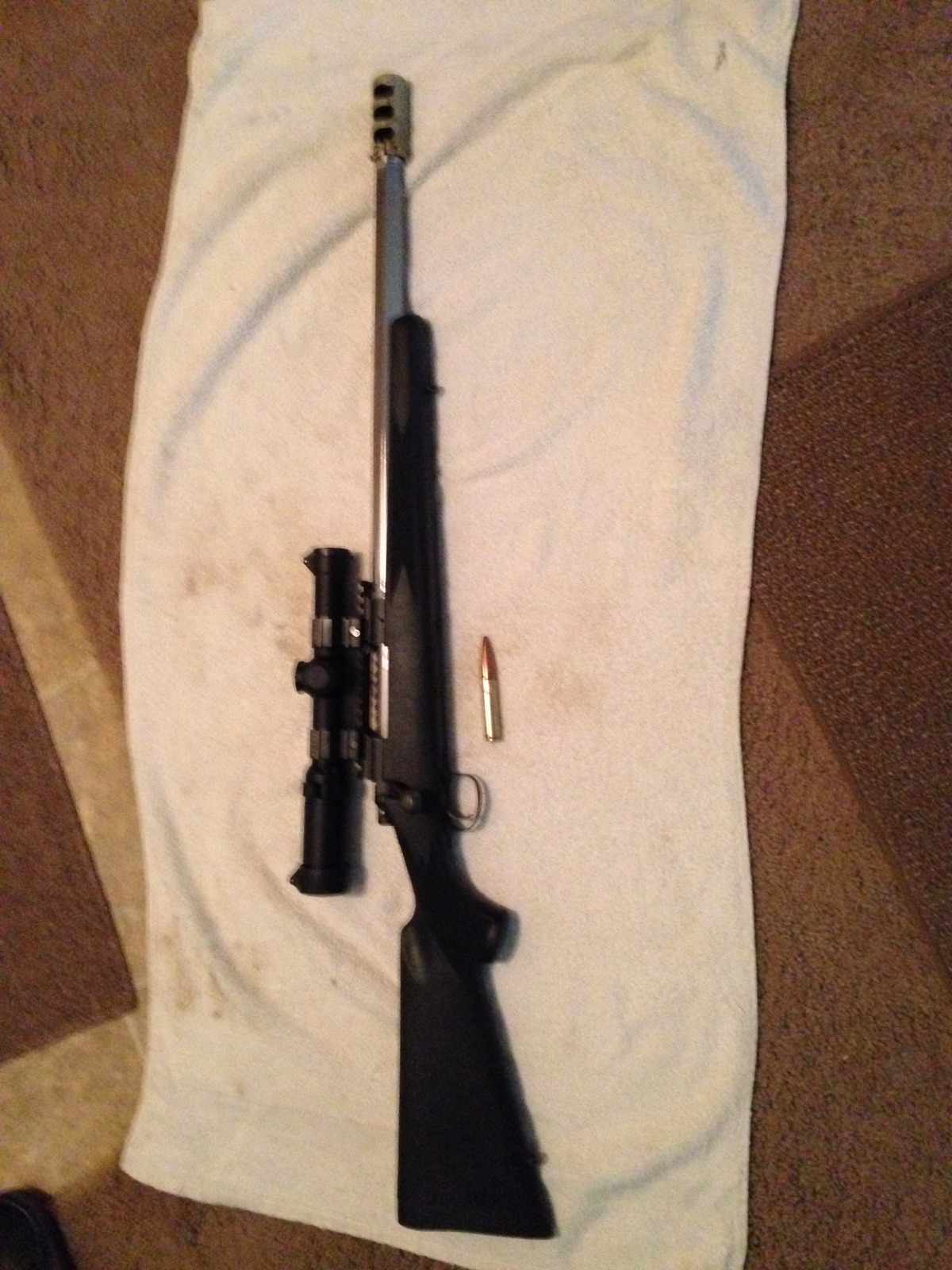

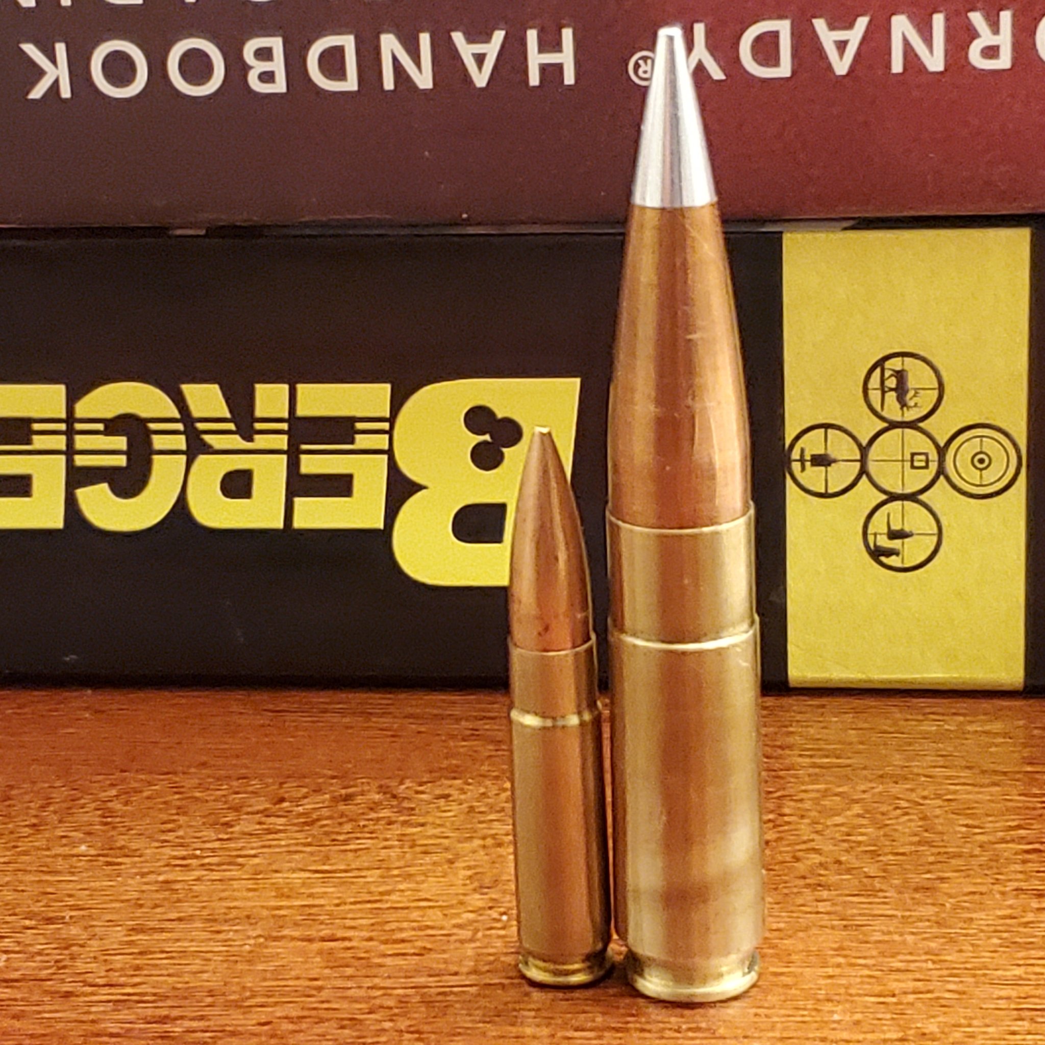

Ignore the muzzle brake, not needed. Turned a proper thread protector and the brake sits in the case. Have only done subsonic as of now. As mentioned above, this concept has the ballistics of an artillery round. Knowing distance to target is crucial. Other than range play I consider it a 150yd max rifle, and a fun shop activity while the wife watches cop shows.

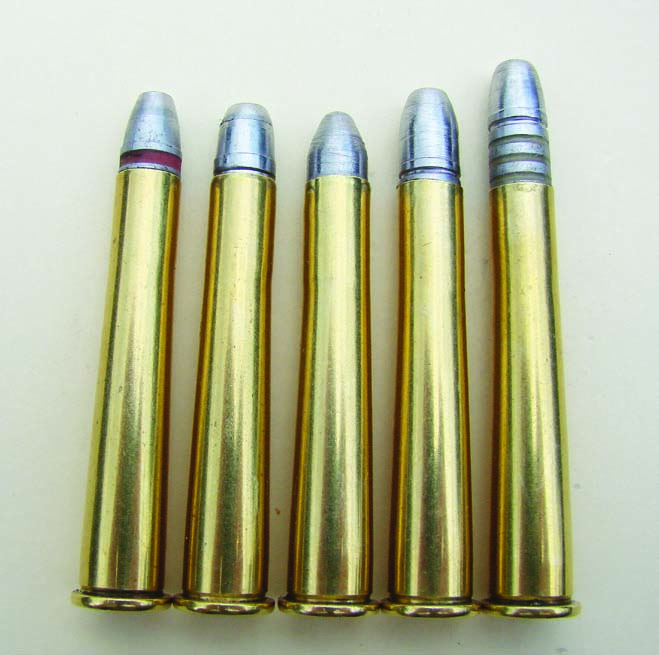

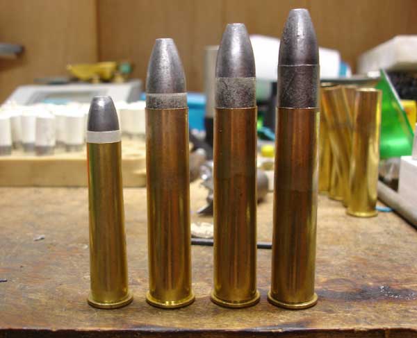

For a rimmed option in lever gun or single shot look at the 360 buckhammer, it's a 30-30 straight wall to .358.
But again the 450 Bushmaster is the easy button with subsonic 395gr loads already available from Hornady and based on a 308 case family.
I’ve been following this thread with the back and forth with interest. If you don’t mind a rimmed case a couple of other options are the 357 Maximum and the 38-55 Winchester. Both have a proven track record and brass is available. I feel that the 350 Legend was created to be a “Rimless” version of the 357 Max for use in the MSR platform.
Of course, I really miss the Siamese Mauser that my father had in 45-70, now that was a stops ANYTHING rifle when using Ruger level loads.
375 Winchester is the improved 38-55 for higher pressure loads. Both based off the 30-30 case, it takes a .375 cal bullet

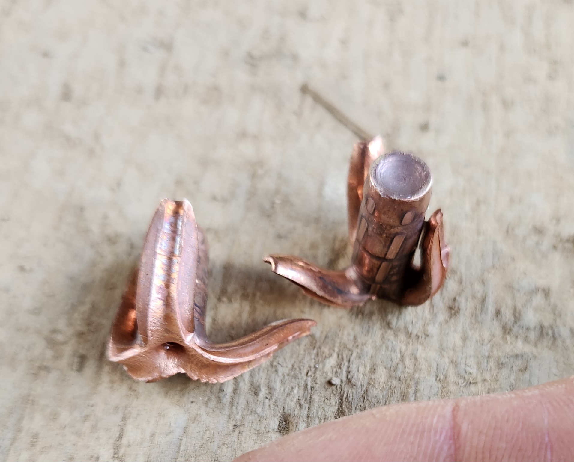

I was on a similar quest for a straight walled deer cartridge that would allow shots out to 300 yards with good terminal performance.
Most of the common options were lacking in performance past 150 yards.
I finally went with a .458 Lott. (Defiance/Manners/Bartlein/Trigger tech/etc)
300 grain Barnes Tipped Triple Shocks are shooting sub MOA and start out at nearly 3000fps.
Less than 15 inches of drop at 300 yards with a 100yd zero and over a ton of energy remaining.
The light and fast option was better out to my 300 yard property line than the heavy higher BC options.
I'm very pleased with it and expect it to perform well.
No on game testing to report as I passed on a couple of huge bucks waiting on a monster buck.
In hindsight, that plan sucked, but I plan to take it coyote hunting next weekend.

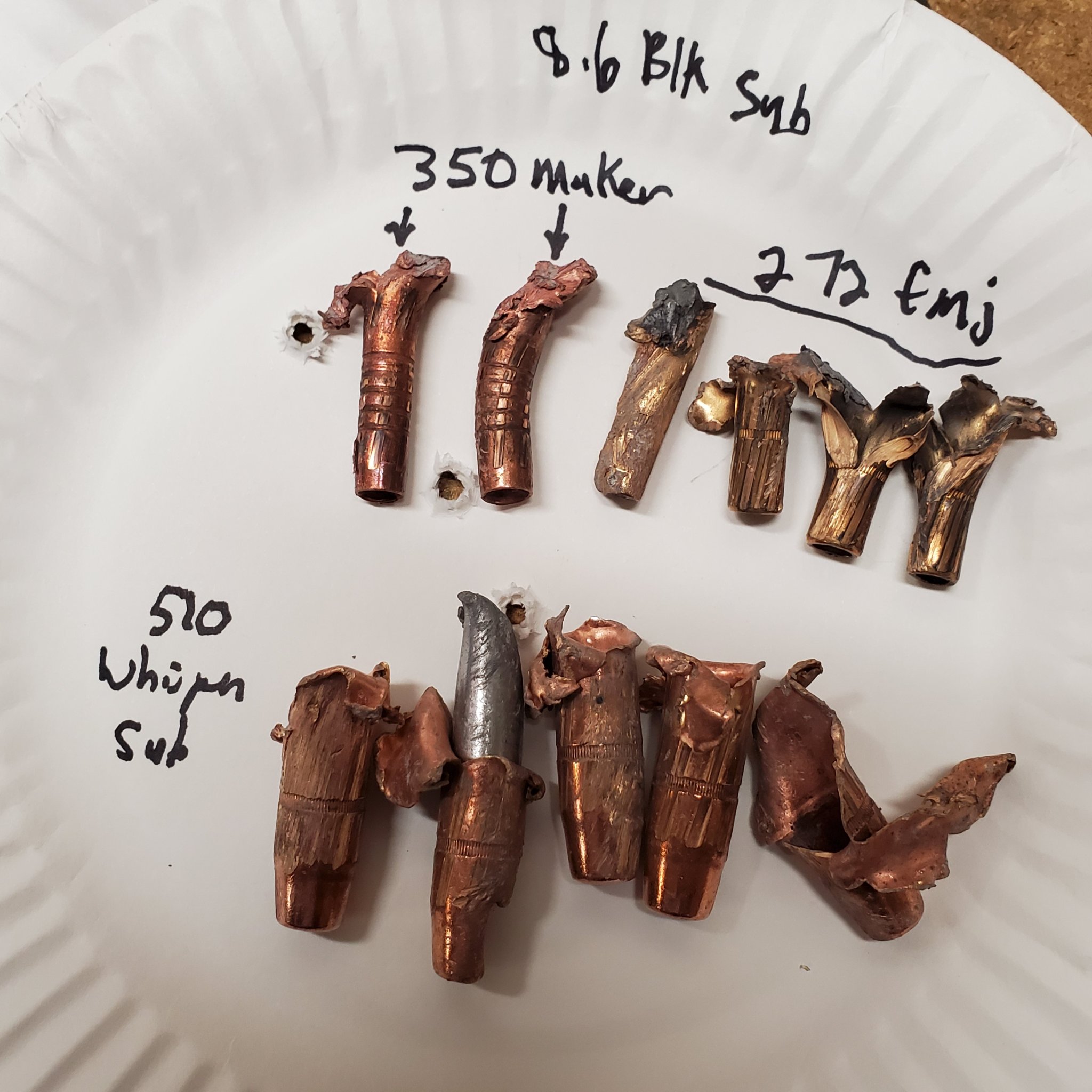

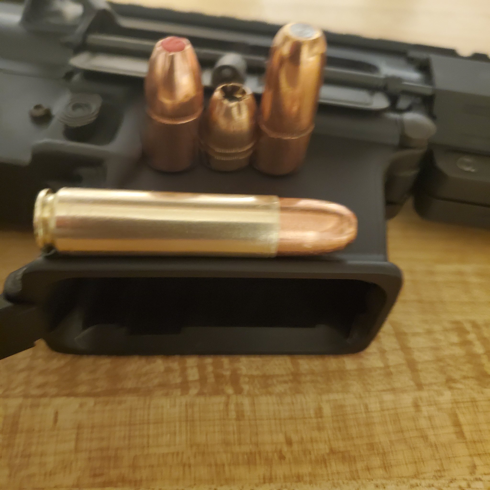

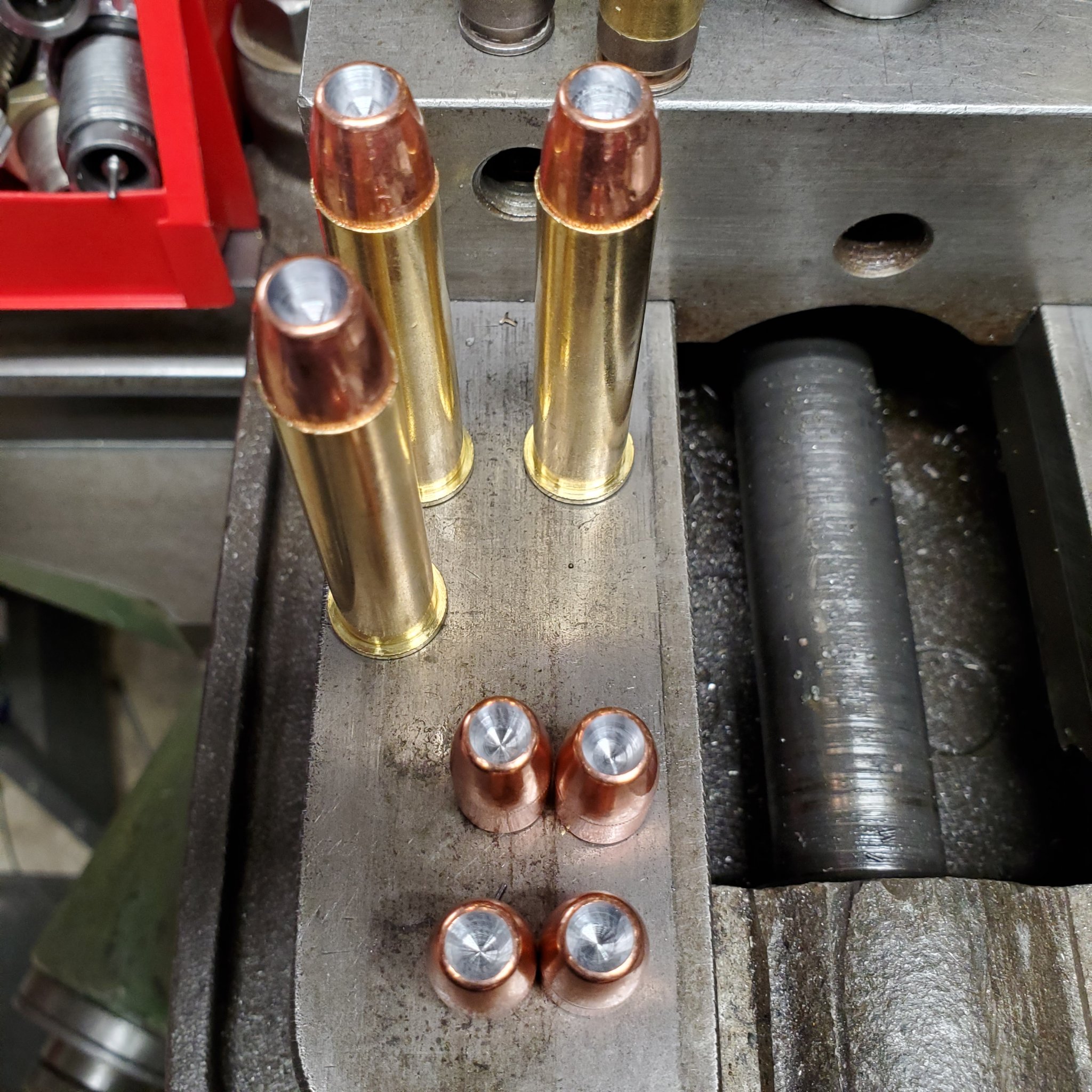

A 510 whisper will fit your needs 750 gr Amax 1.050 BC only loses about 180 fps from muzzle to 1000 yds when fired subsonic. There are several variations of this cartridge, mine is the orginial, SKS sells expensive brass for it.
And bullets as heavy as 1002 grs available. Fit the Rem 700 LA 10 twist barrel
Short barrel? Suppressed? It's all good. Plus you can go high velocity short range with 350 gr copper bullets, or cast some soft 900 grain bullets for close range smack down.
The 510 whisper vs 220 gr in 300 blk ....or 45-70 with sub HP bullets.
But only the 510 whisper brings the energy and diameter to meet the longer down range needs.
