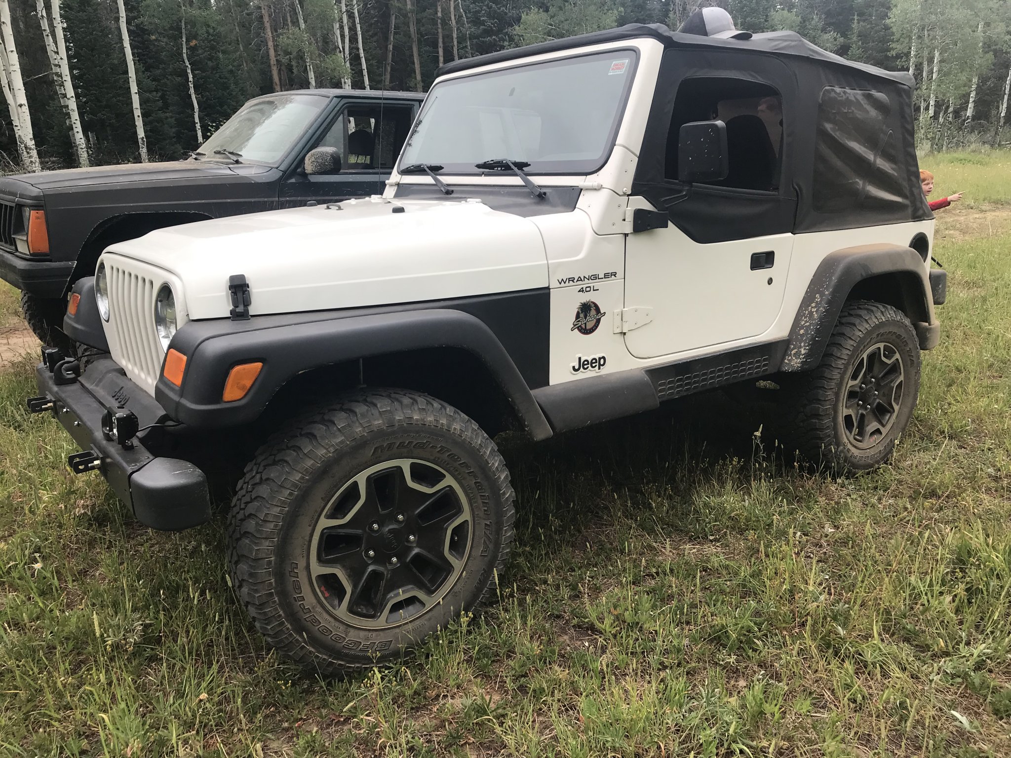

Or an old jeep ;)
How did you know??? I just bought a TJ

i tell you, the jeep wrangler i got is so nice because i can do just about everything myself. yeah, it rides like a haywagon and only gets 19 mpg, but being able to take care of it all myself is great.
the other one i have is a buick lesabre with the 3.8 v6. old, but very reliable.
