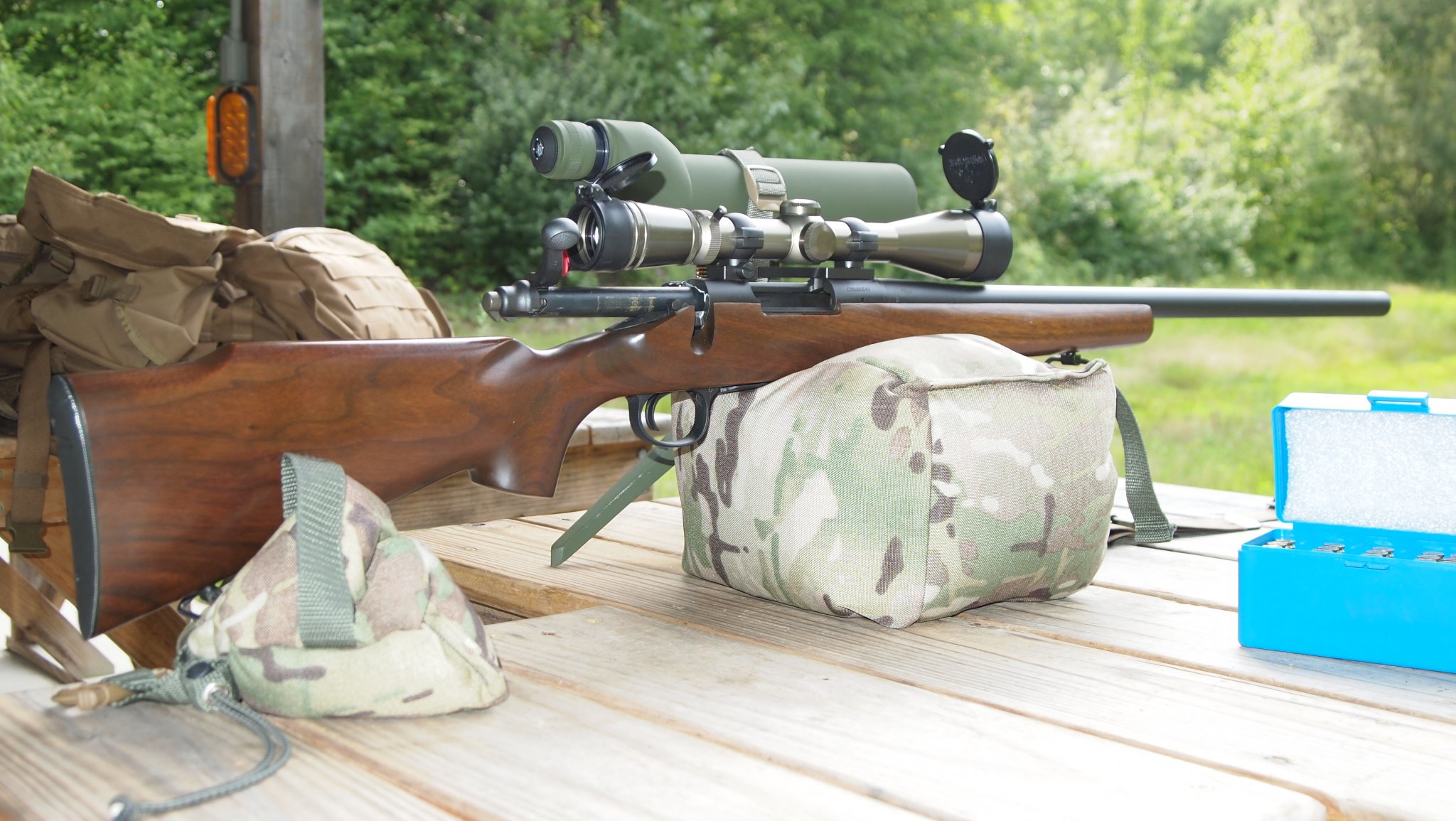

    Been thinking the same. Looking hard at Zeiss again because I miss my conquest 5 when dusk came around. The Zeiss V8 is amazing it’s just MOA and I am a MIL guy.
    But it I only had one rifle and One scope to do all, that would be on top of my Tikka but I am more a hunter than a match guy.
