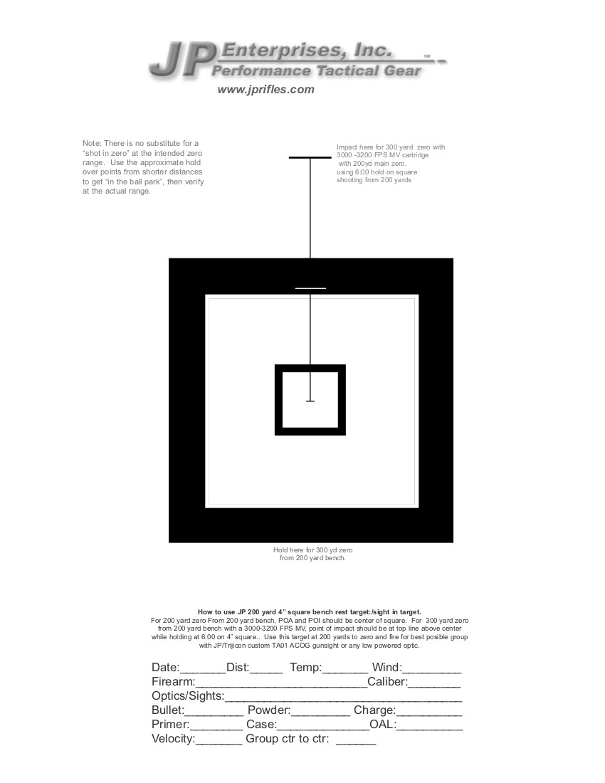

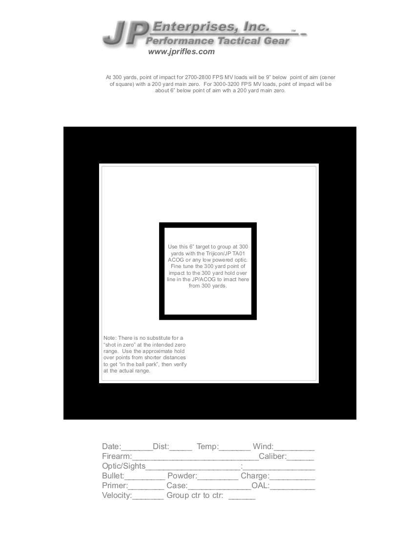

This has worked great for load development from 100-200 yards, and when I got to the point of shooting a worked up load at distance I'd use regular NRA type round black circle targets or big squares, like these from JP
Now that my precision rifle hobby has evolved to the point where I'm basically shooting to justify my precision reloading hobby, its getting harder to find those little increases in performance/accuracy at the reloading bench. This makes the gains observed on target smaller and smaller, which is forcing me to work farther and farther out to be able to more clearly perceive improvement. Basically diminishing returns has forced me to find a better system of optical alignment for my POA. I find myself wanting to do load development work at 300-600 yards, and none of these targets I've traditionally used seem to be very ideal for that task.
