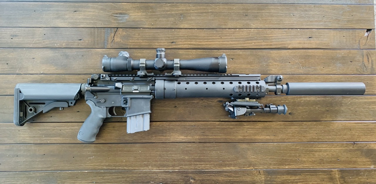

I finally finished my mk12 mod1 this afternoon. I can't find the correct a.r.m.s. rings so it's running mark 4s for now. I want to replace the trigger and I have my eye on the correct front sight, but money is getting thin! All things considered, it's up and running at least.
The rifle is so much easier to carry and quieter than what was around at the time (2008). Got to play with one overseas. The 77gr ammo and suppressor made a pleasant diversion from standard fare. Not to mention breaking contact was safer with a full auto; suppressor off and lots of fire & noise! The other options were less "cool" M110 (bit of a long pig), M14 EBR, and of course the M107 (pack mules were hard to come by🤣)

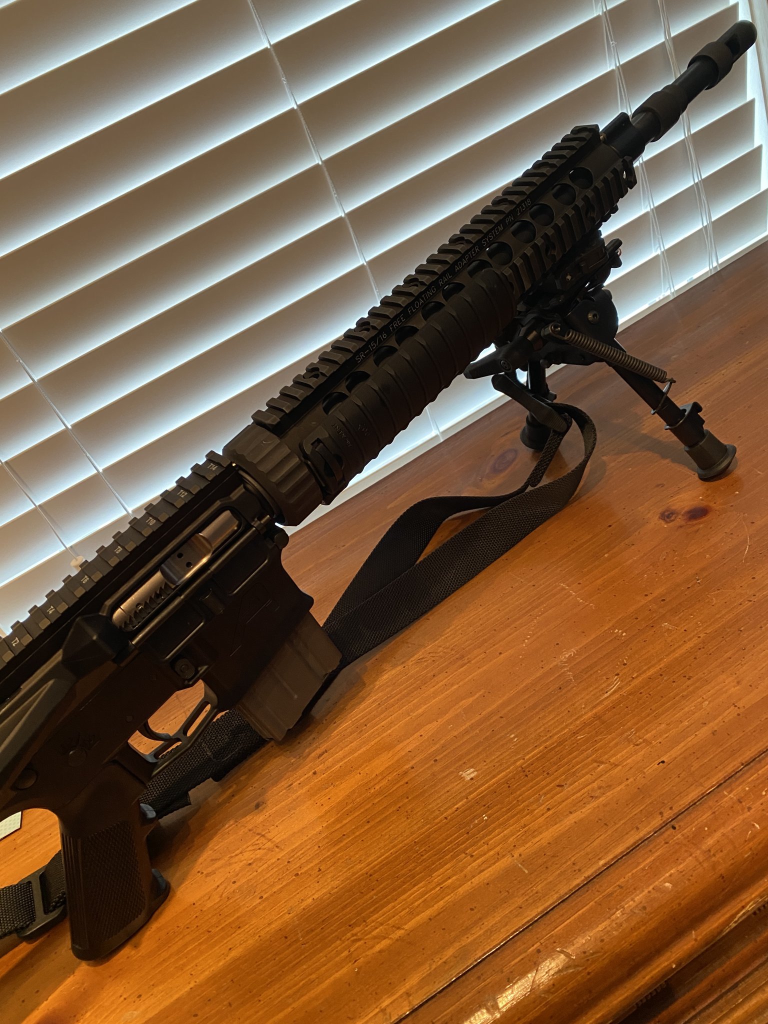

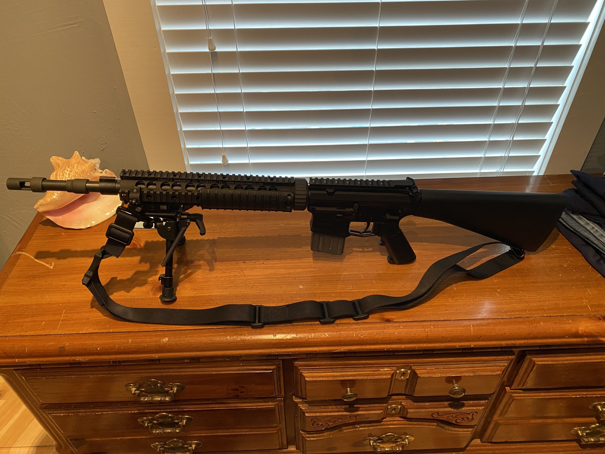

So here’s where I am so far, still need an optic. No where near clone correct but it makes me happy. One major problem though, it’s not cycling correctly. Ejects spent case at 3 O’clock, bcg doesn’t lock back on empty mag or load a second round. Air moves freely through the gas system with a plugged chamber and air introduced at the muzzle. I only fired 5 rds of Win M855 through it. BCG was torn down and oiled properly prior to testing.
Every part is new, do I send a hundred rounds through it one at a time to allow parts to mate up? Doesn’t seem right. What do I do?

And what about buffer weight? Dunno what the heat comparison would be between M855 and Mk262 but keep in mind the design is focused around that being the 262 which is definitely a warm load. Maybe try different ammo too.
.0935 is what ballistic advantage tells me. I don't have pin gauges to verify
Should be plenty. You can get a rough idea of port size if you have a decent selection of drill bits. I have a BA SPR barrel that had the same issues. Port was .07ish, had to drill it to .09ish to get function.
Reactions: darkfader
I'd love to get my hands on some 262, but it doesn't seem to be very available at the moment. The 855 is the highest pressure ammo I have in the stash. It's a mil-spec rifle buffer, I may play around with the weights just to experiment, but I think that is just a bandaid and not the right fix for the problem. I sort of expected it to work well with factory 855. Is it common to change rifle buffer weight to account for less dwell time in this configuration?
Depending on the ammo you run I would say yes in just about any case. But that’s starting to get out of my pay grade. Doesn’t necessarily have to be 262 that you try either. Really just anything other than the M855 just as a data point.
That’s a better port size than the .1-.105 called for in Mk12 specs as most here aren’t in need of Arctic capabilities.
An adjustable gas block really sweetened up how my .103 gas port barrel shoots.
I just saw the IMI in stock at SG. Ordering now and will give that a try prior to messing with weights. Thanks for the help gents.
Just to touch on playing with weights, and I know they’re a lot of dough, but the JP SCS would be the route I would take unless of course you have a plethora of various springs and buffer weights on hand.
I only have a handful of tungsten weights in order to dial in a 300BLK pistol and that's only going to make the buffer heavier anyway. I've been wanting to go with a JP setup since I first saw them and it looks pretty customizable so that's the route I'll most likely take if it comes down to it. Thanks for the tip. I had considered getting some aluminum bar stock and cutting lengths to swap out steel buffer weights to see what would happen, but I also don't want to cause premature wear on internals. First I'll verify again that air is moving through the system, but I'm confident that it is, then try the 77gr ammo, then mess with weights.
Absolutely. Let us know what you come up with.
Dump all the weights out and try it empty just for diagnostic purposes.

So here’s where I am so far, still need an optic. No where near clone correct but it makes me happy. One major problem though, it’s not cycling correctly. Ejects spent case at 3 O’clock, bcg doesn’t lock back on empty mag or load a second round. Air moves freely through the gas system with a plugged chamber and air introduced at the muzzle. I only fired 5 rds of Win M855 through it. BCG was torn down and oiled properly prior to testing. View attachment 7578850View attachment 7578851View attachment 7578852View attachment 7578853Every part is new, do I send a hundred rounds through it one at a time to allow parts to mate up? Doesn’t seem right. What do I do?

So BA is known to jack up port sizes at times...just might want to check...
My "milspec" A2 kit had a weak recoil spring...went with Sprinco Green and cured my ejection pattern...

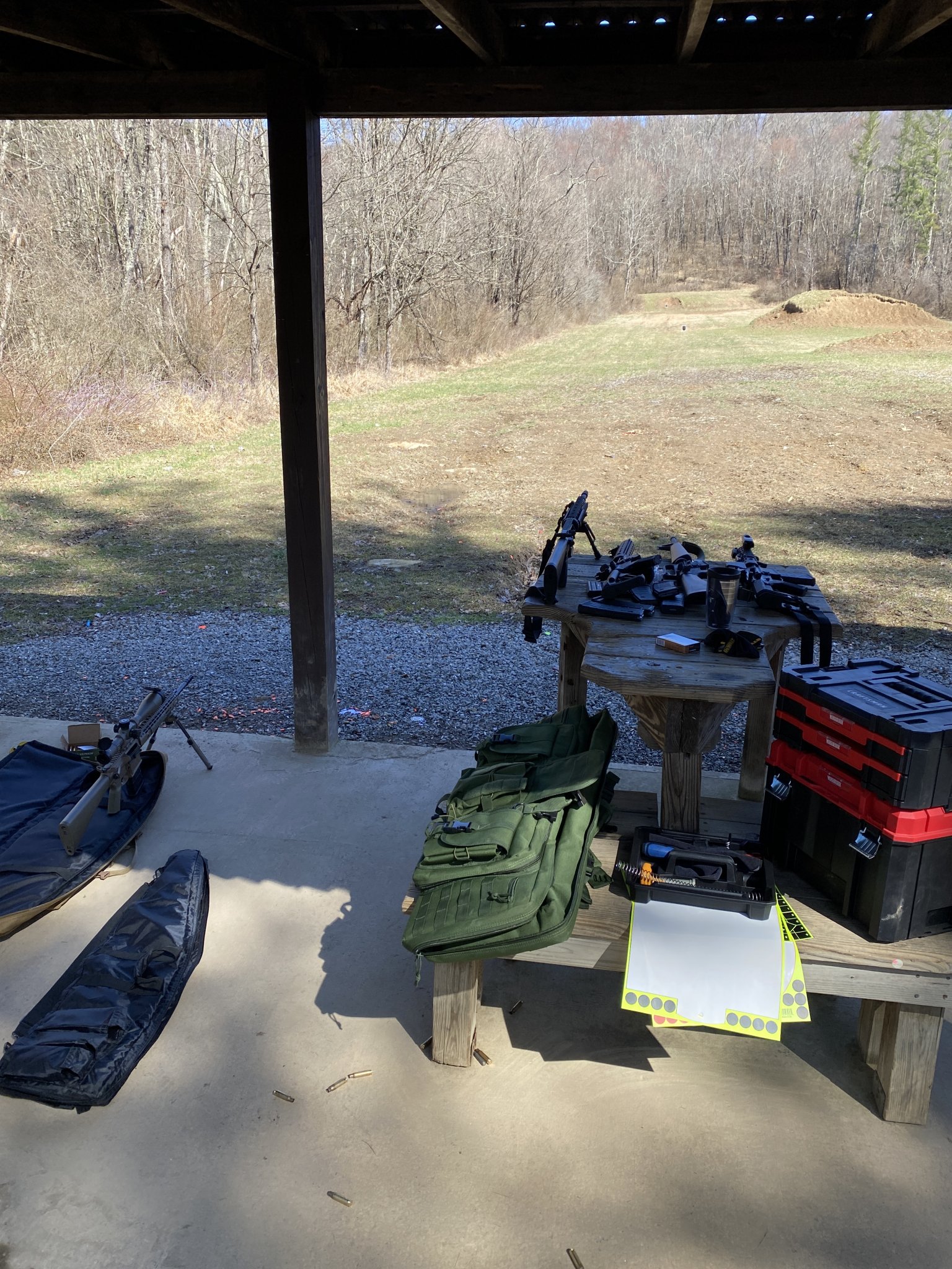

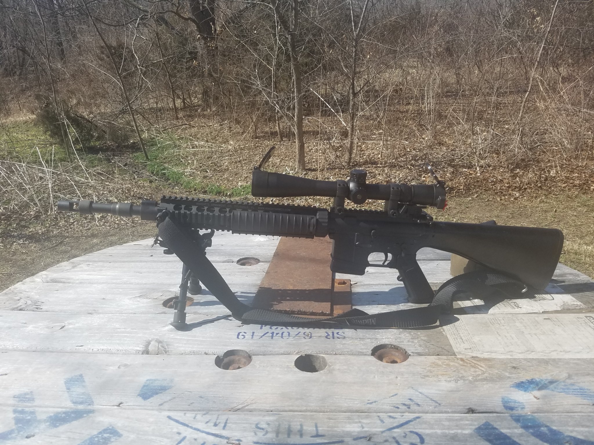

Hey guys, just an update real quick. I was able to hit the range today to do some testing. Still don’t have any 77gr. yet, but I wanted to shoot so I went out. I messed around with buffer weights. I acquired some .500” aluminum round and .500” delrin round. I don’t have a digital scale but I do have a cheap powder scale that only tells me grains. For scientific purposes, I measured out .600” lengths and cut the rods. Aluminum weighed in at just about 81 grains. Delrin was just about 42.5 grains. Fun project but swapping weights in the buffers did nothing for me to be honest. After fooling around for about 80 rounds the rifle started acting right, meaning it was stripping the next round off the mag and locking back on empty. I had the same issue with the M16A1 clone in the photo. Using Okay Surefeed 20rd and magpul M3 mags, the A1 clone is reliable in my mind, the Mk12 is still a little shaky but seems to be running much better. Nothing I own runs with tulammo, shocker, but seemed to be ok with PMC X-tac, did real well with M855. I’m hopeful with 77gr and now maybe parts are mated, things work well. I was running the bolt fairly wet with Lucas oil and it seemed to get gummy once dirty, not to mention it was only upper 30’s today, even though Lucas says -38*F. I don’t know. I cleaned everything and put light coats of Lucas CLP on everything. I’m waiting on an optic and the 77gr for the next outing and see how it runs. Today was a glorious escape.

What optic did you decide on getting?
I decided on the Primary Arms GLx 2.5-10x44 with the FFP ACSS Raptor reticle, with their corresponding mount. It seemed like there were a lot of pretty good reviews on it across the net and I didn't really want to spend more than what it costs, especially since I have another rifle that needs some kind of optic as well. I'm sure it will fit my needs just fine. I'm currently shopping around for something 1-6 or 1-8 for a carbine. Sitting on a couple hundred rounds of 77gr to try out once the optic arrives Monday.

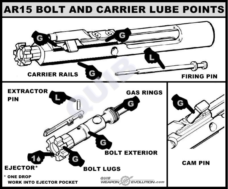

Thanks Sinister. Is there a different lube I should try? I got into the habit of cleaning and applying the Lucas Extreme Duty oil pretty liberally upon initial assembly prior to first shots.

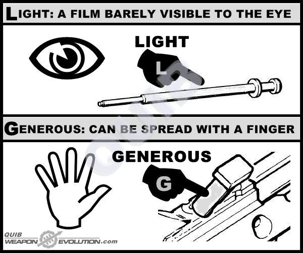

With the SPR, I cleaned it real well Friday night after the range and used the Lucas CLP and followed this diagram:
Reactions: USGILT
I don't have experience with Lucas, although I know they make lots of automotive, bicycle, and gun stuff.
I've used LSA since I was a teenager back in the 20th century, otherwise Mobil 1 synthetic 30-weight motor oil in a plastic squeeze bottle. A GI quart can of LSA will last you several years.
What your graphic training aid (above) says is fair guidance. I usually put a drop or two in the cam pin track (one in front of the bolt cam pin hole, one behind) and on the bolt tail.
If it's shiny it gets a drop, smeared with your finger (shiney surfaces on the carrier, cam pin, and bolt). The firing pin gets lubed just being in the carrier.
Per the GI manual there's supposed to be a drop in the gas key, but I really think that just gets vaporized and blown out. Lube on the firing pin seems to help clean up quicker, though.
