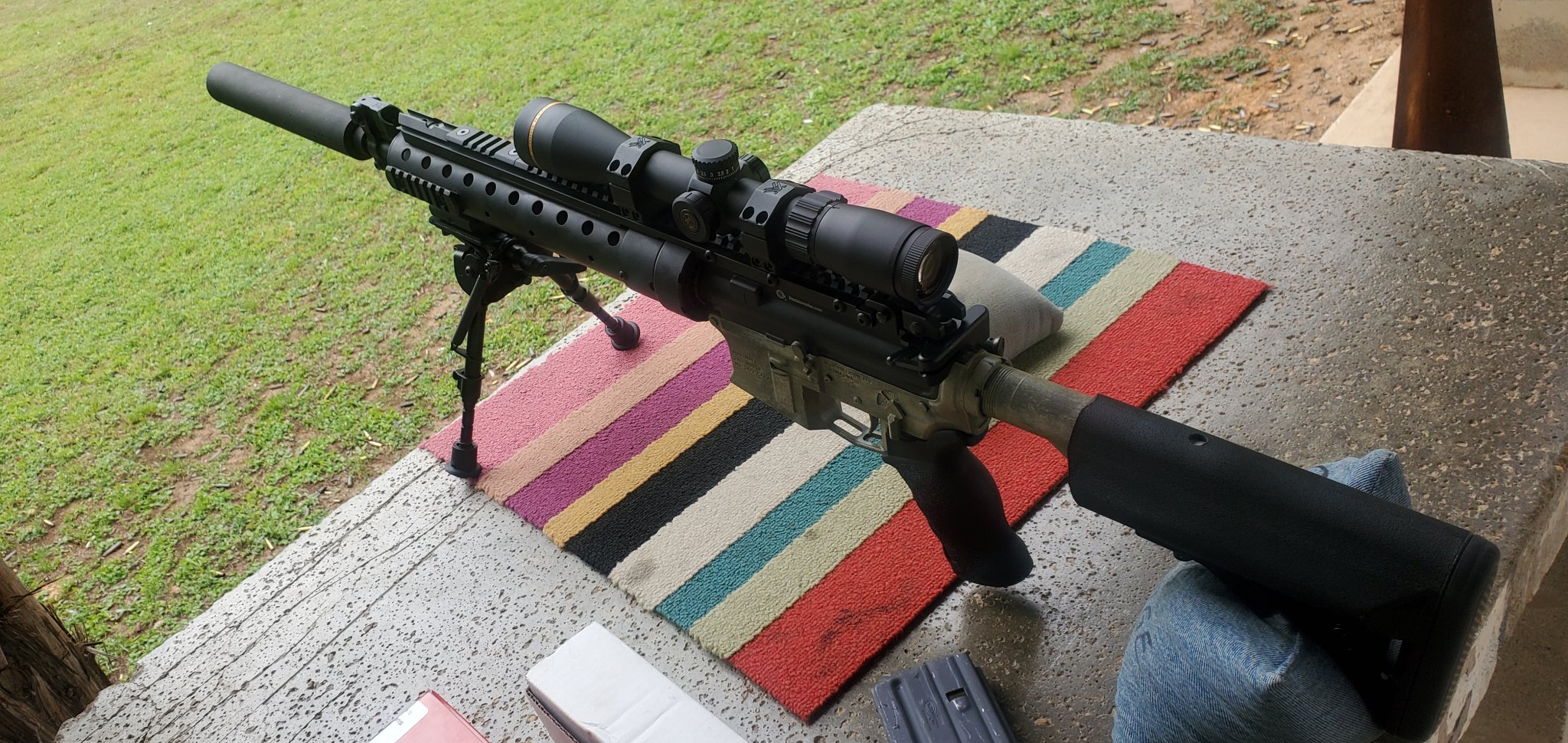

I will still say that the 18” SPR suppressed is one of the most pleasant AR-15 set-ups to shoot from the prone/bipod-supported, as well as tripod-supported positions. It’s just not as pleasant to carry as a 14.5” SOPMOD Block II or 10.25” CQBR-equipped shorty.

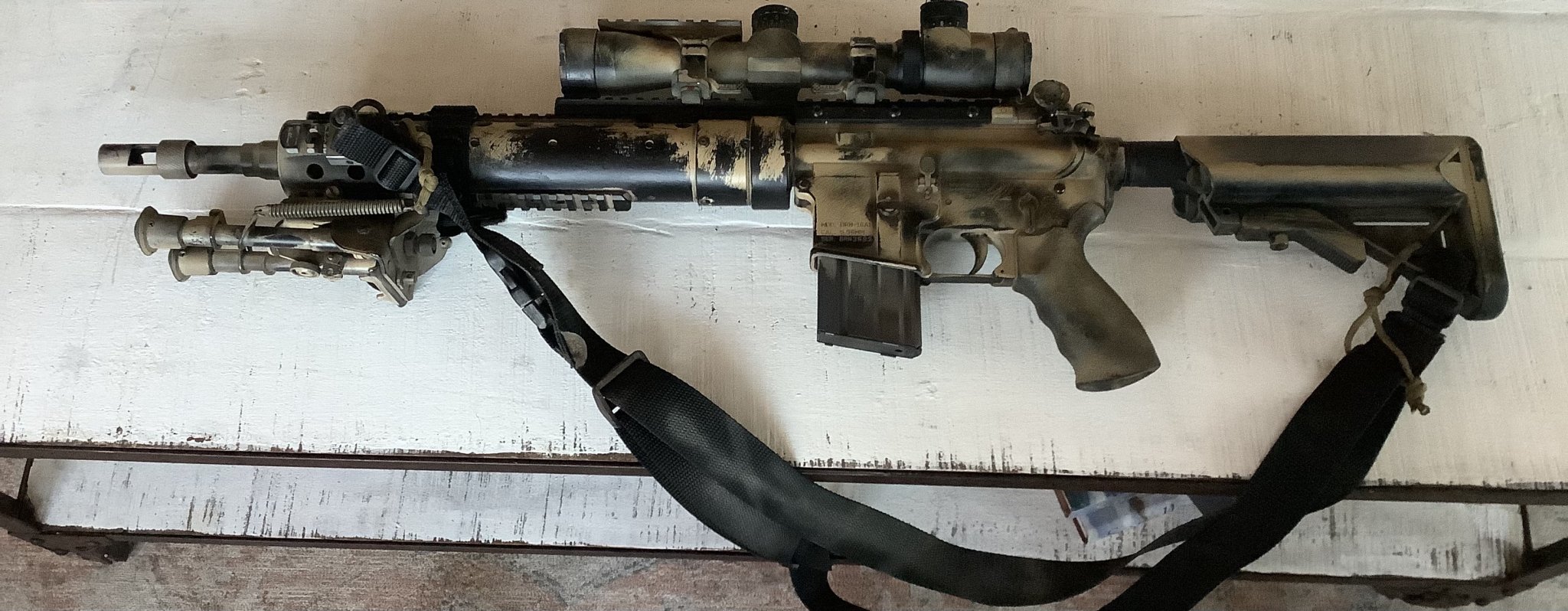

Mod H is the only clone I kept. Probably never part with it. View attachment 7565994
I was today years old when i found out there was a Mod H and it's now on the to build list. I think I'm going to do a Mod H and put a 2.5-10 credo on it. What does your Mod H weigh out of curiosity?

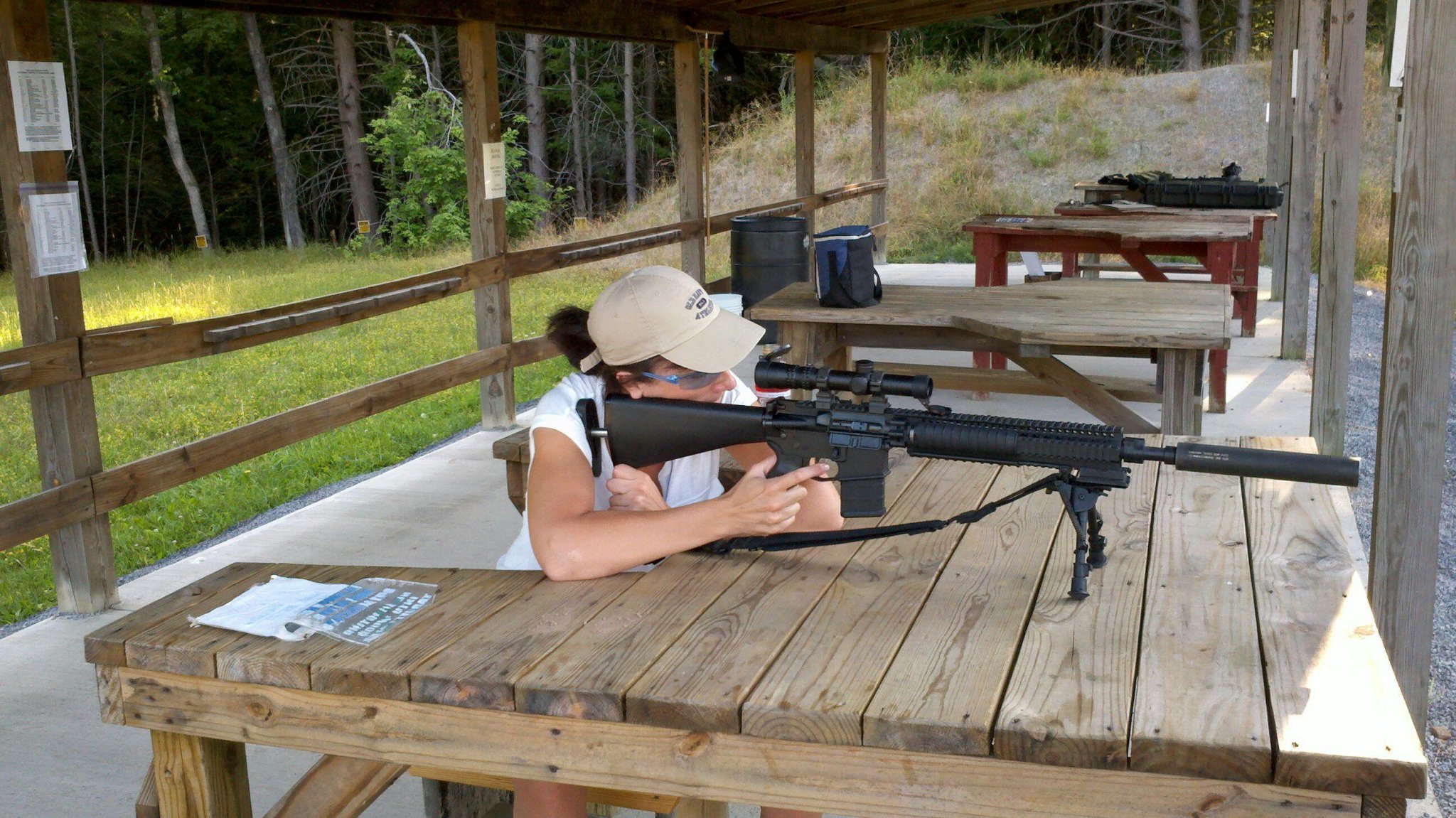

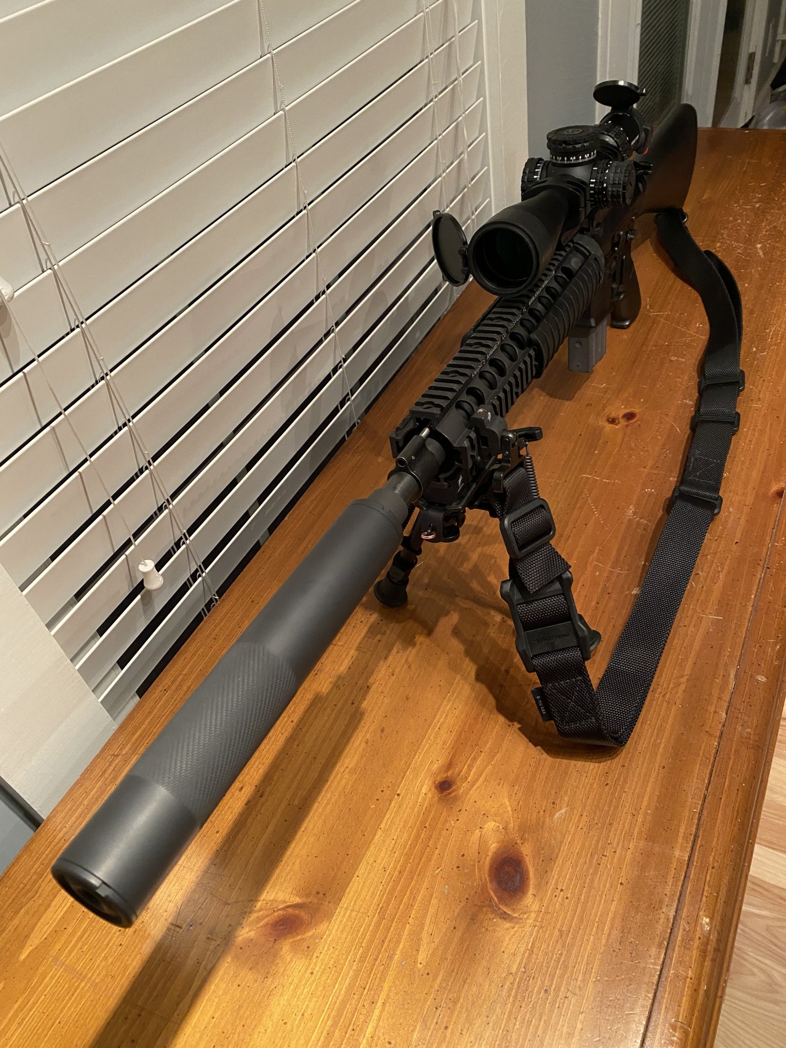

Yeah, these rifles are absolute sweethearts to shoot supported, especially with the can (that's an Ops Inc 12th Model I got in 2009) I am still on the fence about changing the gas block from the Superlative, but that's pretty simple. Lower is an old (ca. 1988) Essential Arms A1-ish piece. The 2.5-10x24 is an NPR2 moa/moa instead of Mildot, but it works surprisingly well in its simplicity. I have an A1 buttstock for it, but normally have the A2 stock on it with a Medesha adjustable buttplate for added LOP.

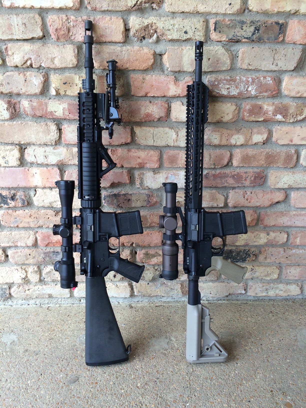

Instead of doing a Reece rifle, I did a medium-weight "Hansen" profile BA 1:8 14.5" barrel, mid-length gas on my carbine. My can on that is a local (Dave Wells) manufacturer and attaches via AAC 51T brake (p&w, of course 🤞). Combined with 3 tungsten weights in the buffer and a Timney 3# single stage, this rifle is butter-smooth and easily gets moa accuracy out to 400 with my 2750fps 75gr/8208 ammo.

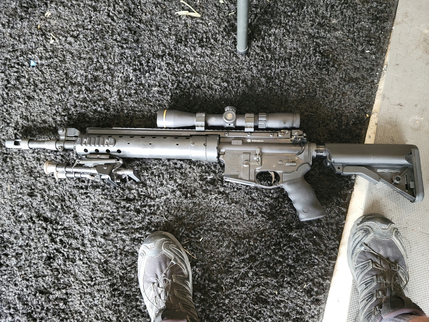

I forgot how much fun these 223 SPRs are to shoot. I had not shot my 18” WOA SPR in awhile. It took it out and had a blast getting good hits on steel from 400-800yds.
This gun started out as a pretty close to clone correct mod0 years ago, but I stripped it down and modernized it a few years ago.
I miss the look of the PRI tube and ARMS rail, but the URX4 is a much better rail.

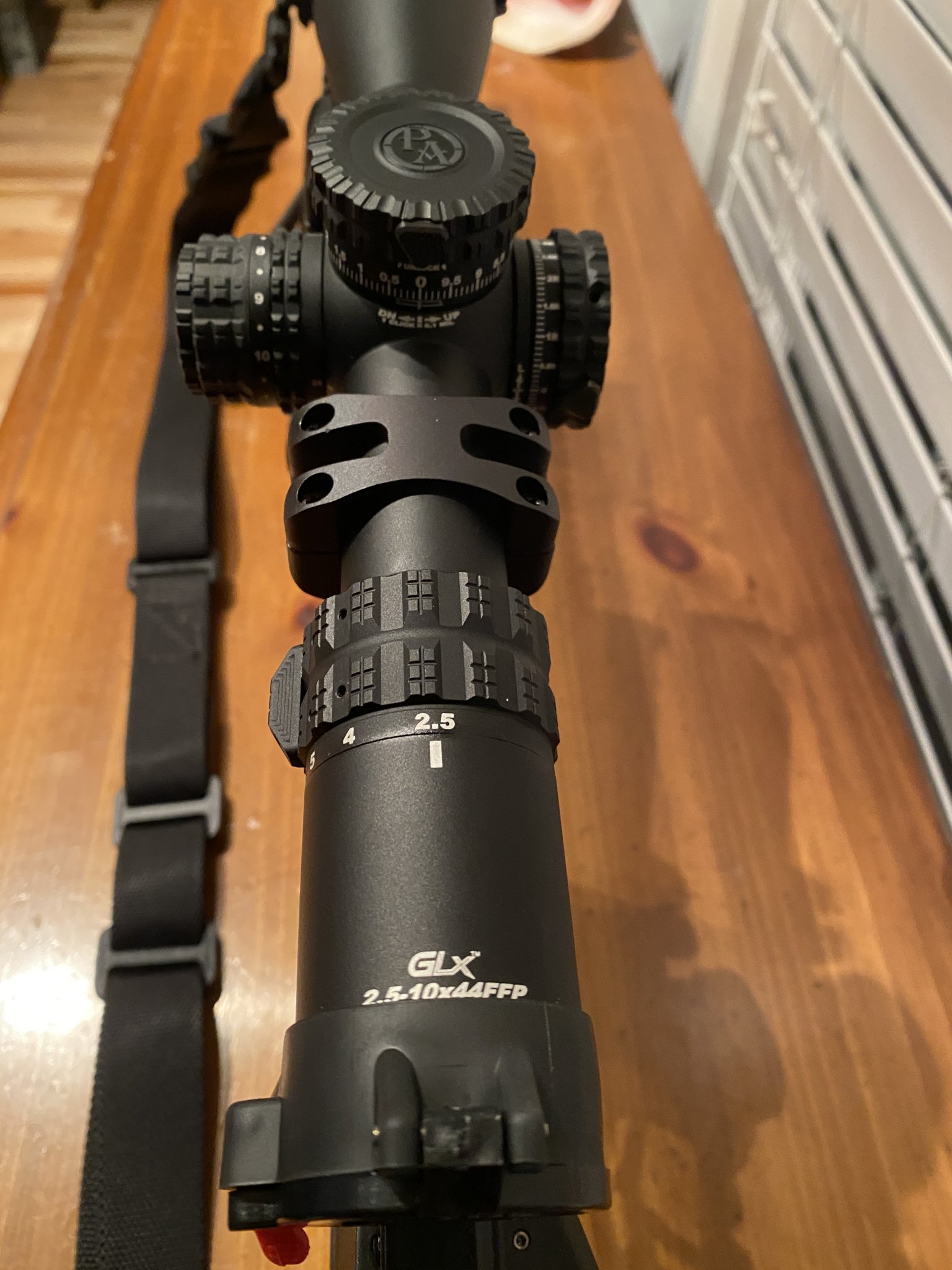

She's just about in final configuration. Got the lower back from cerakote today. Graphite black was the correct choice. Sinner Mass Fabrications in San Antonio, TX. Great group there.
Looks great. I had to go with higher rings to get a good cheek weld. Used a 22MOA badger riser and .88 Badgers with the M3 and the 32mm NCS and use 1.3” Nightforce with the 24mm NXS.

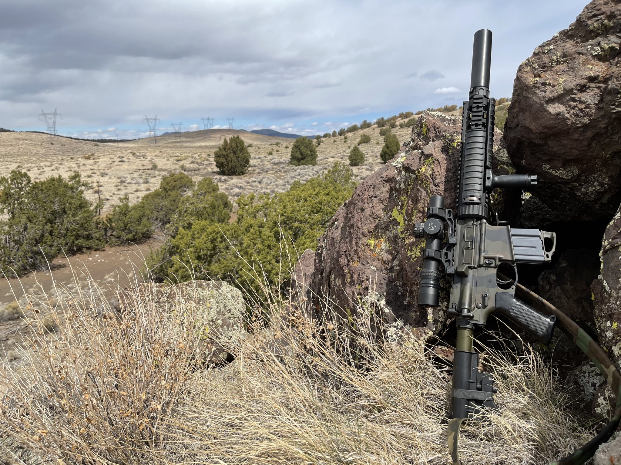

Still haven’t sighted the optic in, or finished the form 1 AEM5 clone yet, but here’s where I am so far.
