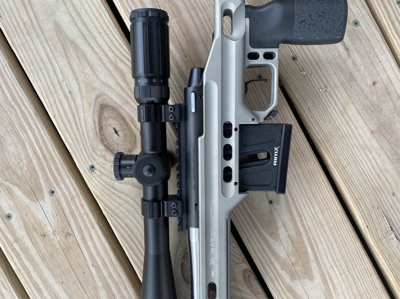

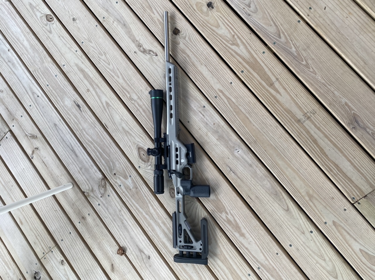

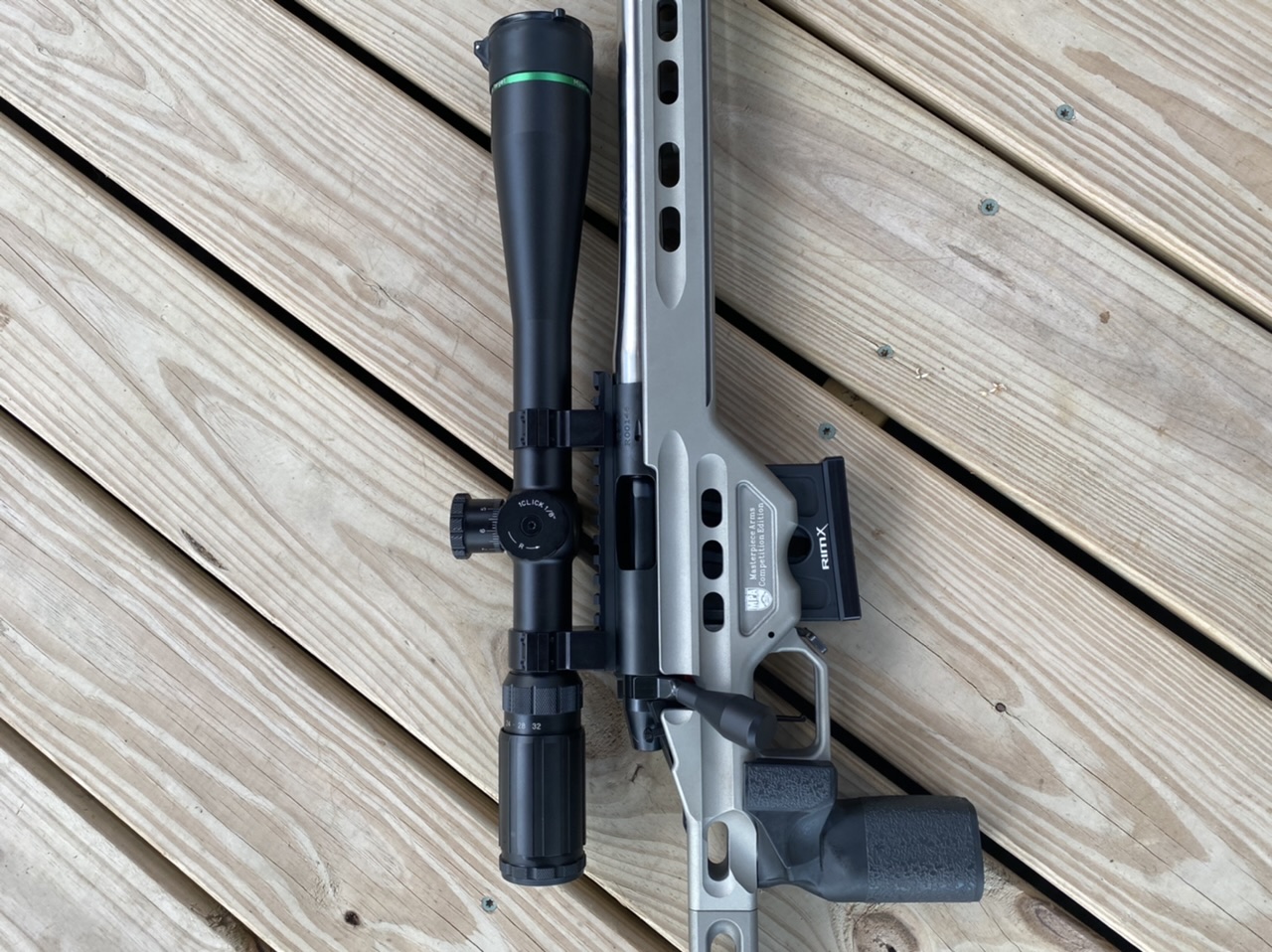

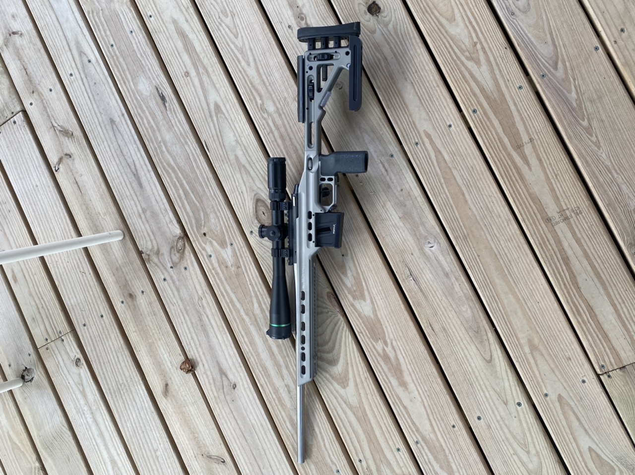

Got mine finished today and fired a few functional test rounds. Had to remove.001” from breech face as bolt was scraping the face when torqued @ 50 ft lbs. still in the factory spec. but is smooth now. Should go out next week to do some ammo testing.

I got out yesterday morning right after the rain stopped. Dead calm, I checked between every type of ammo on the Kestrel, not a measurable amount of wind to be found. Not a branch or leaf moving. Calmest day Ive shot during this entire review. Temp was 68F and humidity was 87%.
I ranged the target with my laser @ 102yd. Took a picture as best I could to show through the rangefinder. I had 2 cameras recording video at both the firing line and at the target showing every impact on the below target. Ill get that uploaded either later today or tomorrow.
Long story short, the Bartlein was just barely larger than the GM with the same ammo @ 100yd but it was extremely close. We are talking a difference of 0.04"... The biggest suprise though.... was the SK+ shot those numbers and continued with its 50yd performance at 100yds. This is amazing. Especially with 3 groups under 0.5"... Really nice to see this ammo/Barrel combo shooting almost identical to the GM CenterX and UM22 results @ 100yds.... Crazy how poorly SK RM shot, dropping super low into the SK+ targets. Youll see those impacts as they are shot on the 4K target video Ill upload shortly.
Not only did I order a few more bricks/lots of CenterX, I got some more SK+ on the way to see how it compares in this barrel to my current lot.
Next up is the Krieger.. Really interested in how this compares to the group as Ive never owned or shot a Krieger 22LR barrel to date...
