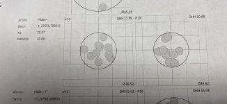

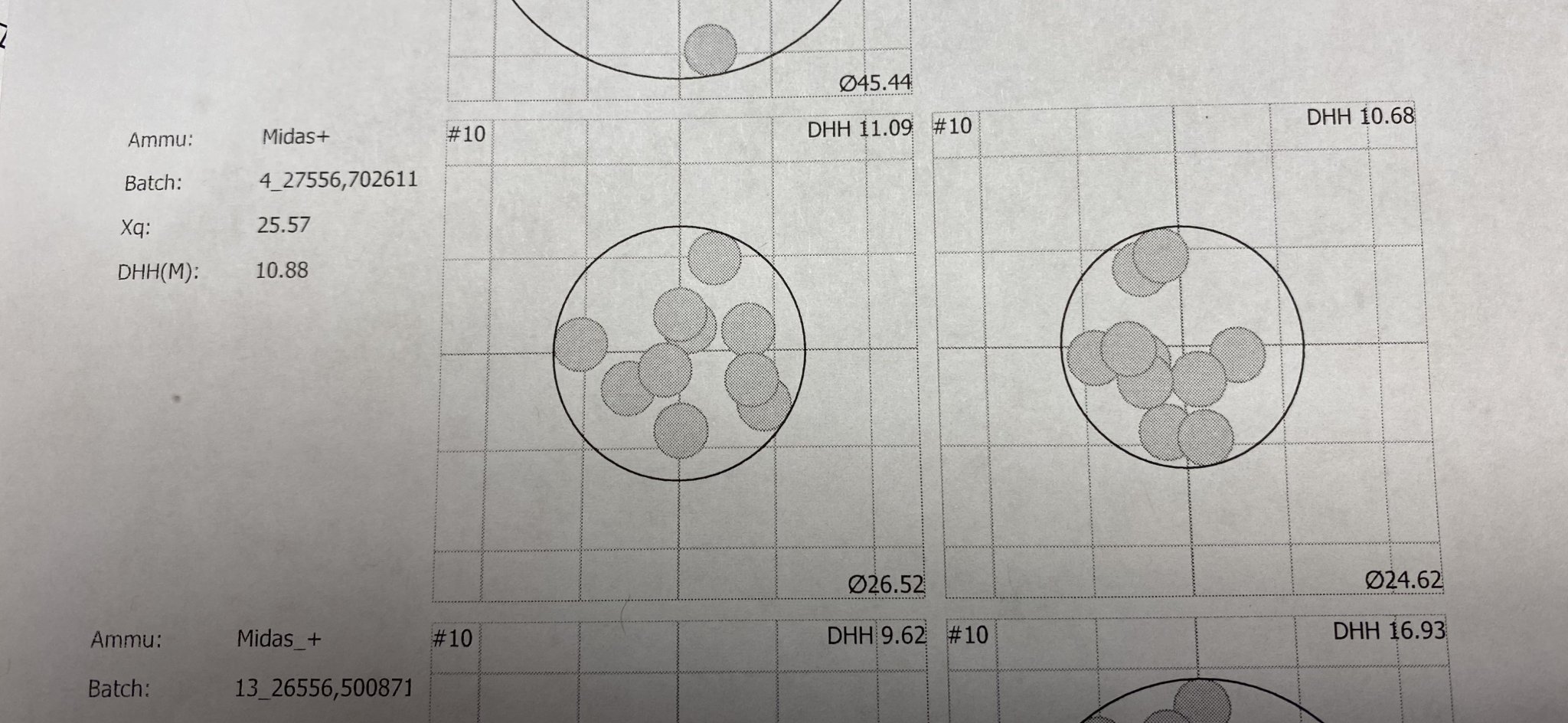

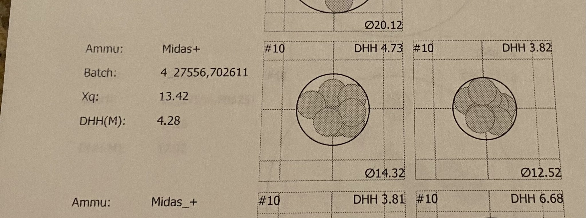

Long time lurker… had to chime in on the Keystone GM barrels. Just got back from the Lapua Rimfire Testcenter, and I have to give John at Keystone many props!
50m 20 shot average 13.42mm outside to outside! (The tech starts sorting ammo when they get a 19mm by the way)
100m 20 shot average 25.57mm outside to outside.
The barrel with the RimX is an absolute hammer.
Keystone Green Mountain 20” M24 with 11 degree Target Crown
Lapua Midas+ (Because that’s what it likes)
