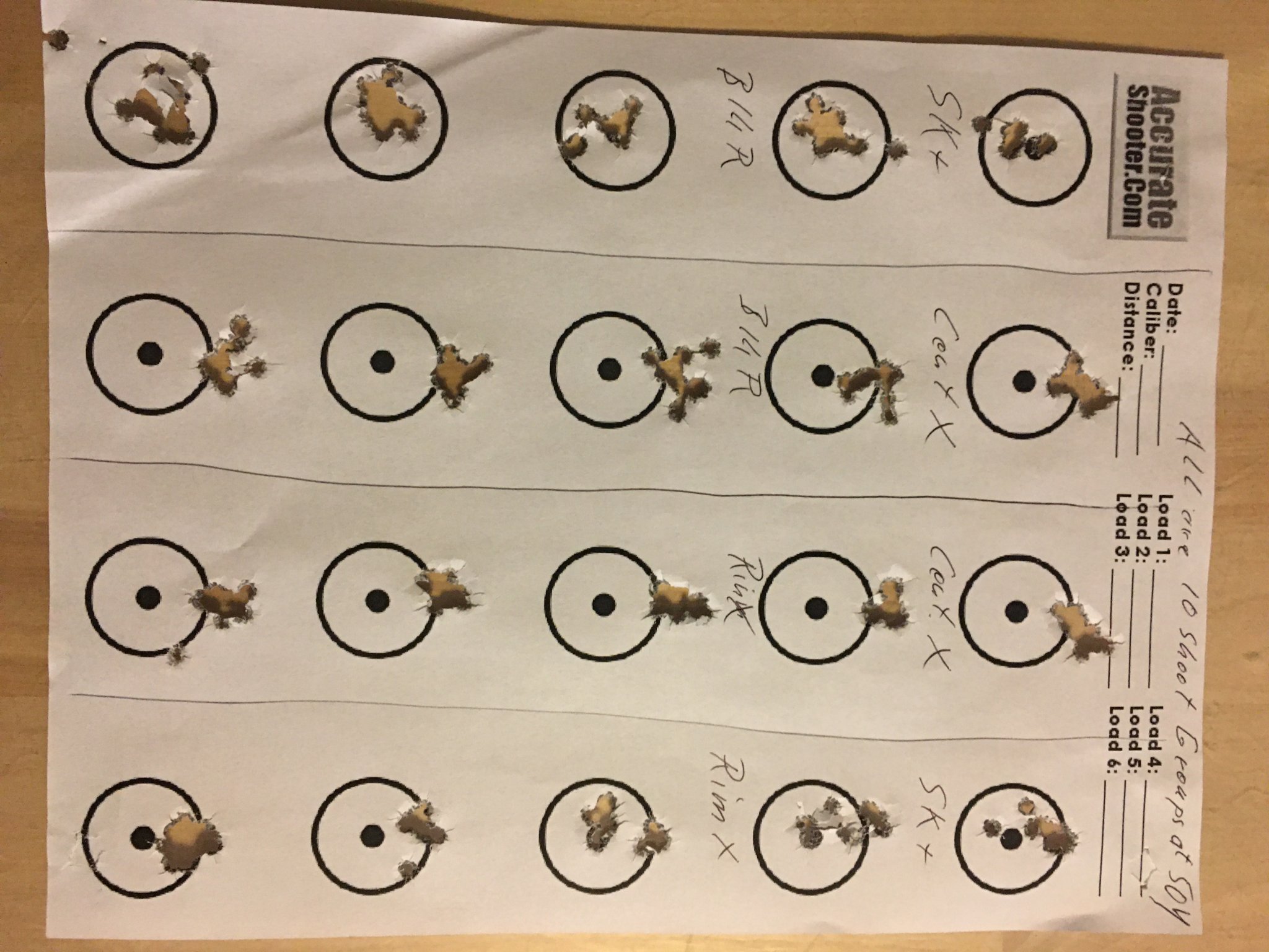

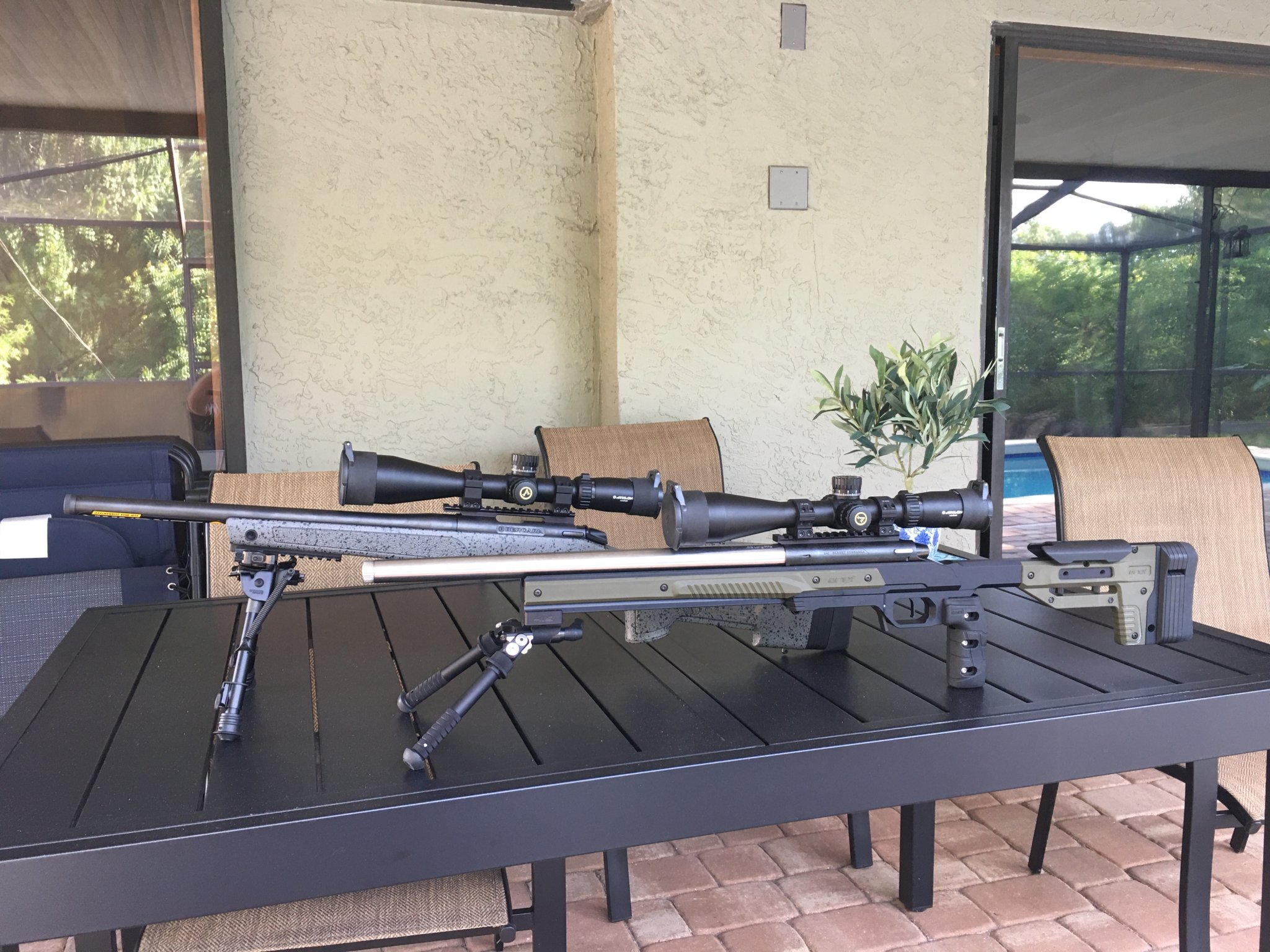

I think you have made the right decision. I went out shooting my B14R and RimX yesterday to compare them just for myself.
The RimX has the 20“ m24 contour keystone barrel John did for me and I screwed on myself. Both rifles have a tt diamond and the same athlon ares scope installed. Everybody looking at this please have in mind that the shooter is relatively inexperienced, about 750 rounds in shooting from a wooden table with bipod and rear bag just learned by reading here on this website. Prone not allowed on the range. These are all contentious 10 shoot groups, not as good as Orkan and Padom yet lol, but I can dream they will one day.
The worst groups are clearly shooter errors mainly breathing and cheek weld (heart rate in scope visual).
I think they are two perfect 22lr training rifles and can‘t imagine there will be better ones (don’t own a vudoo).
Both function perfect as far as I can say, including the tt diamonds set to 8.5 ounces.

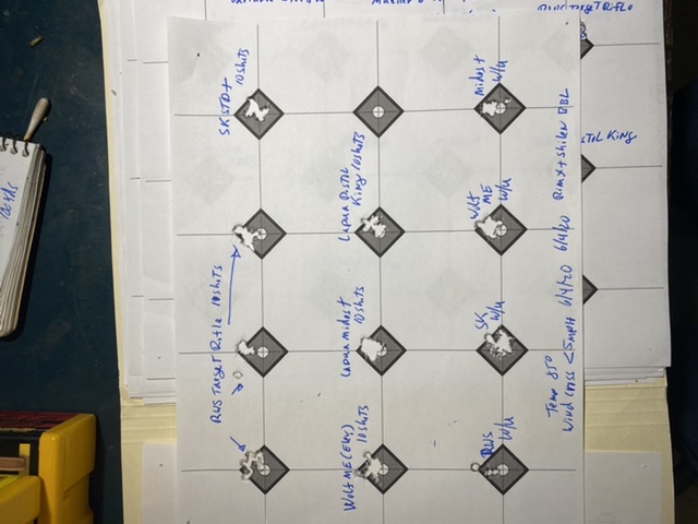

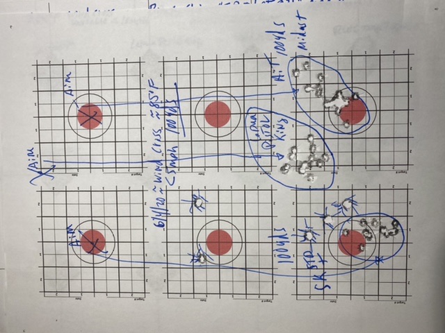

Took my Shilen barreled RimX our again today for casual ammo testing. 50yds and and several at 100yds. Lapua Pistol King was better than Midas +. SK STD + also did good for cheaper ammo.
For 100 yds shooting didn’t want move scope, just aim high. Another shooter decided to to shoot my my target when I was shooting @50 yds.
