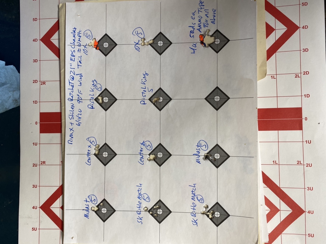

Took my Shilen barreled RimX out again today. EPS Chambered, five shot groups @ 50 yds. with 5 shots in W/U target before shooting. Two groups each with various ammo. Temp was 90+ and light variable tail wind. Lots of gnats getting in my eyes while shooting. Lapua ammo still is the best in all my rifles and Pistol King has always been solid performer in all my rifles. Will test again as conditions permit @ 100 yds where Pistol King has been a solid performer. Center dot is 1/4”.
What barrel contour is that?
Jeff
escopeta2020 - Looks like your Shilen shoots pretty darned good with Lapua in its EPS chamber. All but one of my custom 22RF bbls have been chambered with my PTG EPS reamer, including five Kriegers, two Shilen ratchet rifled select match, one 3-gr Benchmark, and a Lilja titebore, and they all shoot pretty well with SK & Lapua ammo. However, a couple of times last year while testing some Eley Match, one of the Kriegers and a Bartlein that VGW chambered shot better at 200+yds with the Eley than they did with a select lot of Lapua Center-X. I was mostly just shooting up some lot samples of Eley that I'd bought to try in an Anschutz 2011, but once I found out how well my V-22s liked a few of these lots, I wondered if the Lapua & SK would perhaps shoot better at the same 200+yds if they were chambered with a reamer designed from the get-go for best performance with Lapua? I may do some work to find out when I get my hands on a V-22S action & get it set up to shoot BR. I have a Shilen ratchet in R5 contour for it, and may try either a Bartlein or Krieger for it also - unless the R5 shoots lights-out, and if it does, why mess with success?

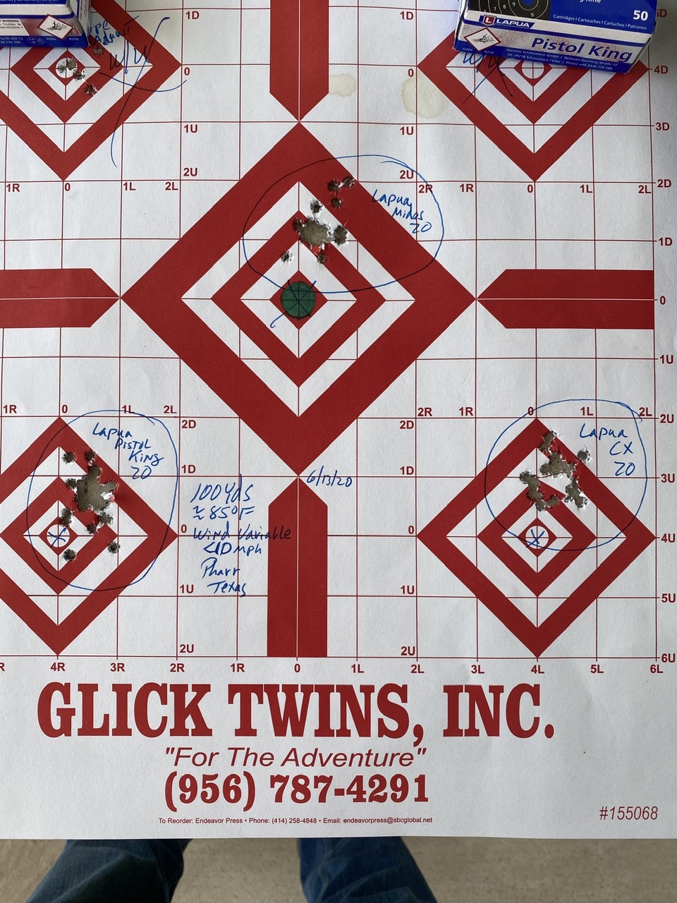

Not impressed today at 100 and light tail wind. Lapua Pistol King, Center x, and Midas +. We’re the best at 50 but lacking at 100.
I think your standards may be too high. For 20 shot groups in variable wind those are pretty dam good groups. Big difference when you go from 5 to 10 and huge difference when you start shooting 20 shot groups (especially in wind).
Reactions: Emerson0311
Good shooting Padom!
I've been watching these barrel tests from the start. Thank you for taking the time, energy & money to do this.
From what I can see - by a very slight margin, the Krieger seems to be the king of the hill.
From you have seen, what barrel was the most consistent with multiple ammo brands?
