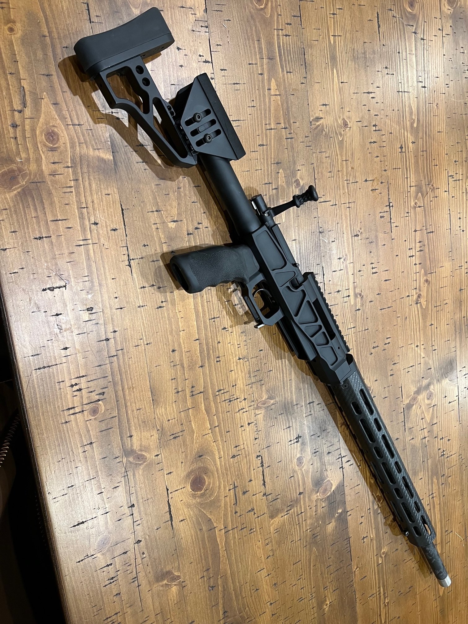

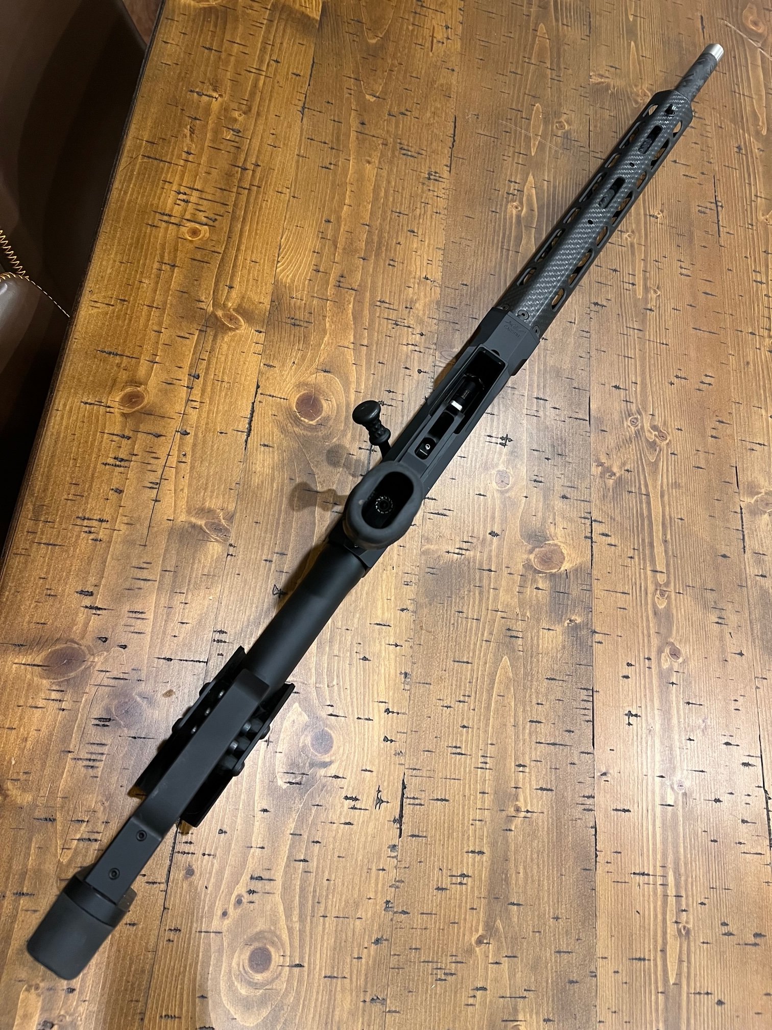

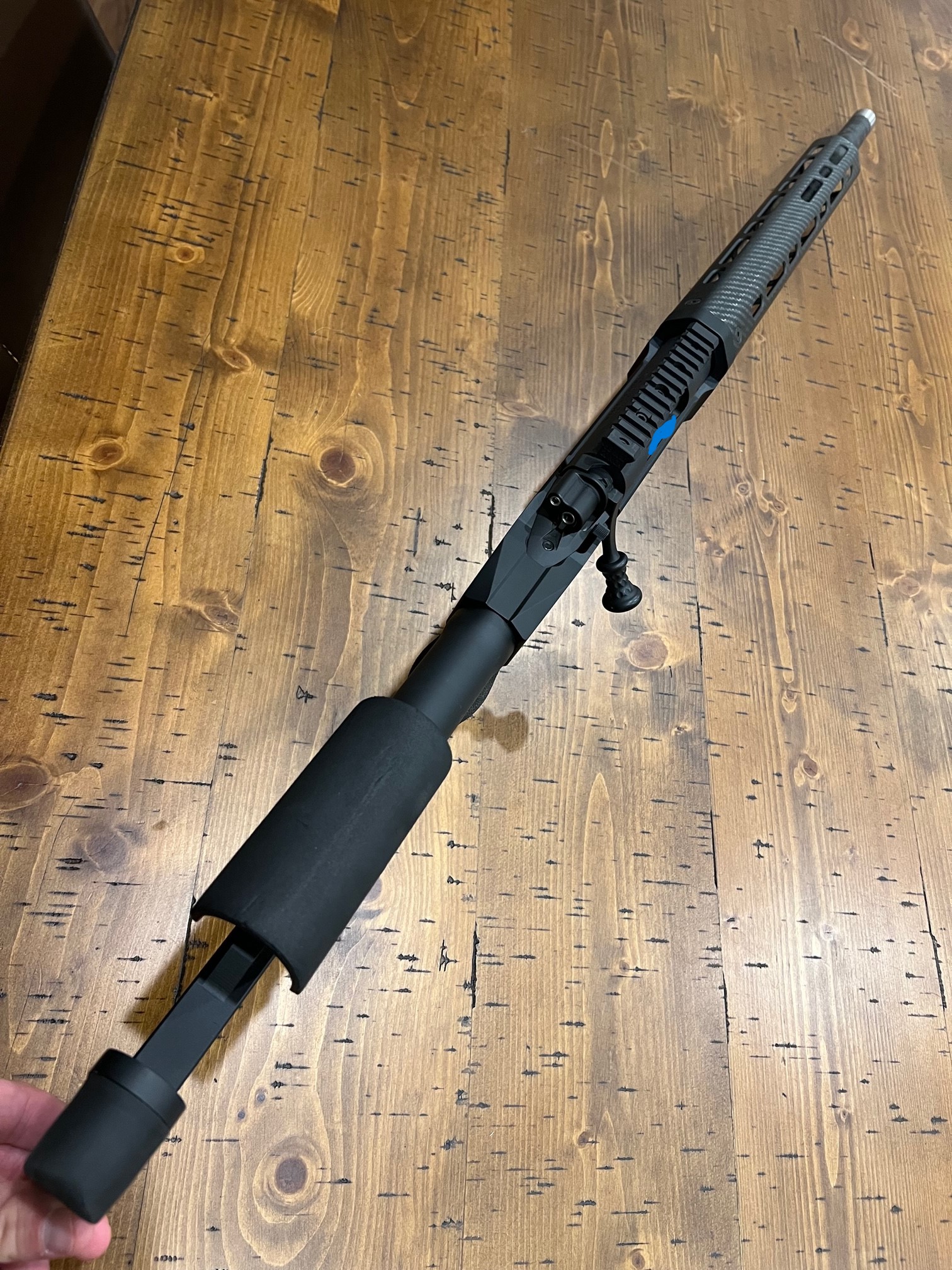

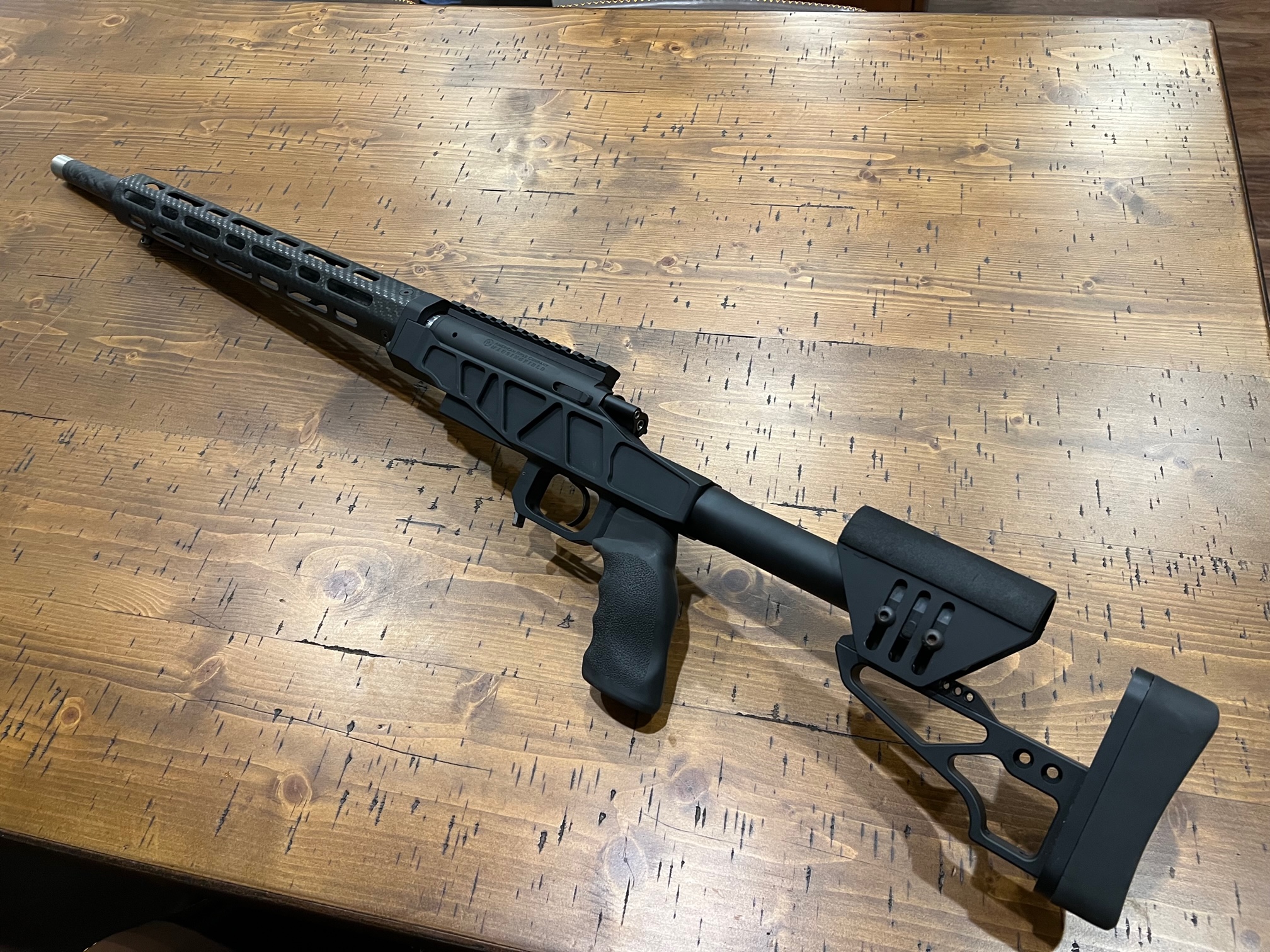

Firearms Garage sale!!!
SOLD!!!!
Movin out a few setups to focus on my bolt gun builds. All these are brand new. Some have a few mods some are stock. Let me know!
-SOLGW m76 556 holosun 512, handstop, suppressor ready $1650 shipped
- cz457 22lr. No bipod or can. Brand new loaded up $850 shipped
