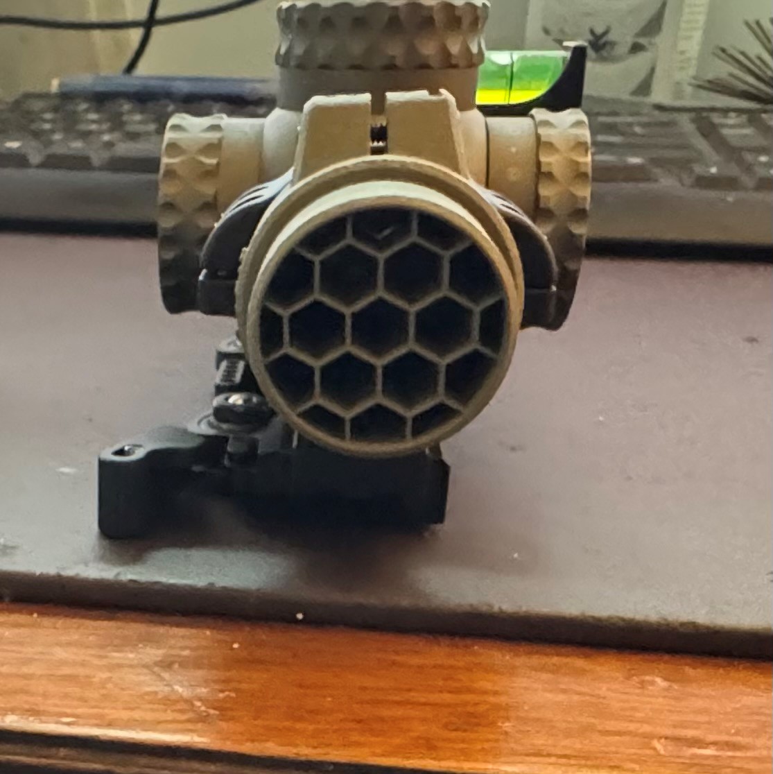

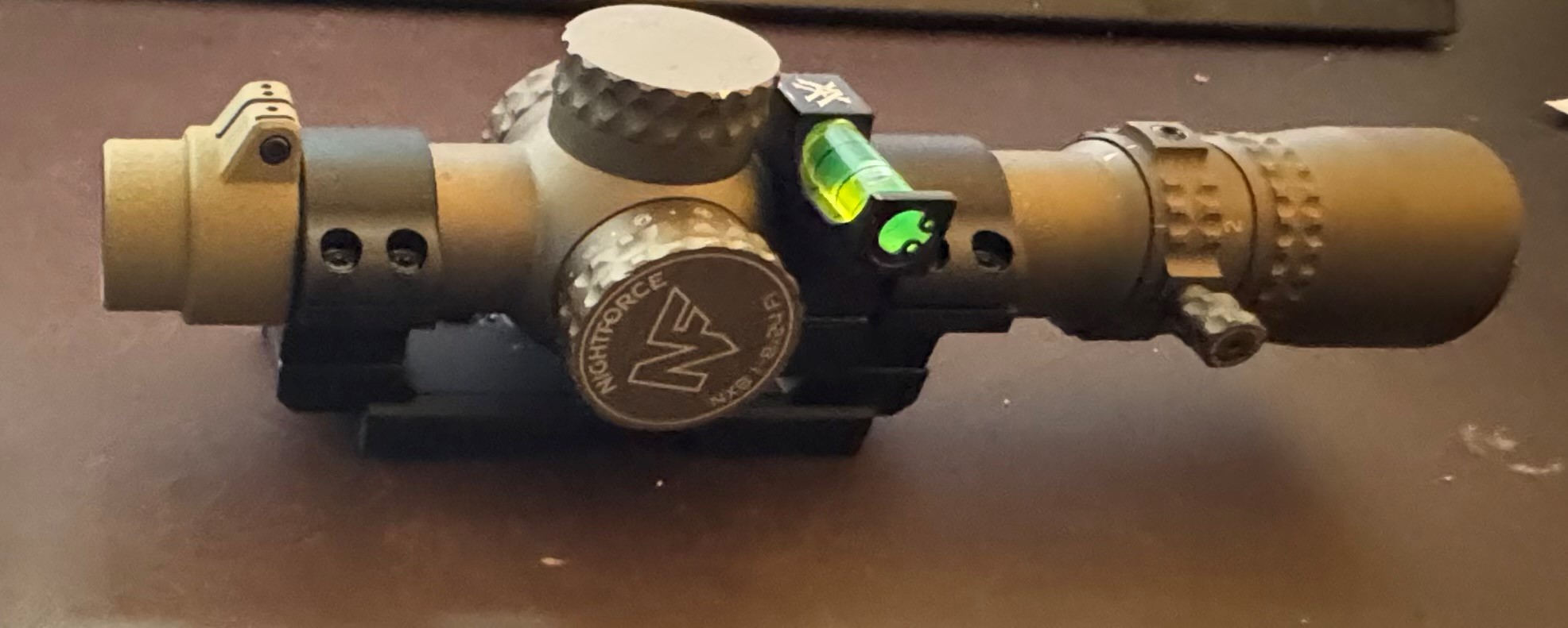

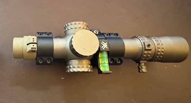

SOLD Nightforce ATACR 7-35x56 Mil-XT like new
Like new ATACR 7-35x56 F1 MIL-XT reticle. Sitting in an American Rifle Company M-Brace 1.26 height mount. Used a handful of times is all. Missing rear lens cover. Can take $2675 for scope without mount.
$2850 shipped
