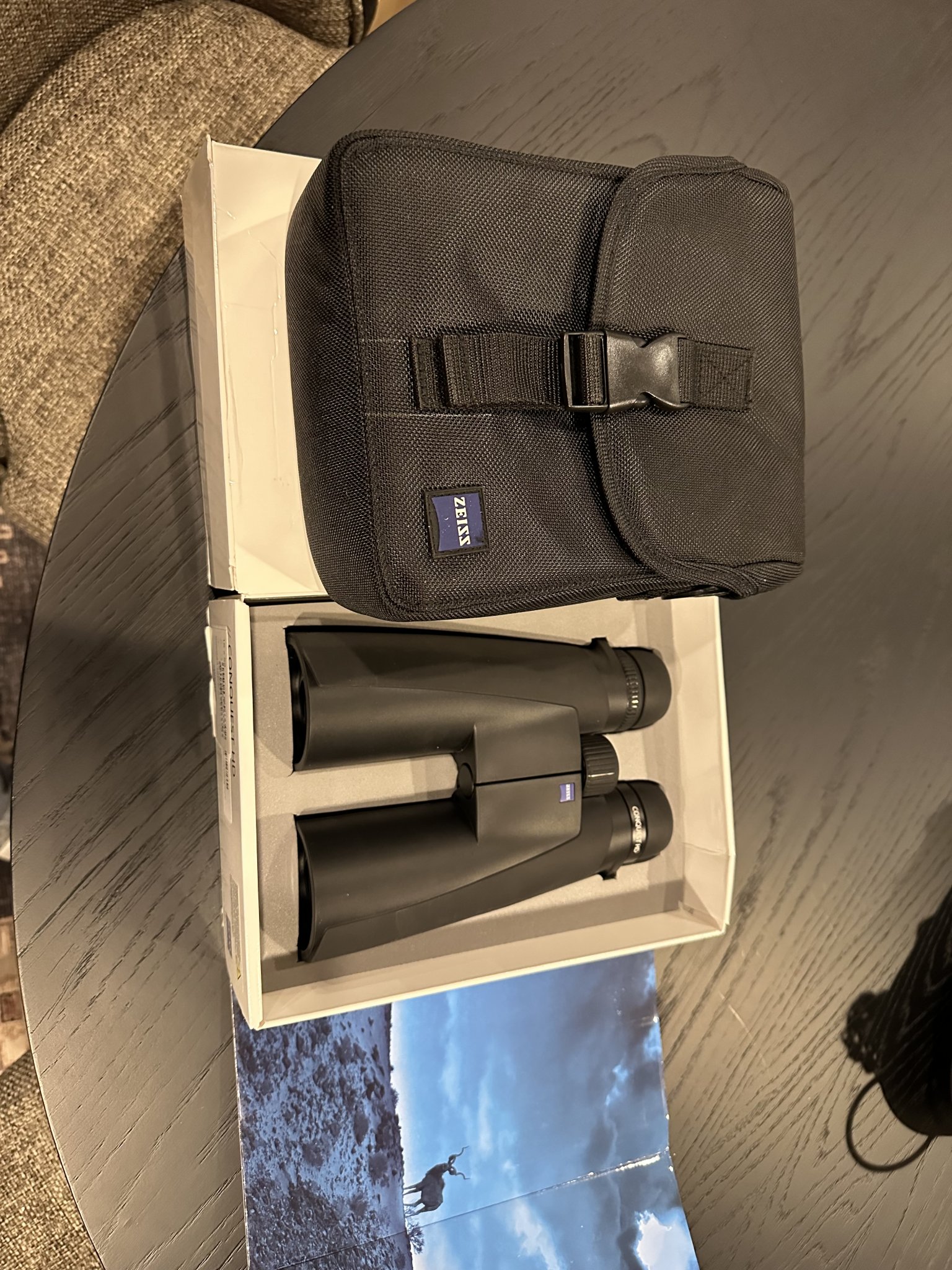

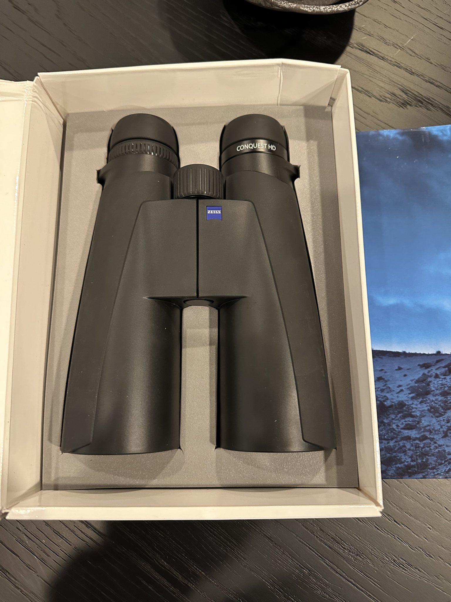

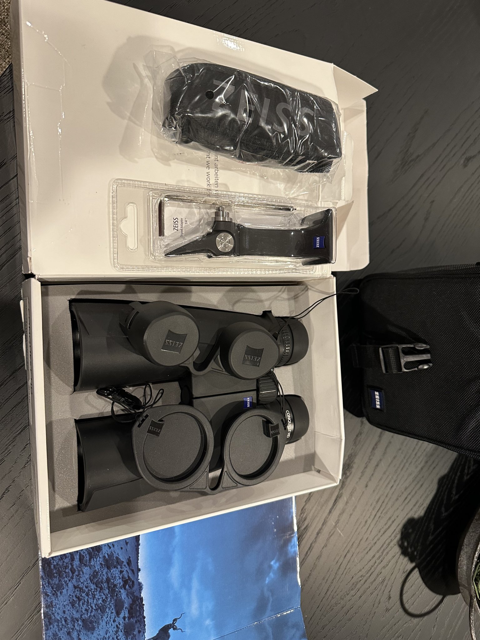

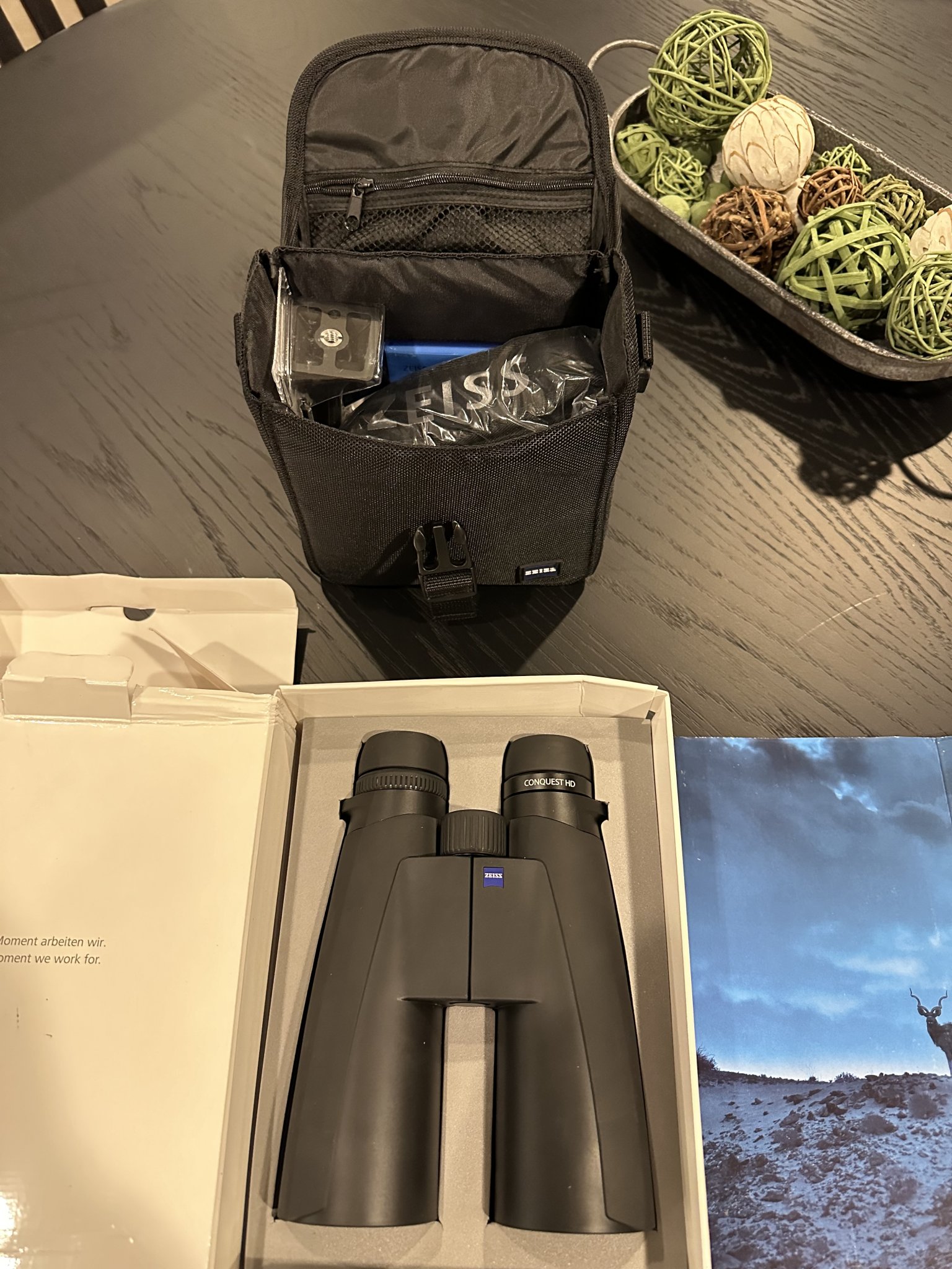

SOLD WTS- Maven 15x C4 Binos
Fairly new condition 15x C4 binos for sale. Lenses are in great shape. I’ll leave the Bino mount in if you like. Only selling because I’ve upgraded a set.
$375 shipped
