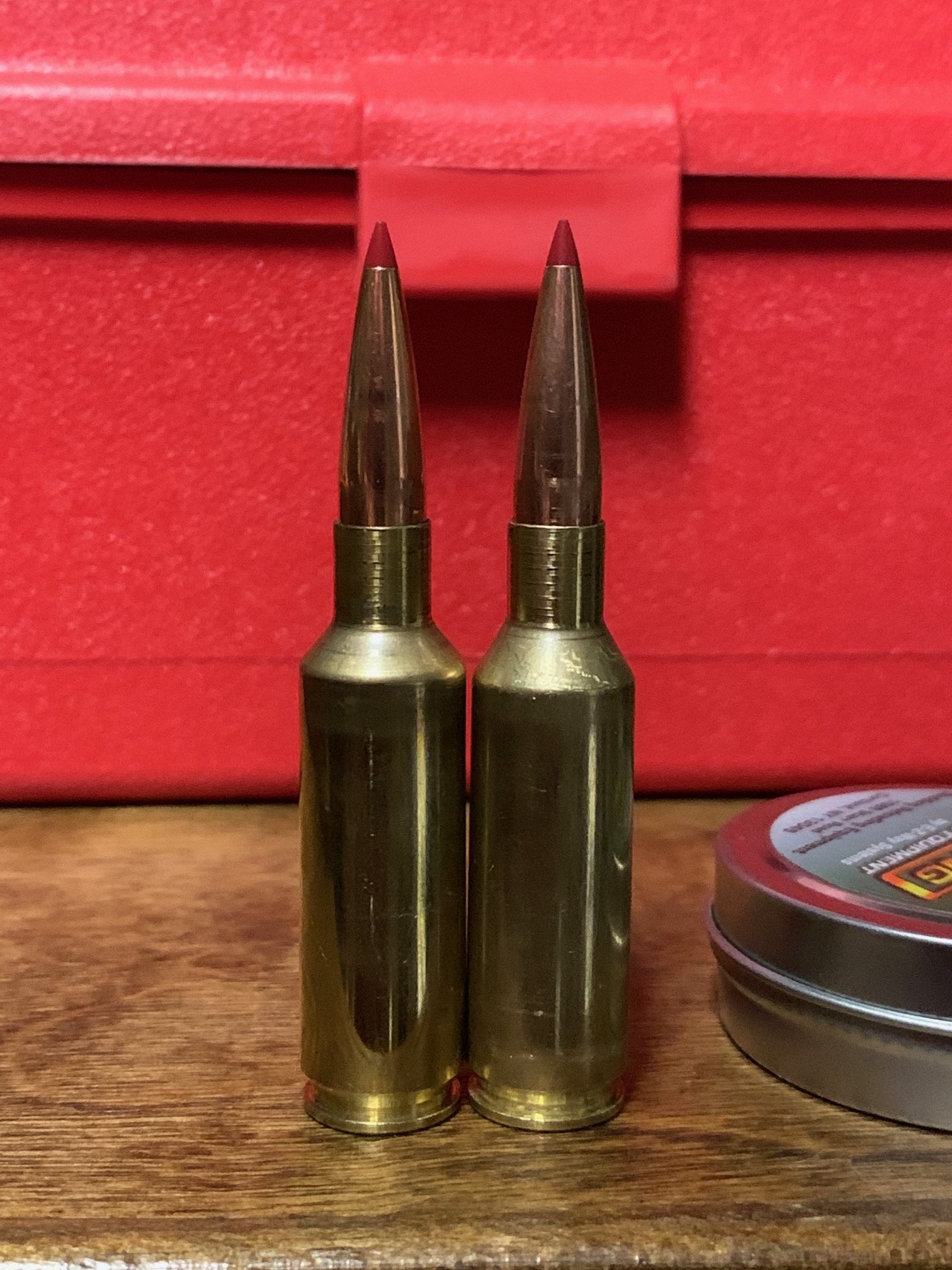

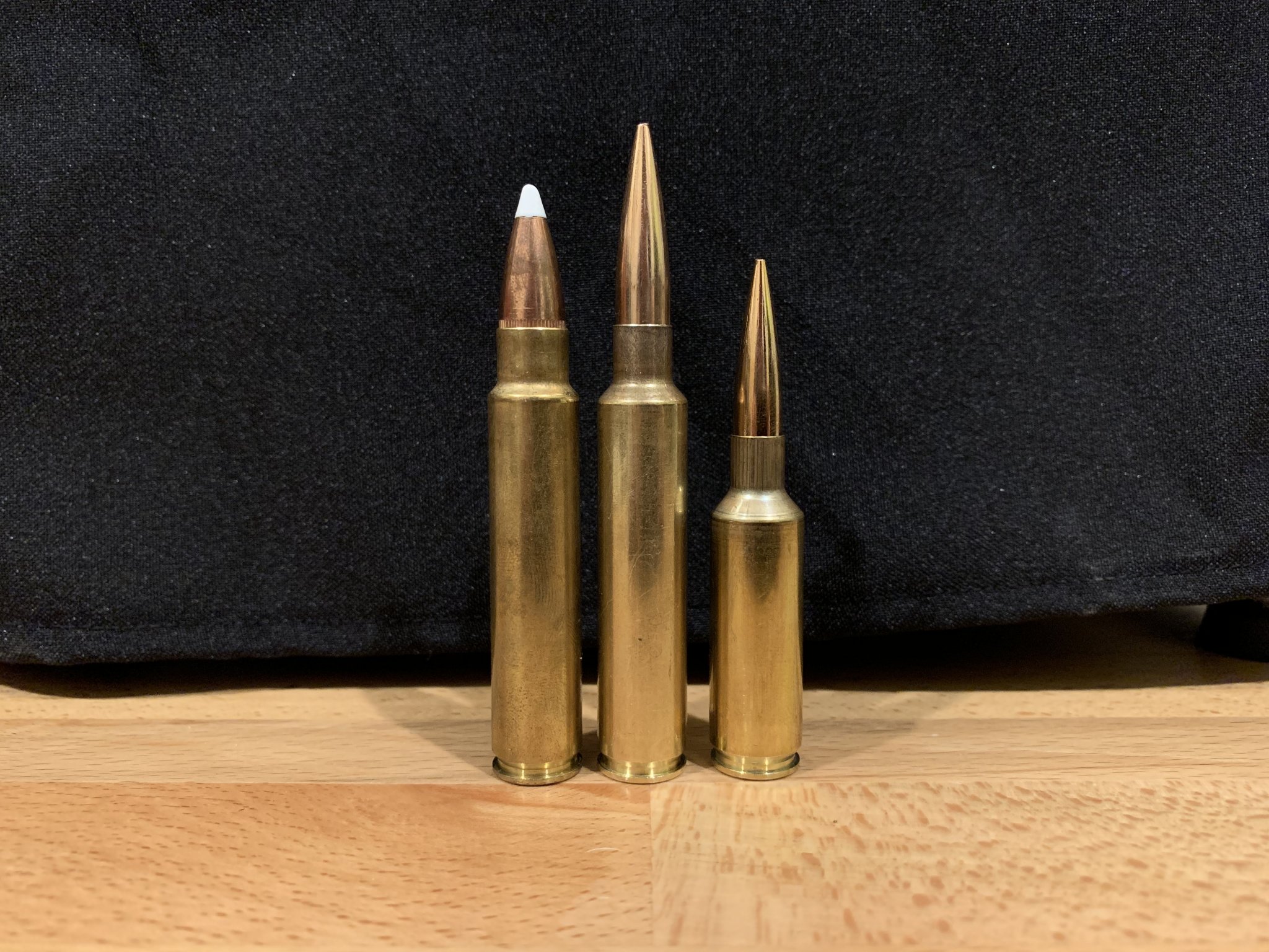

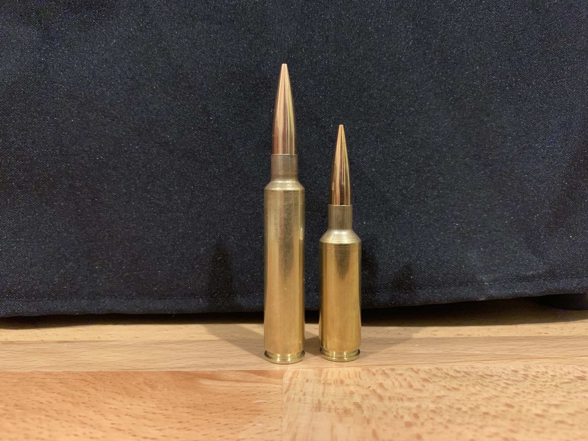

Left is a 300 Sherman mag with a 215 hybrid and right is a 7 SS with a 175 Berger Elite Hunter.
That's a lot of sex right there
They are my favorite cartridges to look at along with my 22 creedmoor. I just took a picture next two a 375 Ruger for scale. It makes me realize how big the Sherman mag is

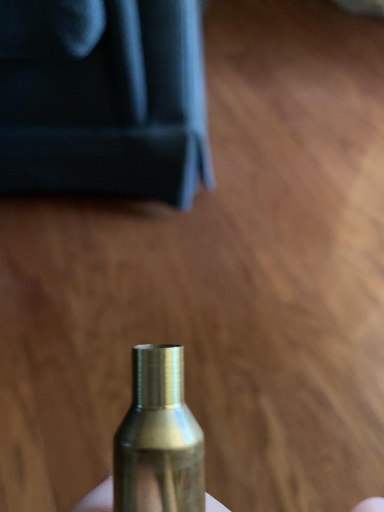

Didn’t jam them at all, but I did run them into an expanded mandrel to open up the necks as they would have been to tight to just load new. I’m just about positive he didn’t turn the necks on these since they are straight from his supplier and I didn’t see the normal neck turning marks, but I could be wrong.

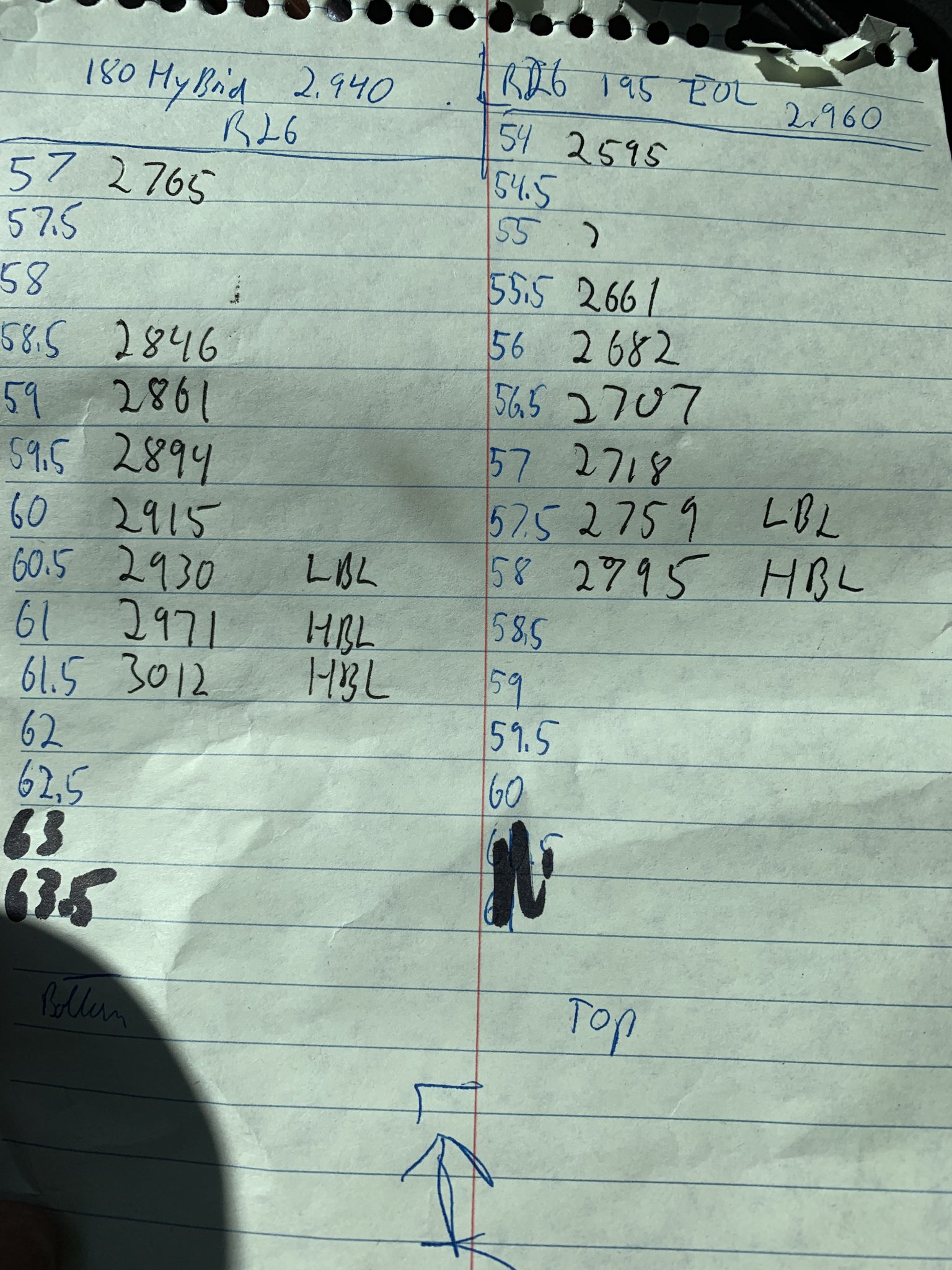

I’ve finally found some time so just loaded some more ladders with the 180 hybrid and 195 EOL. I’ll let you know how it goes.

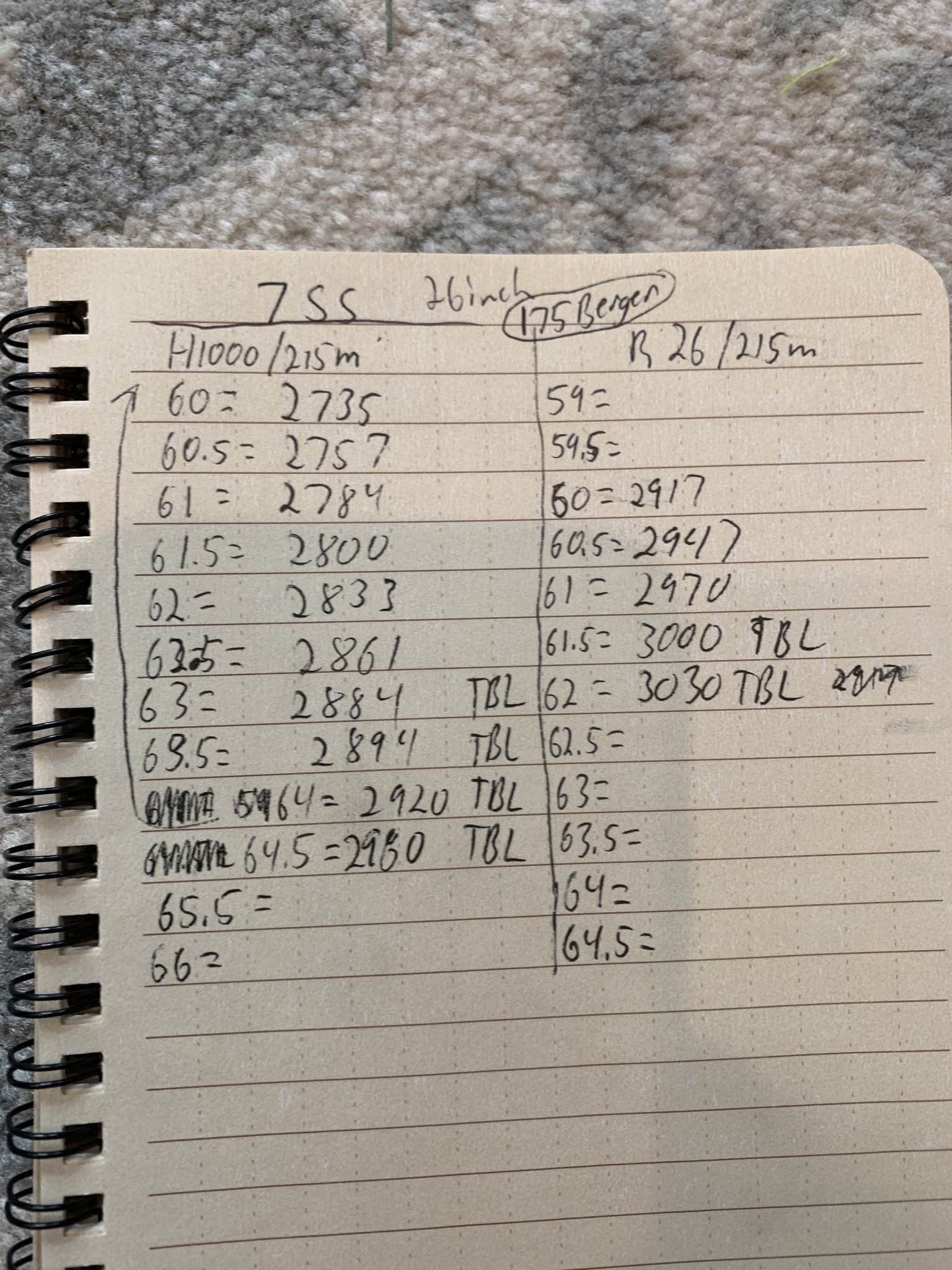

Doesn’t look good for me. Was hoping to get close to 3000 fps with h1000 in a 24” barrel. Looks like I was a bit optimistic.
Yeah I was expecting 175s north of 3000, 180s around 2950-3000 and 195s at 2850-2900. Unless this barrel picks up late. At 90ish rounds fired I was definitely on the optimistic side. Still impressive out of a short action cartridge though regardless

I'll be interested to see what else you run. I had to put together a load with limited time before my hunt as well. You have a fantastic load, it is slow but man that is awesome. I wonder what the 175s Elite Hunter will do over a slower powder for you.
I have been running 62.1 grains under 180 vld hunter at 2970 in a 26" barrel. I am switching to slower powders to get to 3000 as well.
Hoping for 180gr ELD-M at 3000fps but completely understand if 2900-2950 is the ceiling. That bullet has more bearing surface than the 180gr Hybrid. Which is what rich was originally testing with the 26". We'll see.

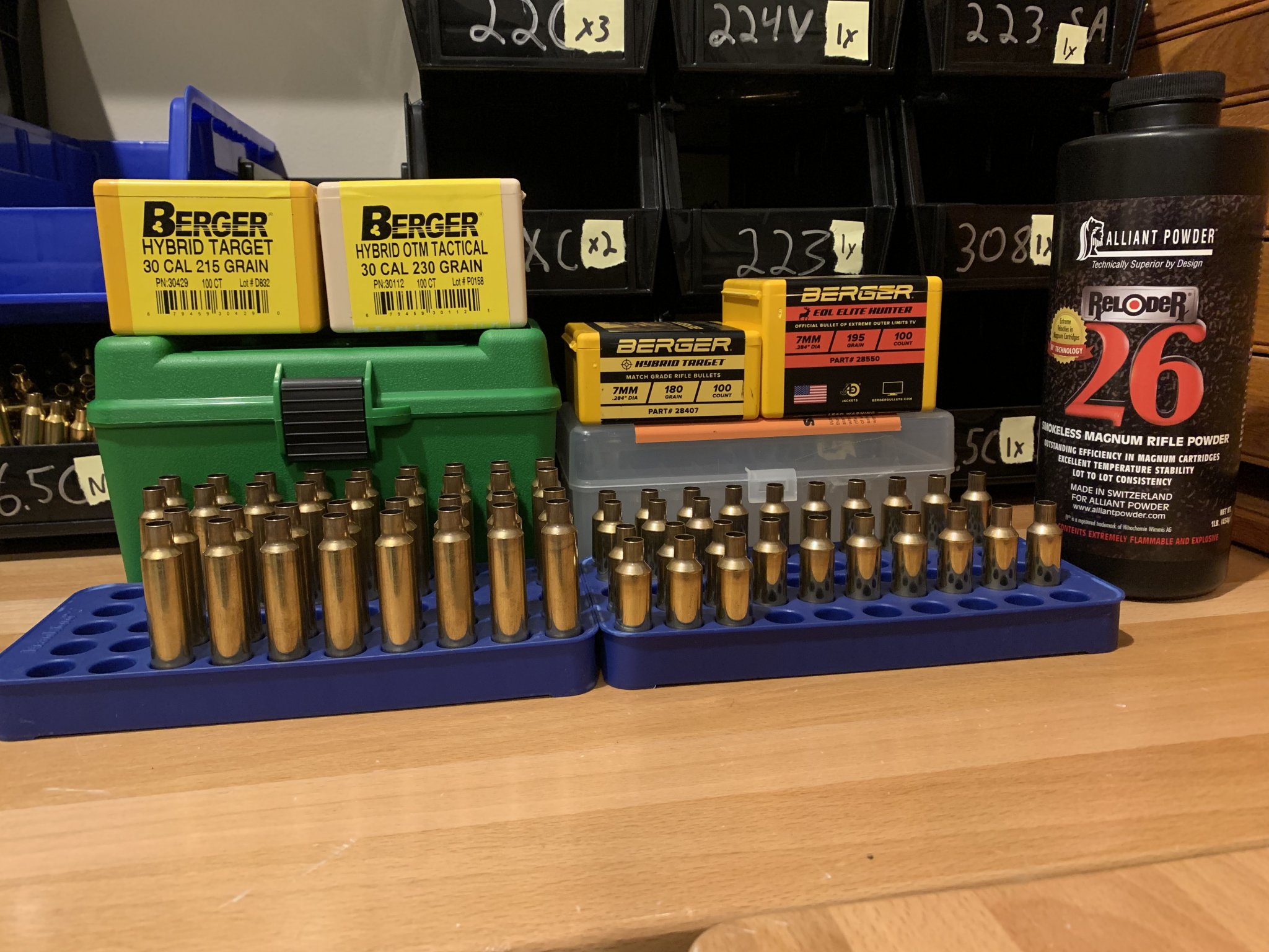

Finally got them all fireformed. Wanted to see how 60gr of RL26 settled with this long pill. Not crunching can still hear powder moving despite being below the shoulder a bit. Which is great. Should be able to start shooting groups tomorrow.
Also damn just now seeing this Jafo i wonder if RL26 will give me the edge. I was hoping for 2900 or better. Just goes to show the immense amount of bearing surface on this bullet. It is extremely long.

Finally got around to shooting mine this afternoon. Was a bit skeptical though, as @5RWill said, I was crunching powder at 59 gr H1000 with the 175 eldx. I was able to run it up to 61 gr and 2745 FPS. Not at all what I was hoping for, but I have other powder/bullet combos to try out. Also, only 65 rounds on the barrel now (24” proof).
Next will be RL26 and 180 hybrids, and 180 scenars. They should not get as far in the body of the case as the 175 eldx.
