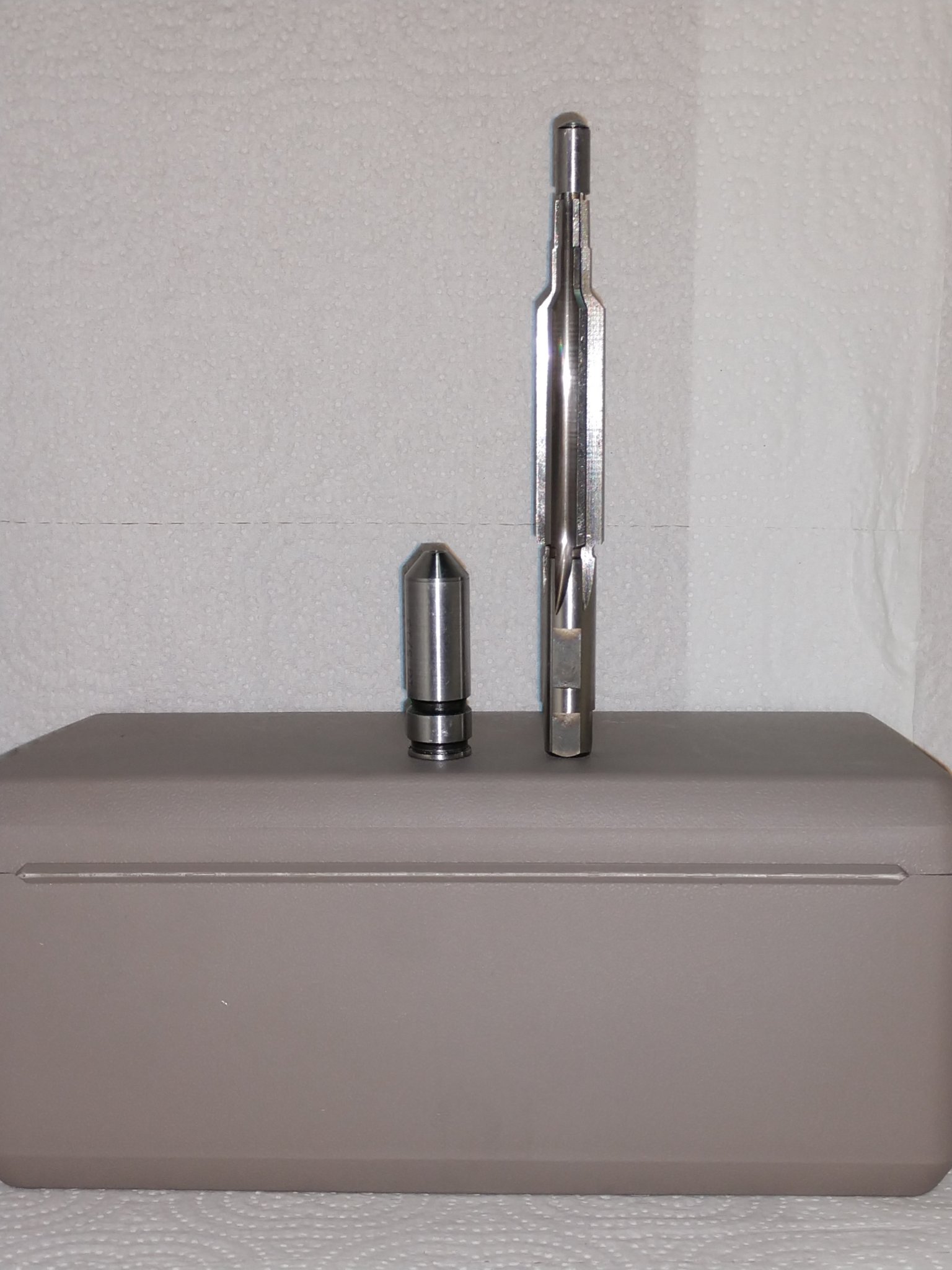

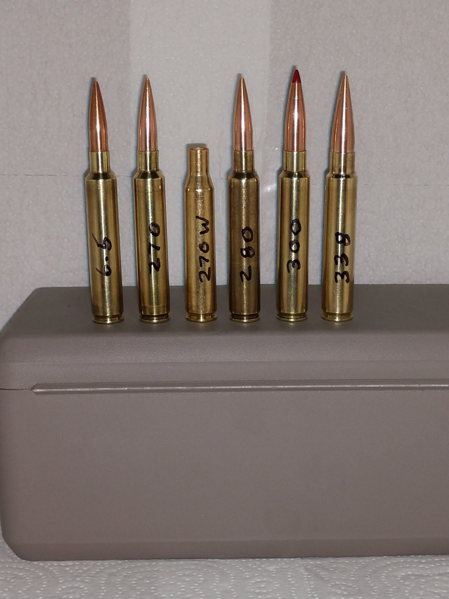

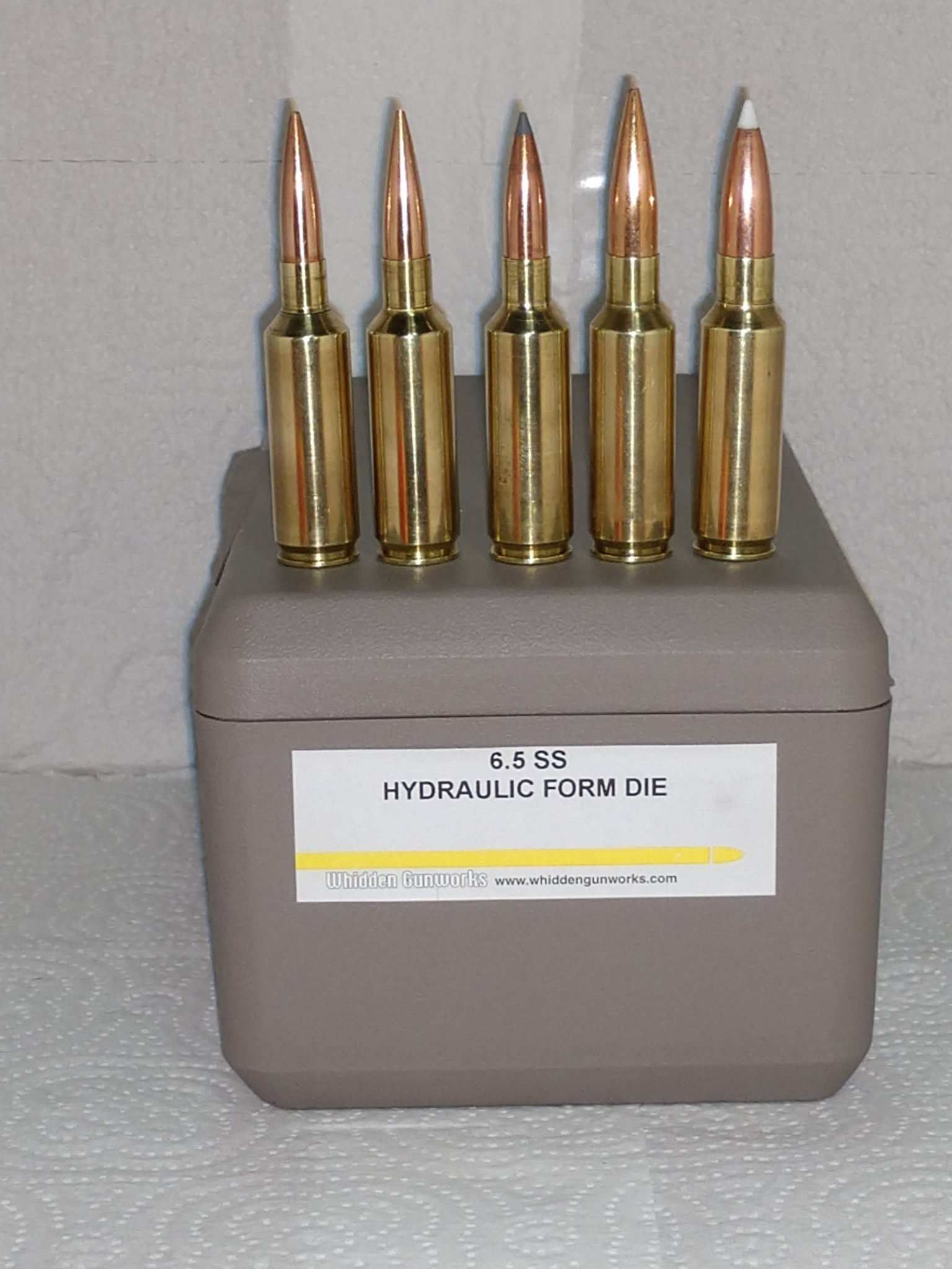

Hi guys, rich sherman here I don't know how often I can get on here but will try to check in occasionally. Things have gotten crazy with the Sherman Cats and I only have so much social media time. The head stamped brass becoming available has kind of opened the floodgates! Anyway; I thought I might clear up a few questions.
The long action SHERMAN design is based on the 270W case and is chambered in 6.5, 270, 280, 300, 338, and a guy is getting ready to put a 35 together. Ballistics in each is very comparable to the factory versions of the WM.
THE SS line is chambered in 6.5 thru 338 and are the ballistic equivalent of the long action Shermans with 4 grains less capacity and all under 3" coal.
The SST is basically a SS with a 30 degree shoulder and shorter throat (Sherman Short Tactical). It was designed for PRS and I run the 147 ELDM @ 3107 with a 2.770" coal.
There will soon be a 6mm version that should push the 115 DTAC or Berger near 3500!
I am currently prepping Norma Saum brass for the ss and sst which is ready to fire form with bullets. The sst can run full loads and the SS should be reduced 7 or 8 percent because the shoulder needs blown out along with body taper. We are getting double digit loading. ADG head stamped brass will be available this summer for the ss and sst in 6.5 and 7 mm. They can be easily necked up or down to other bore sizes as all the bodies are the same. I will be taking pre orders soon when I get the website up. Probably @ shermanwildcatcartridges.com. I have to order a years run of brass, so it would be wise to pre order if you are interested!
You can also catch me on long range hunting online magazine forum or face book @ Rich Sherman/ wildcat cartridge page.
