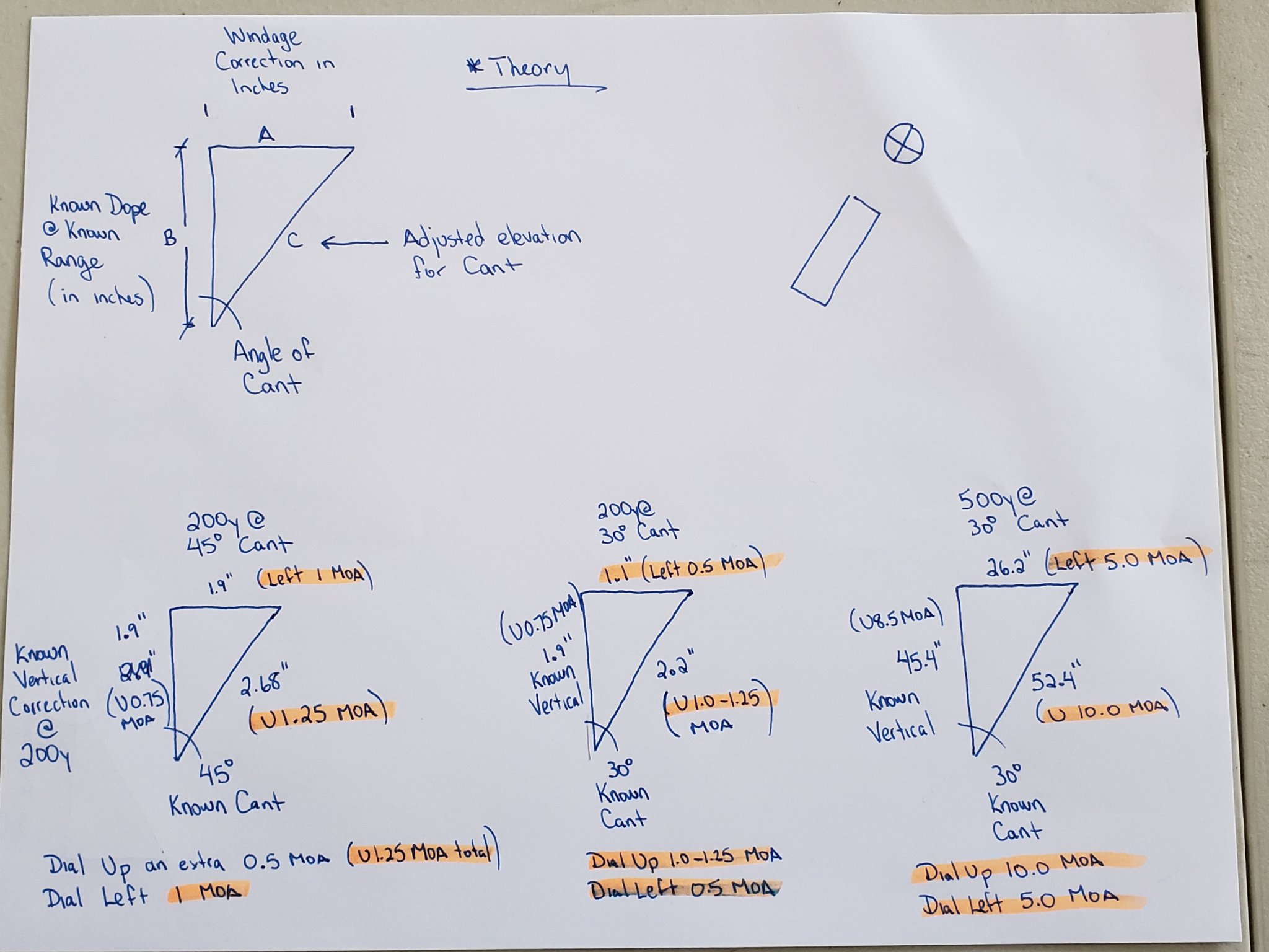

I've shot with my rifle canted a fair bit, but most of it has been within 100-250 yards @ 20 - 30 degrees cant, where the adjustments aren't so severe, and the targets are often fairly generous - so I haven't really needed to run actual numbers. If my scope leans to the right, I generally just hold the upper left corner of a target and find success.
But this thread made me wonder how it could be calculated, and what the numbers would look like at longer range. I spent a few minutes marking up the attached drawing with some numbers I calculated using trig. Of course, I'm using (roughly) my dope on my 6.5, as well I'm a dirty, MOA-using left handed schmuck, so I try to cant to the right if I have a choice and my adjustments are in caveman MOA, HA, but the data in the markup more or less represents what I see when I shoot canted at 200yds, and should be fairly close using the same calcs at longer ranges.
I used the trig calculator at http://www.carbidedepot.com/formulas-trigright.asp
I input data for:
-Angle A (the degree of cant you are shooting)
-Side b (the known adjustment in inches, MOA, or MIL if you were to shoot with your rifle plumb at the known range)
Once you put those two numbers in and calculate, it will provide you with:
-Side a (your windage correction in whatever type of measurement you entered in for Side b)
-Side c (your corrected elevation in whatever type of measurement you entered in for Side b)
Actual wind corrections and corrections for aiming higher or lower would need to accounted for as well.
I'm a few weeks away from the next time I shoot so I can't actually test any of this, but if any of you guys get a chance to confirm how accurate this is at longer ranges I'd be interested in hearing if it worked.
