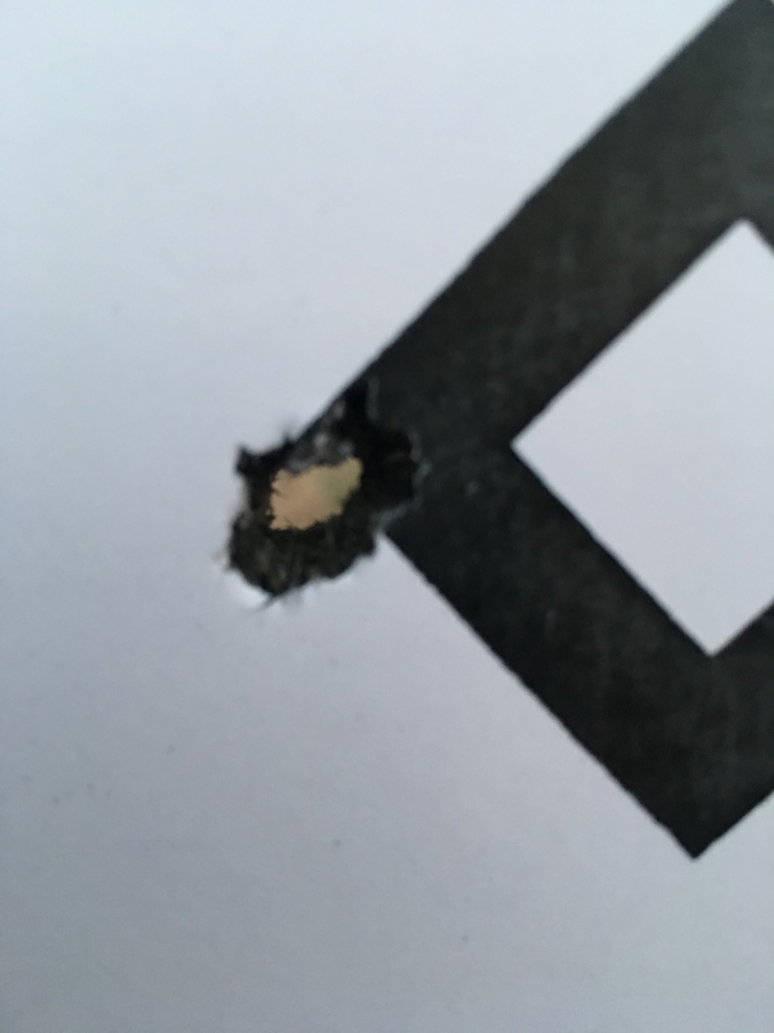

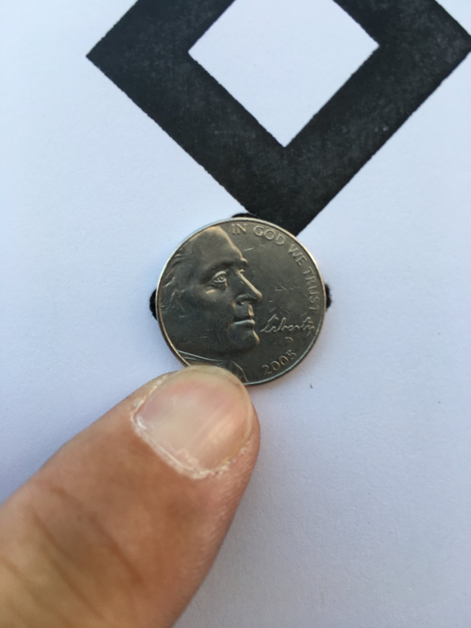

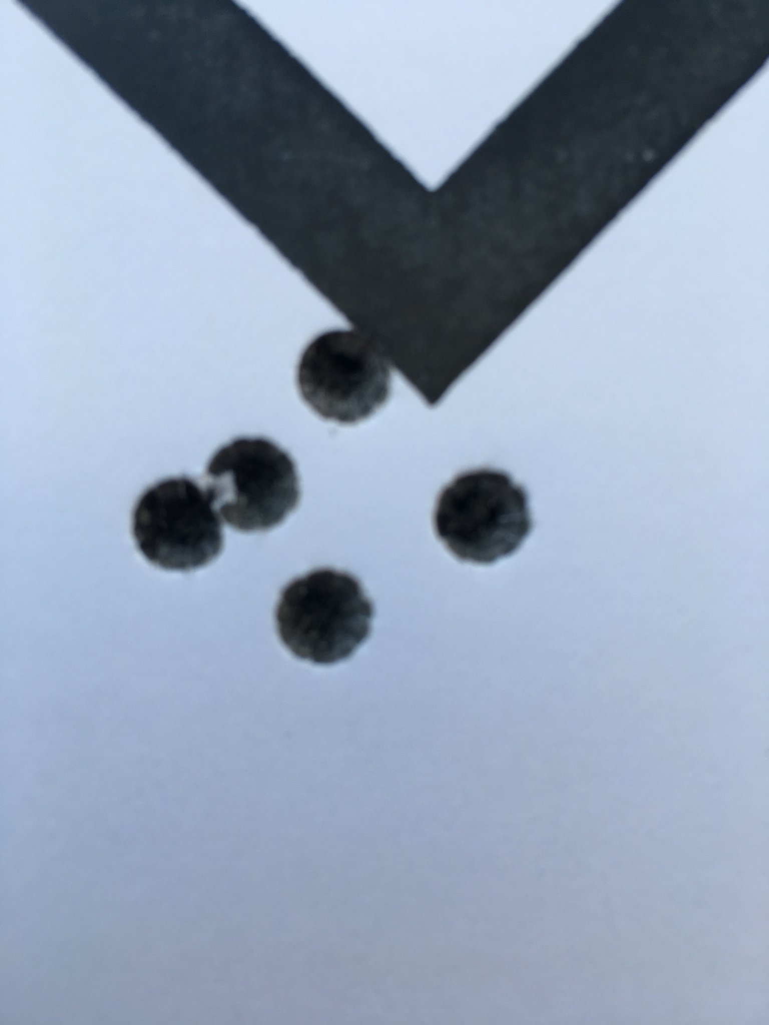

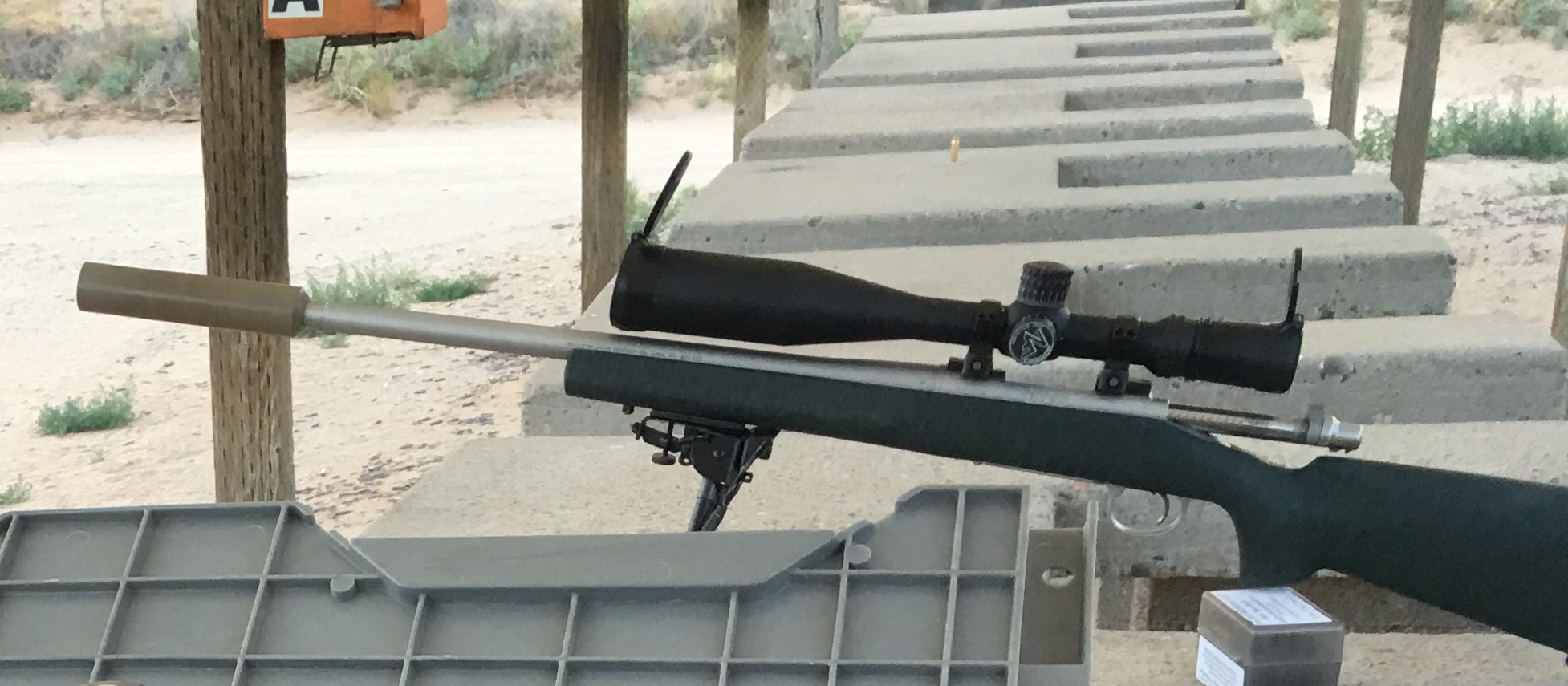

Do you hand load? Another option is a Ruger precision rifle.
9 twist & 73 Berger gets you to 600 easy.
1/2 size IPSC @ 750 is boringly repeatable.
First 5 rds @ 100
Second 5 rds @ 200
Third 5 rds @ 100
Stock 700, 5R, 20”, 223, isn’t even bedded.
Berger 73 Match BT, virgin brass
Working on an 80 gr load for 223 RPR, isn’t quite ready for release yet but really close.

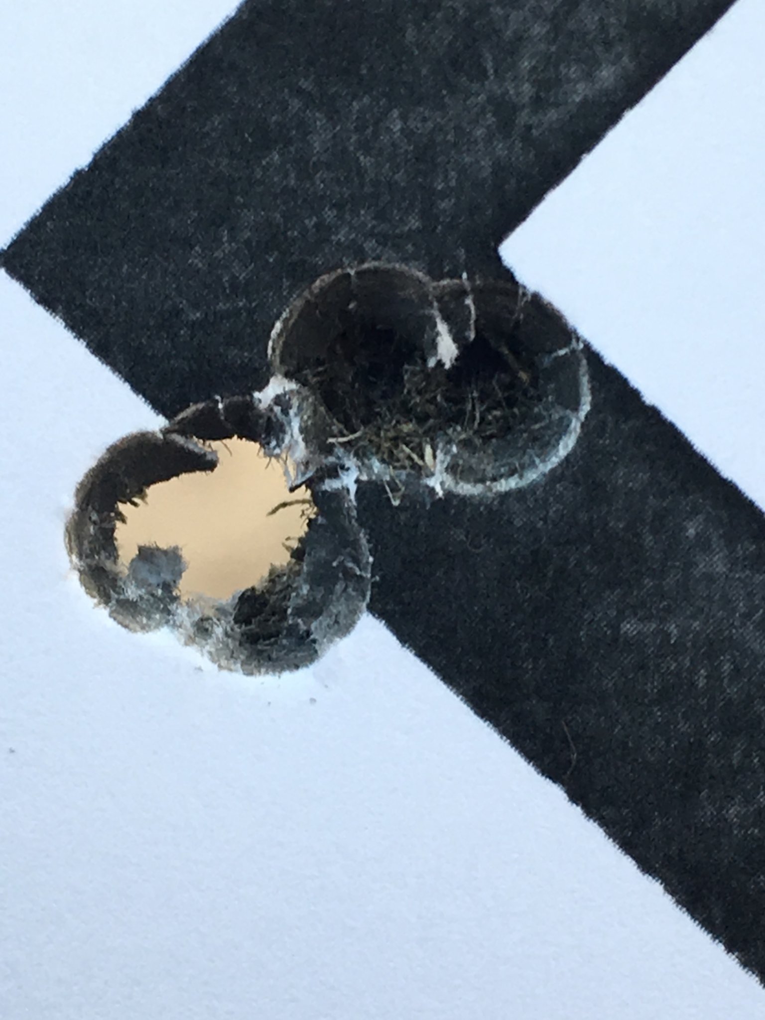

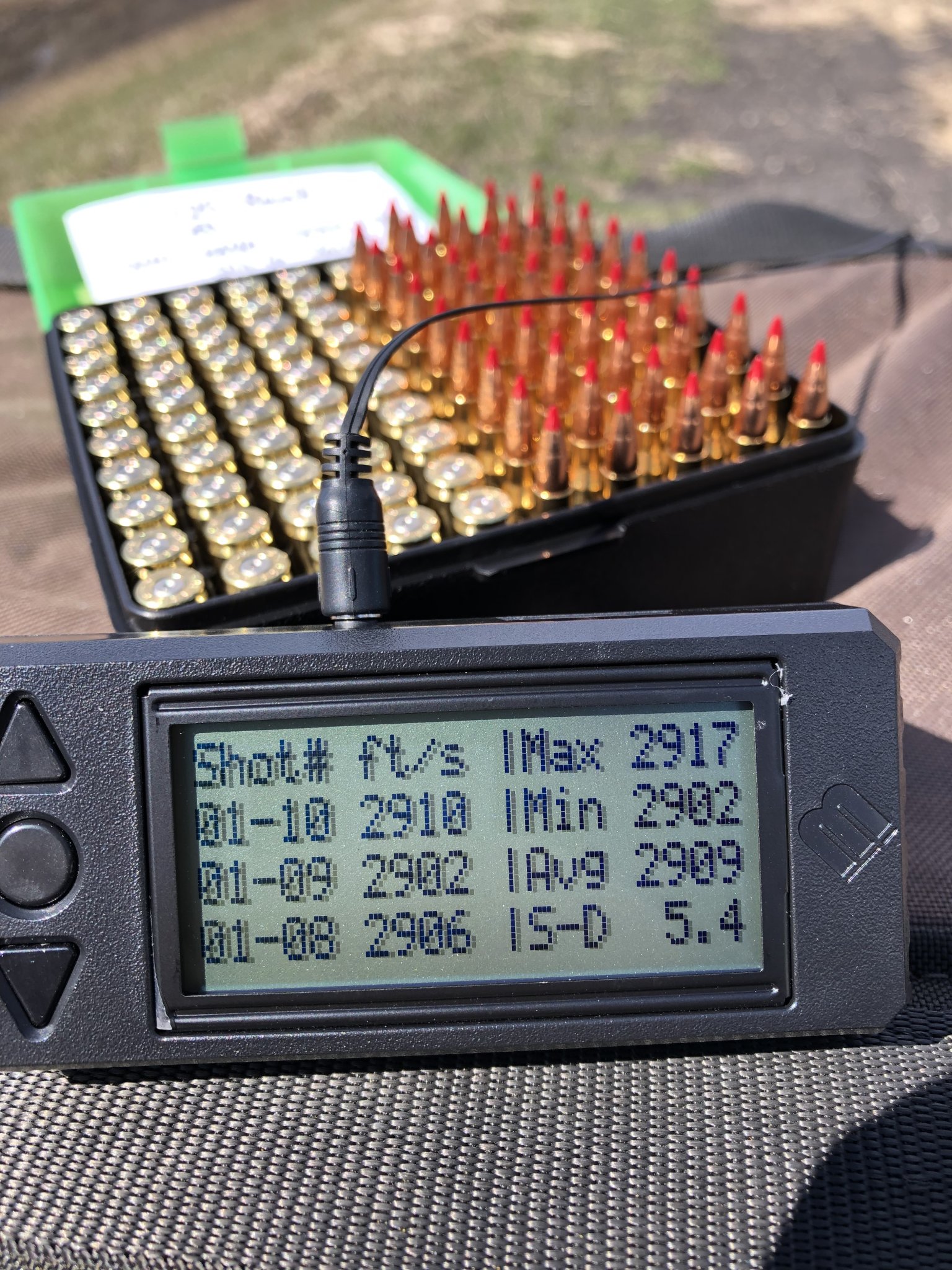

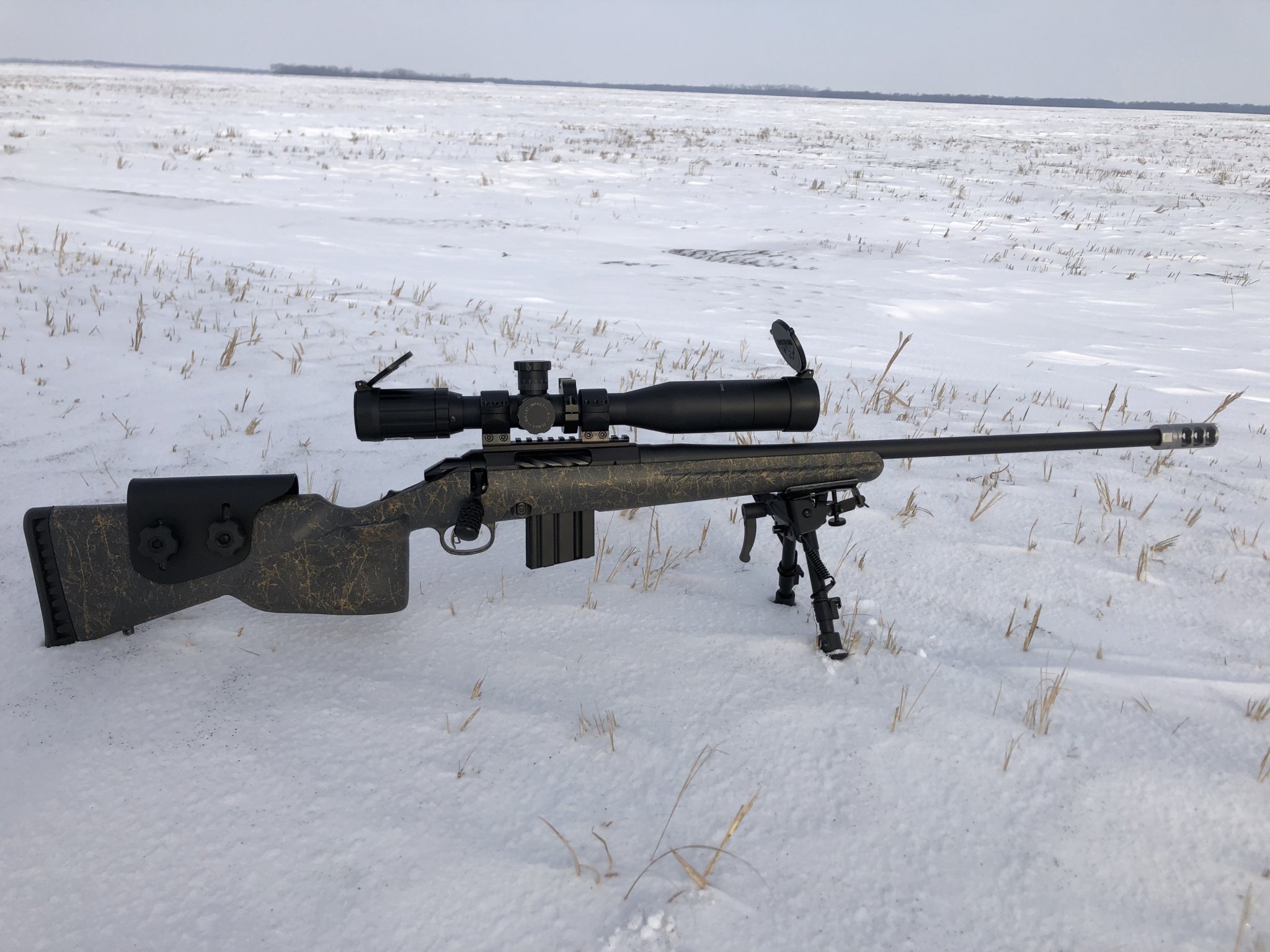

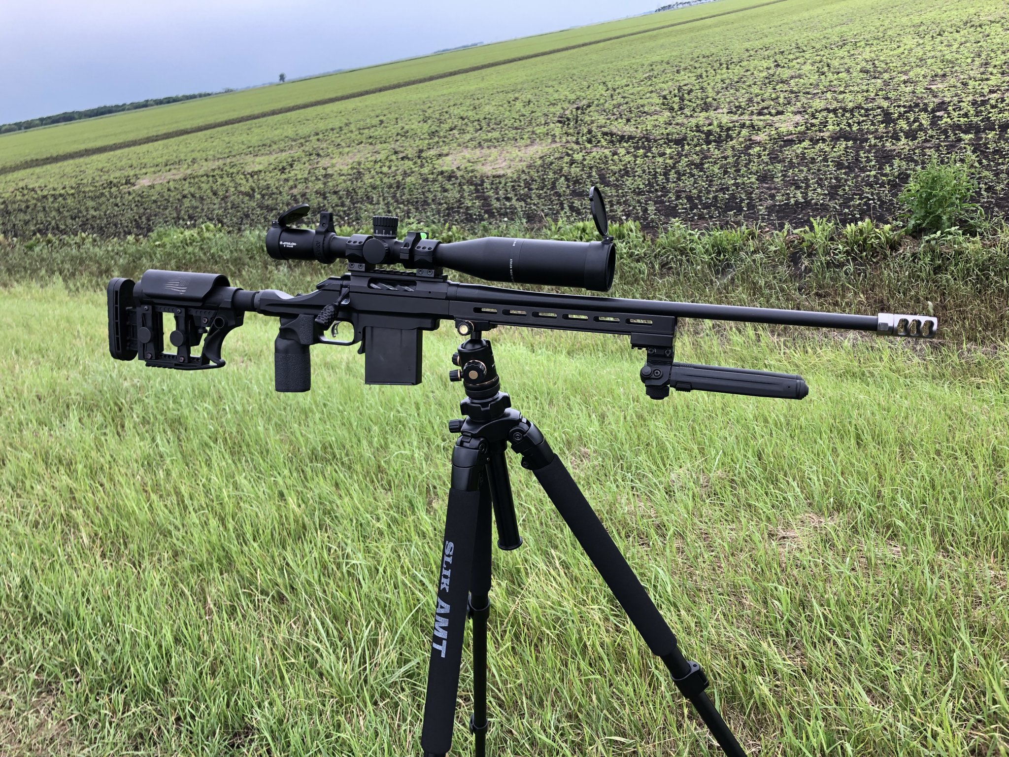

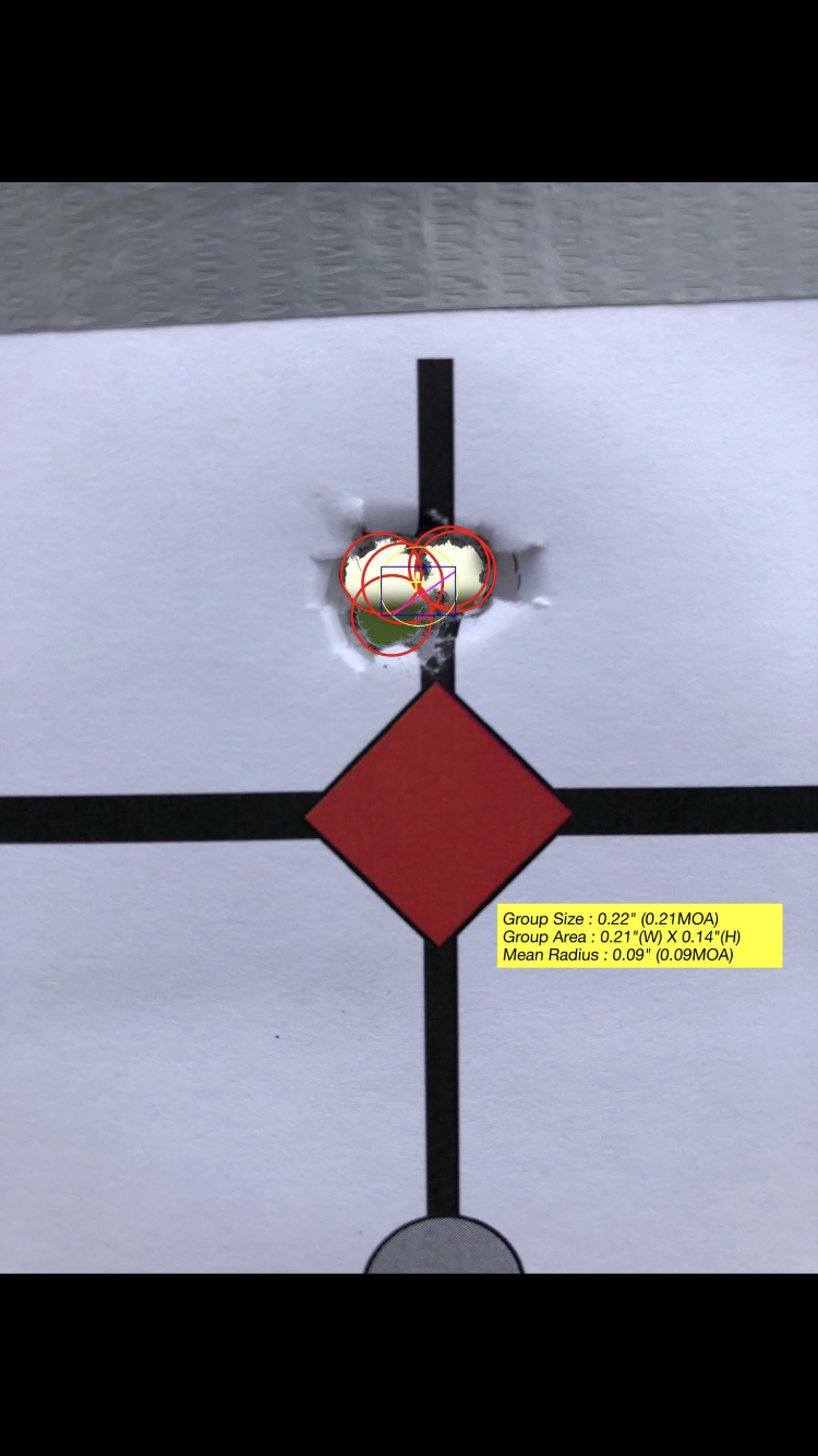

I’ll probably be alone on this recommendation but I love my Ruger Americans Predator 223. I’ve put money into it as funds allowed. But for $400, add a scope, scope rings, and a cheek riser, and do some DIY stuff, and you’ve got a 1/2 MOA rifle.
With some money spent, but mostly with doing stuff yourself, the action can feel very smooth. I enjoy working on things with my own hands so to me doing DIY stuff is enjoyable
Pros:
—Accurate. Under 1/2 MOA with factory ammo, my handloads are closer to 1/4 MOA, +/- alittle depending on me/my shooting
—Threaded barrel
—Very usable factory trigger with some work done-mine is at 2 pounds, no creep. Timney available if desired.
—3 lug, 70 degree bolt throw (I personally hate 90 degree bolt throw)
—Decent amount of aftermarket support, and gaining more options often (still nowhere near r700 level aftermarket support though)
—Factory stock for Gen 2 models uses AR15 magazines if you’d like something like that, I personally prefer AICS magazines though.
Cons:
—Factory stock definitely leaves things to be desired, but with some DIY work and a cheek riser can be very functional
—Requires some polishing of the bolt to smooth out re-cocking action
I’ve taken mine with my handloads of 73gr ELD-m out to 1,000 yards, averaging an 80% hit rate on a 16” gong. Hitting 700 yards is honestly boringly repeatable, but still fun nonetheless.
Group pictured is my handloads, 5 shots at 100 yards. Also chronograph data with Starline virgin brass, Federal 205m primer, Varget, and 73gr eld-m seated 0.005” off the lands.
Also pictured is how the rifle looks now (in the Indian Creek Design MoFo Chassis) ....and how it looked before in the factory stock with some modifications I made

Which chassis is that?
Indian Creek Design MoFo (Modular Fore end) chassis. Made in Idaho. Base retail price without sales is around $400 with the Tommy and Slimmy fore ends...$430 with the HERO AR Handguard adapter....and $450 with the Johnny fore end that has M-lok slots running the length of the fore end on all 3 sides, and an Arca Swiss rail running the length of the bottom. I’m running the Johnny fore end on both of my chassis’s...one of them started out with the Tommy, but I switched the Tommy fore end out to the Johnny when the Johnny was released.
ICD also makes a folding stock adapter, a replacement bolt shroud with built in bubble level, an a buttstock called the P-body that is similar to an XLR buttstock

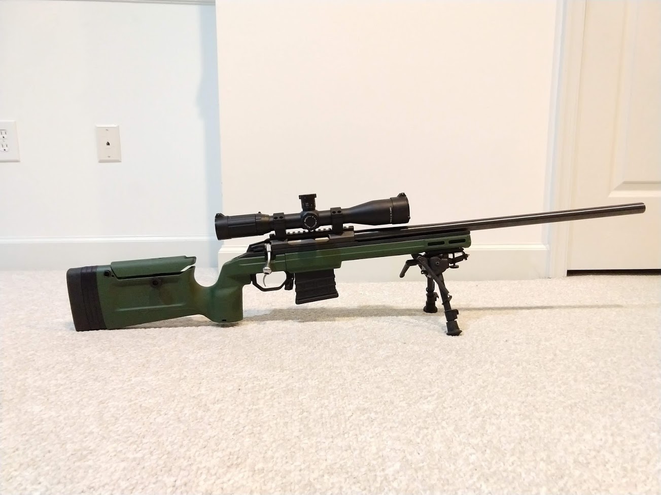

I recently went through the same drill. The Tikka action is hard to argue as is the overall accuracy of their barrels. After too many hours/days of research I determined the Varmint action/barrel combination was the best value factoring in $125 to have the barrel threaded 5/8x24. Once the accuracy potential was confirmed I ordered the KRG Bravo stock, a $10 trigger spring (1lb 4oz consistently crisp break) and couldn't be more satisfied in the rifle's feel, function, and accuracy. Tikka's are a very good value IMO, as are the Ares ETR optics.
That's a sweet rifle... thinking about it for a trainer.
